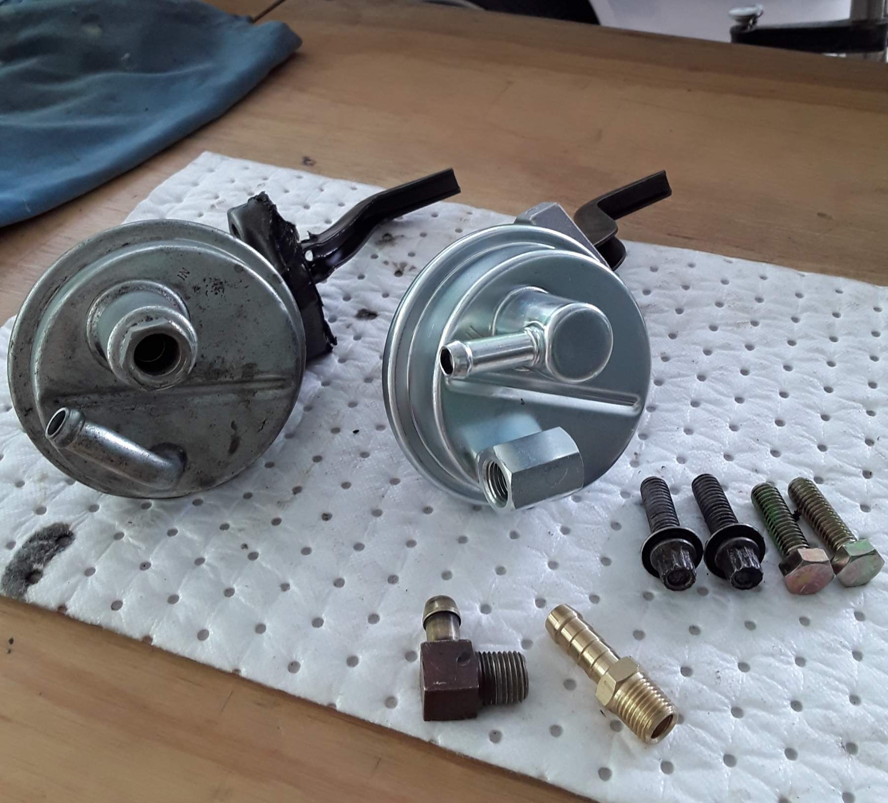

New Fuel Pump Fitting Drama:
This is how you turn the simplest little task into a Cecil B DeMille production. First of all, procure a new fuel pump. Hmm...the fittings for the hoses are different. In fact, the manufacturer decided to completely reverse each fitting. No problem, they both take 3/8 fuel hose. Wait a minute. The 90° brass adapter won't screw into new pump because it fouls against the pump body. Right - I'll measure it and buy a straight one. I measured across the threads and came up with 1/2". Drive for an hour to my nearest auto parts supplier and examine their array of brass fittings. Hmm..packet says 1/2" but it's way bigger than mine. The bloke next to me shares my conundrum and advises me of a shop in Cairns that specialises in this sort of thing. I drive another 30 mims and it turns out it's a 1/4" fitting. Believe me, it measures 1/2" across the threads but I suppose BSP threads must have a standalone measuring regime. Whatever, he sells me the correct part.
Have a look at the original bolts - they are 12 point 3/8". They are the ONLY 12 point bolts on the entire engine. They are factory (I googled it) and I don't know why. I bought 2 hex head bolts to replace them.
I am just about to physically fit the new pump.  If I come across more drama, I'll be sure to let you know.20220228_115718.thumb.jpg.285145188342d7fd50f31cf41e72d98c.jpg
gota love rock auto mate!!! i had the same thing with my pump, connections where opposite.... and your right, thats 1/4 bsp... crack up aye!!
i get that all the time with gas fittings for campers and caravans! ...got to watch out too for threads that maybe 1/4 bsp but are 3/8 npt !!!
none the less... its piece of mind to do a fuel pump so you know the whole system is 100%:cheers:
 hows the arm mate ???

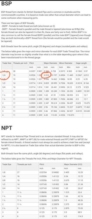

I had to use pink (gas rated) plumber's tape to get the new brass fitting to seal AND I really had to crank it tight - I hate doing that with pipe threads because you are just waiting for that moment when the threads strip. So what's the deal with BSP thread sizing? Why is the actual thread diameter not a true representation of it's size? I kept scratching my head looking at that damn 1/4" fitting knowing full well it was half an inch across the threads!
Anyway, started the car, no leaks and pump appears to work but will only know once out on the highway giving it the gas.
Do you remember if you had the same 12 point bolts? That has really stumped me, as I can't see any obvious reason why Pontiac would have specified them.
mate i really dont know either!!! dam poms and their bsp ! i am sure last indian would be able to explain to us wtf is going on with these threads !!!
no. my factory bolts where justA standard ones, i am sure yours has been changed, no way would they be using 12 point in 1965.
I looked it up - other peeps were wondering why they had 12 pointers too. Weird.
thats odd aye !!

As further proof of my boredom, I looked up BSP threads. Clear as mud.
yes there you go, it measures near 1/2 inch.... weird aye!!!
there has to be a simple reason why they are called different measurements aye
