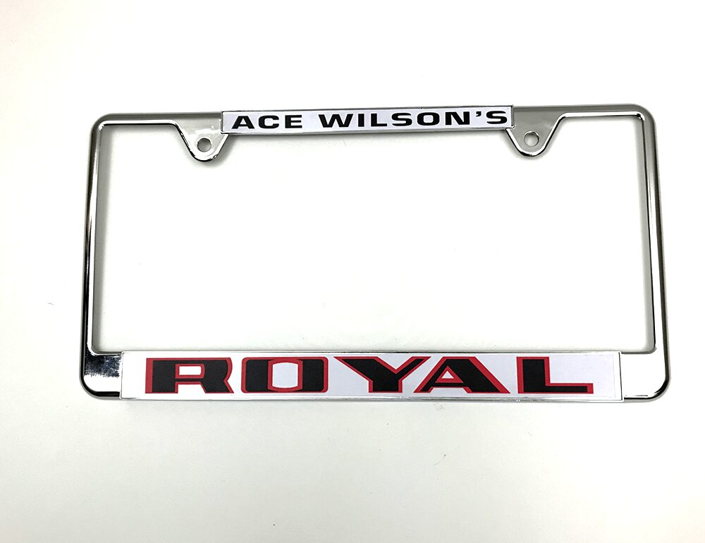

Hmmmm.....I think an Ace Wilson Royal Pontiac license plate frame would look a lot cooler and would impress the local Pontiac community down under. Ace Wilson was the Royal Oak Michigan Pontiac dealer that Jim Wangers and Pontiac used to take cars to have super tuned, e.g. the famous Royal Bobcat treatment. Any Pontiac could get thier Royal Bobcat treatment, but the first cars to get them were the Bonnevilles and Catalinas, which is where the name BOBCAT came from.
Of course Justa is still pissed/jealous of me for getting mine at the Widetracker's swap meet some years ago. I bought a used original Ace Wilson Royal Pontiac rear plate holder for $10 with an old Michigan license plate still in it. Justa had just missed it. These things are almost unobtainuim and I scored one, and for cheap. I could be wrong, but I suspect some knock offs exist now too.
I always wondered what the significance of Royal Bobcat was, and now I know. Like I said, to be true to the car's roots, it had to be a CA plate holder plus it's old & beaten up so will match the car perfectly! The one I really wanted was a srtaight Pontiac dealer plate (no GMC, Buick, Olds, etc mentiomed) but the dude wouldn't send it overseas. I hope he enjoys keeping it in his shop.
