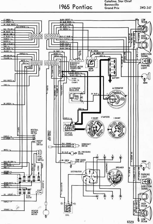

I have a question: did these old cars ever come with a headlight relay? I have checked the factory wiring diagram and cannot find one. My nice new headlight switch has evidence of melted plastic and the lights will go out after a few minutes and then come back on, almost as if a protective circuit breaker cuts in and out. I've never fitted a relay: any tips? I don't ever intend driving at night but I need those things to work without the car catching fire. I'm only assuming a relay will take the bulk of the current away from the switch.
my 64 doesn't have a relay mate, but i do think there is a bi- metal over load strip on the switch from memory
the relay would be a good idea 👍
And i am the same! the 64 isn't going anywhere in the dark
That sounds right - I sorta remember reading about some sort of overload protection in that switch. Do you think a relay will reduce the current going to the switch? I don't even know where in the wiring I should locate it. Come on - you know electrics. I'll buy you a beer if you tell me.

so looking at the wiring diagram, i would be cutting into the feed to the switch, put that load through a relay and use the light switch to trigger the relay. and you will need to do that for both high and low beam its certainly will help with the life of the switch !!:cheers:... oh beer!! dont talk to me about beer right now!! i am full of the bloody flu ! stuck at home trying to get rid of it, and no pressure! the sparky is here tomorrow to do the pre wire of the additions, i have to get the gas fire piped and installed this weekend as the insulation guys are here Tuesday to fit the wall and ceiling insulation (cheaper for them to supply AND install than i can even buy it for):cheers:

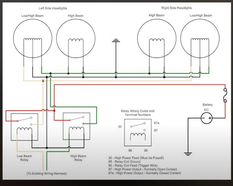

No relay but putting one in is a good idea, actually two would be good, one for low beam and one for high beam.
I would put them in the engine compartment and get the feed / power directly from the battery with a fuse in between, maybe the power point at the horn relay?
here's a schematic I found online.
I like to put relays on for the starter also.
Nice work, Andy. Thank you. I'll have a think and will post whatever disaster I eventually concocted, thereby guaranteeing that the car will be in flames in no time.

cool systematic 👍👍👍👍👍👍
I completely agree with 2 relays
one for each high and low as each draws as much current load 👍
And fitzy andy is right , a good load point to get your power supply from  would  be the horn Relay on your inner fender on the drivers side …. And next to that relay is your feed wires from the switch to the head lights !
you don’t even have to go under you dash to to this up grade !
you could mount the 2 relays next to the horn relay , on that inner fender
then cut the high beam feed from the switch and put it through your first relay
And do the same with the low beam wire !!!
easy as !
And it would be super tidy
I will draw you a picture of what I am thinking in the morning !
