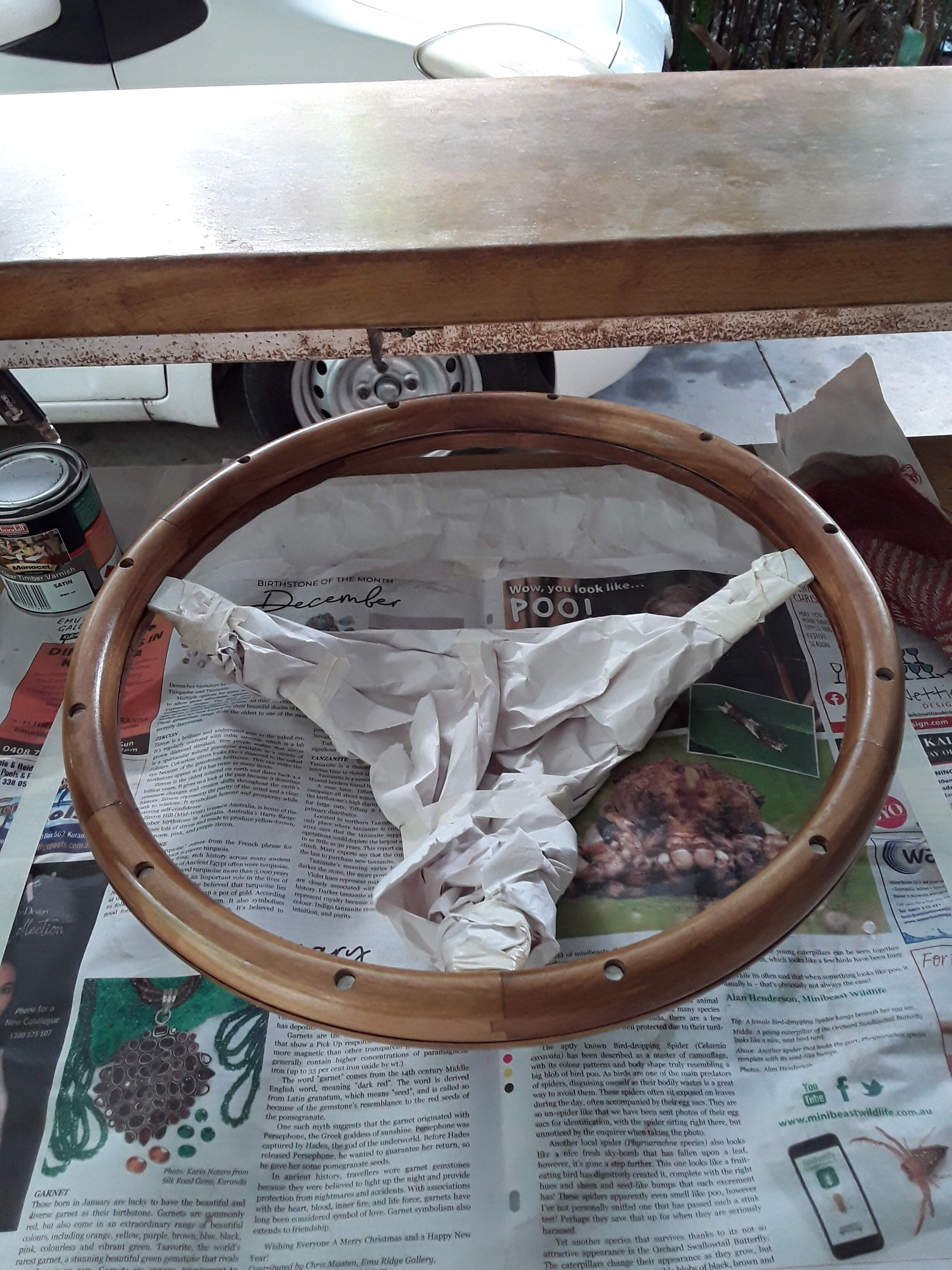

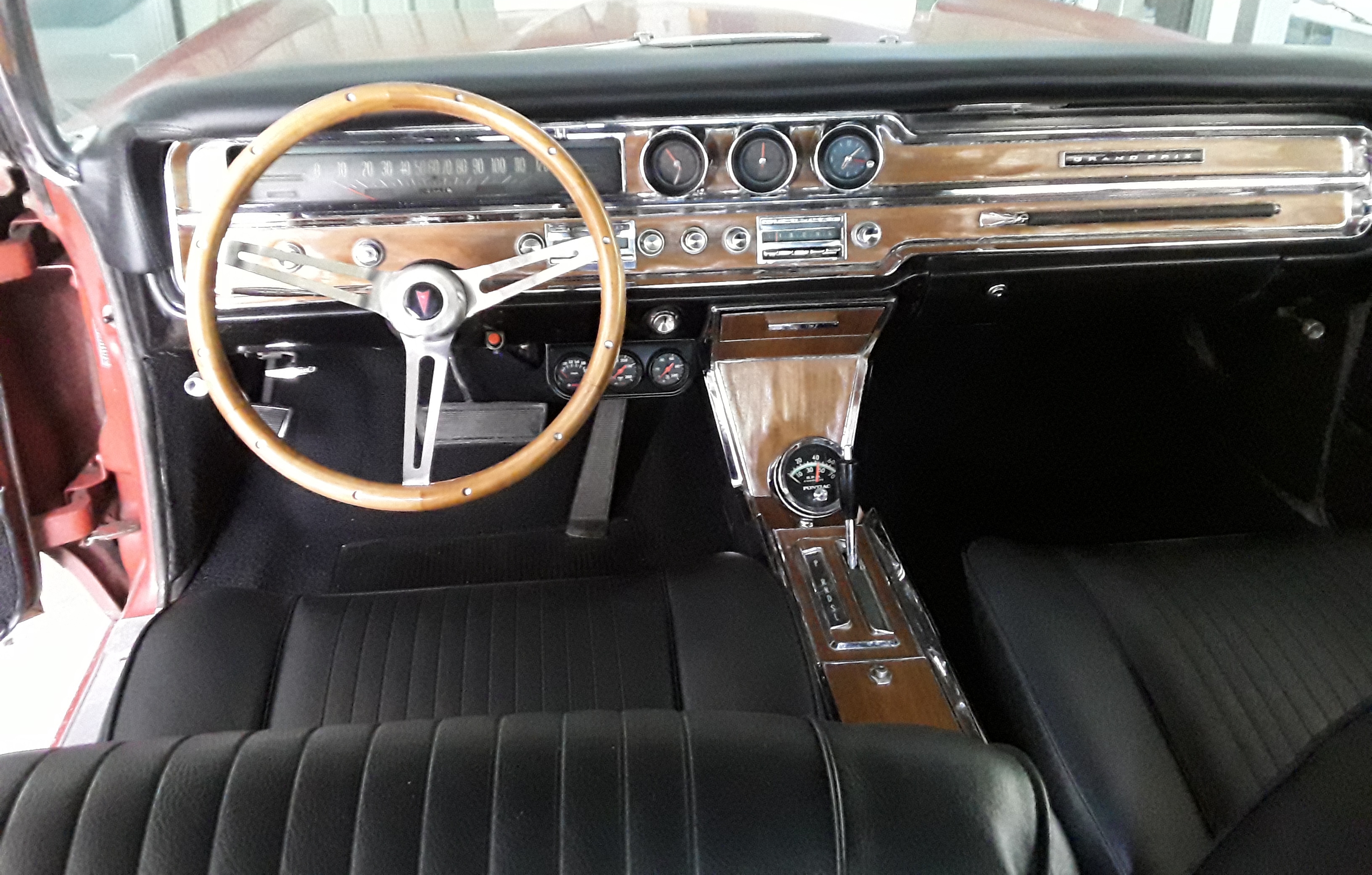

Speaking of steering wheels, my reward for spending time under my mower cursing & grunting turned up today - the new steering wheel! It looks like a quality unit (and so it should be considering the cost) but I am a little surprised at the thickness of the woodrim. It is way thicker than a proper 60s vintage wheel but I'll gladly put up with it. I had a choice of slots or holes in the spokes and went with the slots. If I had a GTO, it'd be the holes. The GP is more of a hybrid luxo sports variant, so no use pretending it's a muscle car,  hence the 'softer' look of the slots.
One of tomorrow's jobs will be to fit that wheel. Just need a carby and the car may go again.
wow! that arrive quick !! great service !!:cheers:
cant wait to see what it looks like on the 65 !!:pop_corn:
i see its a grant... i hope the horn button mount works correct ! my grant on the camaro is a nightmare with how they designed the way the dome button presses onto the backing plate, dumb thing doesnt stay in place and pops off !!

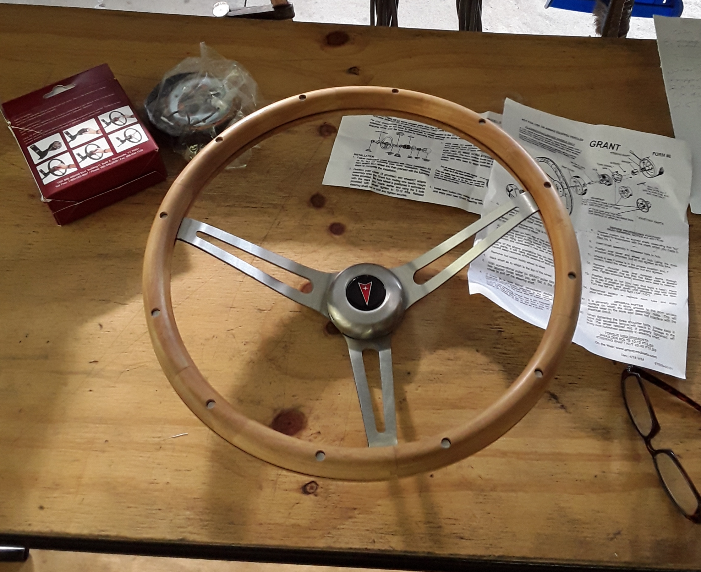

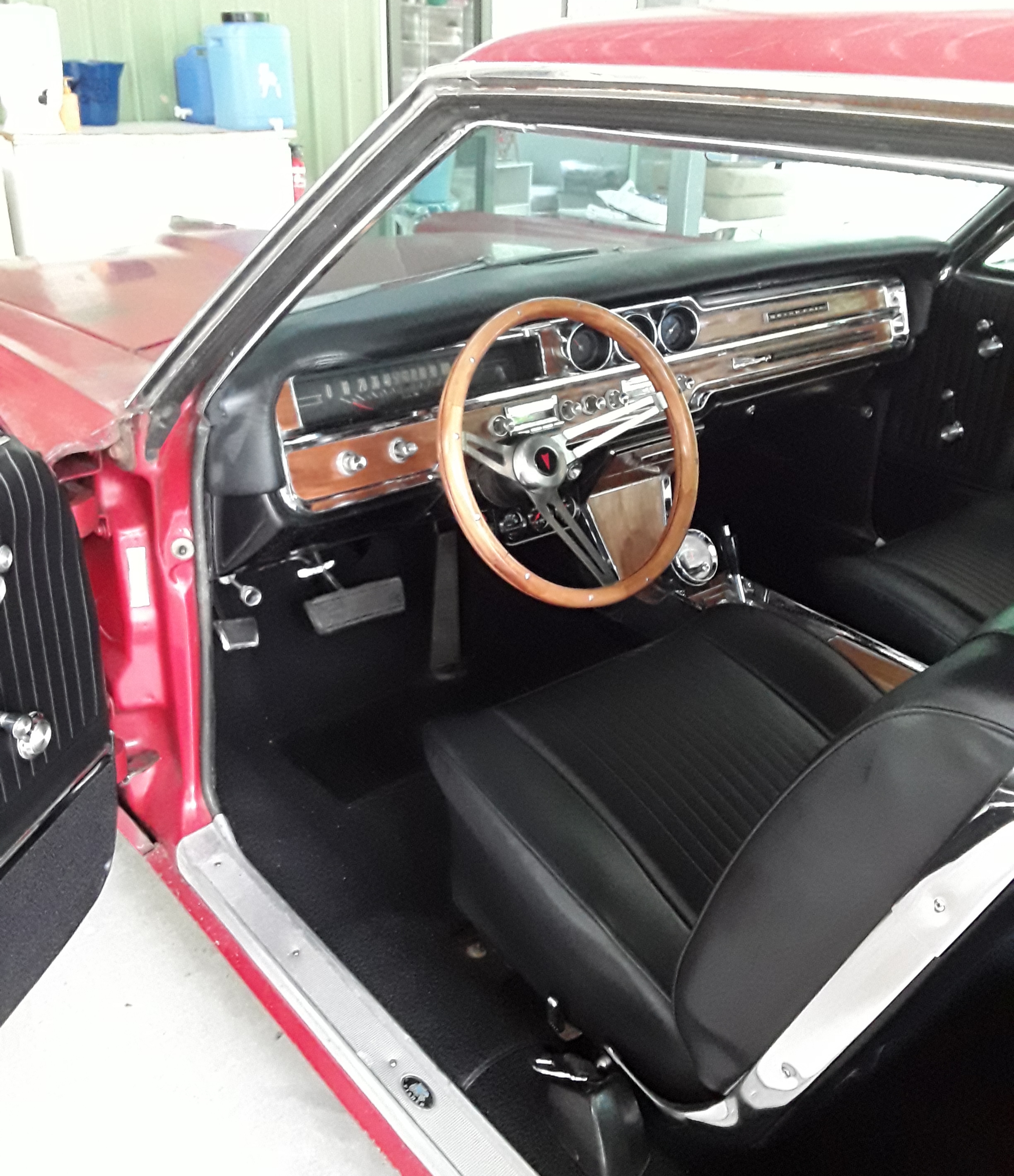

It's been raining here for days so today the sun came out and steamed us alive - a great day to sit in the GP and fit the new tiller.
The supplied instructions look like they were printed by a 5 year old - come on, Grant. For what they charge for a steering wheel, you reckon they could provide some clear instructions with nicely drawn CAD images and not kindergarten scrawl.
It's a simple enough procedure but of course there was a drama. As I was struggling to get the horn button to clip over the recesses in the fibre cap behind it, Kiwi's words kept echoing through my head, ie. the Grant wheel horn button in his Camaro won't stay in place. Mine wouldn't even go on. After some inventive swearing, I pulled the lot out and examined the horn cap dimples and the recesses in the fibre cap - they sorta lined up, but not as well as they should have. Out with the power drill and I carefully enlarged each recess so as to guarantee successful docking procedure. I also LIGHTLY sanded the fibre ring perimeter so the cap would slide over it smoothly. It worked beautifully until it was time to rotate the horn button so as to make the Pontiac emblem sit upright. God himself could not have made that horn cap rotate, so I GENTLY tapped it around using a small bladed screwdriver and a ball peen hammer. Done! If I drive that car over a cliff, that horn button will stay intact.
I applied 2 coats of urethane sealer with a very light sanding between each coat, then a light cut & polish over that. It matches the walnut dash trim quite nicely and looks pretty good, but I would have preferred a more 'period correct' thin rim wheel but it is what it is. As far as the horn goes, I sidestepped all the crap involved with making the wheel button work and had previously mounted a push button just under the dash to operate the air horn.
It looks great, good job bud!

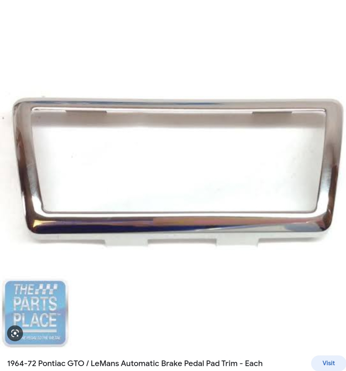

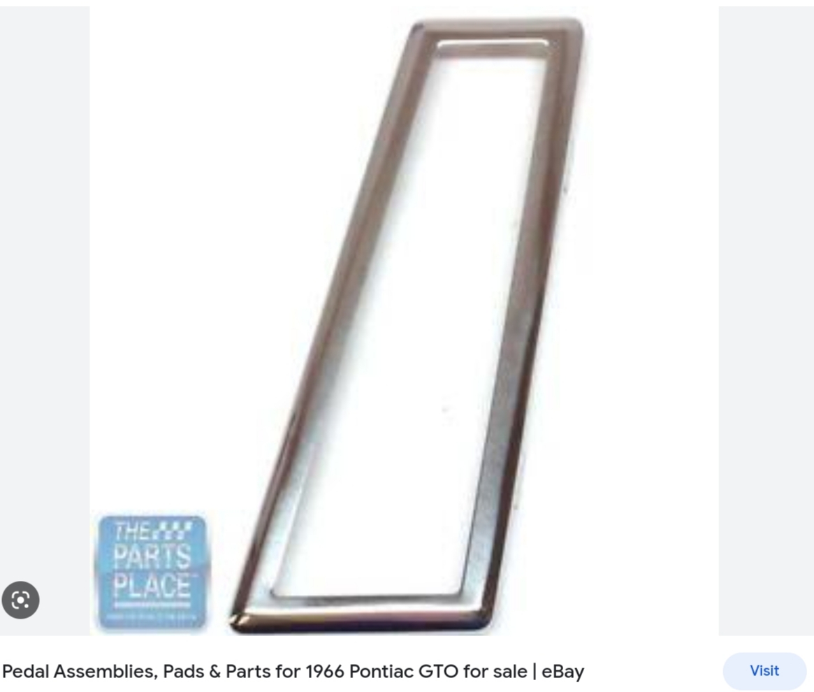

Here's a challenge for you - does anyone know where I can get a set of accelerator & brake pedal chrome trim pieces? They seem to be available for manual cars, but not autos.
Come on … you know we like pictures around here ! What do they look like ?

Franks has your brake pedal with trim for $25 bro and a gas pedal for a 64 for $85 (not sure if that's the same as the 65) and a 65 gas pedal with linkage for $135. I didn't see justa the chrome bro.
Thanks Wrongway. And for Kiwi, here are some stock images. You'd think that the trim for a Tempest AND a fullsize Poncho would be the same but I want to know for sure before I commit. I would have thought that they'd churn out hundreds of these at a time, but not so.
