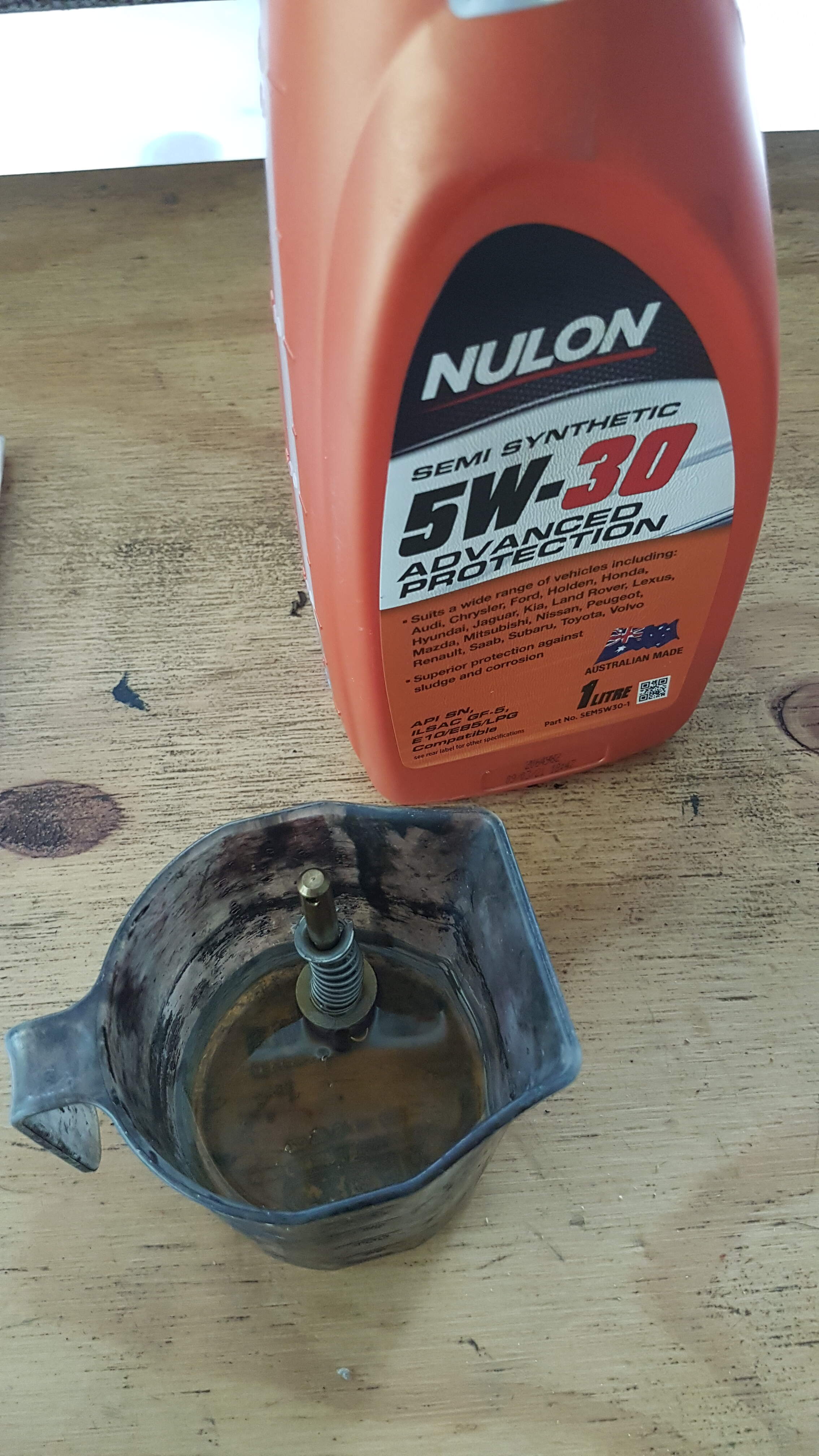

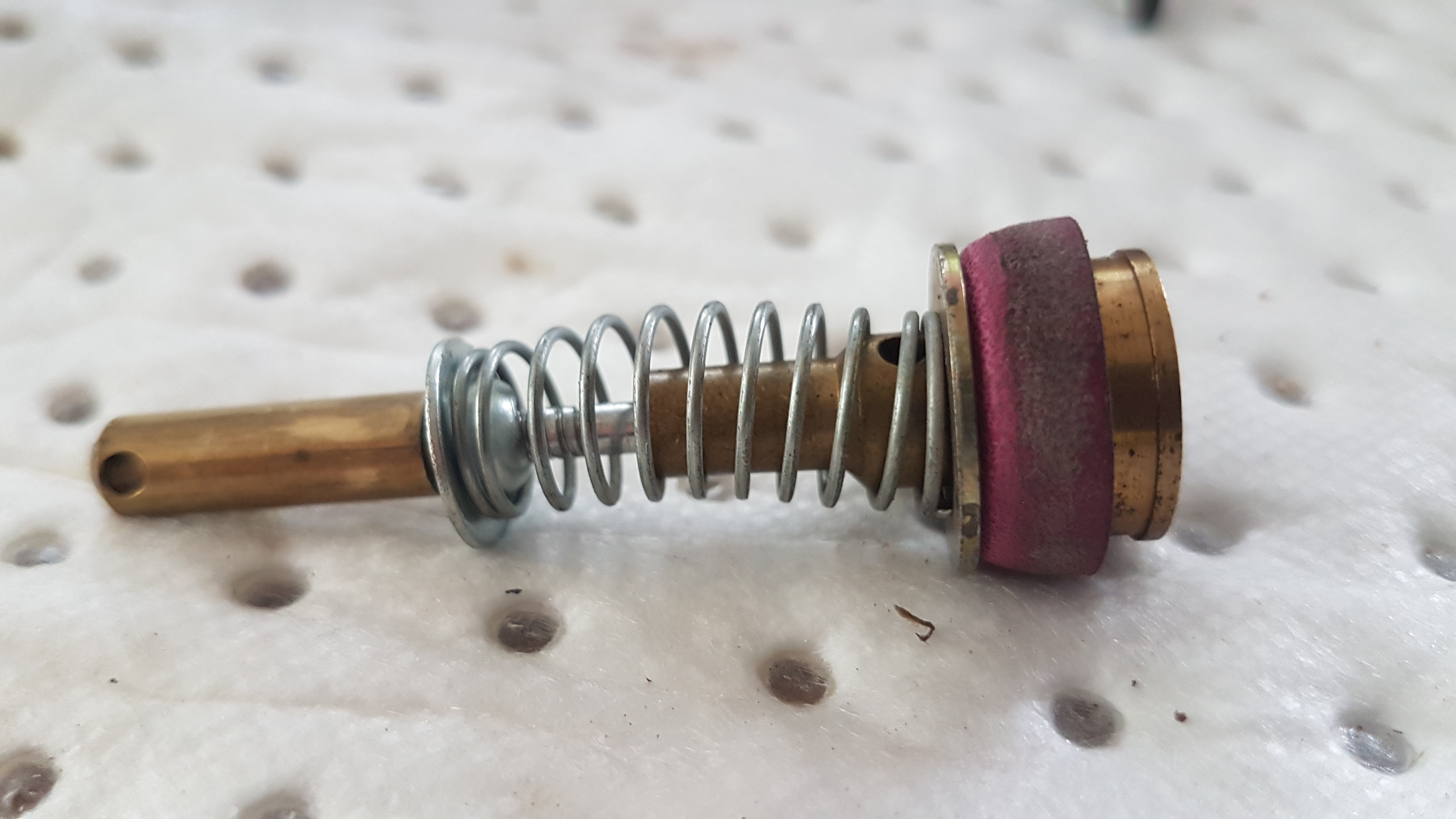

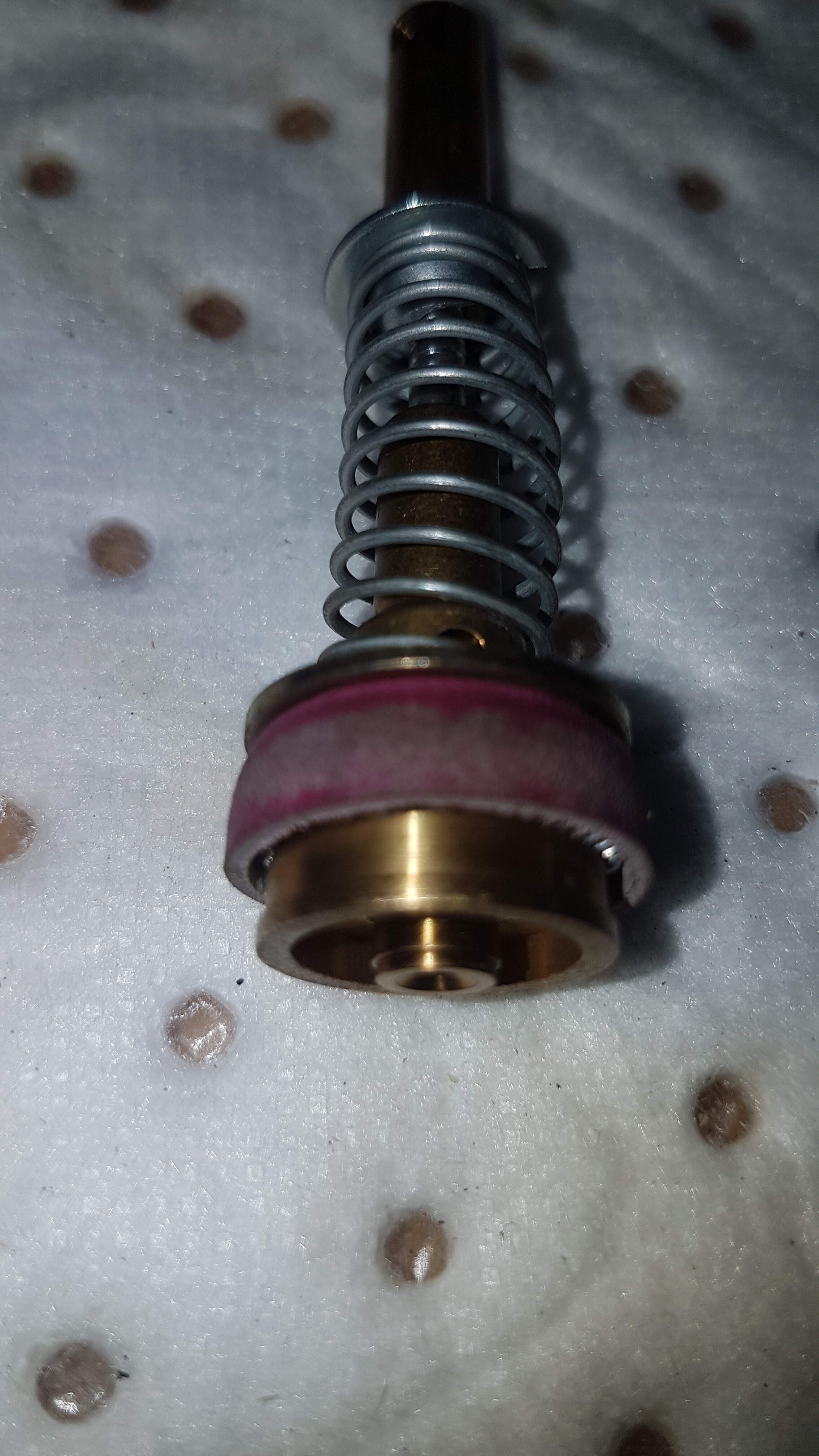

Right from when you and I rebuilt our carbs I wasn’t 100% happy with the power of the squirt. That plunger in the picture has been sitting in oil for months now and I will try it in the carter . If it doesn’t improve the acceleration on my worn old 389 I am justA going to buy a brand new edlebrock carb.

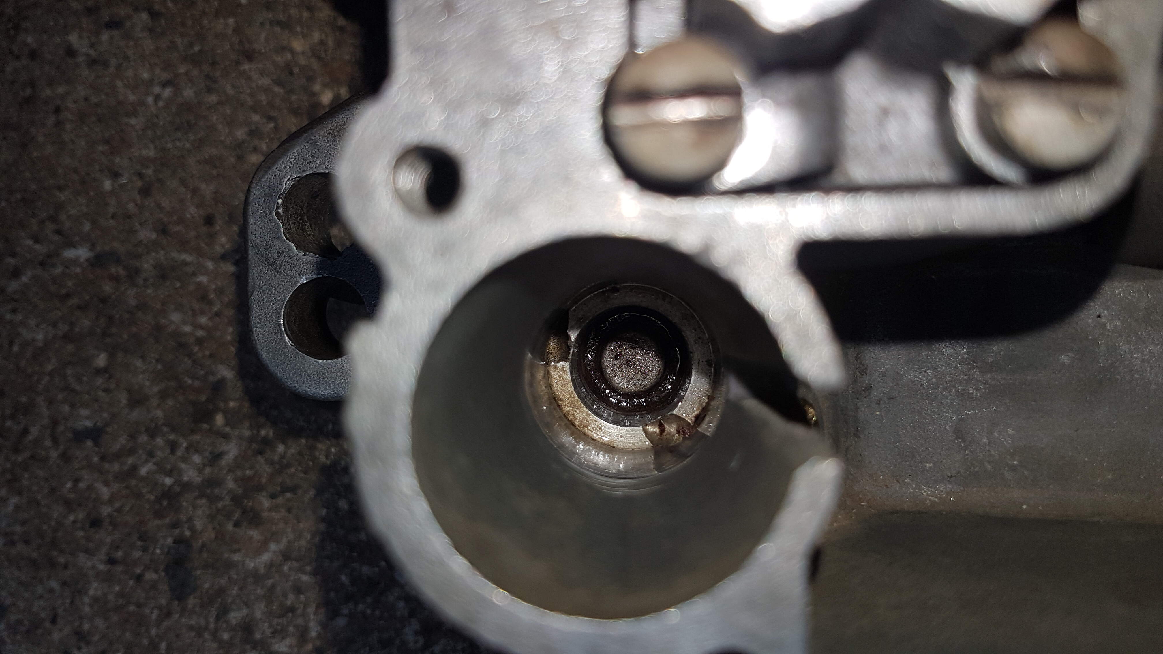

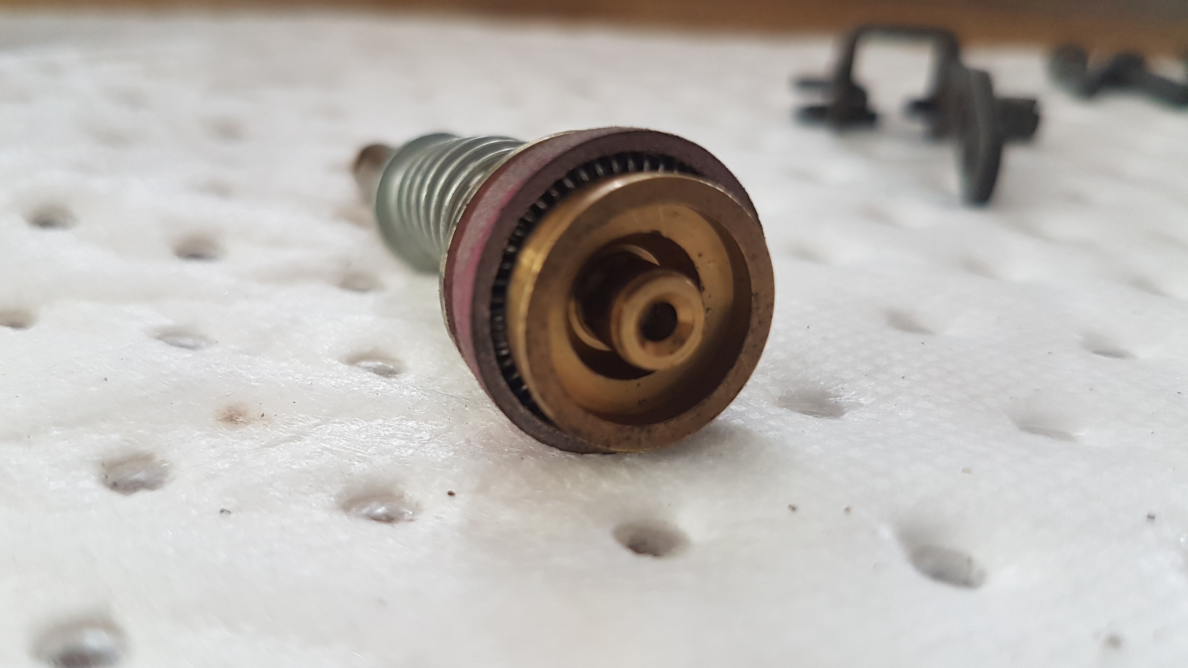

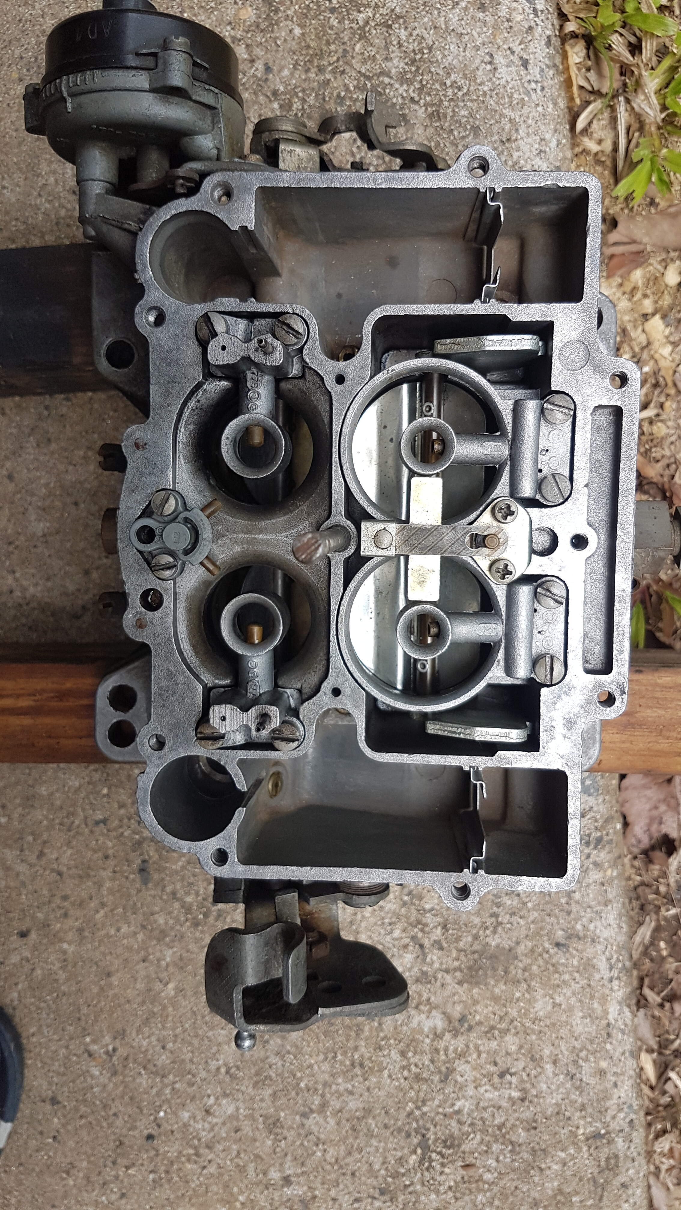

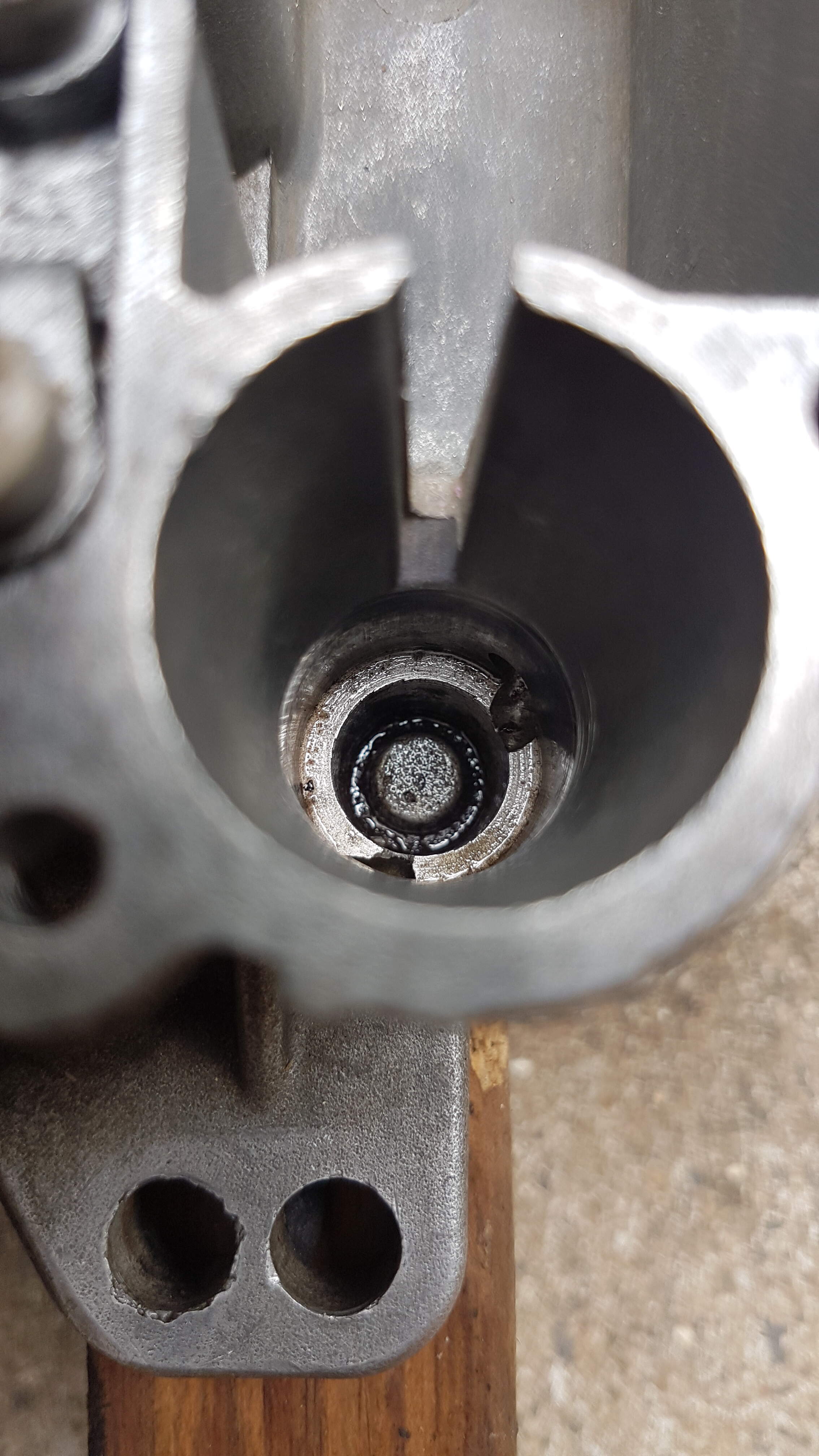

Welcome to Forever Carter. I took carb off the car in order to drain it and thoroughly dry it out prior to packing & sending it, possibly on Monday. I opened the throttle once more and this time the discharge looked healthy! I couldn't help myself: I removed the top cover and inspected the accelerator pump plunger and bore. The bore is smooth and the taper is still there, but the plunger didn't feel tight enough, I thought. You know, a size up plunger could fix everything. I inspected the plunger material and it appears to be leather - see pics. I soaked the plunger in oil for about 30 mins and pushed it into it's bore. I daresay it now probably seals better,  but surely being immersed in petrol will soon get rid of the oil. Whatever: carb is being sent away. Like I said: I'm a backyarder and the carb experts might find all sorts of things that are wrong.

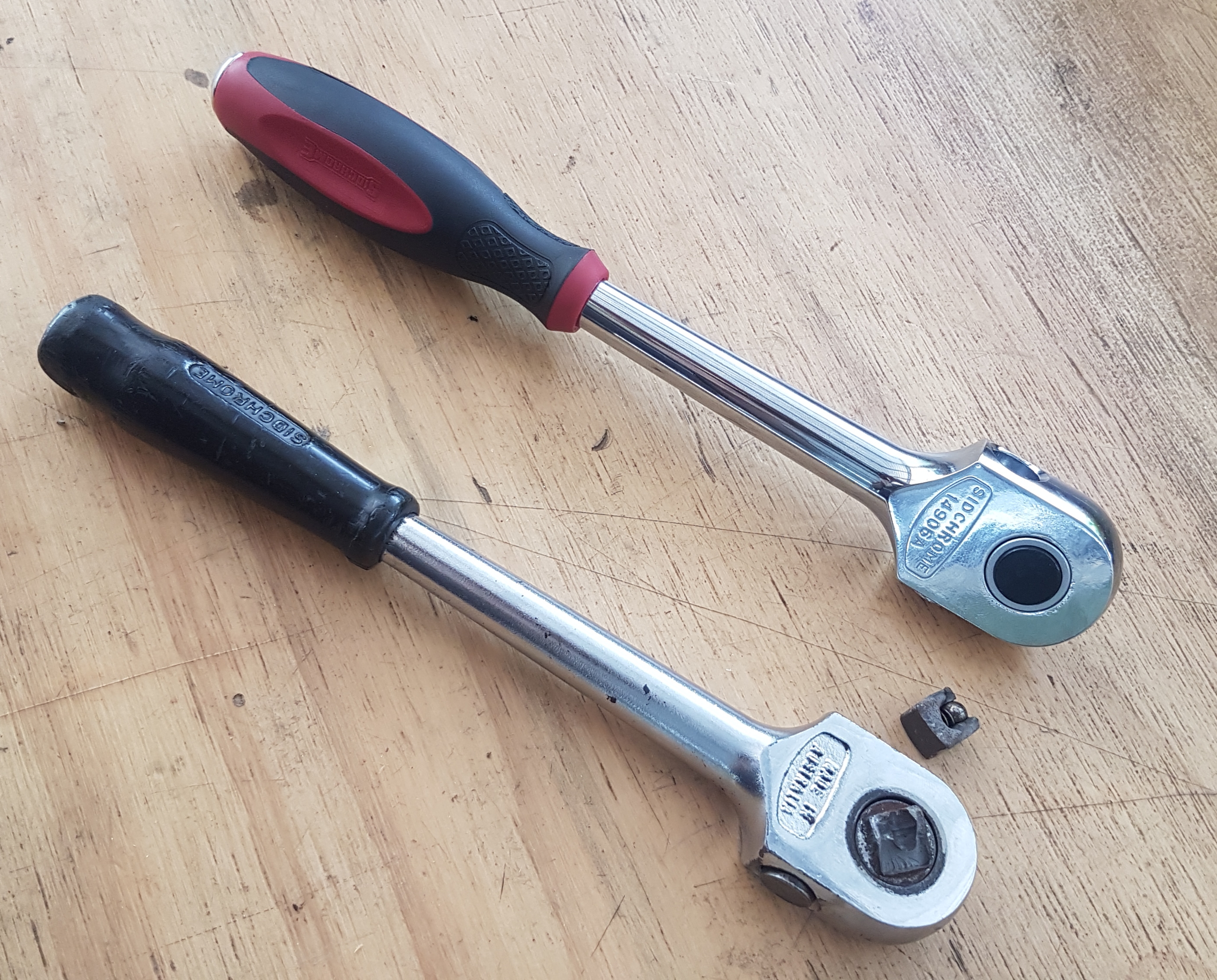

The last pic is of my 40 year old Sidchrome Made In Australia socket wrench. I finally managed to break it. Sidchrome (a famous Australian brand of high quality tools) has always given a lifetime guarantee on it's products. For a laugh, I told them the tool had failed and does the warranty still apply. Can you believe it - they sent me a new replacement. I didn't mention to them the insanely crazy thing I was doing with the wrench when it broke. I was attempting to remove a heavily rusted towball nut and had attached a breaker bar (pipe) over the handle of the wrench and applied some force and 'snap.' I'm pretty sure it was never meant to be abused like that. In desperation, I tried to loosen the nut with my rattle gun - no cigar. I took the offending towball to a tyre place and asked if they would have a go with their rattle gun. The dude comes out to the car with a Miwaukee cordless rattle gun. "That won't even look at it," I thought as I watched him slide the socket over the nut. Within 3 tenths of a second, this incredibly powerful cordless unit had loosened that nut like it was nothing. I'm impressed.

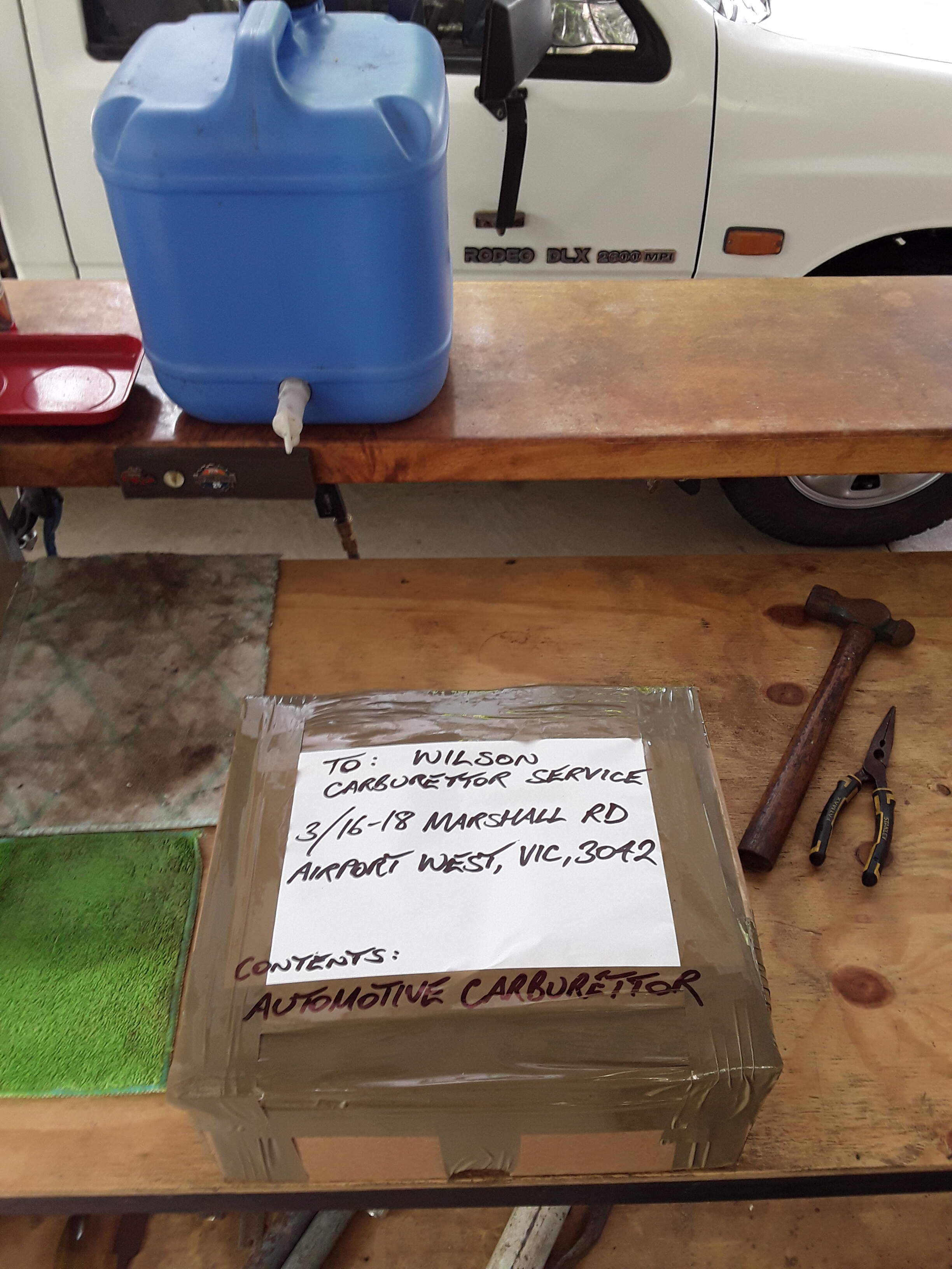

Carby is drained, dried, bagged, padded and in it's box. Let's have a bet on the potential cost of this exercise. I'm going to bet that the cost will be not far off the purchase price of a nice new AVS2!    D'oh!
Here's a pic of the boxed carby - farewell old friend. Come back working properly!
And here's another pic to keep all the EV demons away. Hmm...wait a minute - no carb on an EV...
