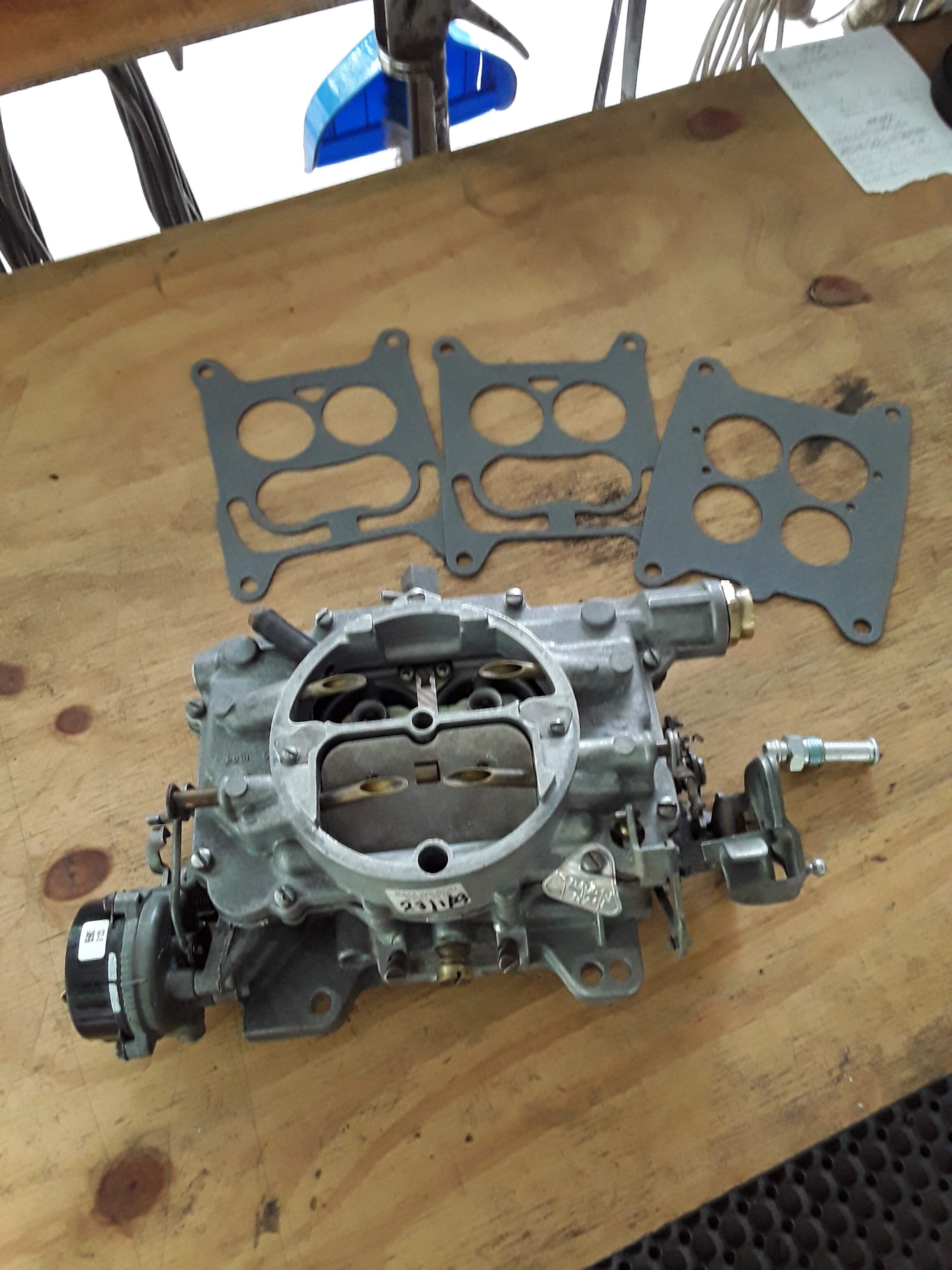

Carb Dude called me: it's finished! They did all sorts of things to it, found plenty of 'issues' AND I'm pleased to report that as part of the service they provide, they have a 'test' motor that every carb (or set of carbs) is bolted to after being rebuilt to guarantee that everything will work. In other words, it's been run tested. For the $816 they charged me, I expect it to be plated in 24k gold with diamond encrusted float bowls and unobtainium extruded butterflies.
He said that the auto choke didn't work. I patiently explained to him (several times) that I have ALWAYS disconnected any auto choke because I don't like the thought of an excessively rich mixture being fed into a cold engine. My cars always start without a choke (a full pump on the throttle is enough to prime the engine to start) and I am happy to let it idle for a minute or so before tickling it with the throttle to get it moving. Once underway, you just gotta be patient and let it warm up a little. He didn't seem to get the concept so rather than continue trying to convince him to leave it alone, I agreed for them to fit a new choke. I will try it out when it comes home and if I don't like it, I'll disconnect it. Where I live, it doesn't get cold enough to have to worry about it.

Anyway, let's move on. My rebuilt carb came back from Jupiter and I just need time to get under the hood and put it back on. That goddam electric choke is shitting me already - I'm gonna disconnect it. I hate those damn things.
I'll let y'all know how the shakedown run goes. If it's all good, I'll try and convince a friend to take a vid of the car in motion and in full song. It DOES sound good and when running well, it has ample power.

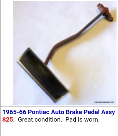

I forgot to add these. I broke down and am in the process of ordering this brake pedal from Frank's. I already have an accelerator pedal from ebay coming. Lotsa dough for 2 bits of stainless trim.
FYI: the pedals on an A body are NOT the same as a B body. Why the hell would GM bother with 2 sizes of pedal? Sure - the cars are a little different, but human feet are more or less the same (broadly speaking,) so why not one set of pedals to cover the range? Whatever. They SHOULD be the last trinkets to attach to the car so as to stop me from laying awake at night wondering why the park brake has the trim, yet the main pedals do not. It's only money. What else was I going to do with it? Take the missus out to dinner? Pfft. I'll cook.
Awww the carb looks nice mate 👍
I look forward to how you think it performs 👍

Good luck with the carb.
An update on pedal trim: like everything else for my particular car, some things are almost impossible to find. I have managed to find an accelerator pedal with trim on ebay and am now having trouble with Frank's Pontiac Parts who are being obstructive & difficult re the brake pedal trim. So I tried another ebay search and would you believe it, found a pair of GM NOS brake pedal trims, so I ordered them. The collective price of the accelerator & brake trims (incl shipping & GST) is going to be almost US$200!
If anyone would like one GM NOS brake pedal trim to suit a B body auto, Fitzy's Pontiac Parts is now in business.
Goodbye Frank. I will never deal with you.

I've seen the trim alone NEW on OPGI.
https://www.opgi.com/interior-accessories/pedal-pads/1964-72-4-speed-brake-clutch-pedal-pads/pad-pedal-1964-72-gm-a-body-brakeclutch-4-speed-drum-pz00013.html
https://www.opgi.com/interior-accessories/pedal-pads/1965-72-parking-brake-pedal-pad-trim-plate/plate-pedal-trim-1965-70-boncat1965-69-gto1965-72-grand-prix-parking-brake-gti0074.html
I'm sure they have it for my GTO.  Depends on pedal size as you said.  Maybe try my buddy Barry @ Sonic motors

JustA - those links you posted are for manual cars, A bodies and the park brake trim. Fullsize autos are different AND inexplicably, my car already has the park brake trim! Anyway, it's all good. I found both and they are on the way.
What does Sonic Motors supply?
Most anything 60's 70's  Pontiac.   Links were to show you they are out there, wasn't gonna spend all day searching. Busy day running around with the wife.

Hey - don't worry. I have done nothing but run around like a headless chook since I woke up on Friday. In spite of all my running around, it rained just about all day today, so it was a good time to pop the hood and bolt the carb back on. I took my time, disconnected the auto choke, double checked everything, got out the syringe and filled both float bowls, replaced the air cleaner, reconnected the battery and thought "this is it." Got in, turned the key and she popped straight into life, even after sitting for 2 months. She idled nicely from dead cold and it seems the carb rebuilder must have set the idling speed & mixture when they run tested it. It was too wet to go for a test drive - I'll give that a shot next Friday.

A day of mixed emotions defines today. Took the car for it's post carb rebuild test drive and it's smooth as silk. Got out on the highway, gave it a little pedal and the same issue: stumbling & missing. I am still convinced it's fuel because you can feel the car wanting to deliver full power but it keeps carrying on, yet it will cruise on a light pedal all day without issue. The only component left that isn't new or rebuilt is the distributor itself. Eliminating a possible faulty ignitor module I removed it and went back to brand new points & condenser. After some fiddling with the timing I took it for another drive and it is much better but still not perfect. What is going on?
I'm now thinking fuel tank or crudded up inline fuel filter. In the past I POR 15ed the inside of the tank and the filter is new, along with the pump. F#$%&d if I know. Where's my beer...?
