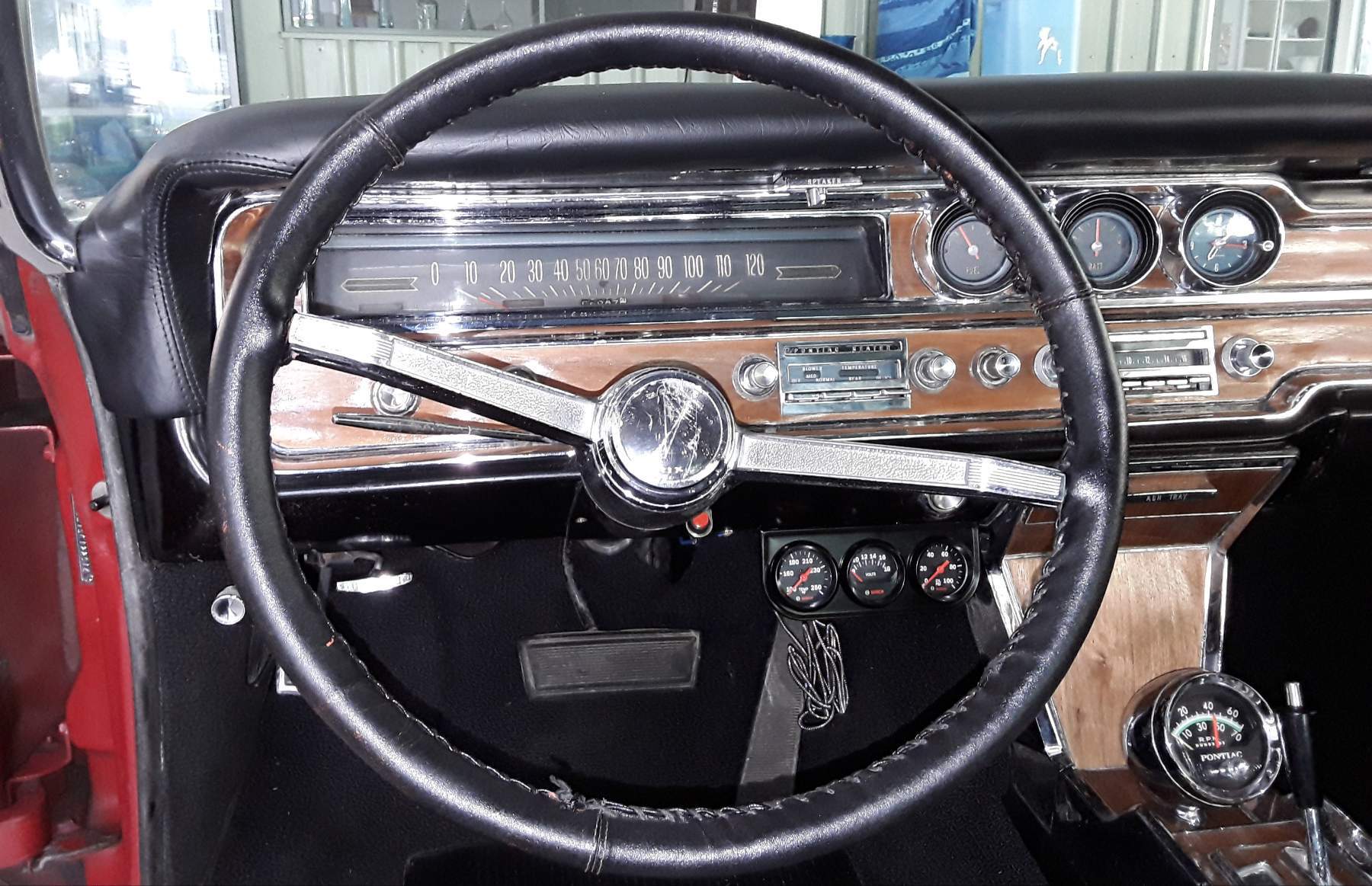

Thanks Wrongway - it was a satisfying drive despite me being a little nervous regarding it's reliability. In fact as I was driving I would occasionally scan the dash for the oil & temp lights and right then & there I felt inspired to install those guages I purchased months ago. Since I have time off work and the car is going nowhere, I shall get that install happening along with the Pertronix ignition this week.

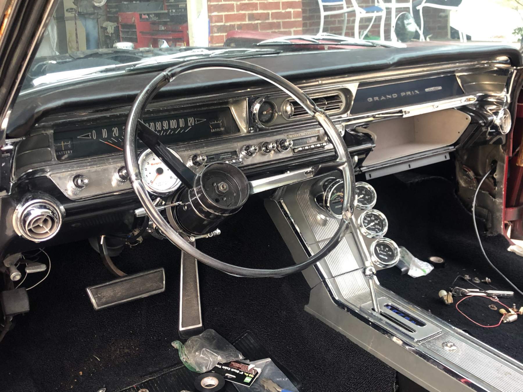

Here's a pic of the guages simply sitting loose in their fascia. As we're all aware, installing anything modern that's visible inside the car is always fraught with danger - you really want to avoid the jarring 'sore thumb' look of a modern addition but I think I pulled it off with these Bosch guages from Amazon - they seem to blend in pretty well.

that looks cool!!!! and chrome:cheers: i like that looks factory
They DO look good, especially being chrome.

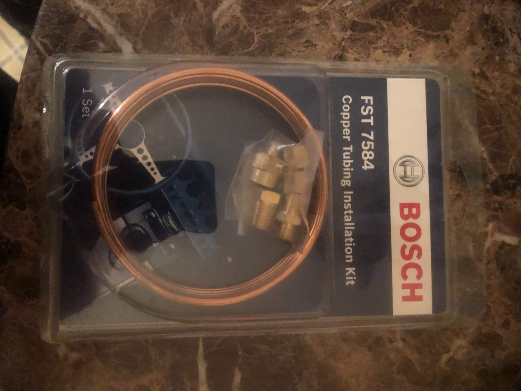

Wrongway, can I ask how you went about fitting the oil & temp lines to the engine? I'm assuming they are mechanical gauges (like mine.) I want to retain the temp & oil lights in addition to fitting the gauges. Now, I see there's an adapter that lets you plug both into the oil filter housing - that seems straightforward, but what about the temp? There's lots of talk about using an adapter that plugs into your radiator hose. The gauge's sensor needs to be immersed in the flow of coolant, so using a threaded adapter for the inlet manifold doesn't seem to be the way to go. What did you do?

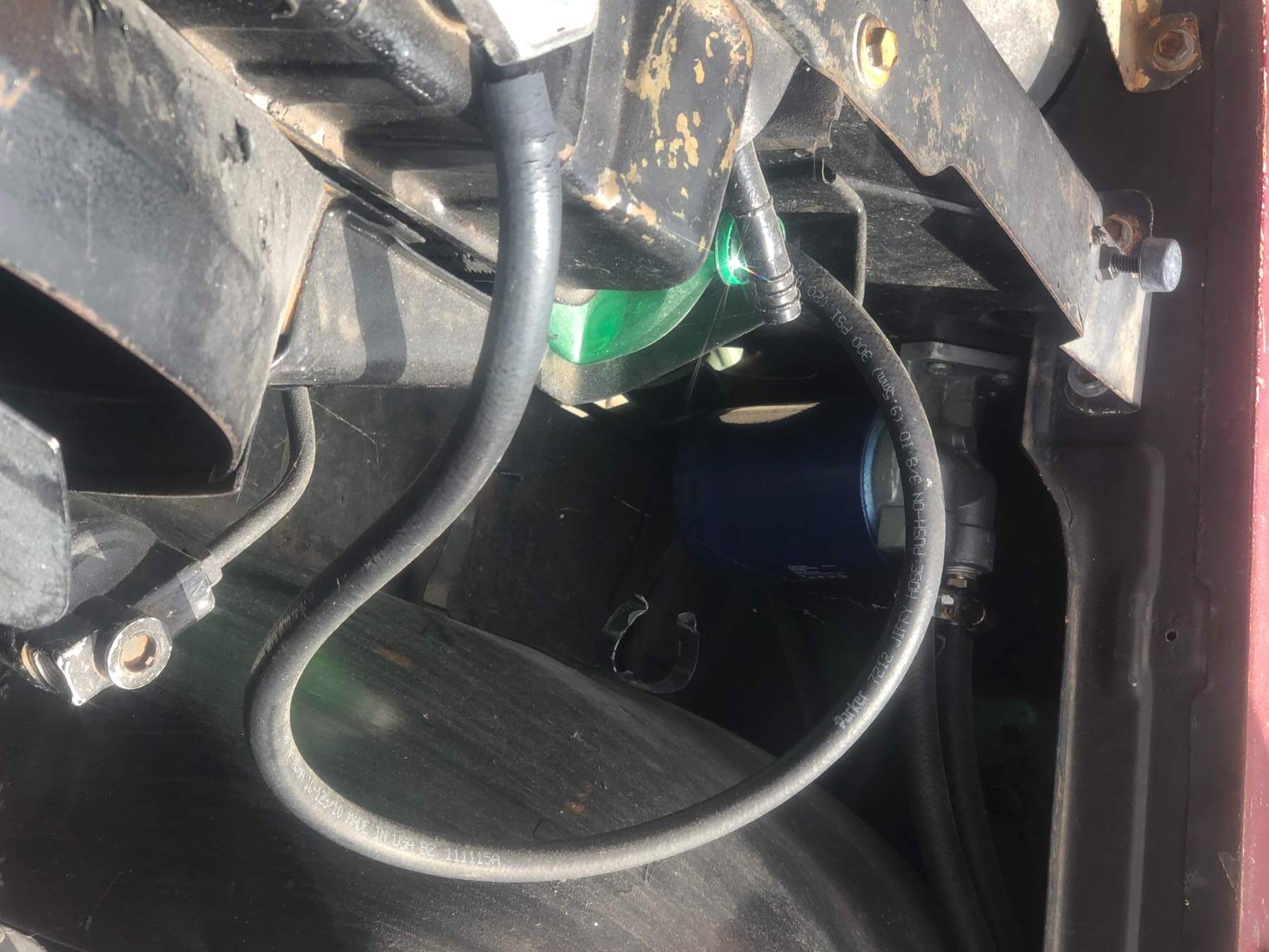

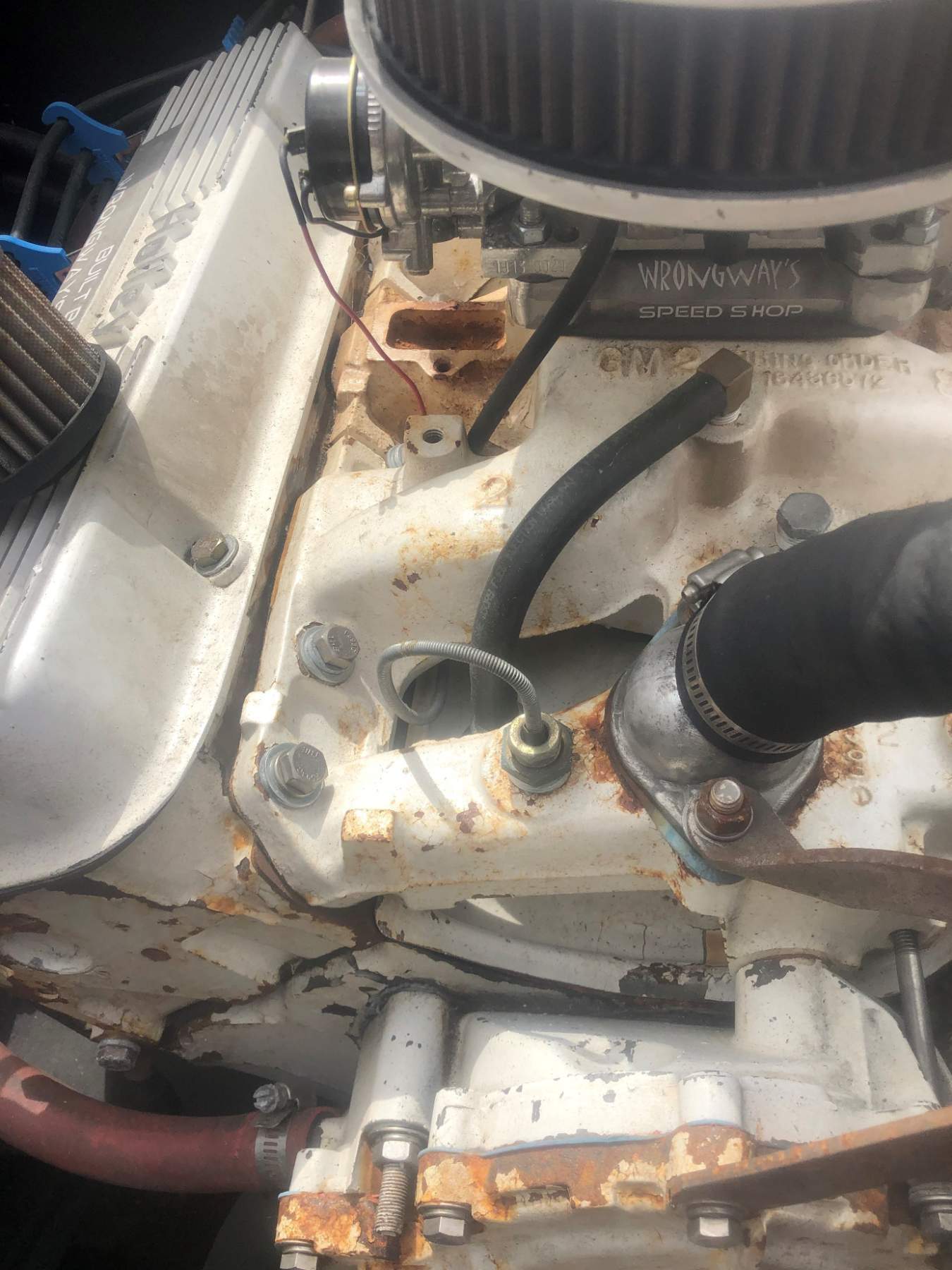

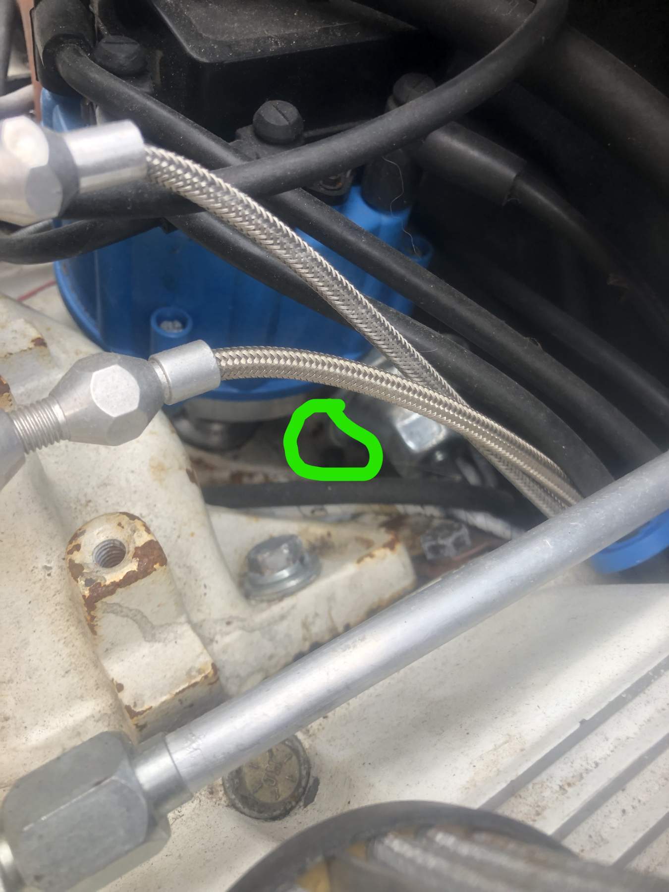

Glad you guys like them. So for the oil line I ran through a grommet in the firewall and to the pad that the distributor sits on. Next to the hole that the distributor goes in there is a plug for an oil line. The fitting that come with the gauge threads in perfect. I'm sure you also know this, I personally would not use the plastic line that comes with the oil gauge. I had a custom S10 years again with A-pillar gauges and the plastic line popped on me while driving. Sprayed oil all over the windshield. Justa mess, since then I always use the copper upgrade line. It's hard to see where the line goes in but it's right in the area of the circle.

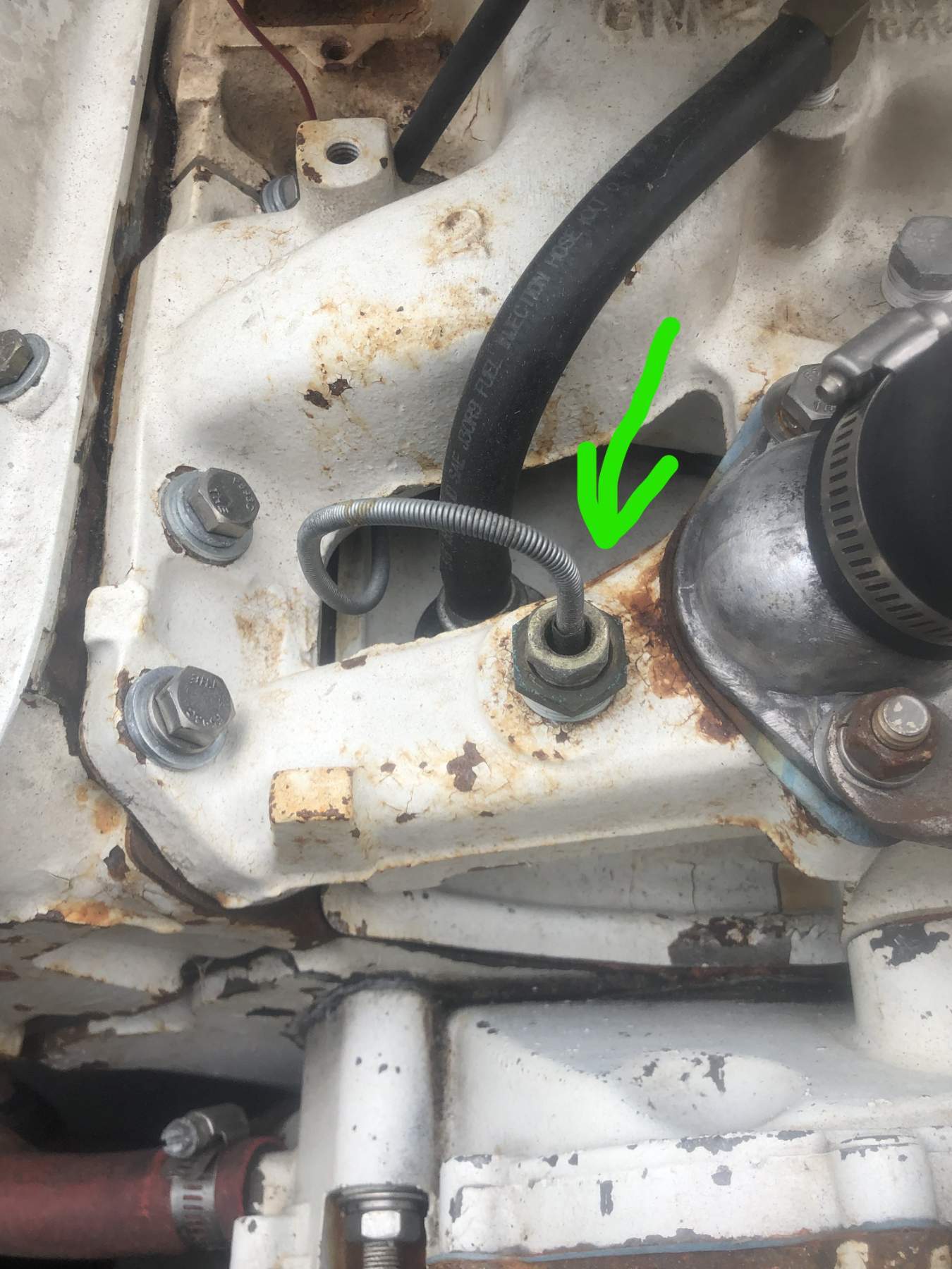

For the temp, again I went through the grommet and under the intake to the front of the engine and plugged into a temp bung. On this intake there is a bung on each side off this intake.

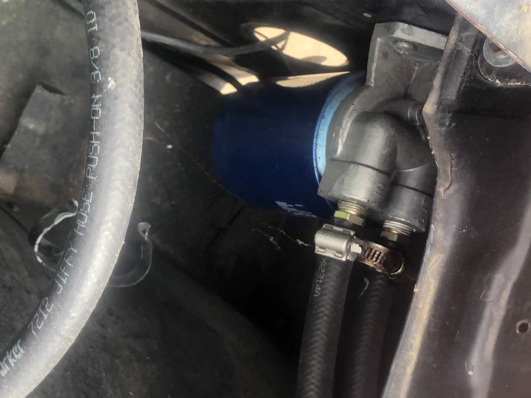

As far as an adapter. I actually used one until I installed my headers. With the headers on this engine I had no room for an oil filter. So I have a filter relocation kit on the car. At that time I moved the oil gauge line to the distributor pan for a cleaner look.
As you can see the engine paint didn't hold up, guess I'll be redoing that when I paint the car.

Perfect - thanks for going to all that effort. On my own engine, I simply use the shorter oil filter replacement to clear the headers. The dizzy pad sounds like a great option and unfortunately I don't have an extra temp bung on the inlet. I saw online that some companies make water necks with a bung just for that purpose, but not for my engine.
I looked at that skinny supplied nylon tubing and wondered do they really expect hot pressurised engine oil to keep getting pushed into that and for it to last? I guess that's why the gauge set was well priced. Where do I source the upgraded copper tubing?
Hot engine oil all over the windscreen! Hilarious to all observers except for the bloke inside the car trying to steer!

Agreed bro. Running along as happy as could be about 85mph and pop! It got exciting for a few min. This is the tubing kit I buy bro, it comes with the needed fittings. I buy them at my local auto parts store but ebay, amazon or justa about anyplace should carry them bro.

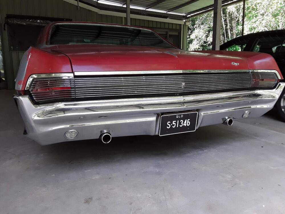

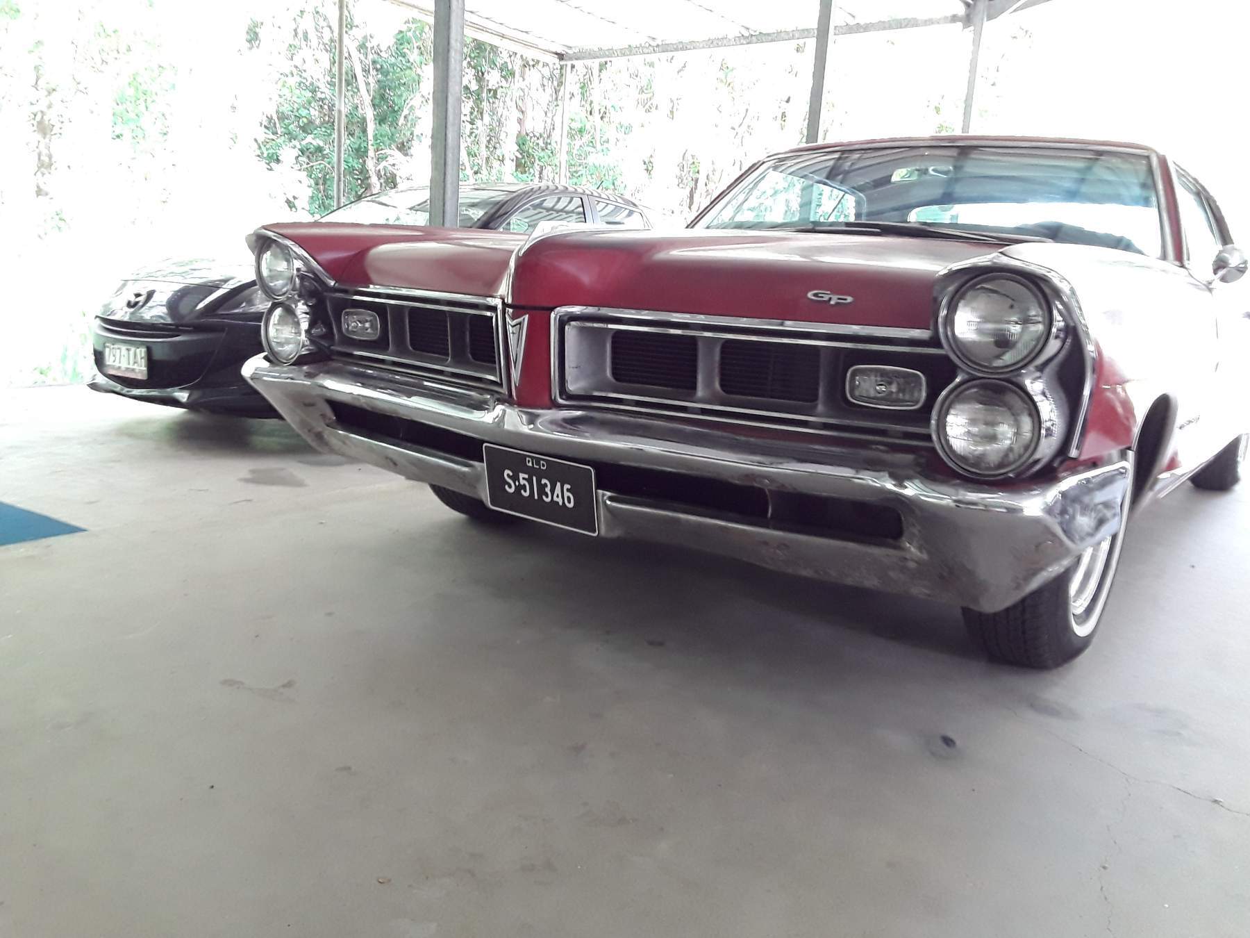

So, what did I do to the GP today? Oh, not much. I just toddled around and GOT IT REGISTERED!!!
Good Gravy - what an ordeal it has been. After being fed the wrong information, getting stooged by the engineer who never showed up and being put on a merry go round by the Dept Of Infrastructure, I'm laying in bed early one morning (my favourite time to worry about shit) and decide to forget trying to get the thing fully registered - instead I'll try for concessional Special Interest Vehicle registration. I'm sure this system must exist in other countries too. It's where for a fraction of full registration price, the car is fitted with special numberplates and is restricted as to how it's used. So, to be eligible you need to be a member of a bona fide car club and the car can be driven to sanctioned club events, or to a workshop to be fixed or can be driven within a 15km radius of it's garaged address for 'road testing.' With the price of 98 octane at about $2.50 a litre, this will do me fine. I'm gonna 'road test' the shit out of it! Of course, the way around it is to join several local clubs, see what they're up to on the weekend and then pretend to drive to one of their events, or if I think it's worth it, actually turn up. I'm only home 7 out of 14 days anyway, so this will be perfect.
All I needed was an application form, proof of club membership, the Safety Certificate and proof of purchase. The girl at the Cairns branch of Qld Transport had it sorted in 15 mins and I walked outa there with those plates in my hand and a grin you couldn't punch off. No engineer required. No Australian Design Rules to abide by. Don't have to wear a seatbelt (but of course, I will) flashing stop lights as rear indicators are good, no brake or other engineering upgrades required. They even gave me US sized numberplates to suit the car. I put the fender skirts back on, attached the plates and took it for a 'road test.'
It's DONE. Beer me up, Scotty. Who's a happy little Vegemite? I am.
