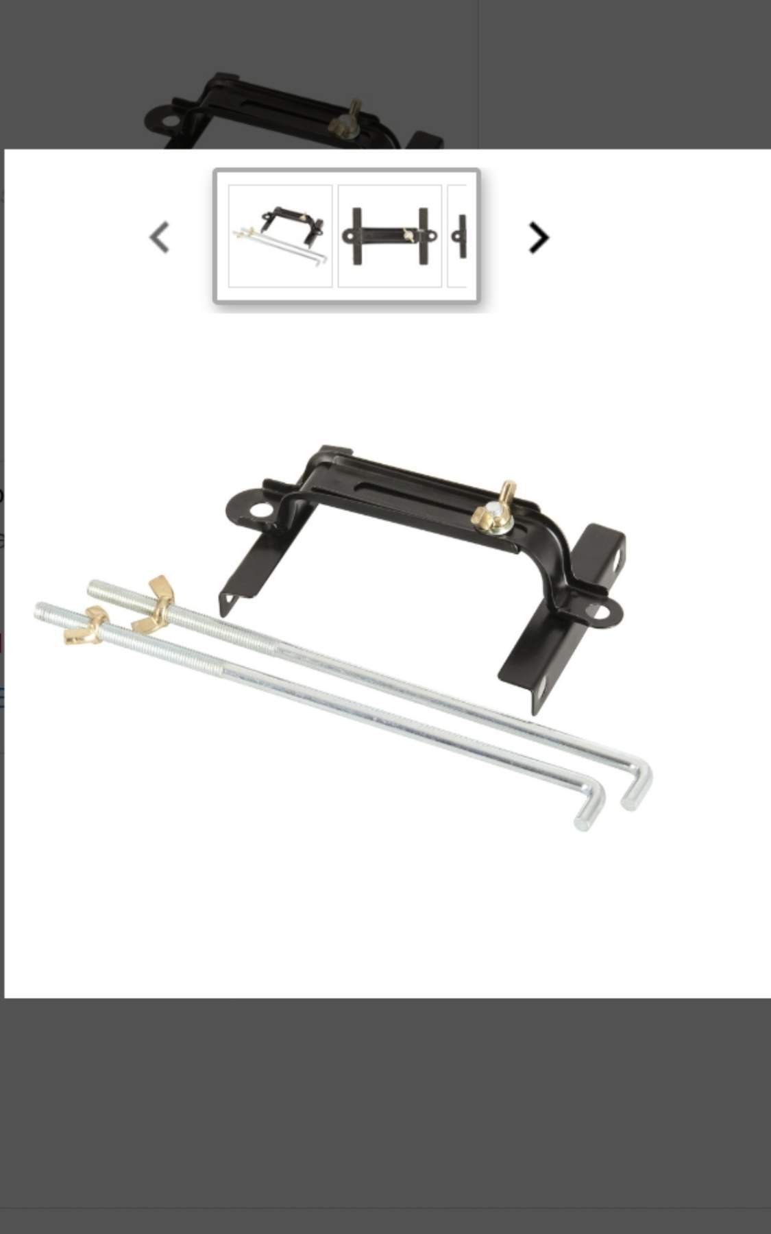

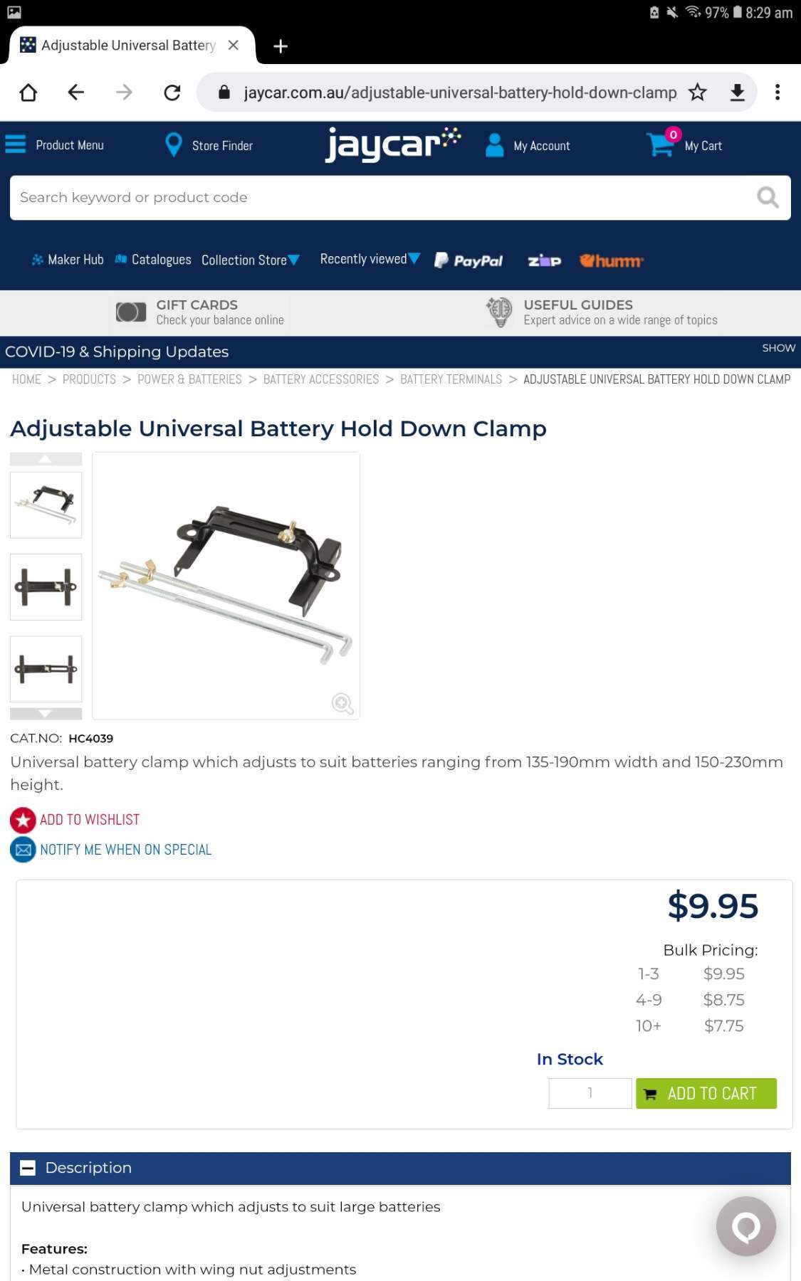

Hey Kiwi - I forgot to mention that I purchased a cheapie generic adjustable battery hold down from Jaycar (cheaper than Supercheap) and simply drilled a hole in the tray nearest the front of the car and drilled out the threaded hole that sits inboard. The first hole ended up being really shallow as there was sheetmetal under there, but no problem: just insert the hooked rod in there and gently prise up until the rod sits correctly. You need to slightly enlarge that inboard factory threaded hole but when you do, the other hook will slide in there. Because the top is adjustable, it's then easy to complete the installation. Battery held down.
Nice mate !!! It’s call the kis !!! Keep it simple 🍻🍻🍻🍻🍻
Fitzy do you have a picture of the battery clamp ?

Here it's KISS it....keep it simple stupid.:rofl:
Kiwi - here you go. Half the price of Supercheap for exactly the same item.

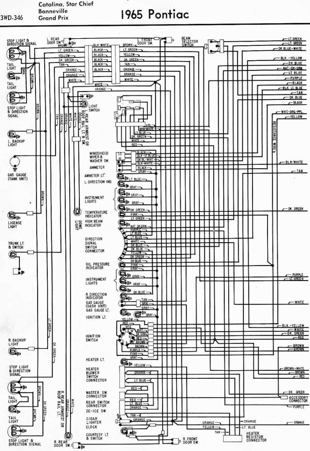

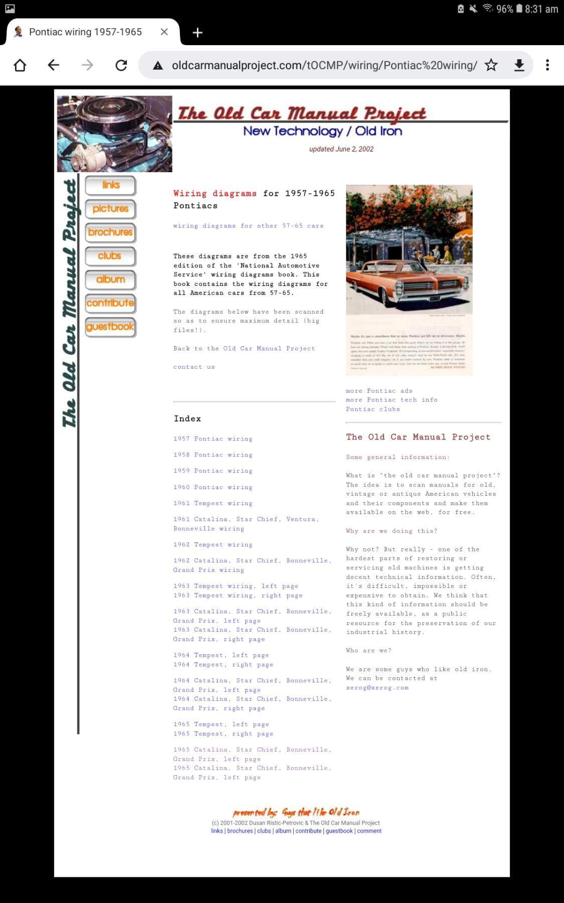

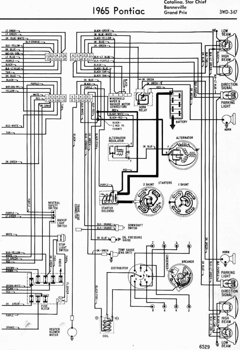

Also, check out these nice clear wiring diagrams. These are the clearest I've found. Obviously, they are for my car but yours are included on the site.
thats a nice clamp !! i will jump on jaycars web site and see if our local shop has them... cheers..
 oh and that wiring web site is the same one i down loaded my diagram from!!! yes very clear and readable for old four eyes here!!!:rofl:

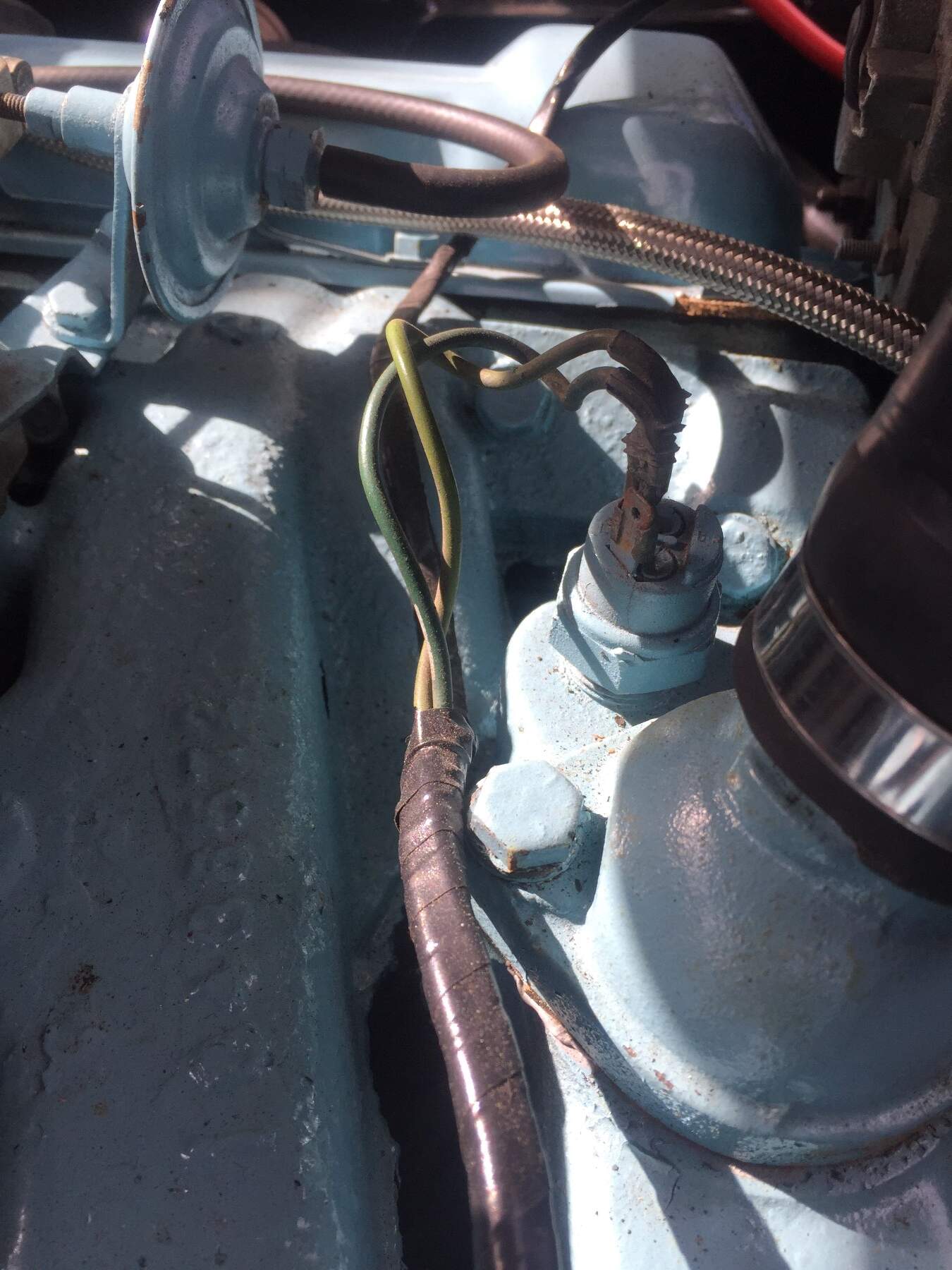

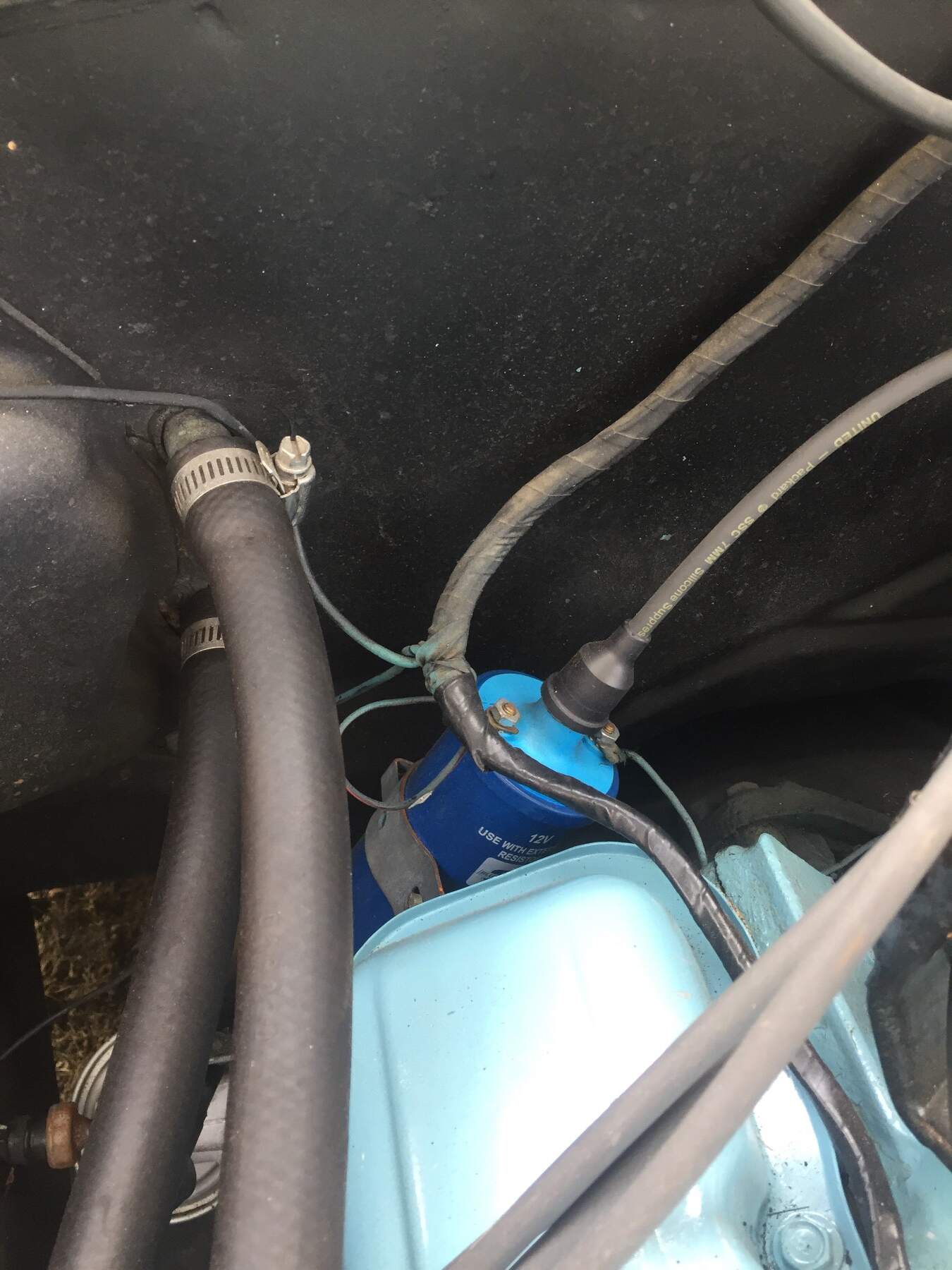

Another question for you: can you have a look at your engine and tell me how many wires feed to your temp sensor? Send us a pic if you would. Mine has only one, and the light only illuminates briefly as engine is cranking. I'm pretty sure it's supposed to light up along with the oil light, to show that they are both working, so I'm guessing there's a wire missing. Thanks.
one moment please :rofl:
Here ya go mate
light green and dark green wires and they come from the loom on the firewall by the coil
This loom has the 2 wires for the temp sender and 2 wires for the alternator in it
Hope this helps mate 👍👍👍👍
Thanks Kiwi. That's a totally different set up to mine. I see you have two wires going to a single contact on the sensor, even though there's another contact. Tell me, when you turn the ignition on, do both oil & temp lights illuminate, then when you start it, they both go out?

its monday here tomorrow mate and i have 3 customers to do emergency work for and when i am finished i will report back :cheers:

mate do you have a cold light that lights up when you fire the 65?
64 Bonneville's have a cold light and circuit to that temp switch that turns off once the engine is up to temp, then a second circuit with a red hot light when its over temp
Fitzy, got all my work done and jumped in the 64, turn the key to the on position, i have a cold light and oil pressure light, turn the key to start and the hot light momentary lights and disappears.hope that helps :) have been painting with no success, and pulled the front off the timing cover to fix my oil leak :cheers:... i dont know how you live in this bloody heat!! another 36c day here and its justA too much for me !! give me andys soCal 5c any day!!!
Thanks Kiwi. My GP doesn't have any cold or hot lights, just one orange 'temp' light. Never mind - I'll fiddle with it later on - back at work today.

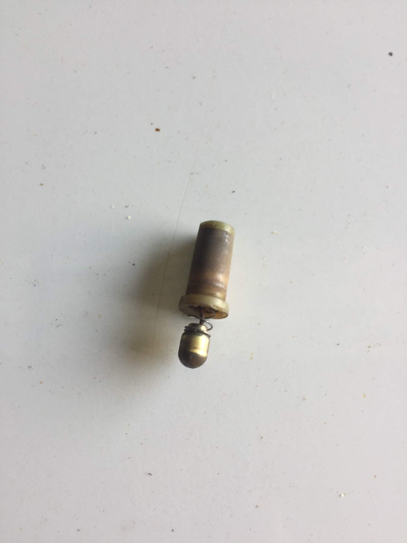

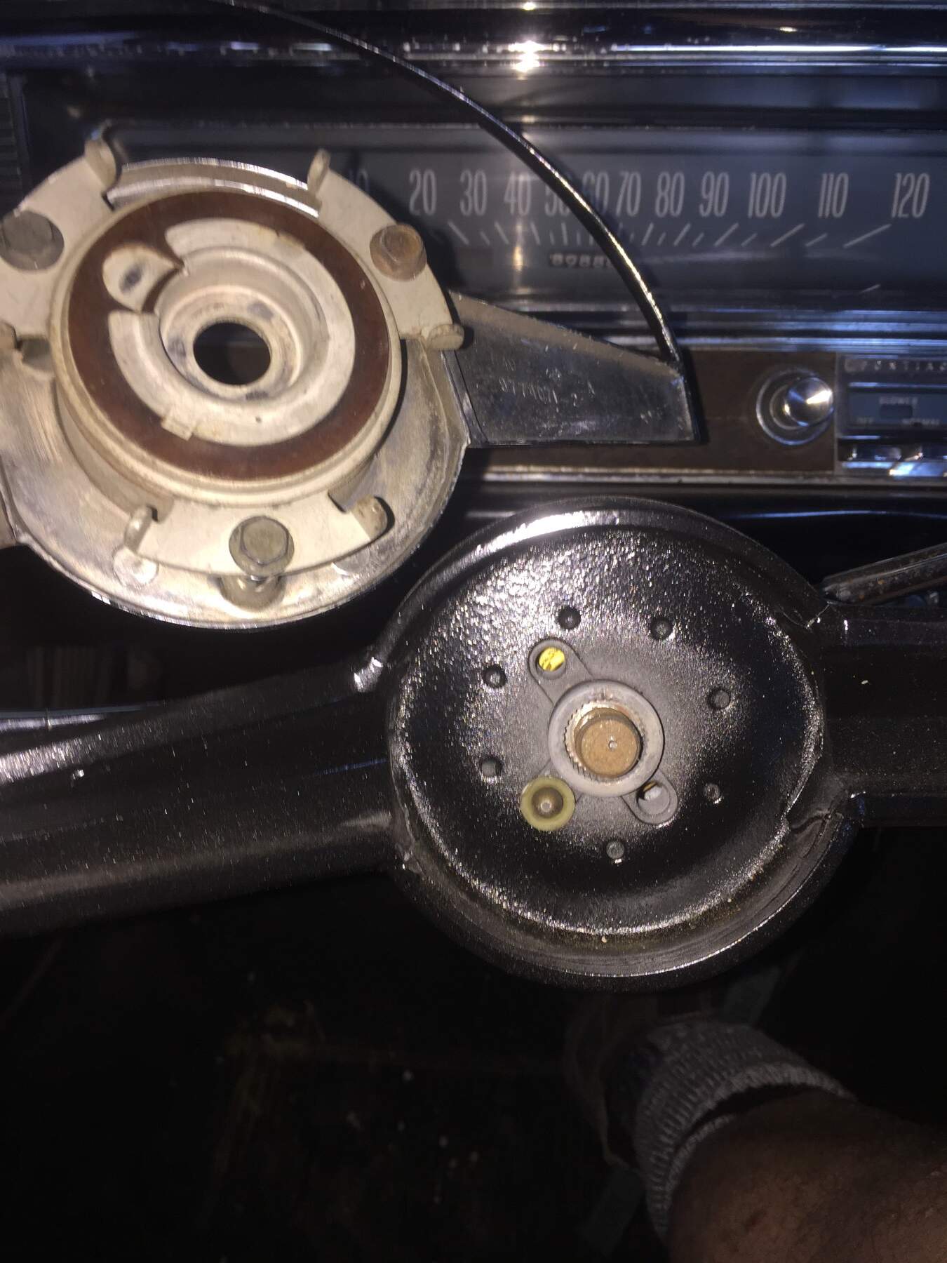

shit mate ! i took these pictures of mine 2 days ago and for got to post them !!!
i pulled my horn ring off, as i could not remember what was under there .... it was nearly 2 years ago that i restored that wheel!! :rofl:
all there is mate on my one is the contact ring and a button with a spring under it to maintain contact with the upper chrome section...if you know what i mean !!
that little button drops into a hole in the wheel itself.
 as far as horn buttons are concerned here in nz, its justA gotA be a button that you can reach, as you have said... so if its a no go on the ring justA gab a button and stick it in the lower dash.... your only ever going to use it to scare chicks on the side of the road :rofl:

thats it mate, all thats under my horn ring is that little button with a spring in it, there no other springs, and it works
