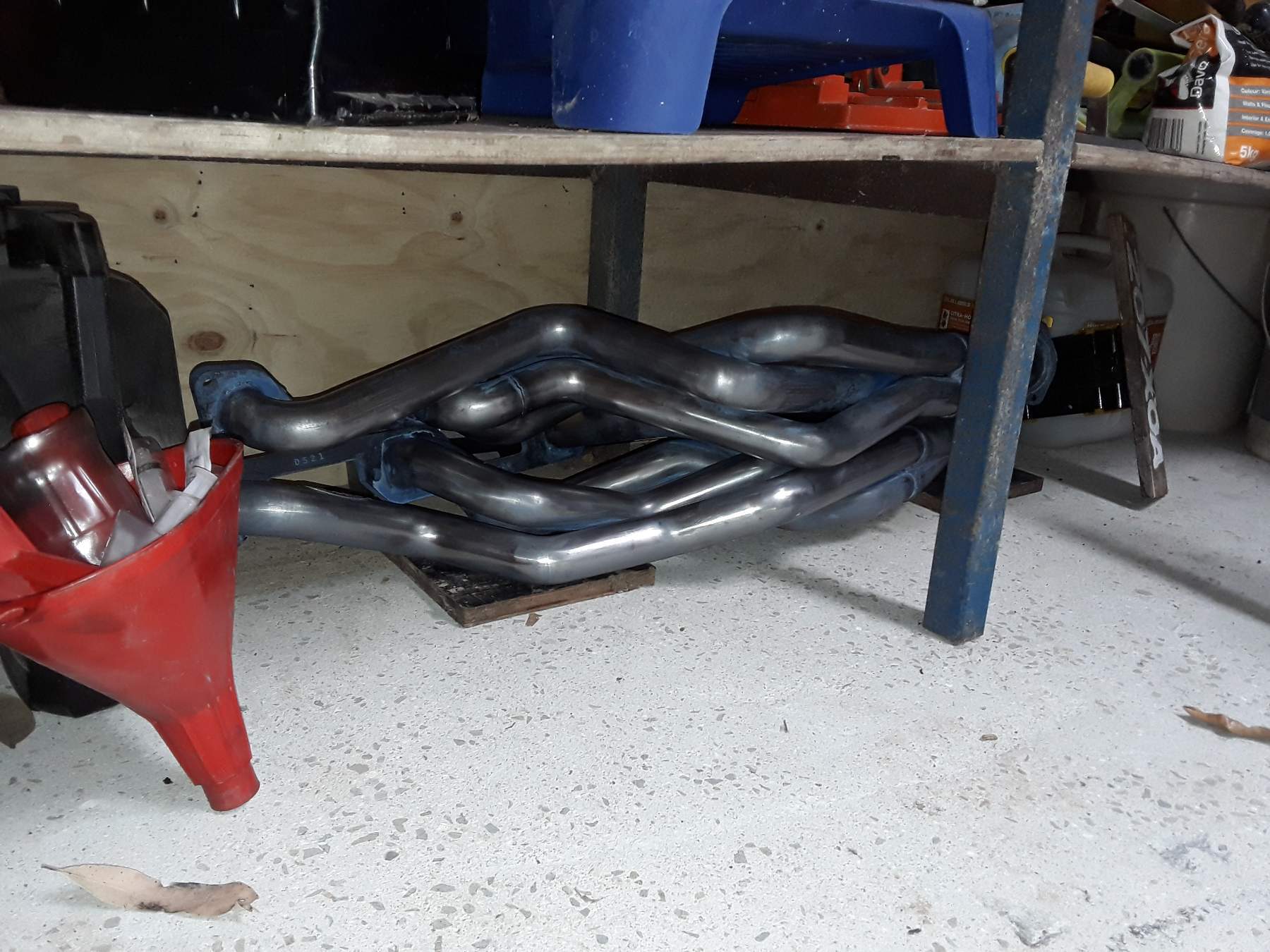

Today, I sighed heavily and dragged my headers outa the shed and took all that lurid blue paint off. I'm going to clear coat them and that's good enough. I left the slightest tinge of blue on them, so they might end up with a weird looking sort of factory hue.

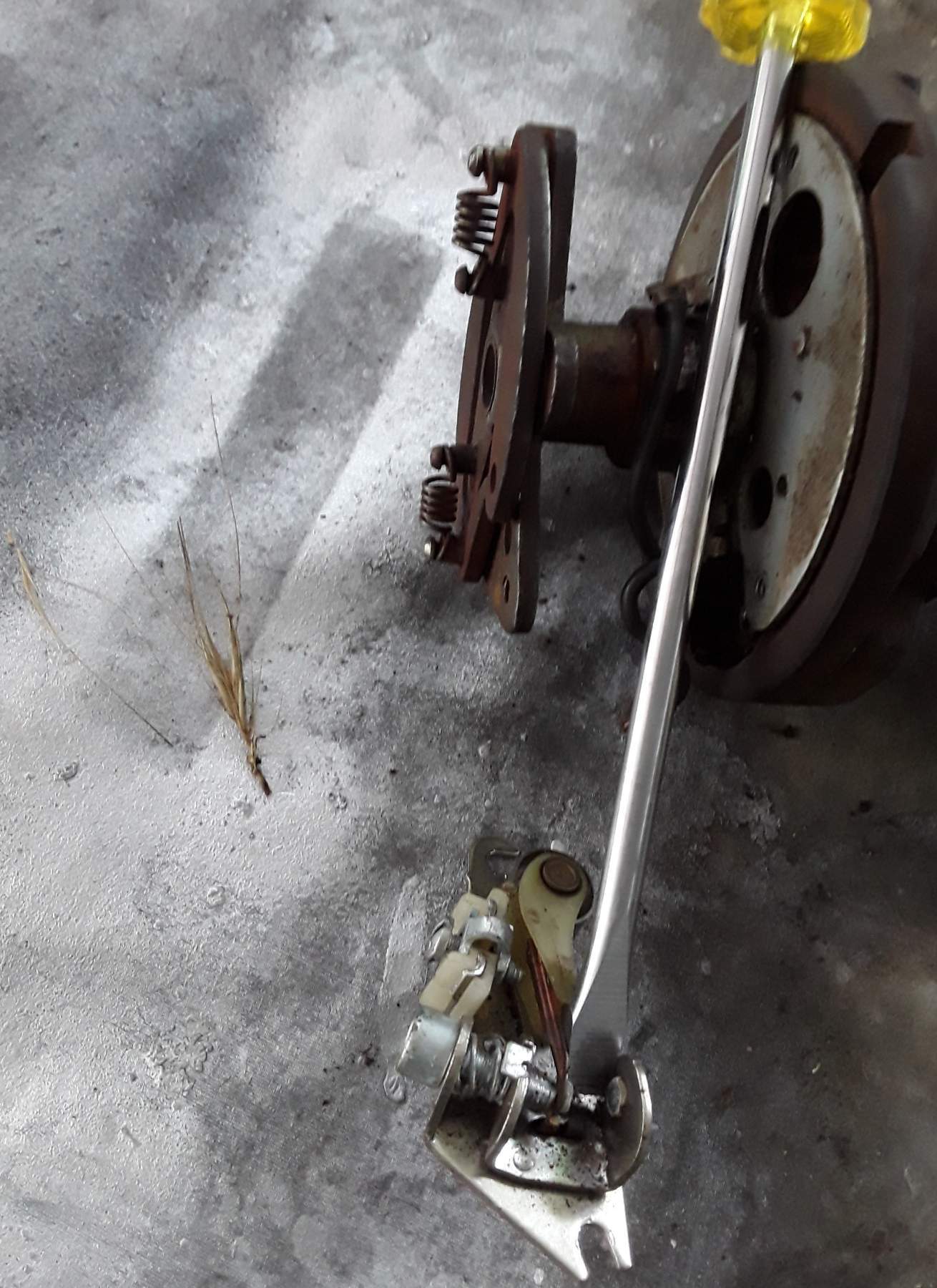

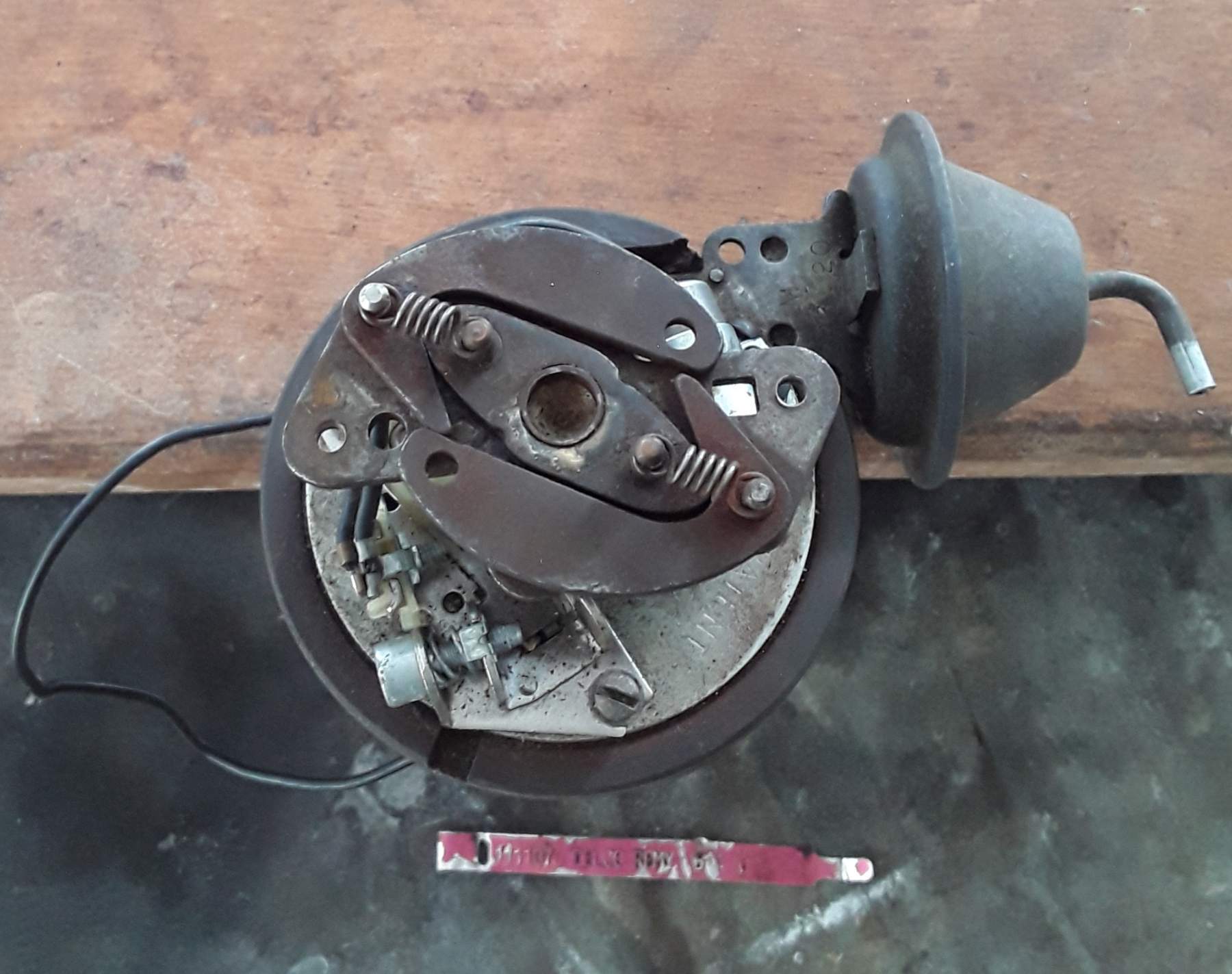

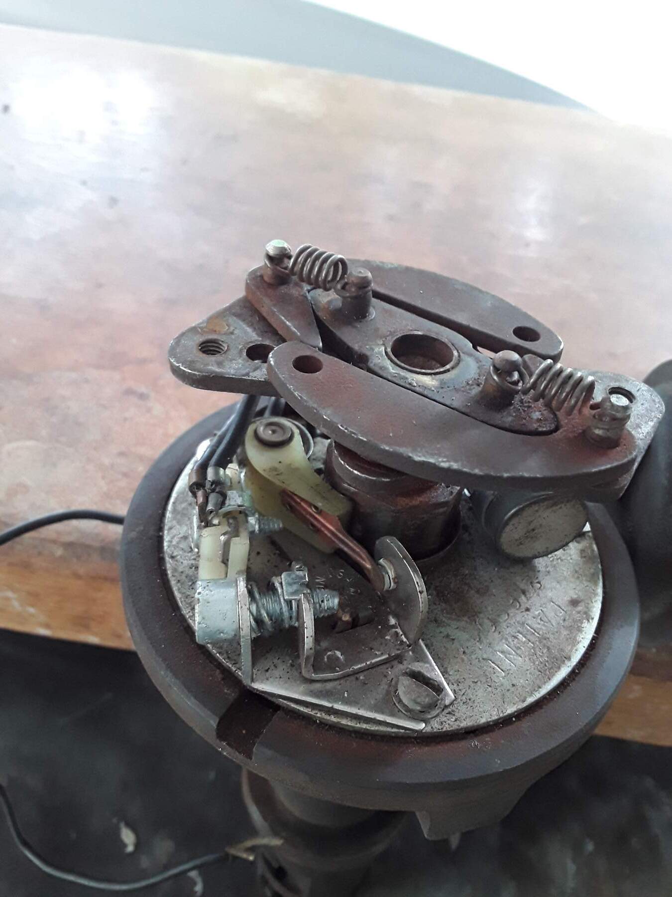

Old MacDonald had a farm. I know this, because I found most of it inside my distributor. I keep banging on about my car being stored in what I assume was a barn, because I keep finding grass seeds everywhere. That particular seed in the pic, along with other detritus was wedged under the points plate! You tell me how the f@#k that got in there??? Dizzy looks to be in good nick - no excessive play anywhere, weights move freely and vac advance unit diaphragm is intact. The points were toast, though. Once cleaned up, I'll fit my new points, condenser, rotor, cap & leads.
I might rebuild the Carter tomorrow. Unlike Kiwi, I'm going to remove Satan's horsepower reducing device and will shred tyres whilst idling.
Edited by Fitzy
Double up on photo
I suspect barn critters like mice, rats, chipmunks, and other little wee beasties (as my Scottish aunt would call them) deposited them there over time. Bloody rude of them, don't you think? :angry:

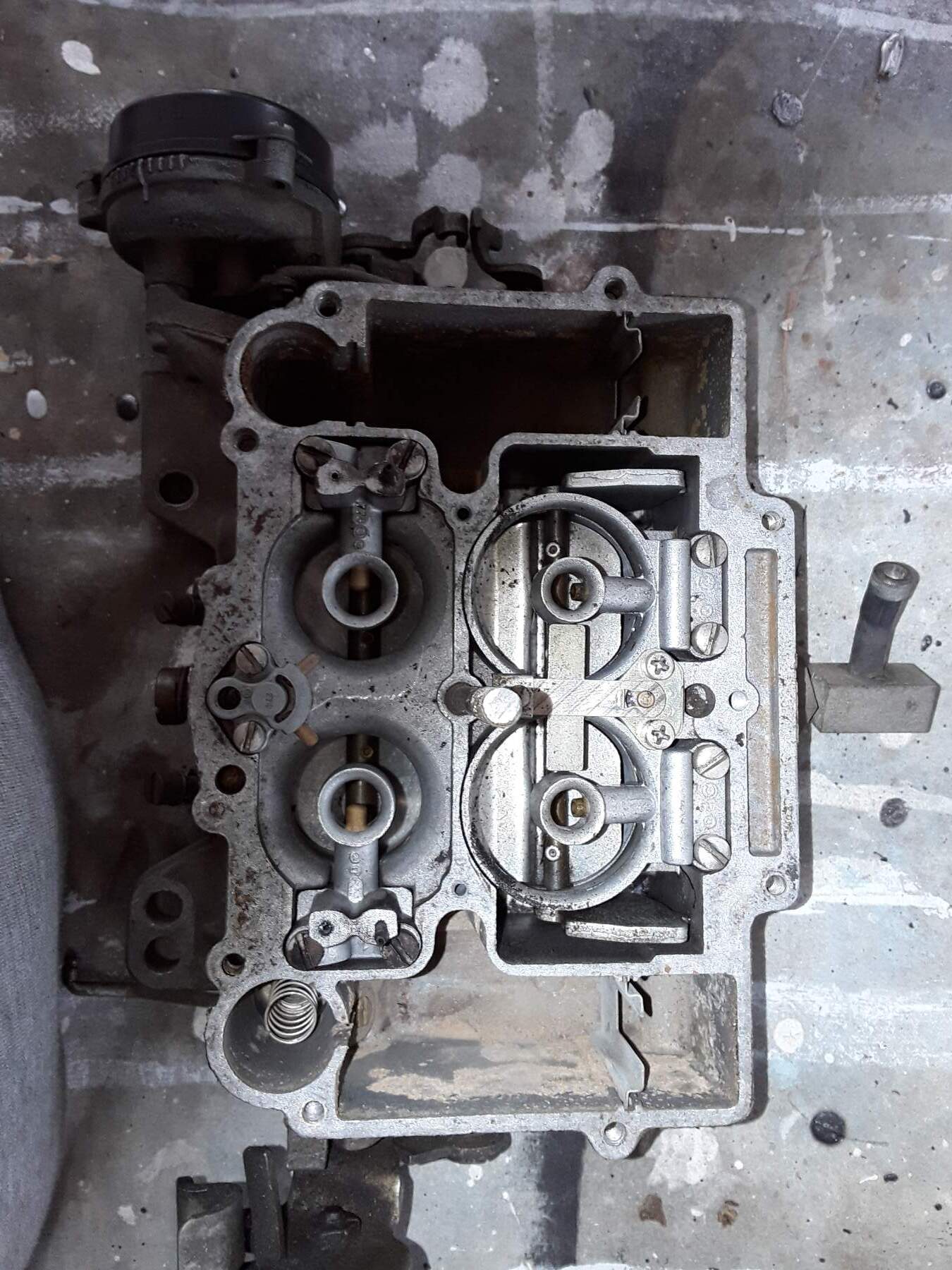

Today I kept ploughing through the distributor rebuild and made a start on the Carter AFB. It's exhausting keeping track of all those little bits. The first time I inverted the top half, a needle fell out. I couldn't work out where it came from, so found an exploded diagram online which made it easy to replace, which got me thinking what life was like pre internet. I would have had to call a carby repair shop and ask nicely for info. How easy things are now, in this respect, anyway.
The thing was filthy - have a look at the float chambers: full of encrusted um, something. Anyway, it's currently pulled apart and I've liberally coated it in carby cleaner, doused the exterior with kero and filled the float chambers with thinners, so it's almost guaranteed to burst into flames once the engine fires up. I'm confident that the dizzy & carby will be done & dusted by the end of tomorrow AND will be sparkling clean inside & out.
