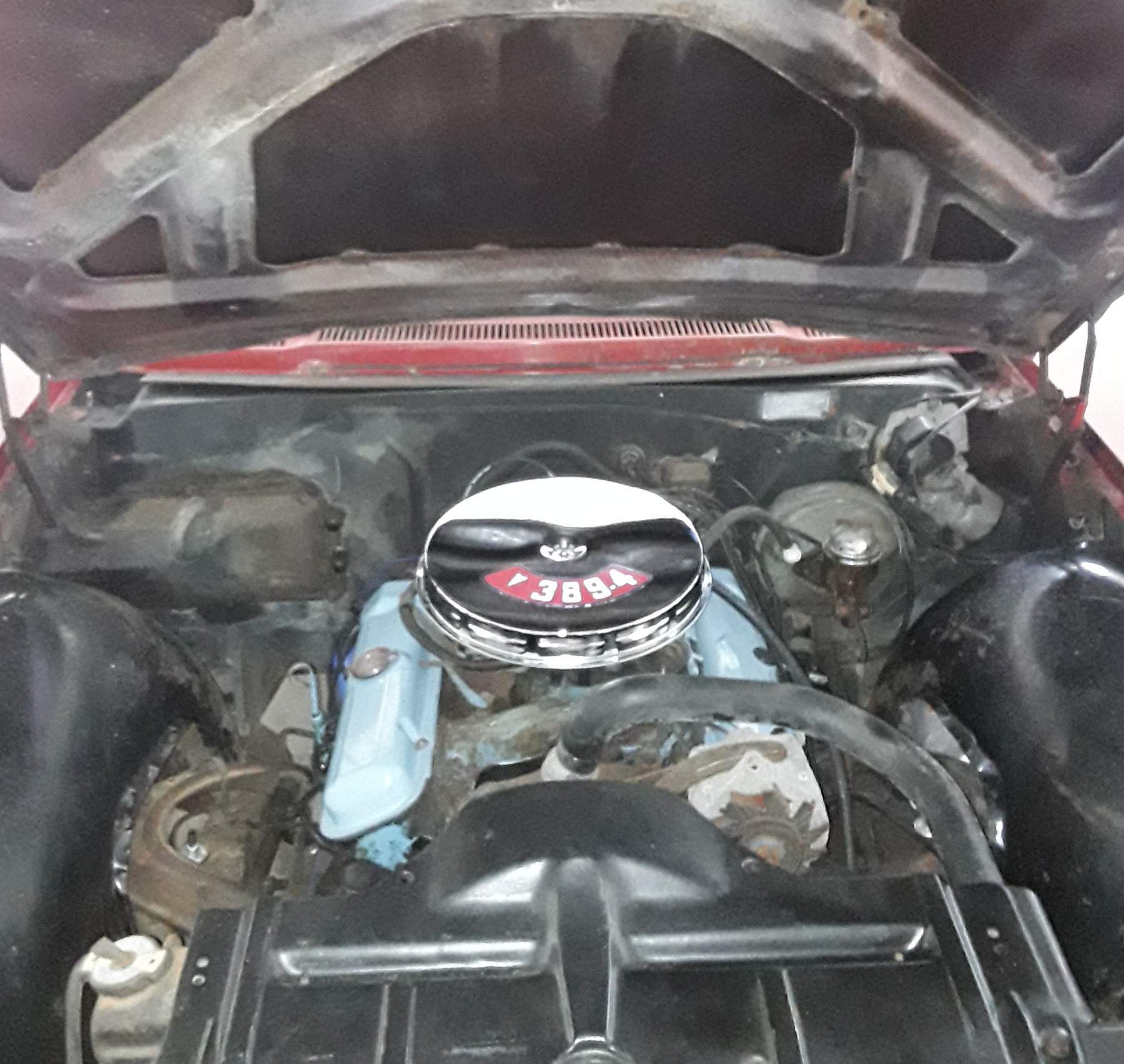

Anyway, as a reward to myself for doing so many extra hours, I spent frivolously (relax - it's now a word) and added some bling to the GP. I kept looking at those chrome louvred air cleaners and could never justify the ask, but then I remembered that this is my one and only life and I'd hate to fall to the ground one day, clutching my chest and breathing my last and thinking "why didn't I buy that bloody air cleaner?" So, behold it's beauty. It makes the old can look positively dowdy. I'm not sure that sucking in all that warm air from around the engine is gonna shave a coupla tenths off my quarter mile times, but I'll look cool as I limp to the finish line dead last.

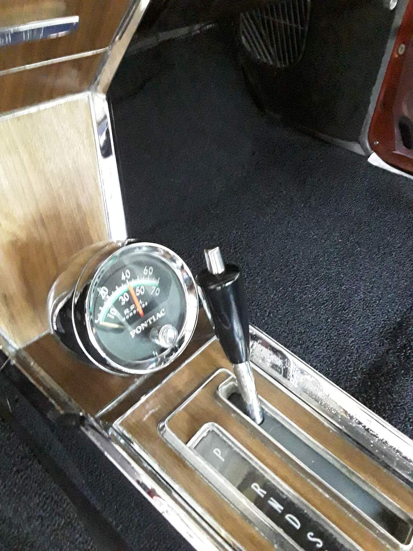

I also procured a new Ames supplied auto floor shift chrome button. The original plastichromed item had shed it's skin and the new one is machined metal - much better than the original. It's not often you read a sentence like that. If you have a floor shift auto and your little chrome button is looking scrappy, I wholeheartedly recommend this part. It'll be a bitchin' accessory for your console mounted tacho, too!

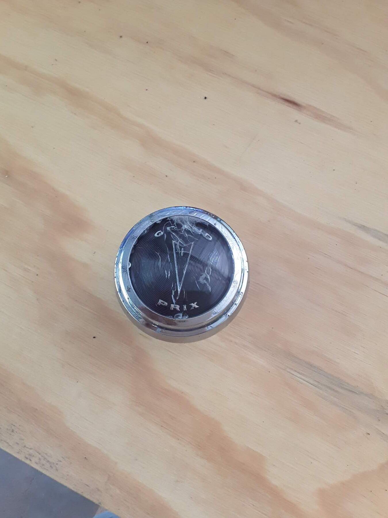

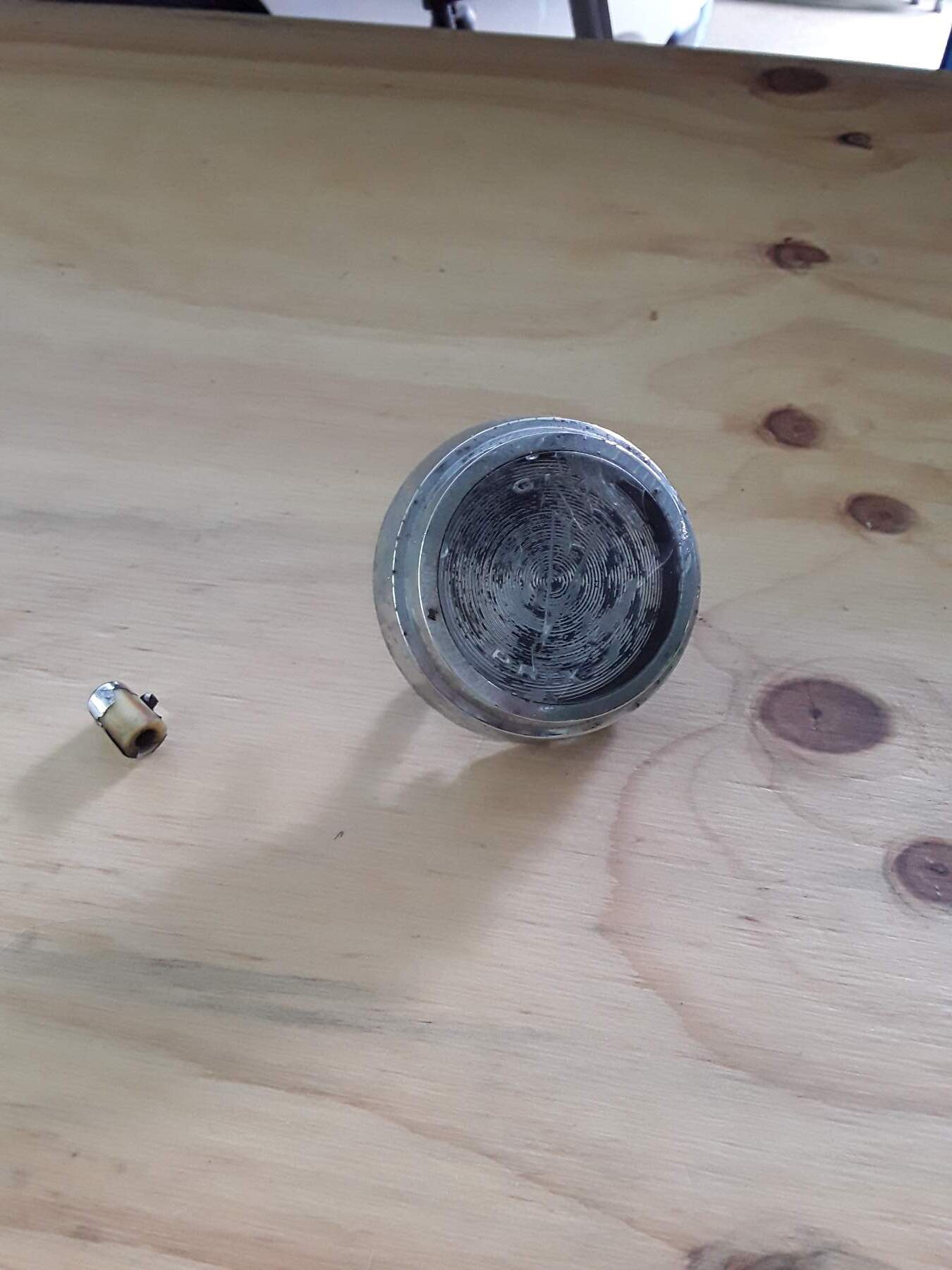

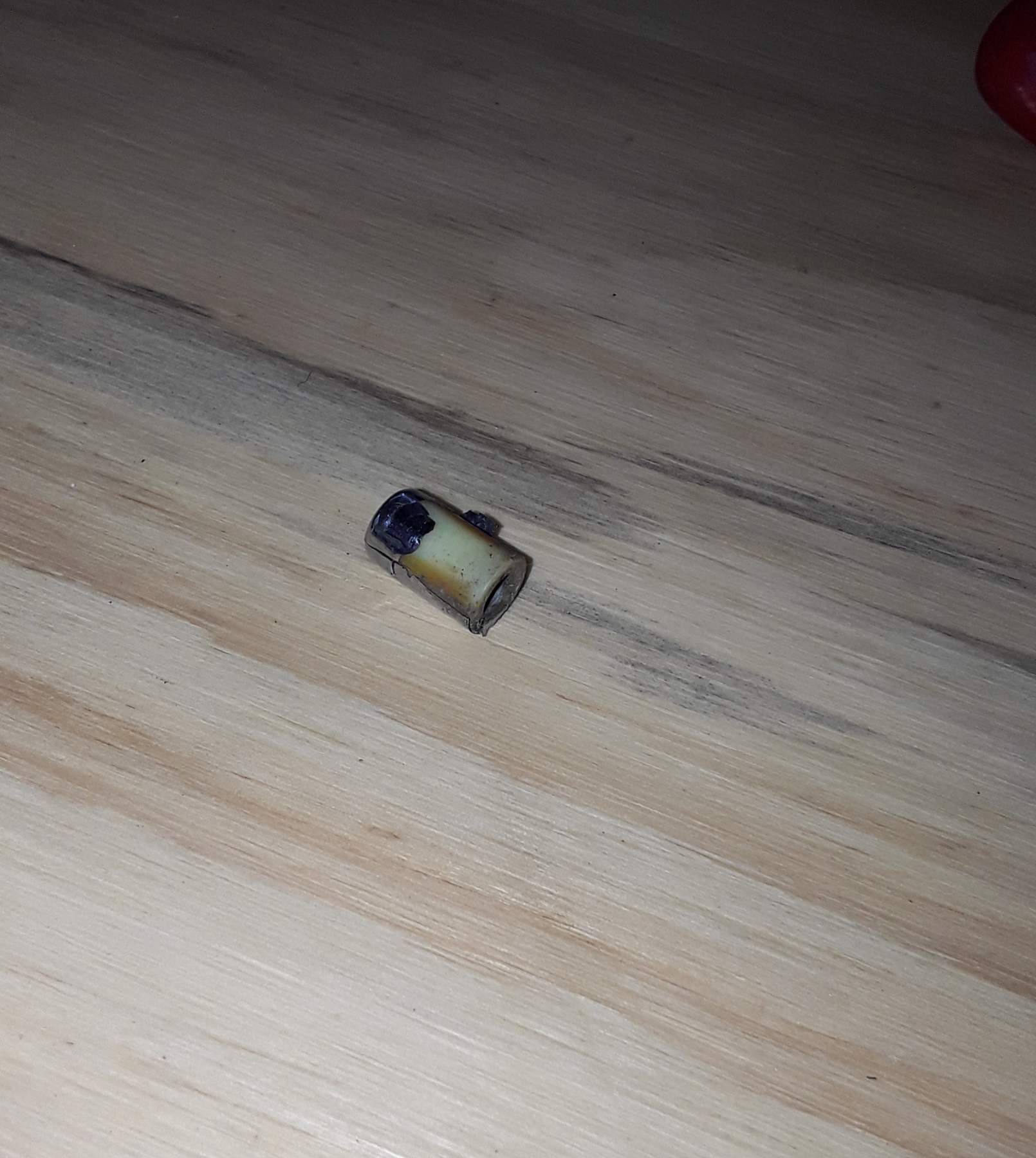

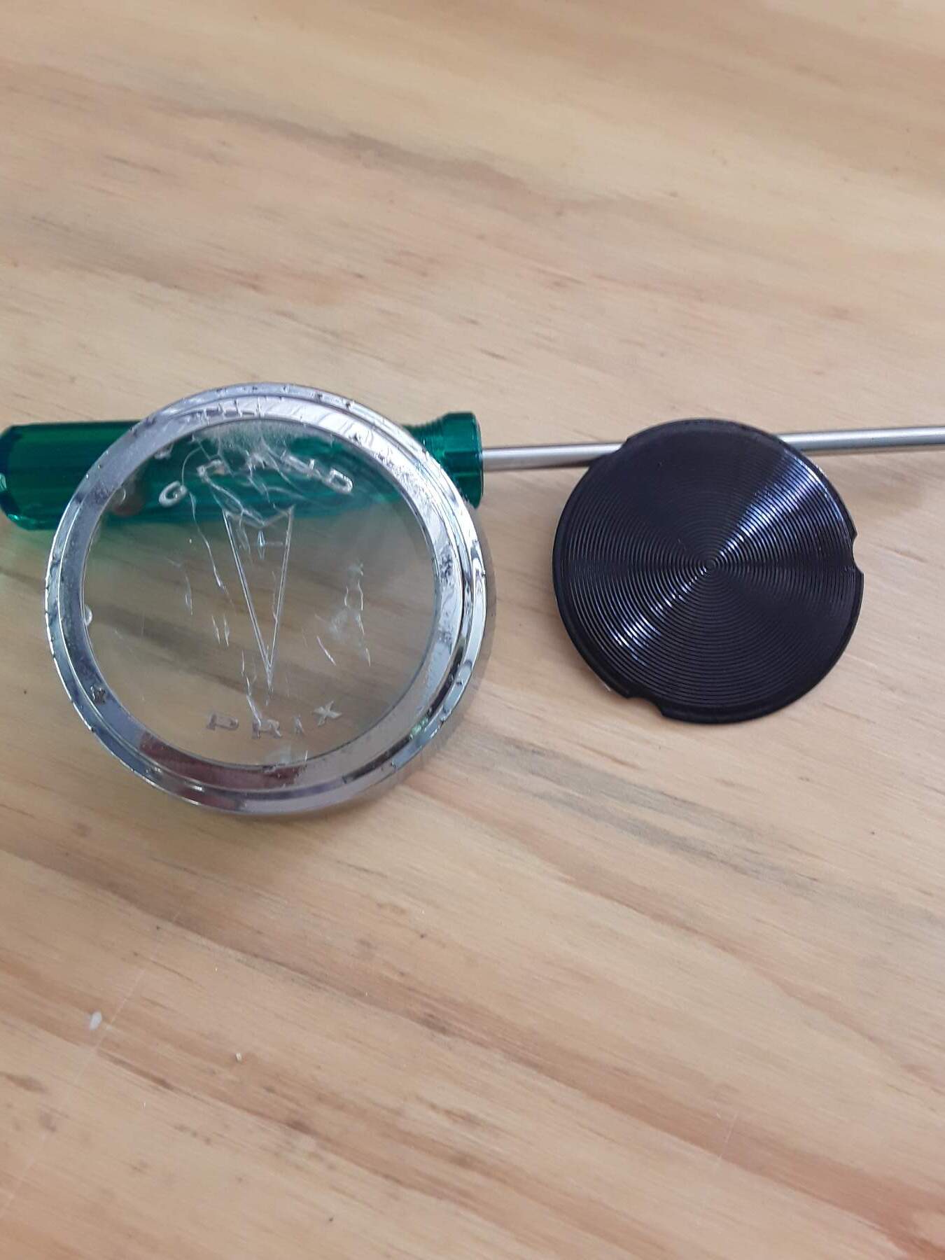

Whilst I was having fun, I had a look at my sun damaged horn button, pulled it apart, derusted the innards, and sanded the plastic face with wet 1200, then some Autosol chrome polish and finally some cream polish. I repainted the metal piece that forms the background gloss black and glued it all back together. Sure, it's never gonna look like new but looks much better and cost me nothing to do.

The old girl is looking better and better in her new prom dress there Fitzy!
I find it amazing that there is more chrome on the inside of the car than in the engine bay. Perhaps you may have to tweak that a bit more to stave off impending death even further. Perhaps chrome valve covers and breathers.
Nice air cleaner mate 👍👍👍
the little details all add up once completed and look wayyy nicer 👍

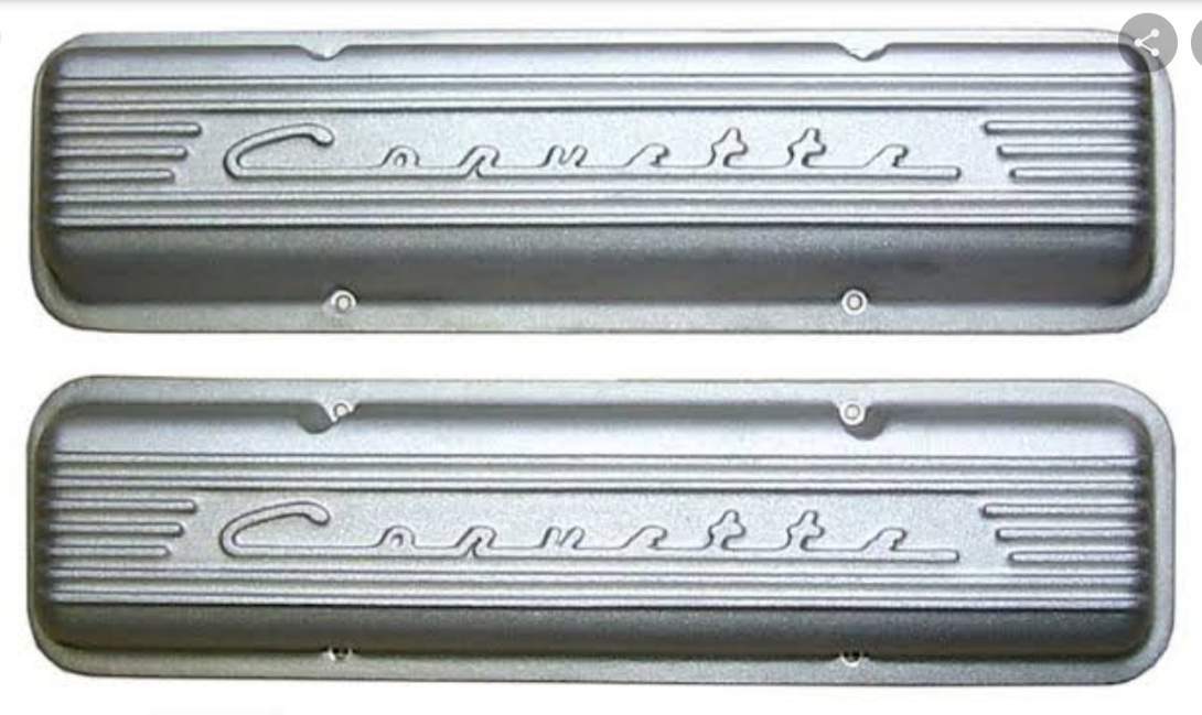

Thanks Boys, the engine bay will get a thorough makeover once the donk comes out. You know, I never liked chrome valve covers. I like factory colours OR those beautiful cast ones that were a factory accessory - I've seen some old Corvette ones that were finned alloy with a beautiful flowing  'Corvette' script across them. I'd have a pair of those in a Pontiac format in a jiffy.
Yes the ones they used on the old 327
are a nice strong cover that will seal gaskets wayyy better than after market tin ones
These are the ones I was thinking of: very, very cool.

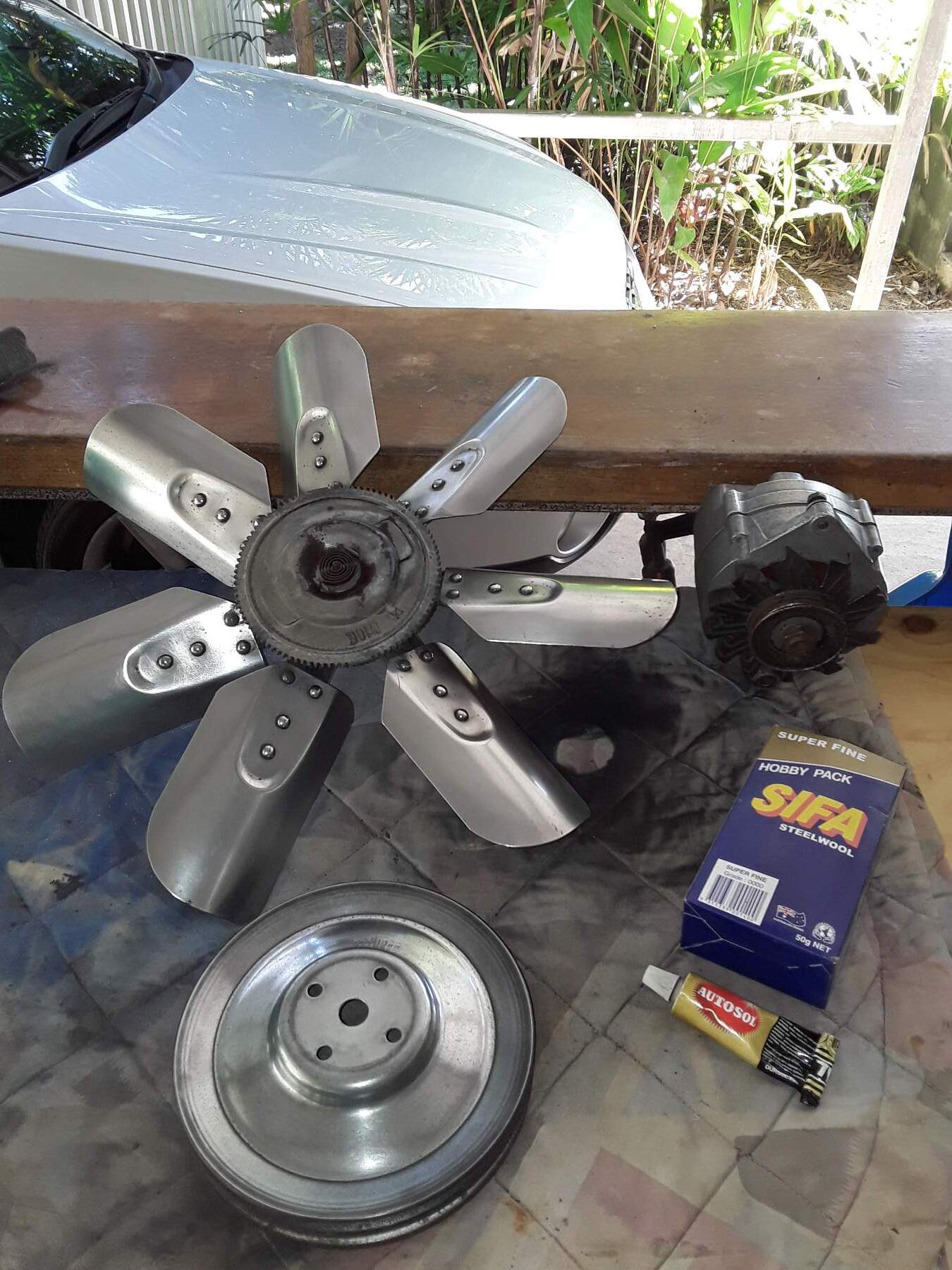

After that, I pulled a few more bits off the engine. Frosty observed that the engine seemed to be lacking some shiny bits, so I polished up the fan, it's pulley and the alternator. Now, I may be late to the party but I experimented today and after sanding all those engine parts (360 wet then1200 wet) I did the final polish with Autosol, but applied it with 0000 grade steel wool. As you can see, it buffed up nicely. I will mention that I sanded several times with those grades of sandpaper to get the parts as shiny and as smooth as possible before polishing with the cream, and finally hand buffing with a piece of old towel. The centre of the fan is how the whole thing looked initially. I'm going to polish that as soon as the rust converter on it dries.

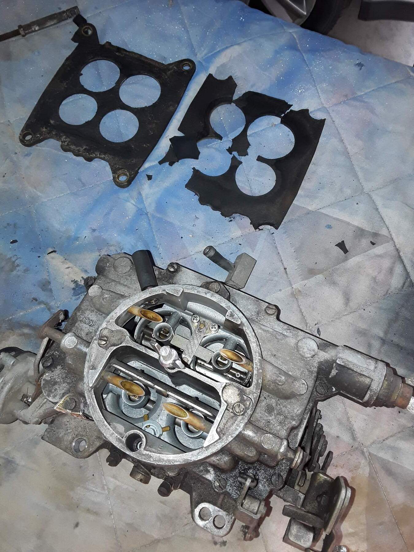

And, after removing the carby, just like Kiwi I had not one but two phenolic spacers that looked like they had been there since Day One. I'll replace them with a nice big fat new one. I unbolted the headers (if your life is lacking that special experience, try unbolting headers) and disconnected all the little doodads and wires, so it should only be mounts and bellhousing bolts left, pop the hood off and out she comes. Yep, just like that - it'll probably jump out itself.

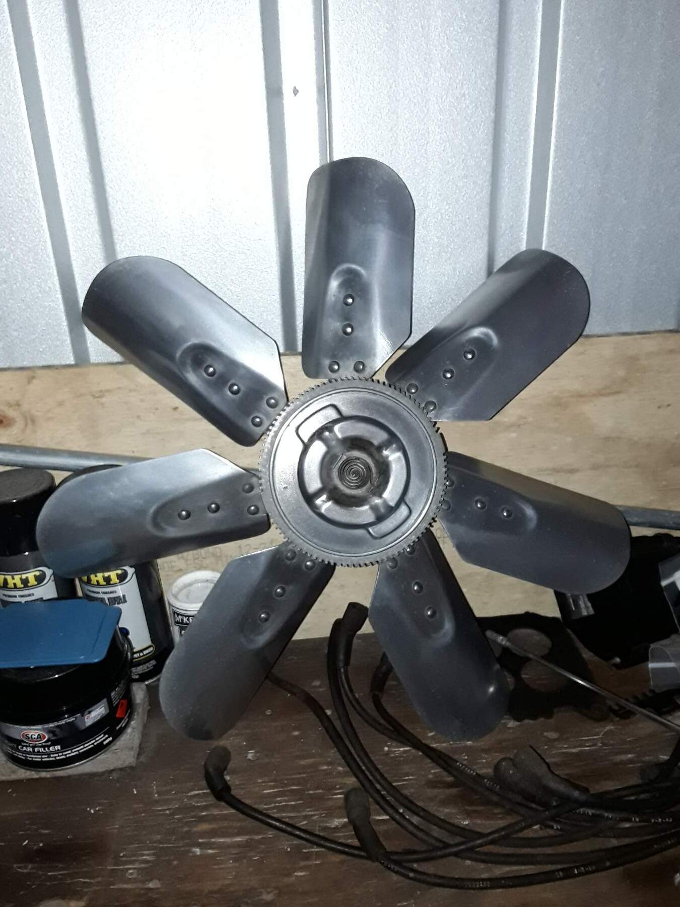

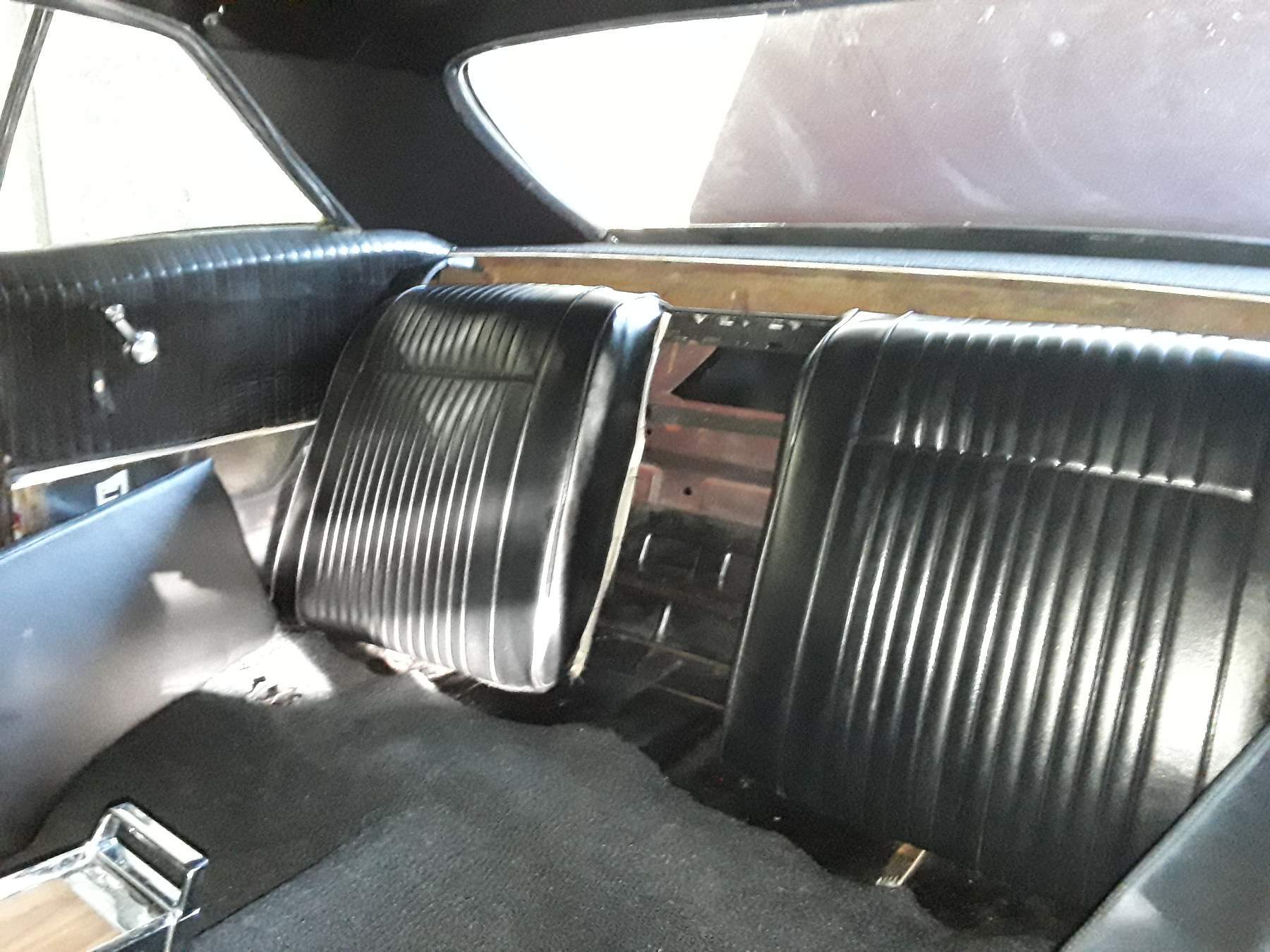

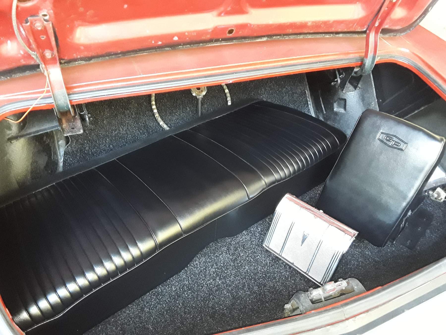

More progress: got all interior pieces back from upholsterer today. Had a look at the rear seat and decided to coat it with vinyl spray before it goes in. As you can see, the 55 year old Naugahyde is holding up very well. I gave it a thorough clean before spraying it, even using my fingernail inside a rag to drag the cleaner down each embossed rib. Also finished polishing the viscous fan - just to keep Frosty happy!
Today's only drama was the attempt to fit the newly recovered dashpad into place. I explicitly told the trimmer to take it easy on the padding towards it's leading edge where it abuts the inside of the windscreen. No cigar - that sucker ain't going in. Looks like some minor surgery to correct that little problem.
I DO love that blingy little speaker grille that sits in between the rear seat backrests. Mine was a rusty piece of crap when I pulled it out, but after much wire brushing & sanding and a coat of paint, it looks fine now. It is complemented with the 'GP' embossed armrest that folds up under it - classy.
