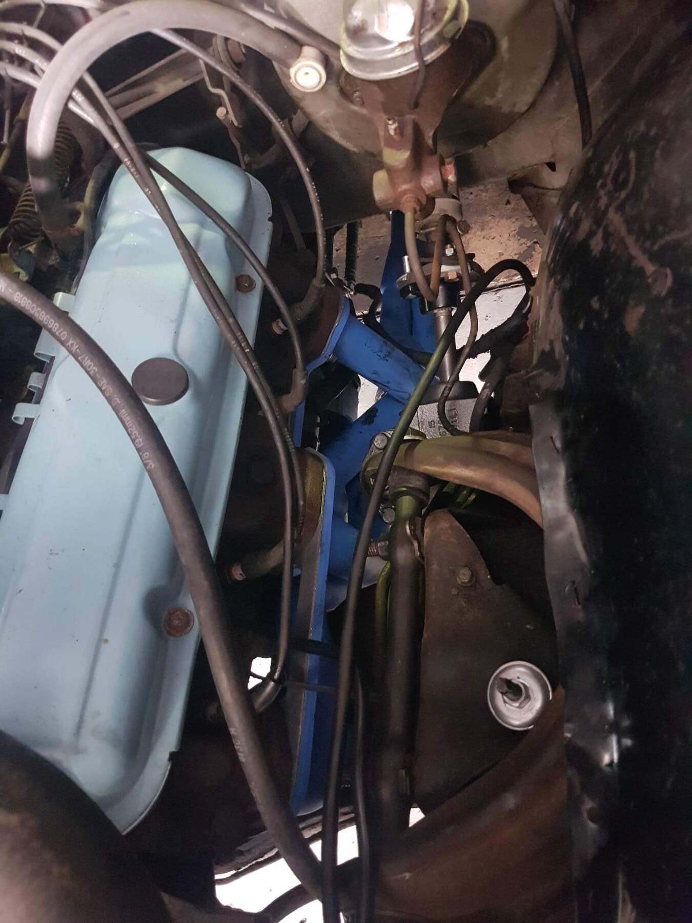

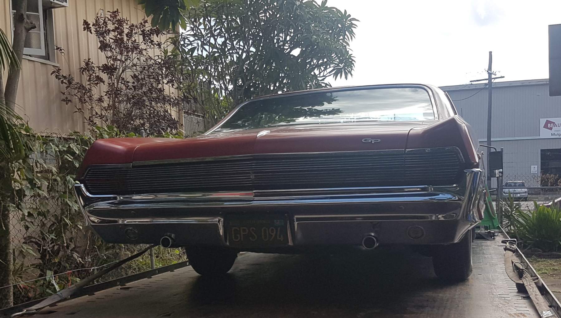

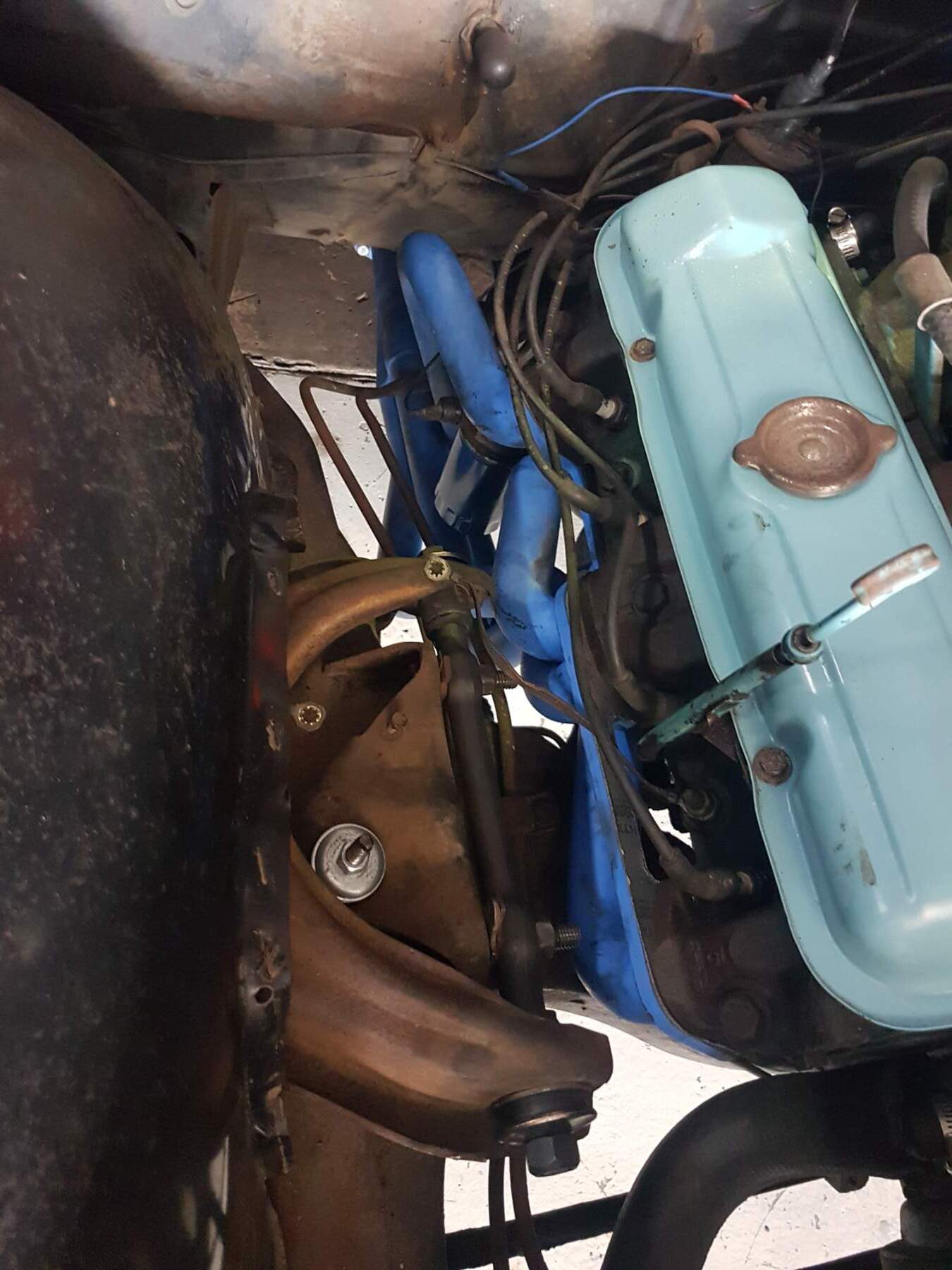

I finally have something that may be remotely interesting to post. Picked the car up from the muffler shop and it's FINALLY got that nice new spanky twin exhaust. I was adamant that I'm extremely fussy about the tips being exactly equal and the young bloke confessed that his OCD gives him grief sometimes but promised that those tips would be perfect, and they are. A nice clean factory looking fit.
Anyway, I had to quickly take these shots - I'll get better ones when it comes home to roost. Note the tight header fit. Steering box? I know you're in there somewhere..And the front of the car is now at a reasonable height. She sits dead flat and I like it, but I'd like just the slightest rake to the front. I might chuck a couple of 10mm spacers atop the rear coils just to set it off perfectly.

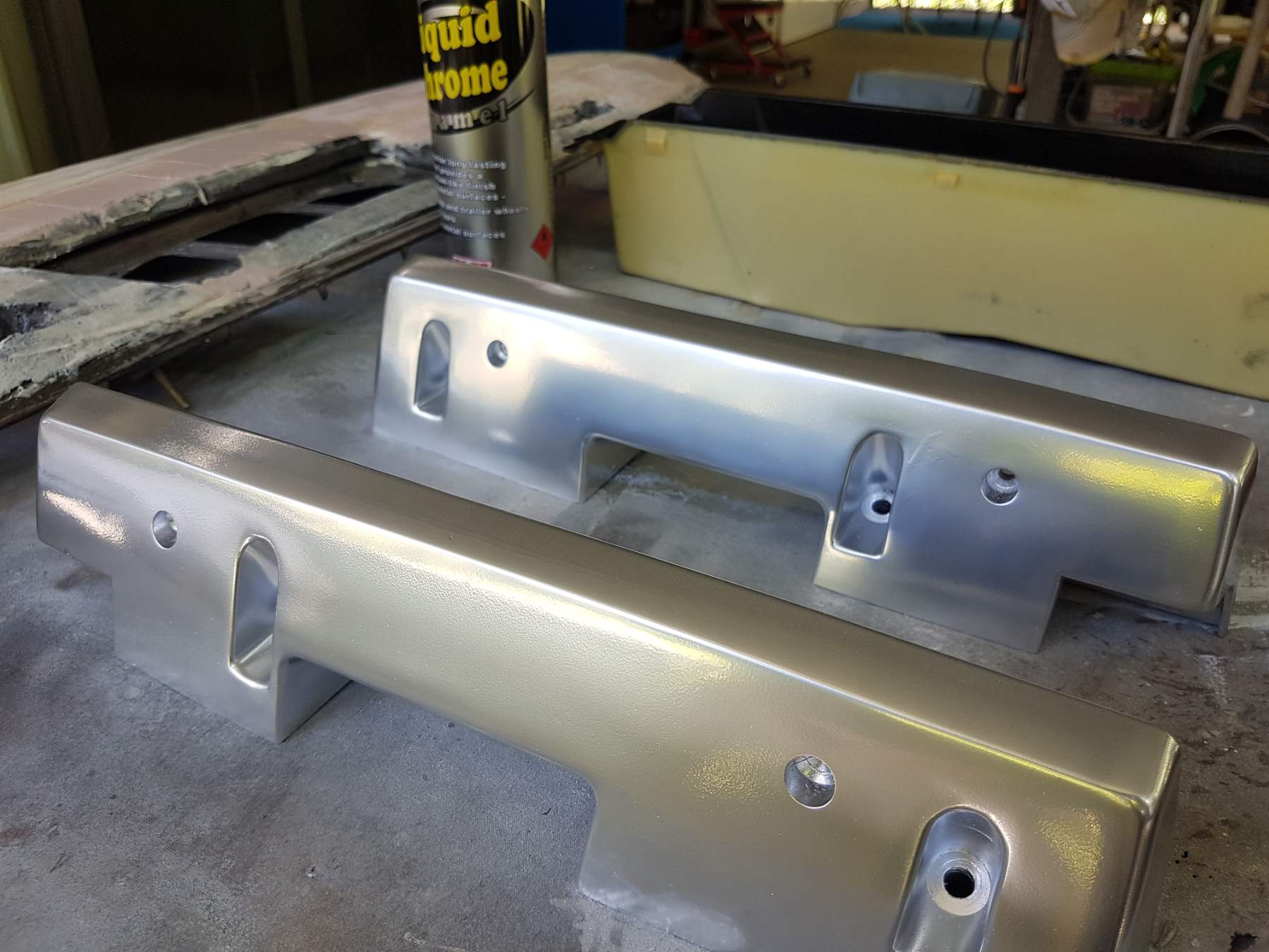

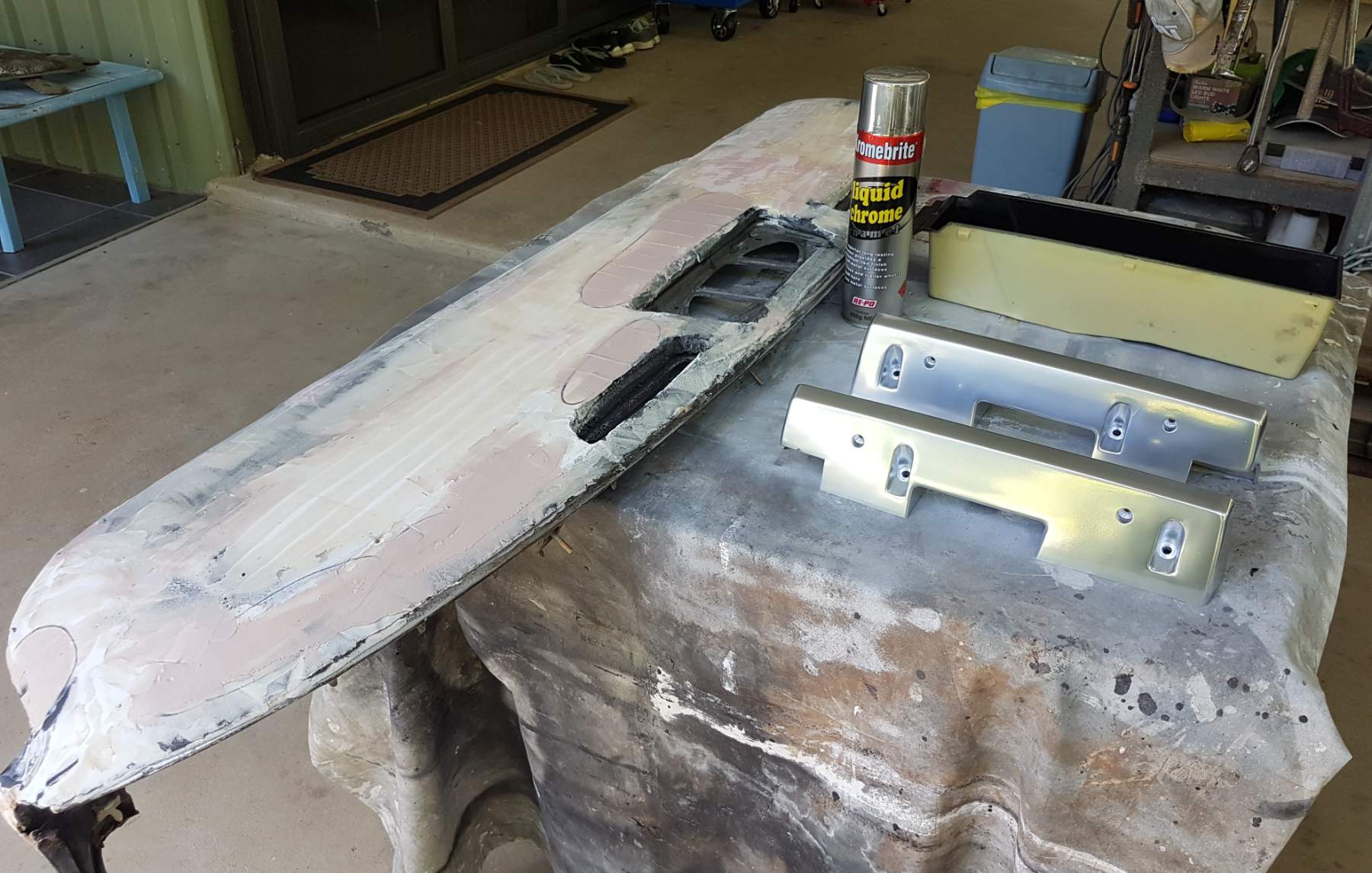

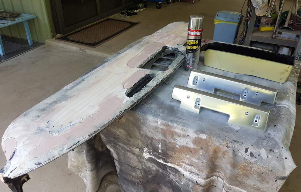

Lastly, I finally got around to spraying some liquid chrome on my front armrests. I've never used this stuff before, but the result is impressive. I plastic primed the armrests first and it actually almost looks like chrome.
That shot of the back of the car makes the tips look a bit wonky - it's gotta be an anomaly with the phone camera: they are actually dead even.
gess  those headers look tight as!  your mecanic did well mate, and your driverside is totally different to my 64 ! image.png.4af19bb40689c8a07f8d5d3e4c749e1e.png

Ohhhh yeah brother! Looks great! I like the look of that chrome stuff to bro. Keep up the good work and pics lol, Im waiting with kiwi for the pics of the plates to :lol::cheers:

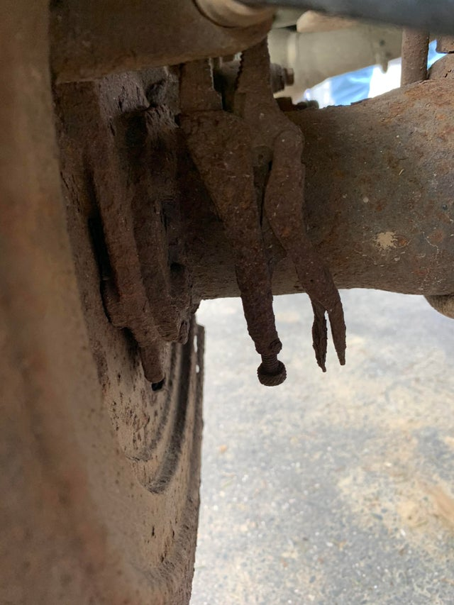

Along with the mystery plates we found this!!!:picard:
4 hours ago, Wrongway said:
Yeah, free tools! Bonus!!! :rofl:
We LOVE free tools....
