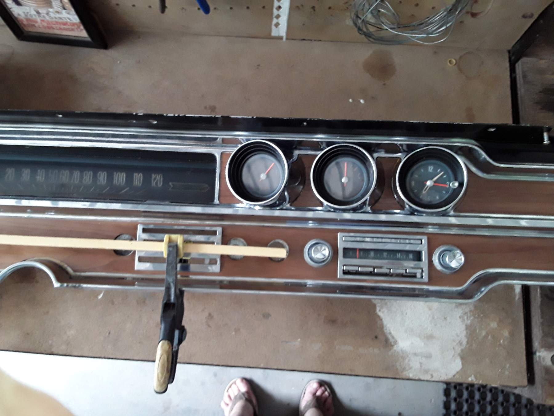

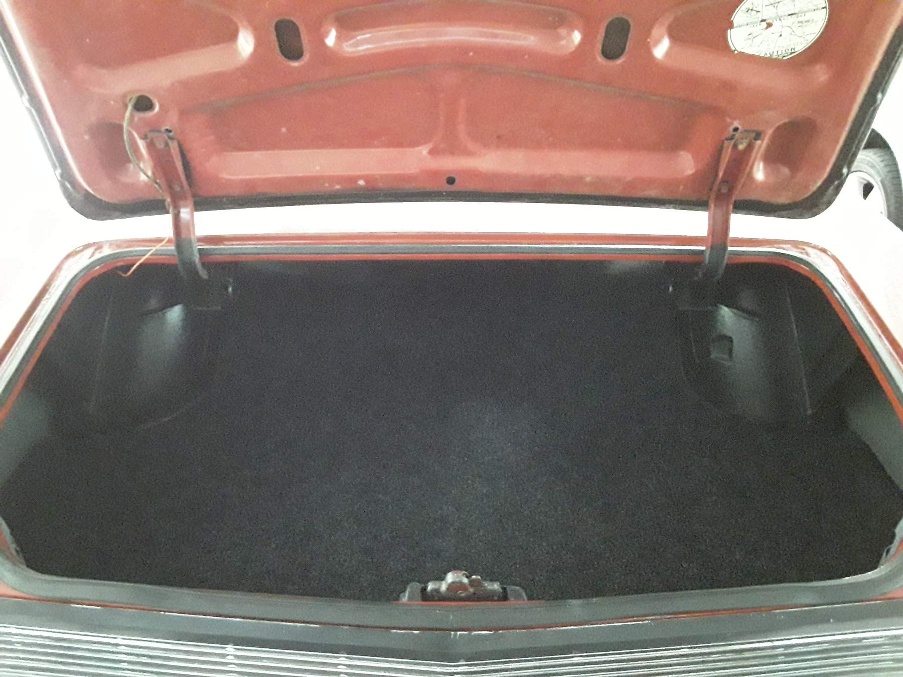

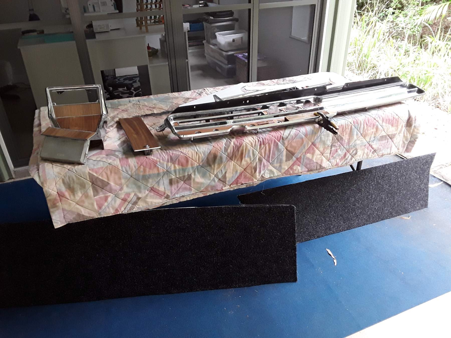

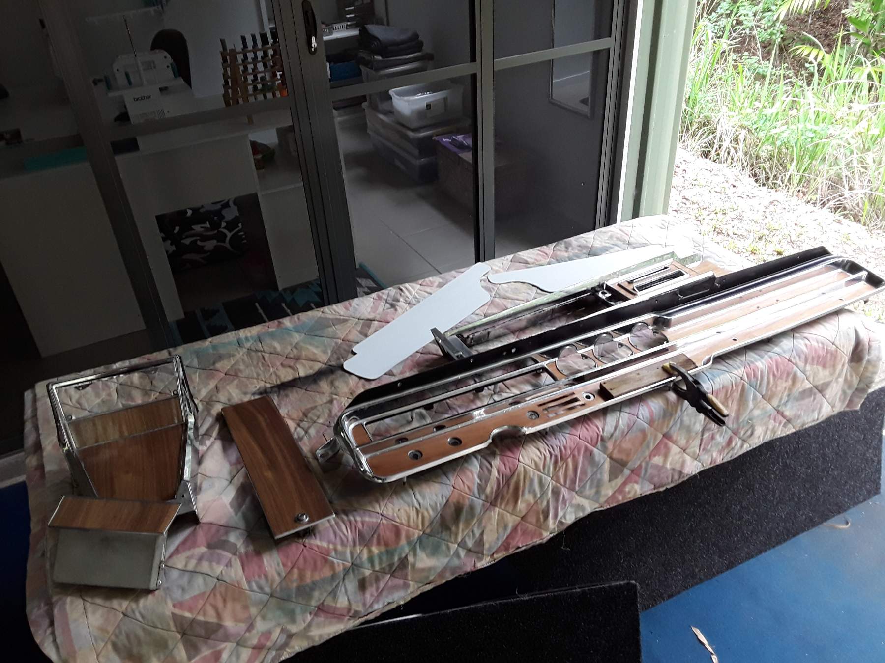

The fruits of my labour today: I made myself a trunk carpet, a trunk divider and a rear parcel shelf. I then applied the Ames supplied walnut veneer replacement kit to dash & console. Trimming the walnut prior to fitment was a sweaty, panicky procedure. One slip of the carton knife and off to the doctor but even worse, one trashed walnut veneer kit. Fiddly, intense work. Is that a refreshing beer I can smell?

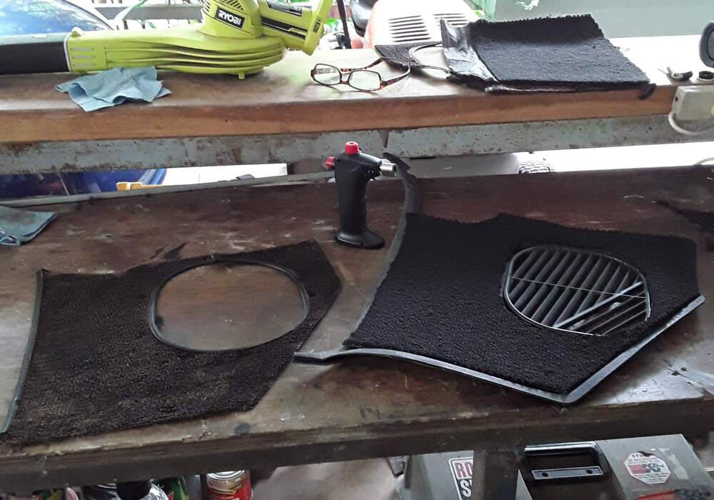

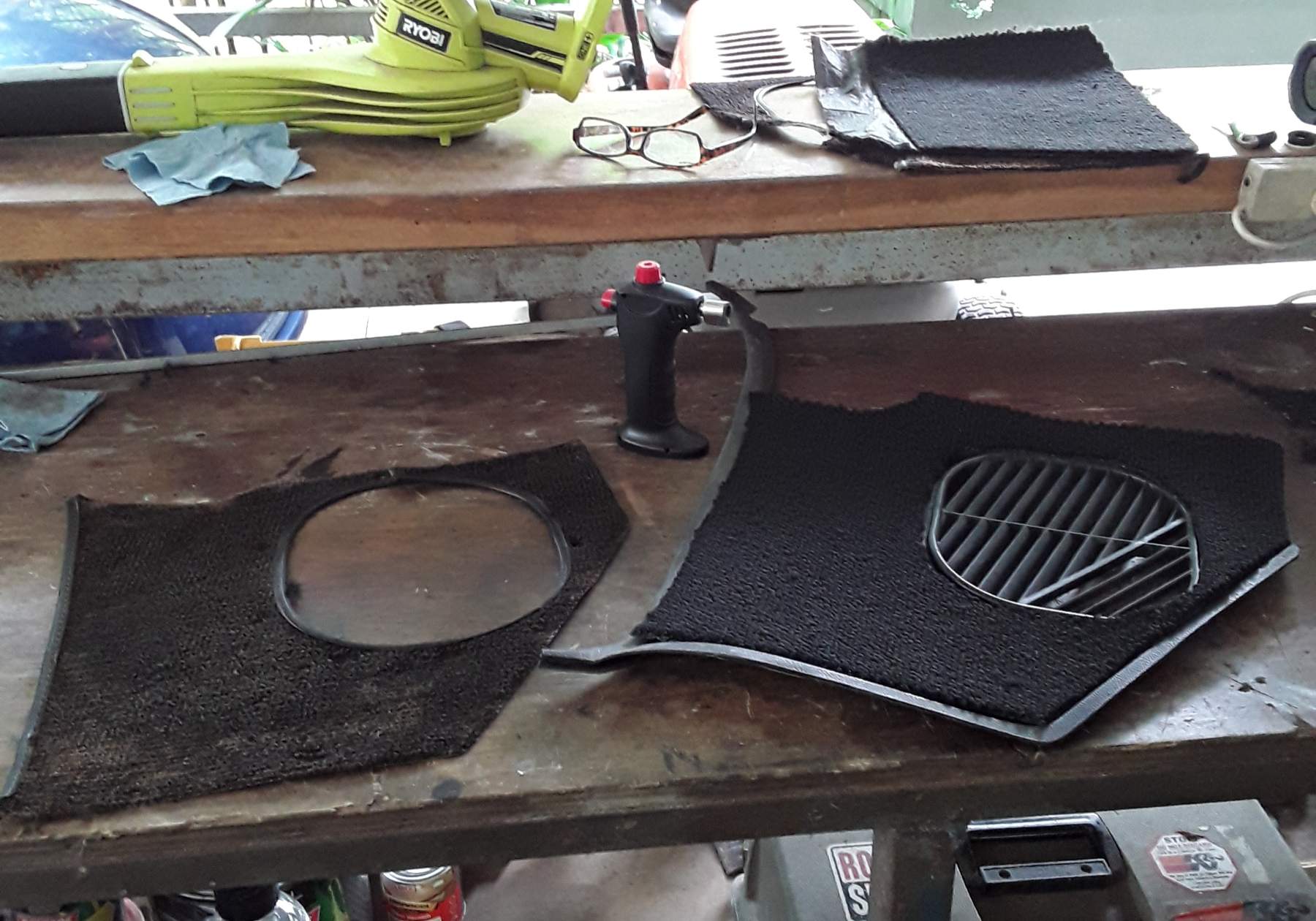

I'm on a roll...I decided to do my footwell trims before beer o'clock. Here's a hint: the factory ones have a sewn edge to prevent fraying but modern auto carpet is polypropylene,  so after I neatened my cuts I resurrected the ol' Creme Brulee torch and melted the edges to prevent fraying. Nobody is ever gonna look under there, so I reckon sewn edges are overkill. Another coupla hundred bucks saved at the auto trimmer!20201231_161318.thumb.jpg.3e51c26bb829cfc5237d1a95c1ffa956.jpg

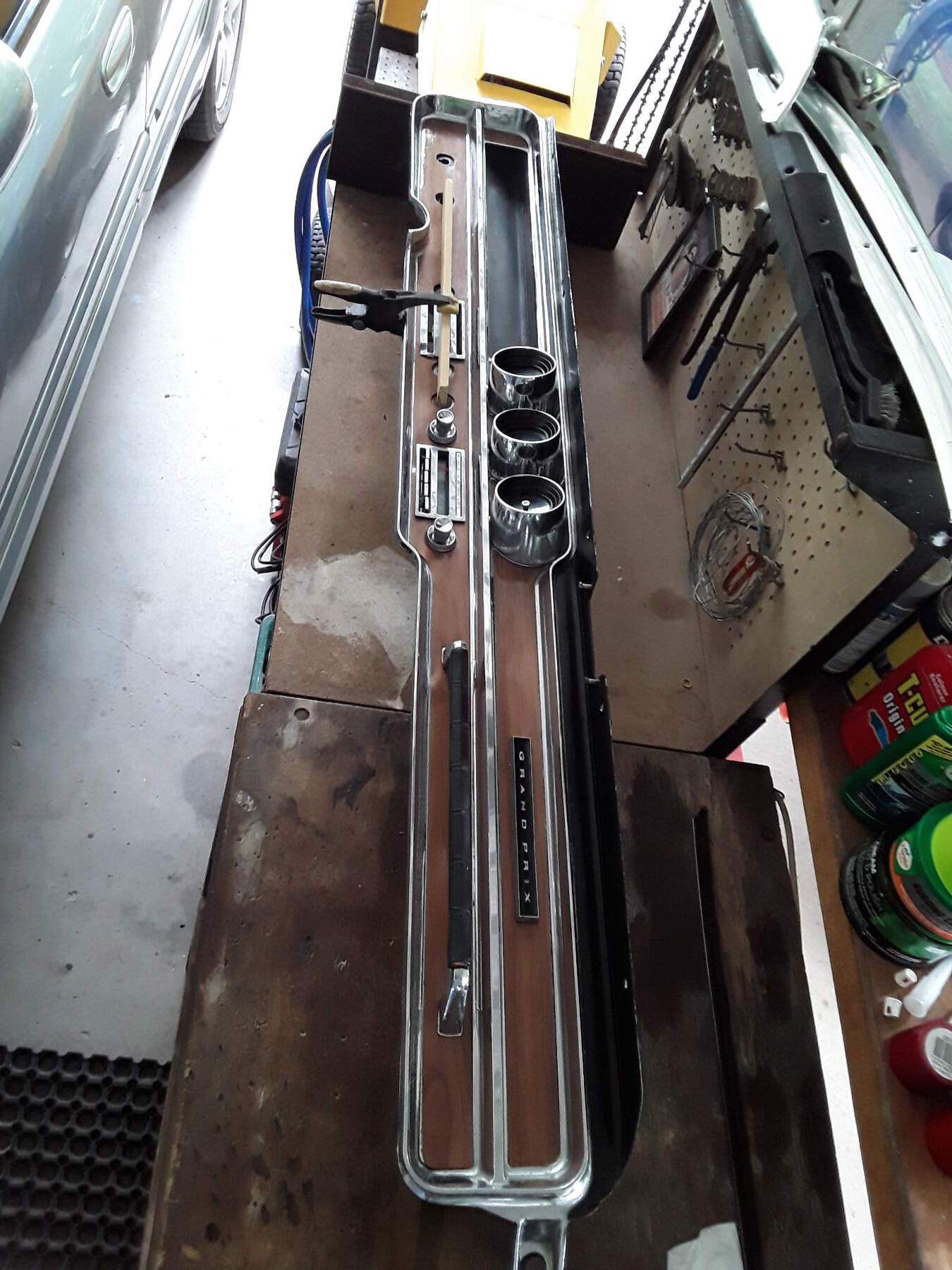

20210101_163956.thumb.jpg.0d00d22c67e1b52d0ff05255ac23832b.jpg20210101_163902.thumb.jpg.680a3db4d1077b7843b7db4cfbdf7540.jpgOne more - today was 'dashboard reassembly day,' so as you can see I polished up all the bits & pieces and bolted it all back together. However, as I was gently hammering home the slotted bezels that locate the radio control shafts, the little fluoro orange needle that tells you what frequency you're on fell out! Now, that radio was full of ratshit, dust & rust when I pulled it out, so it was pointless to think it was ever going to work, but I wanted to keep it in the car, so I discarded the vast majority of it and what is left is simply the face - just to keep up stock appearance in the dash. So, after I'd finished hammering, I deftly put the tiniest amount of clear adhesive on the back of the needle and located it on the face. It looks perfect, but of course if anyone fiddles with the controls trying to hear something, all they'll hear is me screaming at them to "DON'T TOUCH ANYTHING!"

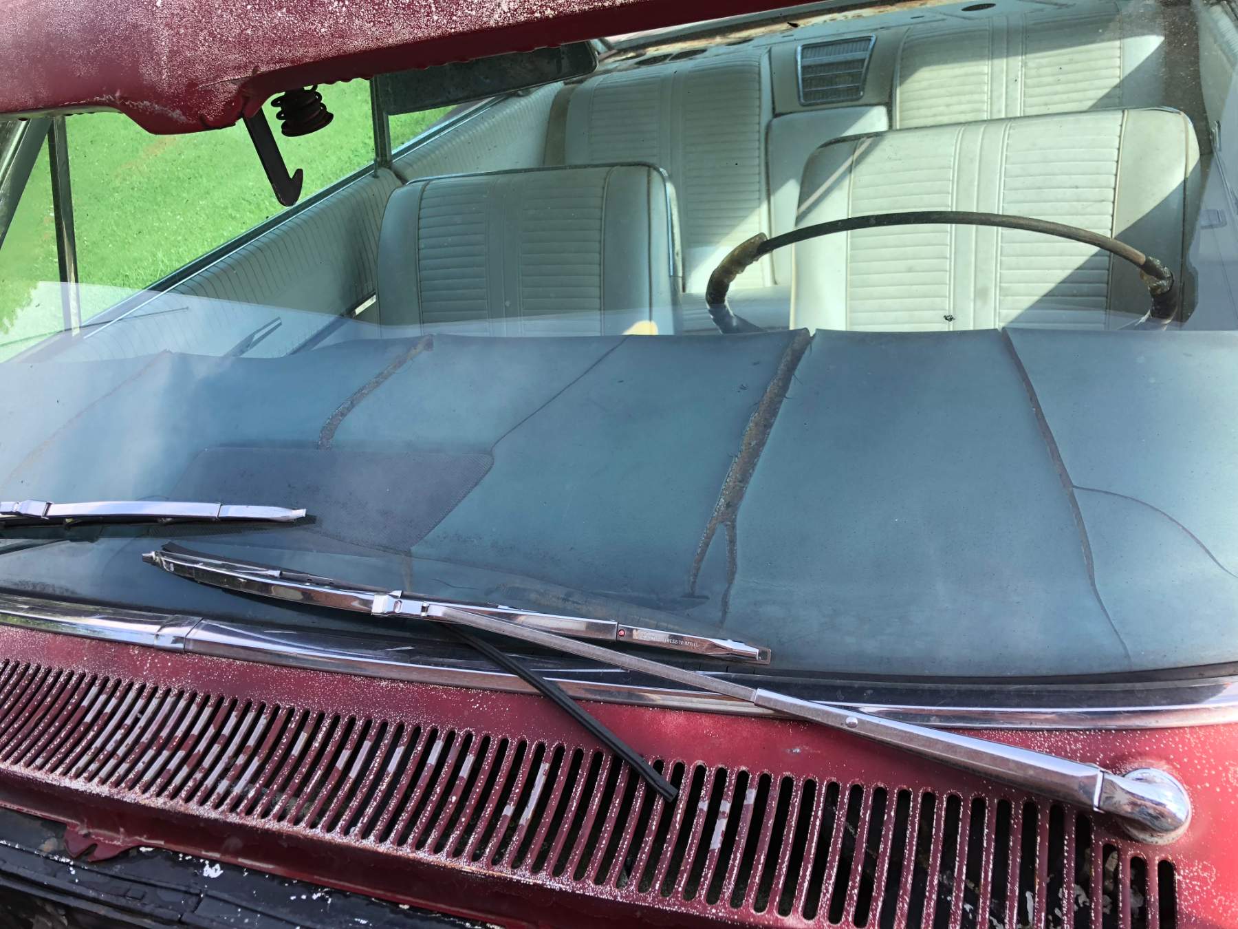

Anyway, it was time to stop ignoring the issue of the dash pad. A joint in the US wanted US$2000 to supply me with a dash pad. As usual, I'm sure it would have been a superlative job, but 2k??? Now, if you're not aware, the 65 GP (and others no doubt) have a sculpted padded top that not only contours down the sides to blend in with the dashboard, it also has a soft bevelled edge at the top where the driver's head is supposed to contact it when those ancient drum brakes don't stop you in time. Yes, I could have let an auto trimmer do it, but there's nothing left at all of the old pad, so I would have had to micro manage their work to ensure they were getting all the shapes right. I thought "I can do this." So, I purchased some very high density foam (flotation grade that goes under the seats in a dinghy) and set to work slicing & shaping it as best I could. You can actually sand this stuff (carefully) so as you can see in the photo I've got the rough beginnings done. I should point out that I will cut the holes for the demister vents. Tomorrow, I can start sanding it and bevelling the outside edges where it meets the windscreen. I figure I can fill any imperfections with fibreglass resin before I let the trimmer do the final skin. Knowing me, I'll probably do that too! I'm proud to say that I've only outsourced one job since I've had the car, and that was the rust repairs.20210102_153710.thumb.jpg.7acb96ec061986173f3c9768499ab0e3.jpg

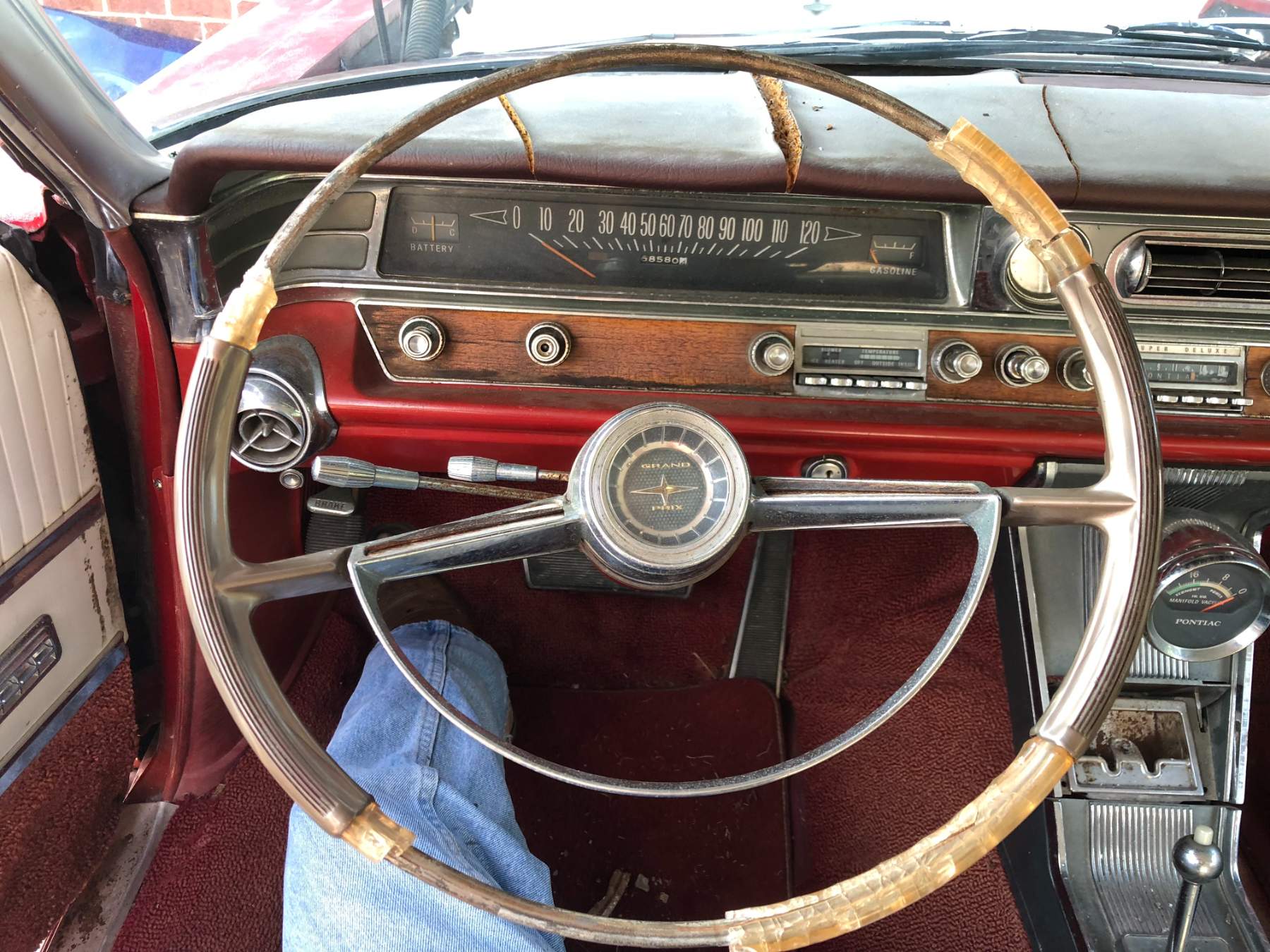

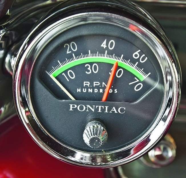

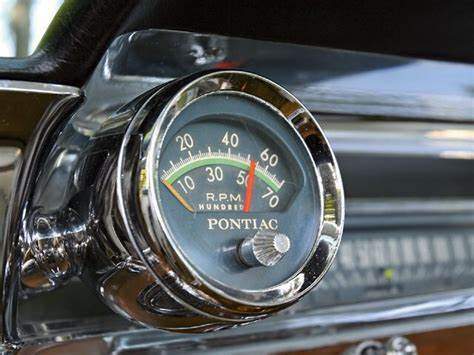

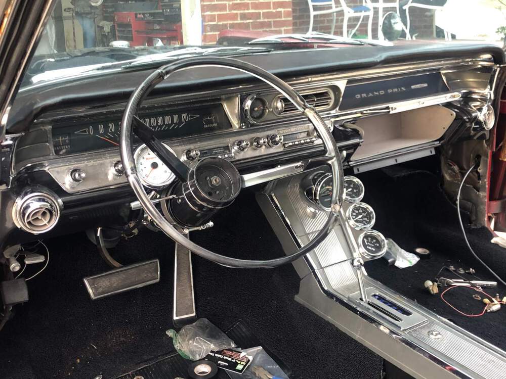

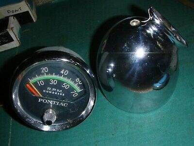

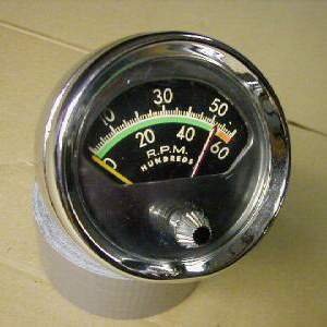

Hey Fitzy, Pontiac made a tach to go in that location on the manual shift cars that opted not to have a vacuum gauge. On the models that were manual and opted for the vacuum gauge the put the tach on the left side of the dash in front of the gauges. They also had 2 models, they looked the same with the exception of one being a 6k and one being a 7k tach. If I remember correctly the 6k was for 61- 62 and the &k started in 63' but I'm not positive about that bud. The 3rd picture is the tach that mounts in the console. You can see the mount on the one for the dash is on the left on the housing. Hope that helps bro.

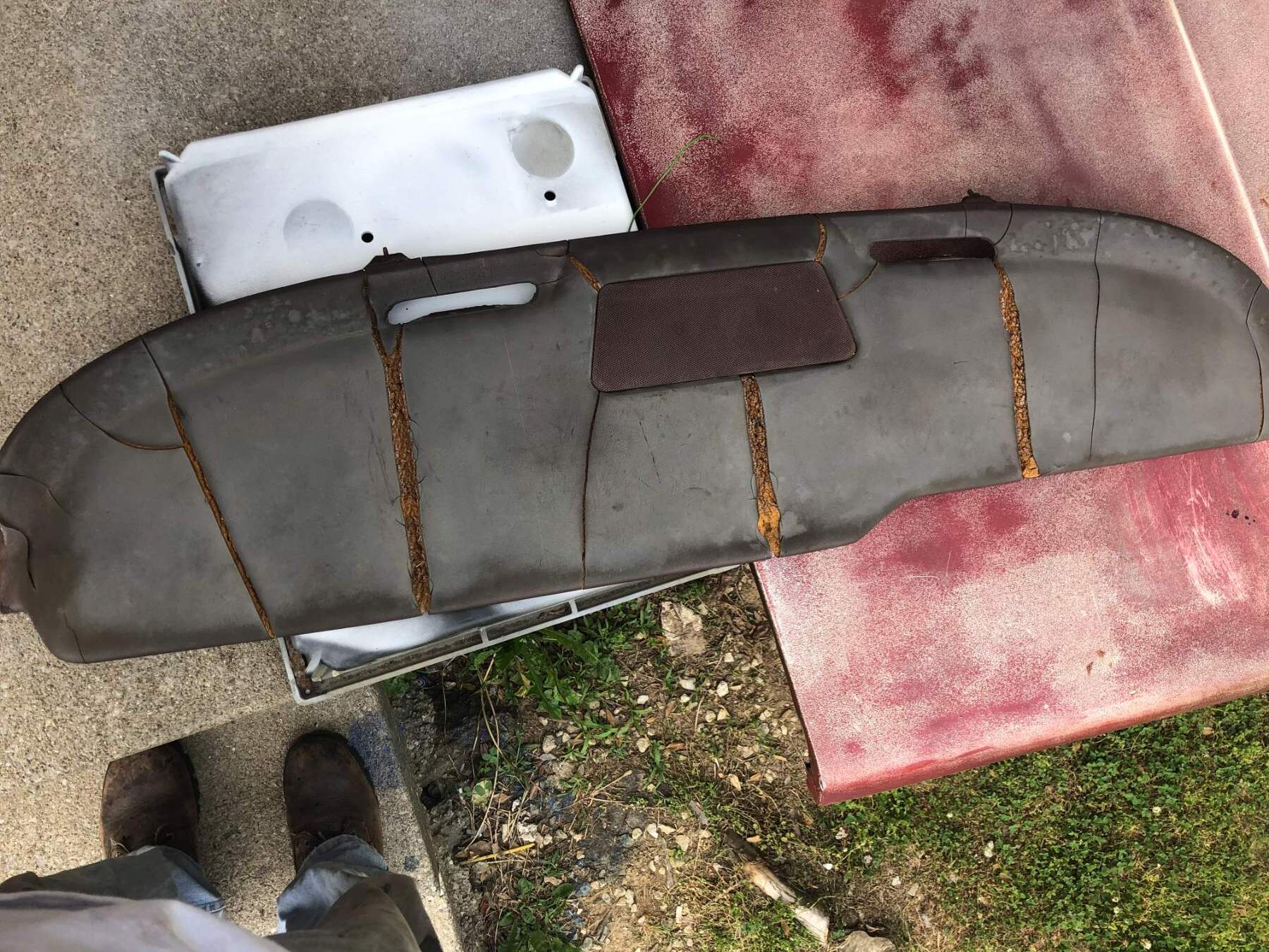

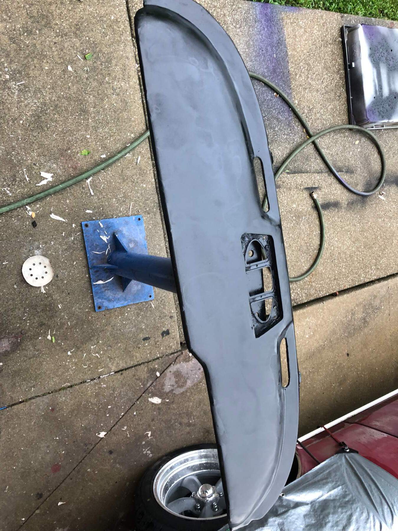

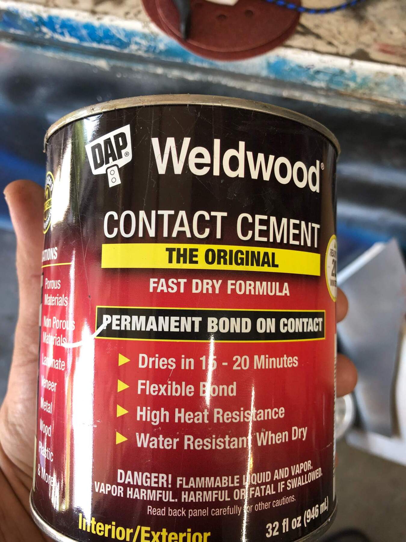

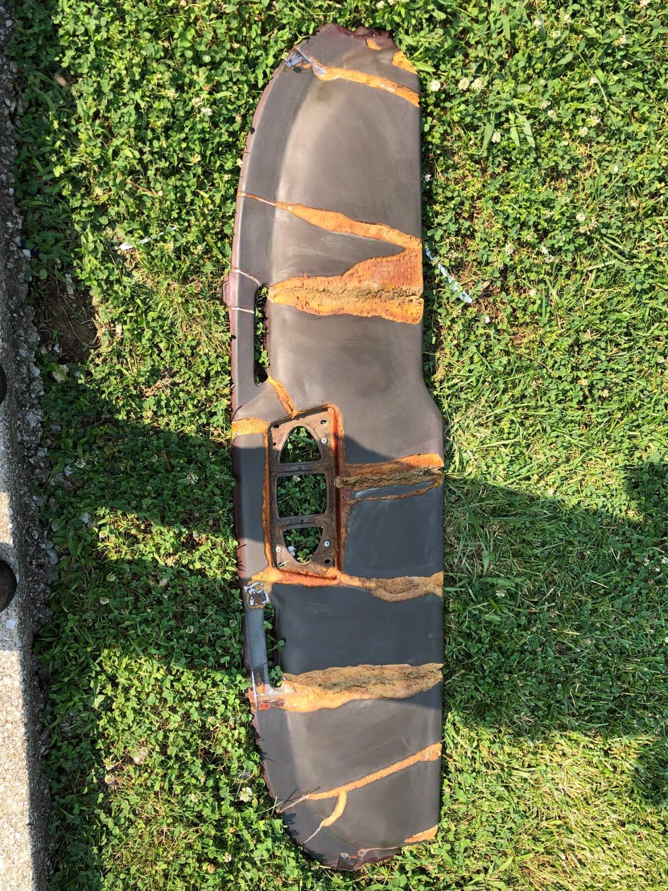

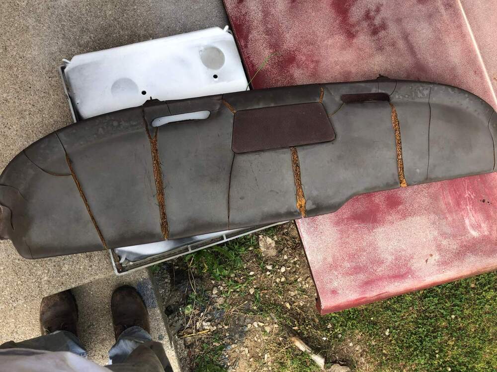

Yeah I did the dash myself bro. Its the first one that Iv done so I ended up doing it twice lol. The only real issue I had was with the adhesive. It just didn't want to hold the material in place. I trimmed away all of the dead, cracked and broken garbage. Then I widened the cracks in a V shape so I could fill them. After everything was filled and sanded I covered with 1 piece of foam and used 3M spray adhesive to hold it down. But as I said it would hold the dash material. I finally ended up using the contact cement. I glued down the top and left it to dry over night. The next day I pulled and stretched and glued the rest and clamped it down. I didn't get to really drive the car this past summer like I planned but Its all held together and still looks the same after sitting outside in the hot sun all summer.

Thanks Guys. Dakota Digital do some droolworthy stuff but I don't think my meagre budget is gonna stretch to that but I'll have a look. I like the factory Pontiac tach - I wonder where I'm going to find one. I'll do the usual searches after I post this.

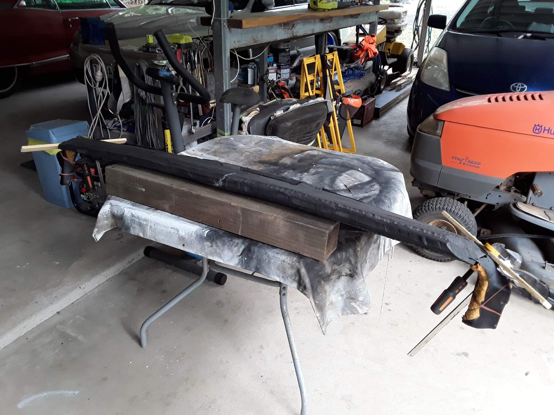

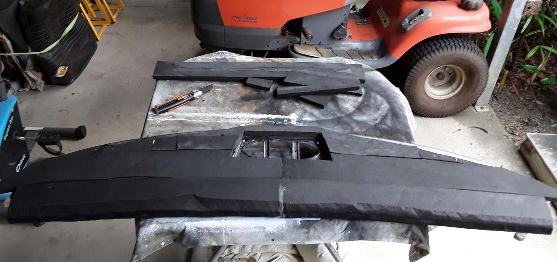

So, today I got the dashpad nitty gritty sorted. The 65 GP's pad extends down the sides whereas Wrongway's stops short and meets that cool looking aluminium trim. When I was wirebrushing the old crud off the metal skin I saw those side bits and thankfully had the presence of mind to cut them off and keep them, to use as a template because trying to replicate that shape from memory was never going to happen. Anyway, today I thought I'll just glue them on and can patch them as part of the entire pad. I think this is actually going to work! I'm buying some tough UV resistant black automotive vinyl tomorrow in preparation for when it's time to perform the skinning.
Wrongway, what did you fill the cracks with? I was just going to use gap filler but also to smooth over the surface to fill any irregularities and apply it with a wet spatula. Gap filler will remain flexible and it's only purpose is to fill those gaps. 20210103_171118.thumb.jpg.0d8798c248be66bbf4471190d19fa211.jpg
I used mostly resin for the small to medium sized cracks and rondo for the larger ones. I mixed the rondo in small batches and kept it on the running side so it would flow down and get deep into the cracks.
Thanks Wrongway - I'm gonna try gap filler and will finish the entire job with a nice big batch of fibreglass resin which will hold everything together and I can sand or fill it to get the final finish. I fly back to work tomorrow so it'll have to wait for my return. See you all in 7 days. Oh, if anyone sees one of those beaut Pontiac tachs for sale (with chrome pod, without, trashed, rusty, not working, whatever) can you let me know?
