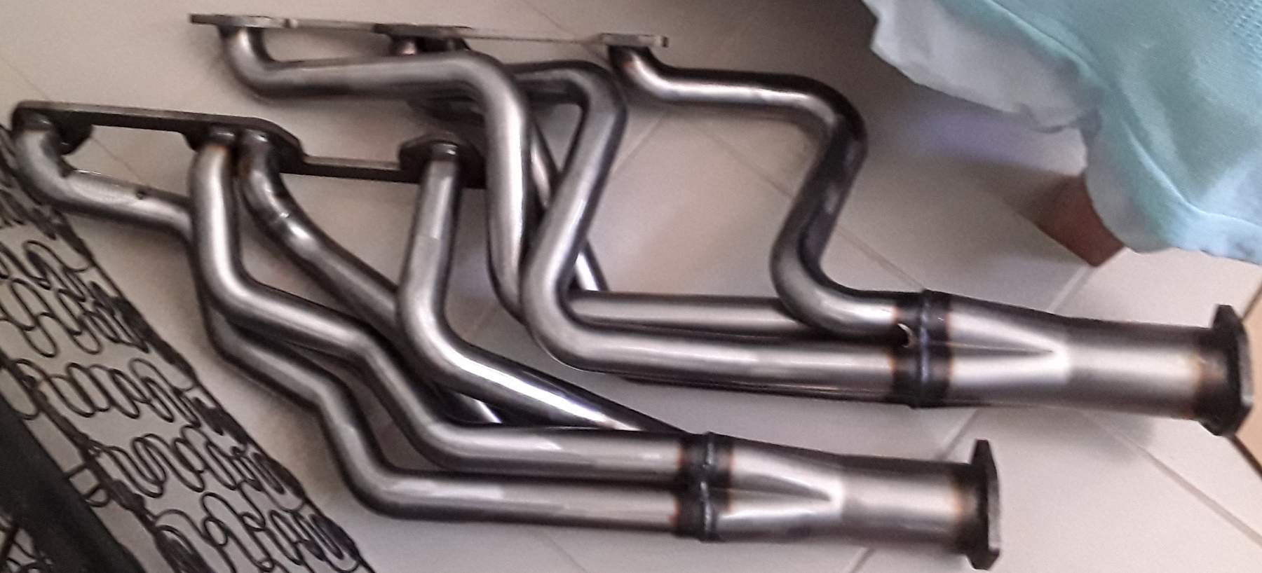

sounds  like your having fun 🍻Show us a picture of your headers fitzy😀
Good job bro! Cant wait to see more pics!!!
Here are the Doug's headers: man, they are beautiful. They look like they're stainless steel. I wanted to paint them before installation but am not sure if paint will stick to stainless without serious prep. Anyone know?
Another question: I want to use my factory fuse box and am wondering if anyone knows of the existence of glass fuse to blade fuse adaptors. They once existed but all leads go nowhere. As you can imagine, they pop in to the glass fuse cavity but with the convenience of a blade that slots in the top. Look, I'd happily replace the panel for a modern one but it's a job for a sparky and getting the car delivered anywhere at the moment is dramatic and expensive.
yup, sure are pretty Fitzy!
your 65 must have the steering box in a different location to the 63 and 64
those 2 center tubes are way different on the drivers side
I just had my stainless headers power coated fitzy, lasts longer and reduces heat in your engine bay 👍

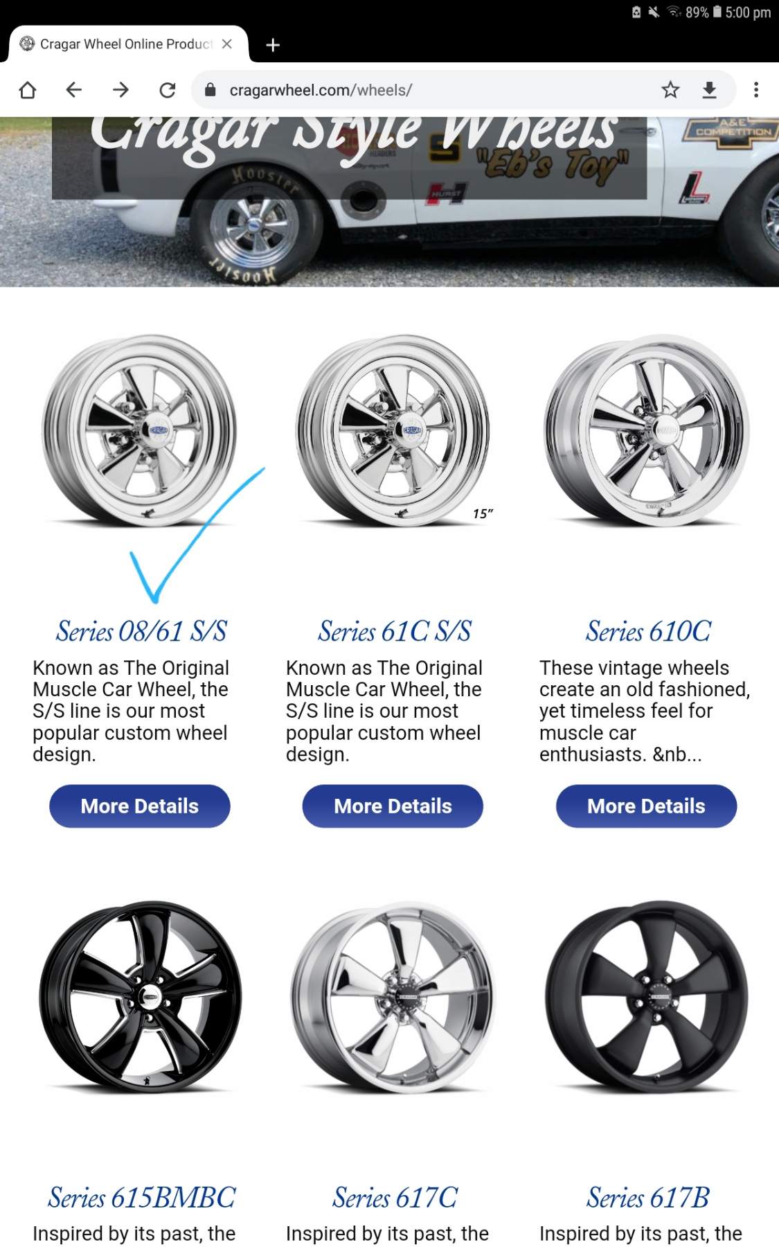

Just to throw an additional spanner in the works, the Cragars are available as a 14 x 6 with the correct PCD, but the offset is a little worrying. There's a lesson here, folks. If you're going to modify, do your research and take your time. I know the end result will be worth it, but every time I look at that car, I will be reminded of the dramas I endured getting it to that point. Whaddya reckon, Torqs or Cragars? One 3 week swing of overtime will pay for the Cragars!

Cragers...for the win!
oh Cragers all the way for me Fitzy, and i bet you will fined the correct offset too... i love chrome so i am bias :cheers:
I bought a set of Cragars SS for my old '73 Lemans Sport Coupe back in 1979. I found them in my dad's garage when he passed away 2 years. They are a tad rusty now but I may get them re-chromed and use them in the future.
Cragars all the way!
Yup, Cragars if you can get them bud.
Damn it, I KNOW you're all right. Yes, I'll get the Cragars. I spent the afternoon measuring my existing factory steelies' backspacing and looking at all points under the car for ANY potential interference problems and weirdly, if anything the Cragars are actually going to improve the situation, where my tie rod ends are currently 10mm off the inside tyre sidewall (backspace is 4.33") the Cragars will come with a 3.37" backspace, so I gain an inch on the inside and there is an easy 1.6" to play with between the ouside of the tyre and the fender lip. The car's previous owner has squeezed 215 tyres onto the factory 6" rims and I believe 205s are optimum for that size rim, so there's another 10mm saved if I have to slim down to 205s.

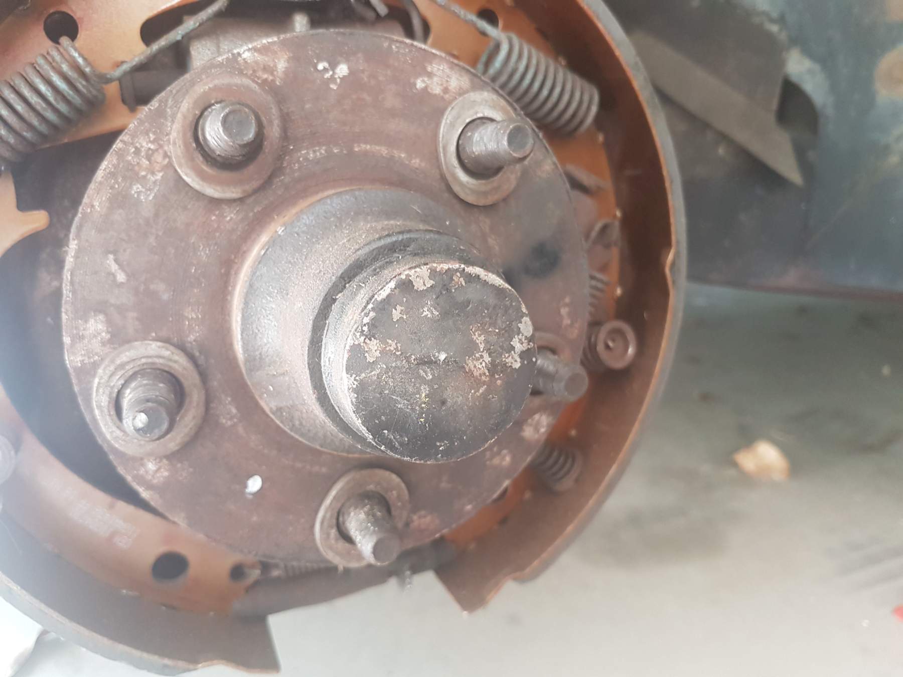

I have a tech question. Whilst fiddling about measuring my wheels, I thought I'd take the front brake drum off for a quick internal inspection. I found spacers on the wheel studs.
What's going on there-is this normal? I replaced the drum with & without the spacers and it seemed fine either way.20201210_151313.thumb.jpg.d221a75a6dfa433c5a238ec609e2a0f3.jpg
Spacers aren't factory. I think someone added them to prevent the drum from rusting onto the hub. That's my suspicion anyway.
That's an interesting theory Frosty. I've never seen "spacers" either and my drums were so rusted on from sitting 9yrs before I got my car that I spent hours trying to get them off. I tried everything from beating, prying and even heat. So my question is have you ever heard of somebody putting "spacers" in to prevent the drum from rusting? Was that actually a thing bro? I can see the logic in it.
i couldnt think of any GOOD reason to have washers there!!short of making the shoes contact a slightly different surface. certainly would not leave them in there👍

Yeah, I'll remove them and check the other front drum. The workshop manual shows no mention of them either. From the condition of the car when I took delivery, I don't think the previous owner would have been proactive enough to go to the trouble of installing 'anti rust' spacers in the drums. If the dude couldn't be bothered removing the soaked piece of filthy carpet that had been sitting in the trunk for years and causing all that rust, I doubt if he was ever under the car - that's apparently my job.
