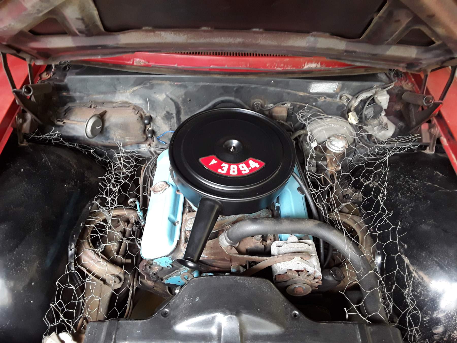

So, I was fiddling with the GP the other day doing some electrics. But, gotta put the battery in first so I pop the hood and there on the battery tray is a bed of discarded chewed seed shells. Then some movement catches my eye and a rat is looking at me from on top of the inner fender. I startle it and it deftly climbs across the engine and promptly disappears. I brush out the shells and find another collection on the little steel platform on the other side of the radiator, so I clean that up too. Then I mask and glove up, get the compressor going and blow the entire engine bay, with shit going everywhere. So, after fiddling with the electrics and getting nowhere I decide to fire her up coz it's been a while but I want to do a compression test first. I methodically disconnect one by one the HT leads and label them as I remove all the plugs and it's then that I notice that the ONLY item of any consequence in there which I had custom made is the solid core HT lead from coil to distributor, and that f#%&@ng rat has chewed through it. Enraged, I invent swear words that make no sense and yell them to nobody in particular. It's time for war.
After the comp test (BTW that old engine appears to be quite healthy, all around 170-190 psi) it's time to fire it up. I reconnect everything and wiggle the low tension wire that feeds the coil and it falls apart in my hand. After I fix that, I crank the engine but it won't fire. I get my trusty syringe (no needle) and carefully fill the front float chambers with fuel to avoid endless cranking. She fires up, but stalls after a couple of minutes. No fuel in carby. I release tank filler cap and hear the sound of escaping air as I release the vacuum. Vent pipe is connected and clear - it's a problem for another day.
Anyway, today I bought 2 different rat traps and as you can see from the photo, I always wanted a Rat Rod! Chicken wire everywhere, mothballs in the car, 2 traps set. I hope that thing is dead before I get to it, for it's sake.20201218_163826.thumb.jpg.2edbcd28baa902f01b2de8c9a8a3e326.jpg

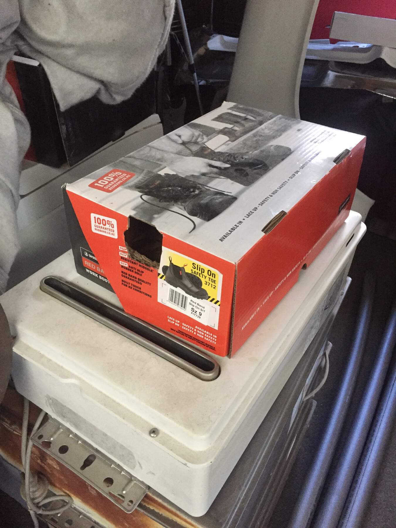

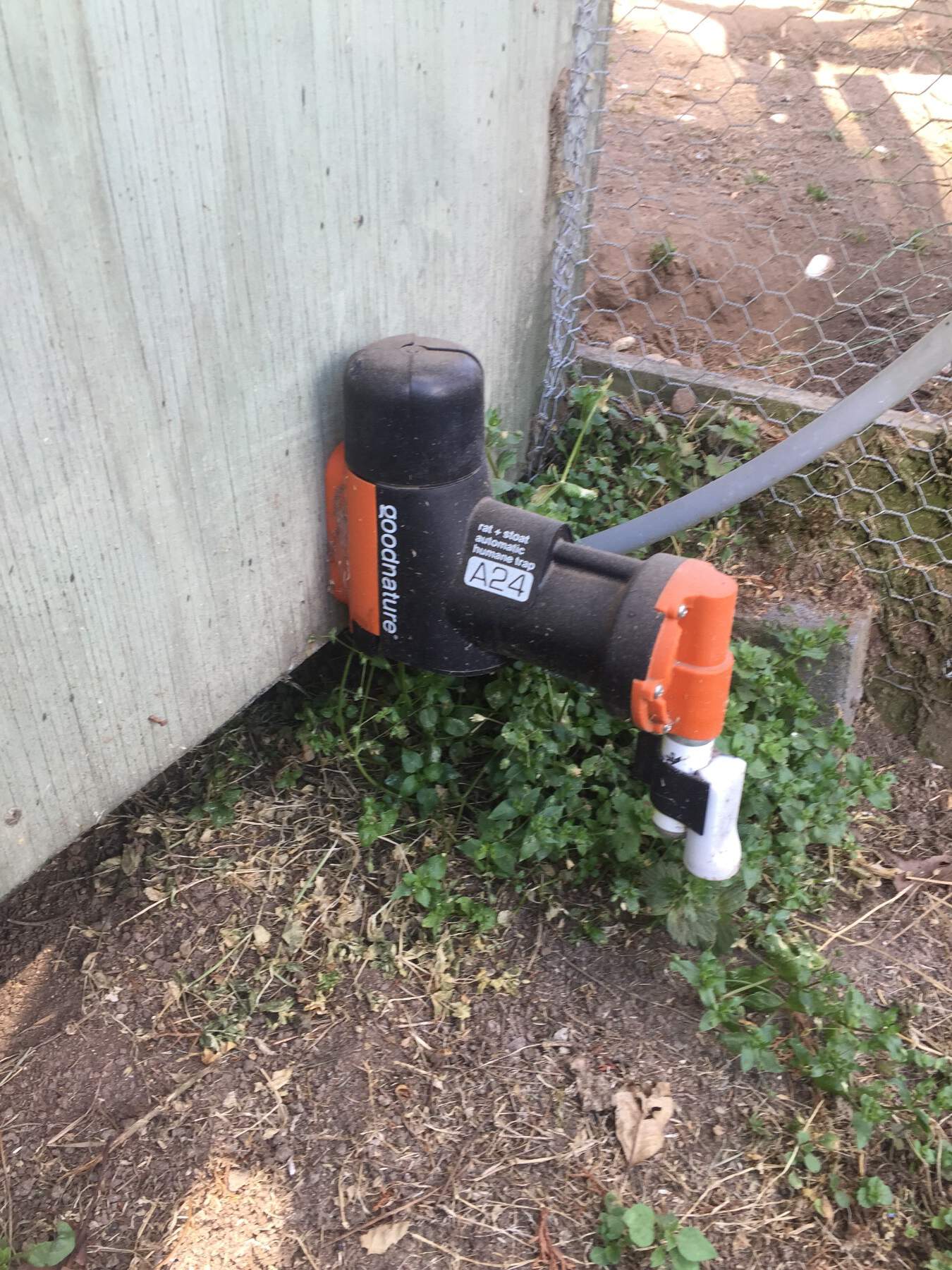

Here is the $200 gas powered trap that has caught zero rats !!!4815A7AB-63C5-46C8-A1FE-BBE346C1A10B.jpeg
And here is my old shoe box, small hole cut in one endF031D2D4-E61E-40E3-B24F-FA941647C5EB.jpeg

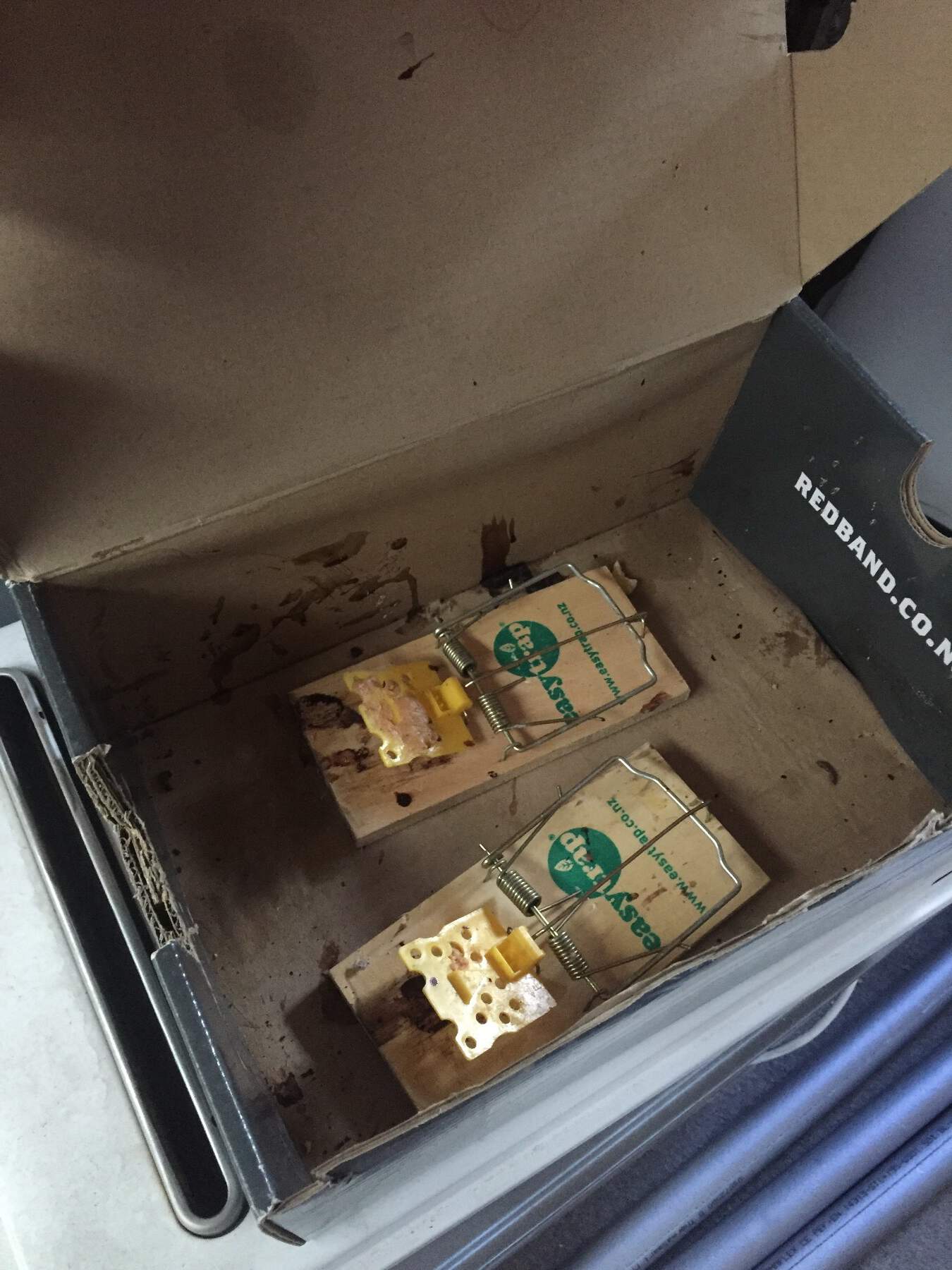

And 2 cheap- as traps inside... you can see its works justA fine, lots of blood and guts from all the rats that fancy peanut butter !!!, and it just sits on top of a stack of water heaters in my shed👍48190A98-7AC9-4326-9F5E-6C7234E200CB.jpeg
Nice work. I set one of those spring traps with peanut butter and it ignored it. I also set a Nooski trap that remains untouched. I chicken wired my entire engine bay, but left the battery tray accessible and put a throw pack of Ratsak nearby (ALSO ignored) AND placed some dryer freshener sheets (purported to be a rodent deterrent) around the place including on the battery tray. The f@#&ing thing left it's nut remains ON the dryer sheet on the battery tray.
I shall try the shoebox method - it's certainly worked for you.

Never seen that gas powered trap before, had to look it up. Interesting. Sad it can be beaten by peanut butter and a trap from the 1900s :lol:

Ah fitzy, just remeber the rats dont like open spaces,,,, stick your trap in a dark corner or along a wall, the f-ckers are cleaver as !!
laying sheets out around is his way of giving you the finger :rofl:
give him something hard to get into and he will see it as a challenge.... you will get him👍
yes Ringo,,, they are what the department of conservation use all over New Zealand and are supposed  to be great !!!!!🙄
dont work on my bush rats :rofl:

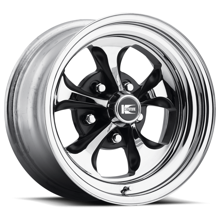

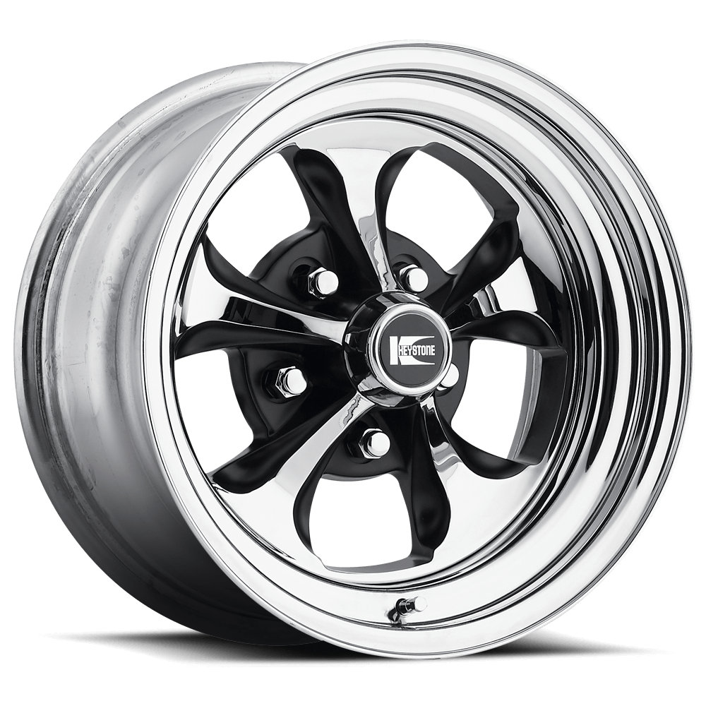

Fitzy - what about the old Keystone ET mags? Cragar now owns them, but they also have a 5 x 5 bolt pattern. So the JEGS catalog says anyway. If you are not a fan, I totally get it. The catch is they are 15 inch wheels.
https://www.cragarwheel.com/wheels/product-detail/series-32-keystone-klassic/
Hi Frosty, yep - another great looking wheel. I can't remember if I posted this info, but I borrowed a friend's 15" Buick steel rim (5 x 5) and attached it to my car and checked for clearance when it came off the jack. There was about 5mm between the outside of the tyre and the rear spat (everywhere else was fine) but the front was an issue because the wheels would foul the fenders at anything approaching full lock. Yes, I lowered the car so the fault is mine but it's non negoitable - I WILL drive a long, low car! So, I would LOVE 15" wheels because the choices are numerous but I have to have 14s. I could fit a lower profile tyre to help, but you know what? I actually like 14s with 70 series whitewall tyres on old cars - it retains that period correct look. If I went with 15s, I can buy direct drill Cragars and voila, problem sorted. Or Rallye 2s, or Dragways or just about anything. The other issue with 15s is that 15 x 7 seems to be the norm, so once again, even if I fitted 50 series tyres, there'll be clearance problems, and that will include the rear, soaking up that precious 5mm clearance. I need to get those new front springs in to lift the car slightly and I will then reassess. Anyway, I have a fence to erect, a carport to assemble and a shed to build in the interim, so all of a sudden, wheels are gonna have to take a back seat for a little while. The OTHER issue with wheel selection is that buying direct from the US is a problem because anything imported into Oz over $1000 value attracts duty, as I found out when my last Ames order turned up. Once you factor in shipping as well, it's just not worth it. The Torqs can be purchased here in Oz, about AUD$180 each.
See, I've got an answer for everything! Laying in bed at 3am thinking through wheel selection is an activity I don't recommend, but it does make me sound like a smartarse.
