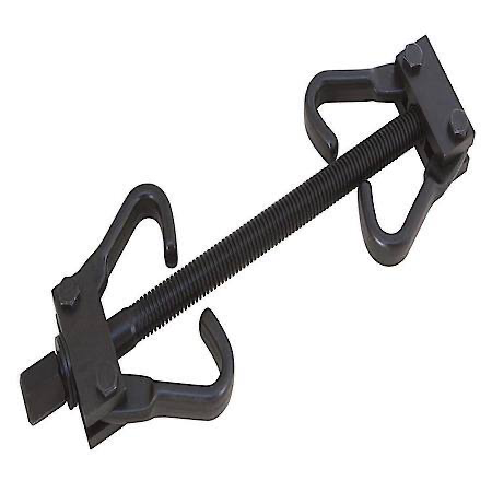

They make spring compressor tools of course. Just one more expensive tool you’ll probably never use again after this job. Any chances you can rent the tool form a local parts store?
You can put a floor jack under the lower control arm, release the castle nut and cotter pin from the spindle and SLOWLY lower the floor jack to gradually release the spring tension. You may need to whack the ball joint with a hammer a few times to release it from the spindle before you try to lower the jack.

I'll need a spring compressor to get those front springs out. I've never used one but from what I've read you are dicing with death! Any tips on how I might live longer whilst compressing those giant springs, apart from paying someone $100 an hour to do it for me? I've also ordered a front end rebuild kit. I'm going to need a ball joint separator, a pitman arm puller, some biceps...mind you, one hour's professional labour rate will pay for all that. Believe it or not, I bought that car to give me something to do in my spare time. My 'spare time.' Let's all ponder that for a moment. What was I thinking???

As far as taking out the springs, yah most people are a little unnerved about it when they haven’t done it before! There are many ways to remove them, but for the type of springs you have I would recommend the standard standby. See below this type is fairly inexpensive, not much to store after the fact and when used right very safe!
you simply take out the shock, install the compressor arms through the center of the spring then the treaded shaft installs to them! Using a socket and ratchet tighten, which compresses the spring. Once you’ve done that, you remove the castle nut, but it’s a good idea to break loose the nut first before you take the tension off the Aarm from the spring, but don’t remove the nut.
once the spring is compressed you need a, preferable, floor jack  under the Aarm. Take the castle nut off, turn it upside down and thread it back onto the ball joint shaft, leaving about an 1/8 of an inch of the nut sticking above the ball joint shaft. At this point, using two hammers, place one hammer on top of the castle nut and hit it with the other, you could also use a chunk of steel in place of the first hammer, but the second hammer, the one you swing should be a good beefy one, two pound short handle sledge would be good! This will release the ball joint shaft from the steering knuckle. Now lower the floor jack slowly. You will need to most likely push the Aarm down further than it will go on it’s own, so make sure you have the car raised up high enough. Now remove the spring! Place the spring, if you can in a vise, side ways to remove the compressor.
To remove the ball joints is fairly easy! All you need is pipe! Get yourself a piece of pipe that fits the outside diameter of the ball joint. This goes on the bottom side of the Aarm, between the Aarm and the ground. It should be as close of a fit as you can get, but the ball joint itself should be able to fall right through it. The top side needs a piece of pipe the fits the top of the ball joint! Again this piece of pipe should fit a body edge of the ball joint, but fall through the hole in the Aarm when the ball joint is out. Placing a flat piece of steel, 1/2 thick or better, on top of the  top pipe and using your big hammer, strike the flat plate with good force! This will drive the ball joint out, but it will take multiple hits to do so!
Making the bottom side pipe as solid to the ground and Aarm as possible will make all the difference in transferring the energy to drive the ball joint out easily!
To install the new ball joints put them in the freezer overnight! While keeping the ball joint cold use a burnz-o-matic and heat the hole area where the ball joint goes, about 500 degrees f. Doing this will require almost no press fit, just some light tapping at best, but you must be quick.

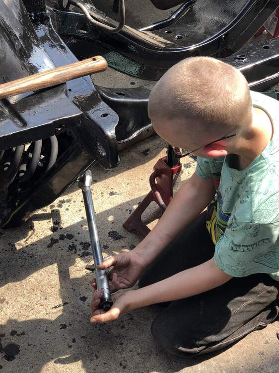

All great advice, as always!  So all I'll add is the spring compressors really aren't that hard Fitzy, I heard how dangerous they were and all the stuff about the tool braking and spring flying off and killing you also bro. JUSTA  take your time and go slow bro. You can see how I did mine on my 63. I rented the tool from the local parts house and in that pic my son is ratcheting to compress. Now I wound NOT let him remove the springs but I did let him compress. Good luck bro
Sweet pic.  Waaay to get the boy involved in our obsession.  Priceless.
Thanks guys, I love that he's so into cars and enjoys working on them. Its memories that he'll be able to share with his kids and your right bro, its priceless!
