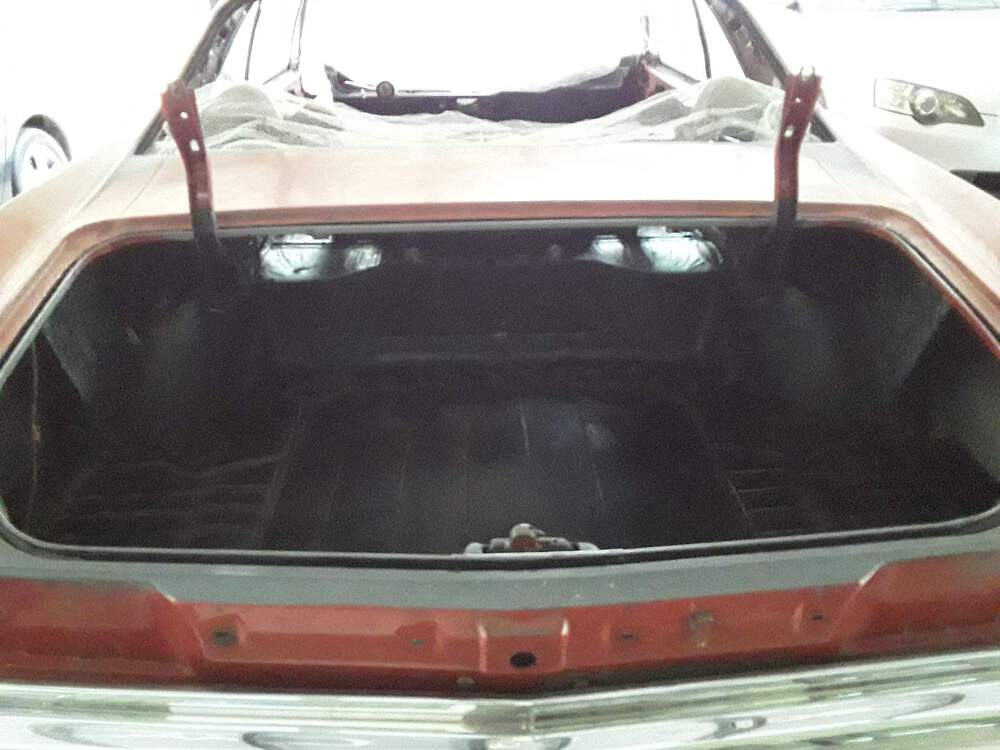

So...yesterday I achieved a milestone. I've had the car about 10 months now and have peered into that rusty trunk almost every day mumbling to myself that I need to get in there and get rid of that ugly surface rust. I planned for the event the day before and then spent the entire day washing & wiping dry, wirebrushing and hand sanding every panel, nook, cranny and piece of hardware from the back seat brace panel to the back of the car, all the time contorted into inhuman positions. Amidst all the rusty dust I found the last remnants of vermin nests that obviously came from the old rear seat padding that had migrated into those side recesses inside the rear quarters. I hooked them out with a piece of wire and then emptied the side lower portions of the trunk, down beneath the spot welded panels that form the sides of the trunk floor. I used an air hose to force out bits of rusty metal, old caulking remnants and 55 year old dust, mixed with ratshit and rusty dust. Yes, I wore a mask and then I brushed rust converter on all areas. I crawled outa there a broken man, whimpering and hobbled into the shower to de-contaminate.
Today's task is to get back in there, wipe off the rust converter and chuck a coat of rust preventative paint on all areas. This is one of those jobs that you do ONCE. Remember, I bought that car so that I had something to do in my spare time - I never envisaged being covered in ratshit was to be part of the ownership package. This is the sort of thing you need to keep in mind when purchasing a restored car.  Sure, the owner is asking a hefty price, but HE got covered in ratshit whilst all YOU have to do is tool around looking cool.
Apologies for the crappy photo - we're experiencing unusually inclement weather right now and the lighting is not good.20200830_083613.thumb.jpg.405983318e863a0434b5129ad1cf55b8.jpg

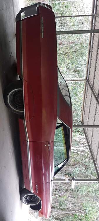

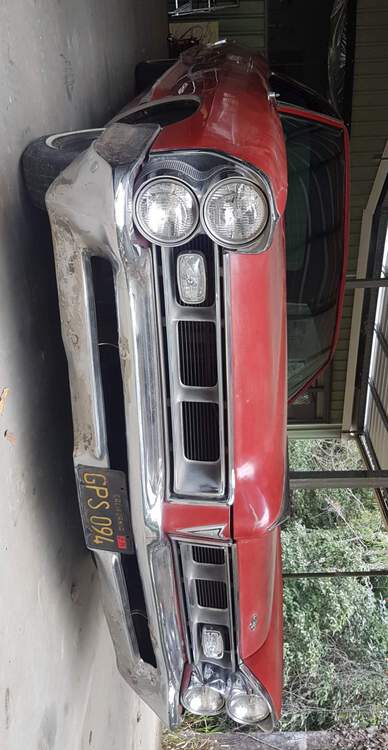

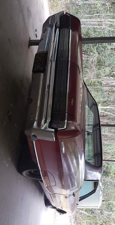

Hey, it's been a bit 20200928_094000.thumb.jpg.5b1c2eadf75394c04e818e9ebb764267.jpg20200928_093912.thumb.jpg.b8f2839efd58c89ac816ae593b446bcd.jpg20200928_093937.thumb.jpg.b6ab4917643f5e94a1ebe1e495ad09c4.jpgof a week and I have news to report. You may have or have not seen my posts on my trunk lock problem finally sorted (it's a good story - look it up) and I finally have closure on the dramatic lowered rear spring dynasty of misinformation and bungled deliveries from 2 US major supply houses.
The trunk lock on a 65 GP is a rare beast. My housing was intact but the barrel was shot, so I ordered a similar vintage Cadillac barrel and got a locksmith to make it work. This doesn't sound like a big deal, but after many months of finally working out how to fix the problem, it was joy incarnate to close the trunk and then open it with a key. More to the point, it now allowed me to reattach the rear fascia, rear light top trim pieces, rear light assemblies and then adjust and retighten the rear bumper so the back of the car is once again almost complete.
Now, lowered rear coil springs. CarID and Summit Racing both sent me the wrong product. After many emails and me repeatedly pointing out that the GP is a B body and not an A body both suppliers refunded me fully including international postage. In the end, because I was fussy, I got a set of 2" lowered front coils from ESPO Springs & Things and a set of custom made 1.5" lowered rear coils from LLC Coil Spring Specialties who were the ONLY company I could find who knew what they were doing. Now, I have learnt that A body Ponchos seem to be the most popular and most revered amongst the models. The spares support market seem to favour those models but they mistakenly include the GP amongst those A body models. Personally, I think the fullsize models are more carefully sculpted and are therefore the more stylish of Pontiacs but I can understand why a performance oriented owner would go for a GTO or similar. I'm obviously late to the party, but if you are also restoring a B body, be 100% aware of what you are ordering because it seems that Joe Six Pack who works in a parts house thinks that all Pontiacs are GTOs and yeah, these'll fit. Take it from me, they bloody won't!
Anyway, take a look at the latest photos. I took out the ancient Montgomery Ward rear shocks,  finally got the old springs out and installed my new lowered ones and some fresh Monroe gas shocks. Want a fullsize hardtop to look even cooler - drop it!
Sorry about the photos. I'm too stupid to work out how to correctly orientate them.
pictures didnt work Fitzy, you may have the same issue i am having with up loading since the up grade to the site🙄
Try that. I cropped the pics and computer won't rotate them as directed, because it's being a prick.
