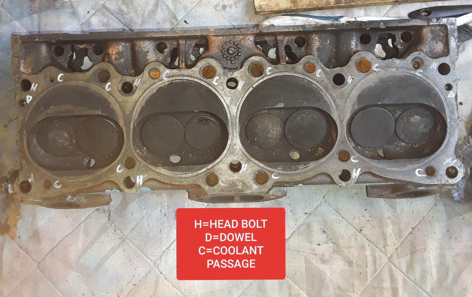

Can anyone throw me a bone with this one? Take a look at the pics. I carefully examined the head to ensure that the coolant holes were indeed coolant holes. I then placed the old head gasket on it to ensure that IT was the correct gasket, which it was - all the holes lined up. I then positioned the gasket on the block and stood there scratching my head wondering why so many coolant holes were filled. So I did some gentle exploratory drilling and it was like I was drilling into metal, complete with shiny metal swarf coming out of the hole. Anyway, I persevered with one and after a few minutes of drilling the drill broke through whatever that crap is and exposed the water jacket. Now, what on earth is going on? That rock hard compound almost seems like what I imagine engine block filler would look like. Is that possible? But, it doesn't extend far enough beyond the surface to be filler. I am perplexed. Anyway, tomorrow I'm going to carefully measure the corresponding head coolant holes and drill the block to match. Like I said - look after your cooling system and you'll avoid the heartache that the previous owner of my car must have experienced before they gave up and just parked it.
I also chiselled the water pump/timing cover dividers away from the housing and will have to replace them. The last job was panel beating the oil pan into a respectable shape, so that it doesn't look like it landed on an aircraft carrier at 200mph.
I'm now thinking of just finding a 455 and bolting it in and driving off into the sunset. Good idea? Extra cubes, more modern design, should hook up to my TH400 no probs.

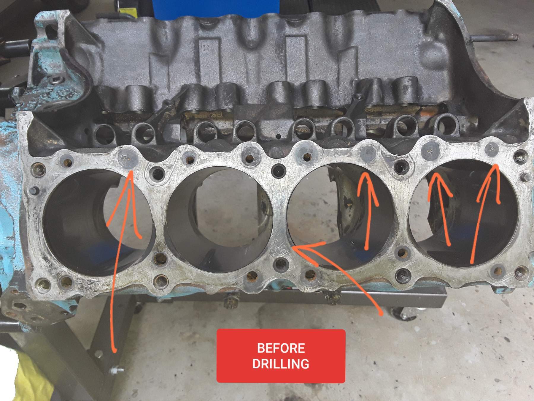

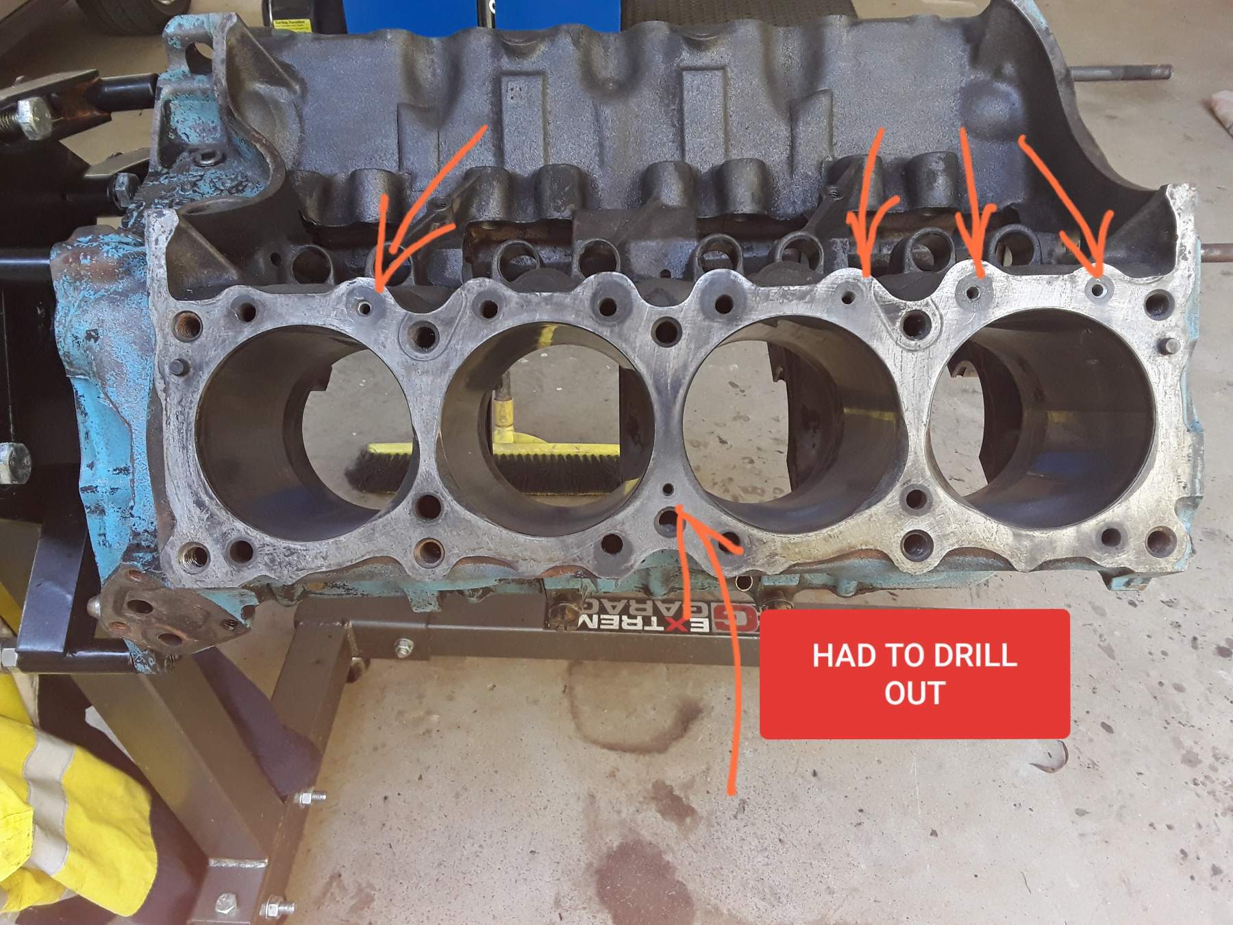

Only bone I can toss atcha is the damn radiator leak seal???  Your dumping pulverized metal into your system, plugs any hole it finds and melts together when the temp is up.  Never seen anything like that in the heads. You would have to use a shit-ton of that stuff. Previous owners......if the block could talk.
Yeah, I thought it might be the effects of a stop leak solution, too. I found similar 'melted metal' on the water pump vanes. I still can't believe I had to drill through what appeared to be proper (although quite soft) metal.

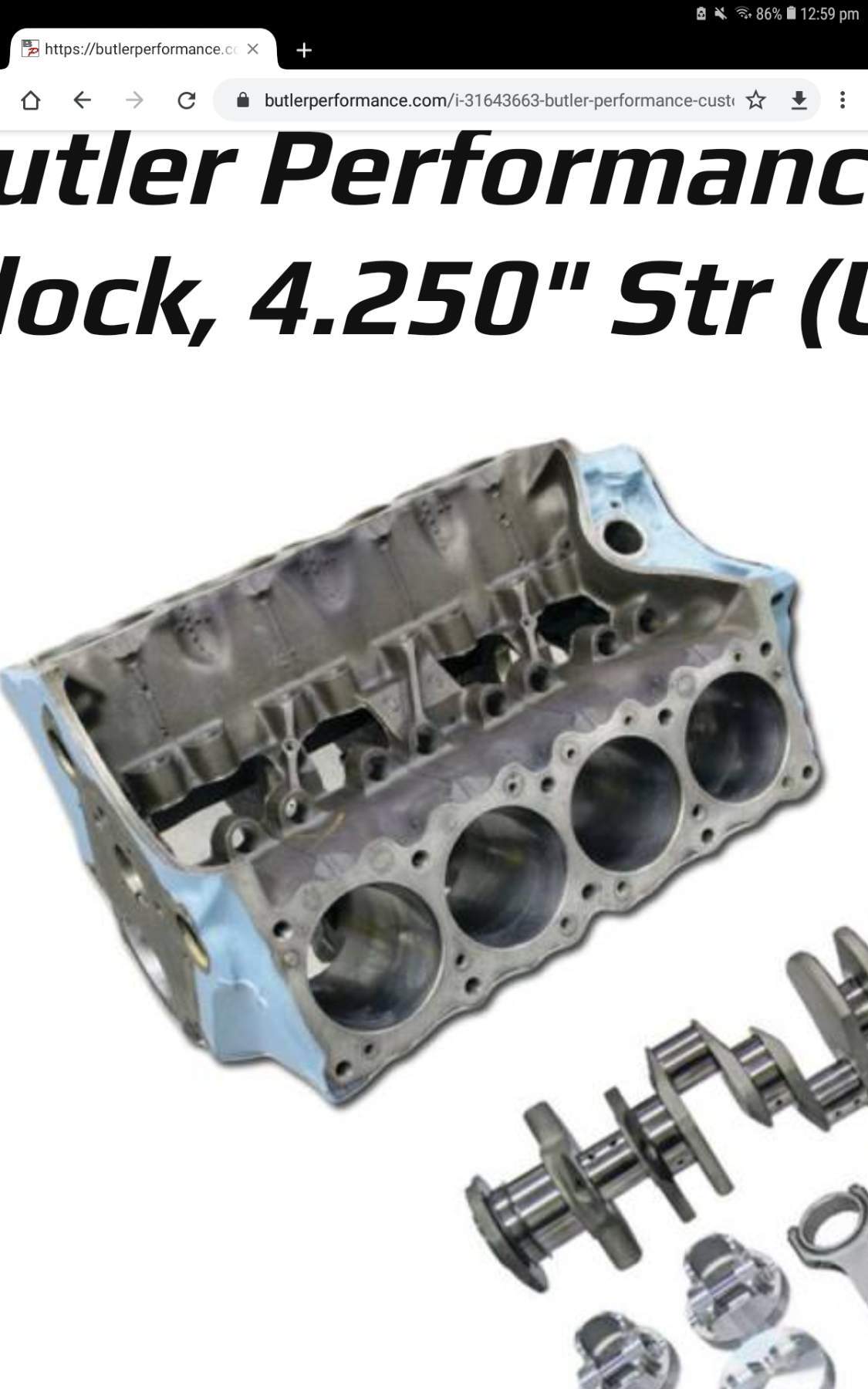

This has got me worried. What is going on? This is an image from Butler advertising one of their short block kits. Have a look at the 'blocked off' coolant passages. Don't tell me that's how it's supposed to be? The head gaskets & heads have corresponding holes though.
I finally found some references & discussion re blocked coolant passages. It seems this is a factory mod and directs more cooling water to the back of the engine, but it wasn't always this way. The higher performance 421s had all those holes operational. There is much talk about whether it was a cost cutting exercise or if it helped to maintain structural integrity around that part of the block. Anyway - too late! I drilled them all out. Most of the US experiences extreme cold and since I live in the tropics, I reckon the more coolant fhat flows around my block, the better. We will see.
very good point there Fitzy, i wouldnt worry about extra coolant passages, you can control flow through the block with different thermostats,
i personally would have done justA what you have done if the heads have passages too:cheers:
Yeah, what a weird one. You go through life and eventually as you get older you think you've seen everything and then something like this jumps out at you. Now I'm going to start worrying about what the machinist is going to tell me once they start inspecting the block & heads. Maybe I'll luck out and it'll be one of the legendary Nascar engines that went missing 55 years ago and it's rated at 800hp, but no, more than likely it'll be the Church Minister Special with 7 to 1 compression and puts out 120hp, but only on Sundays.
