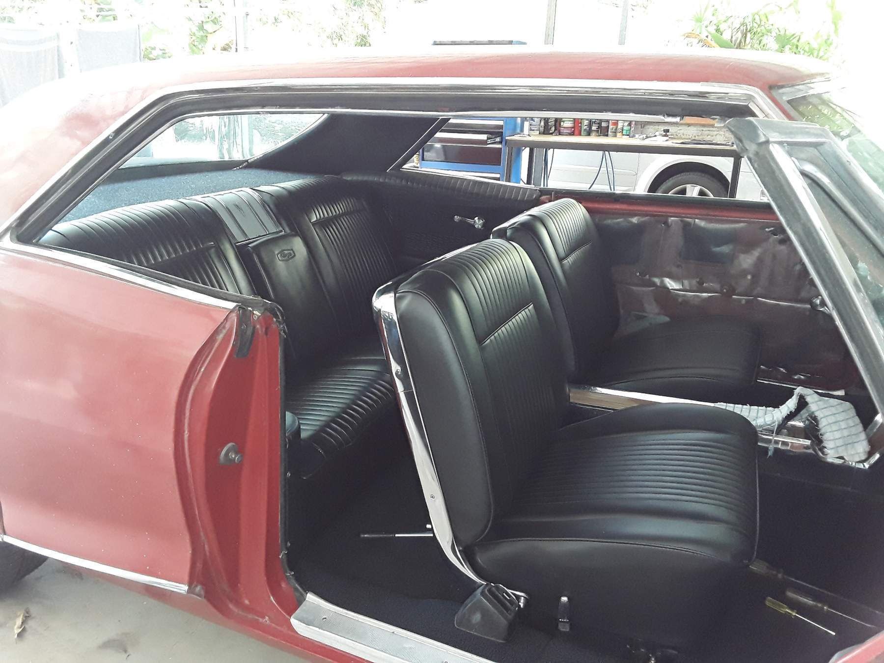

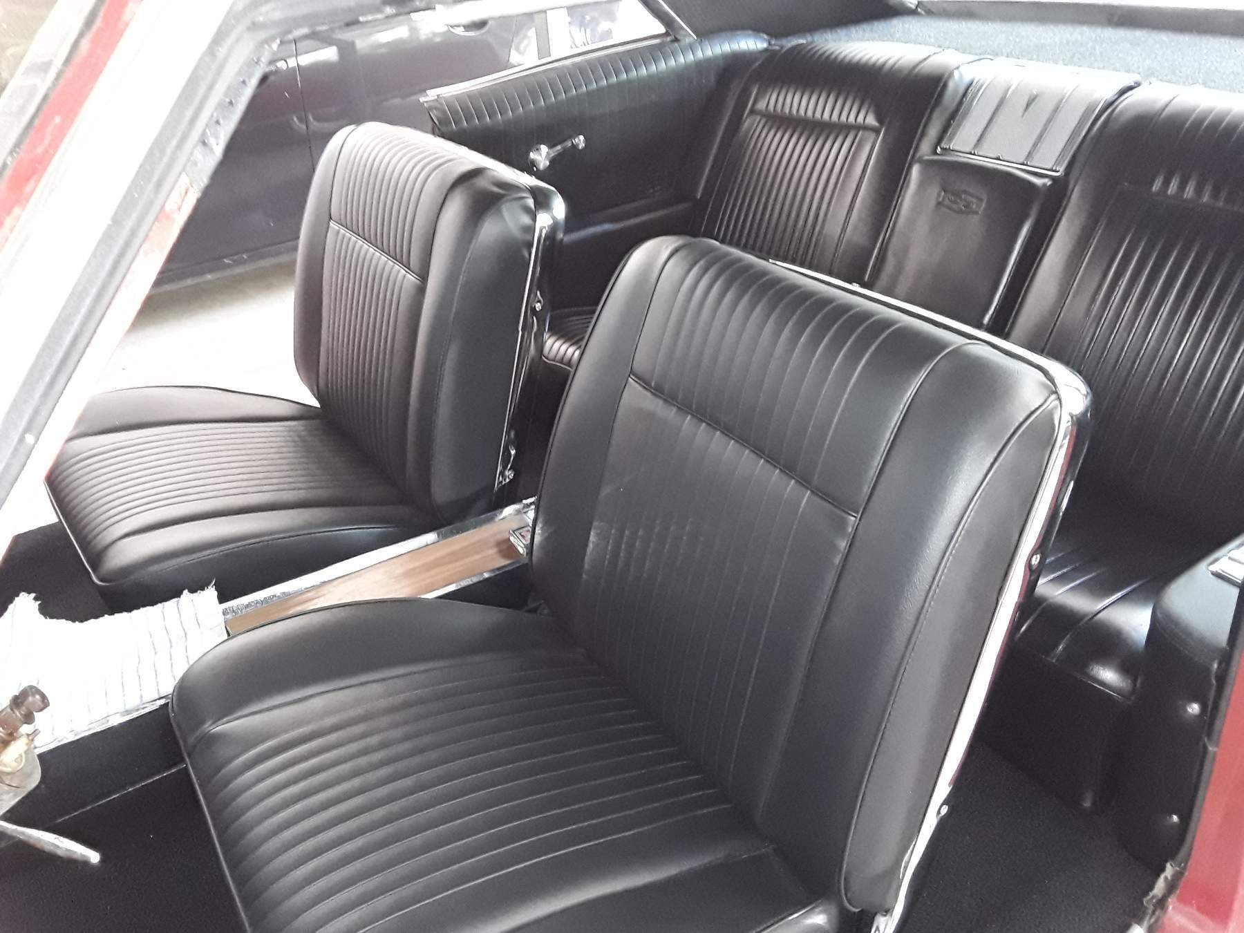

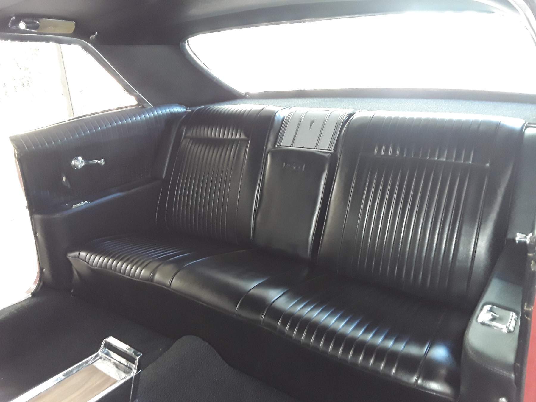

Check it out: back seat and trim finally in! It's at this point that I'd like to remind fellow lunatic restorers that when you start pulling a car apart, take notes & photos and put all those little nuts, bolts, screws, springs and other assorted paraphernalia into ziplock bags and label them. It's been almost 2 years since I had everything apart and boy, am I glad I took my time and documented everything. I should have both front seats in tomorrow.

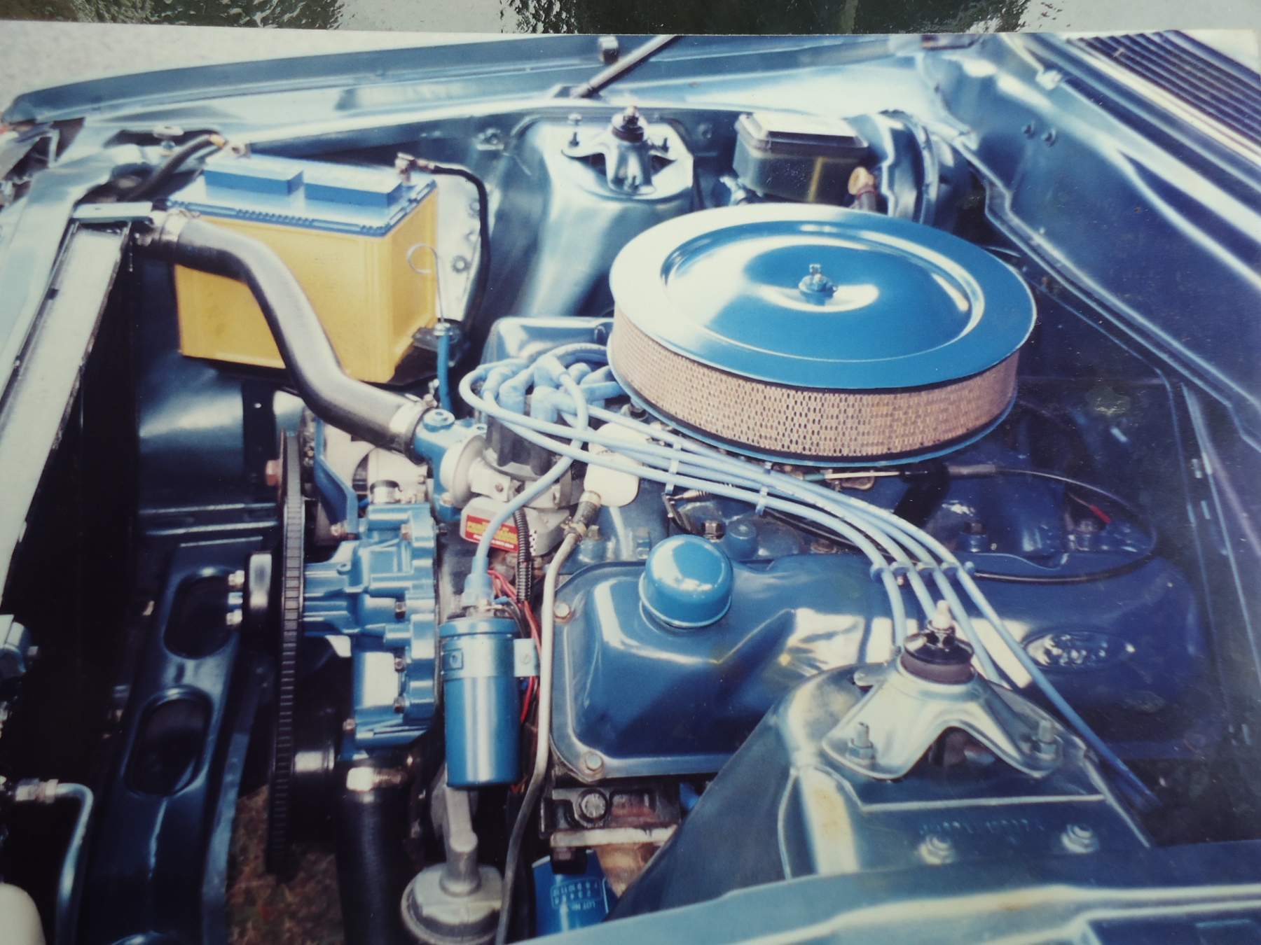

The other pics are of the last engine I rebuilt and cleaned up the engine bay - 351 Cleveland stroked to 378, removed aircon & power steering (are you seeing a theme here?) and fitted a thermo fan.

now thats looking good mate:cheers:

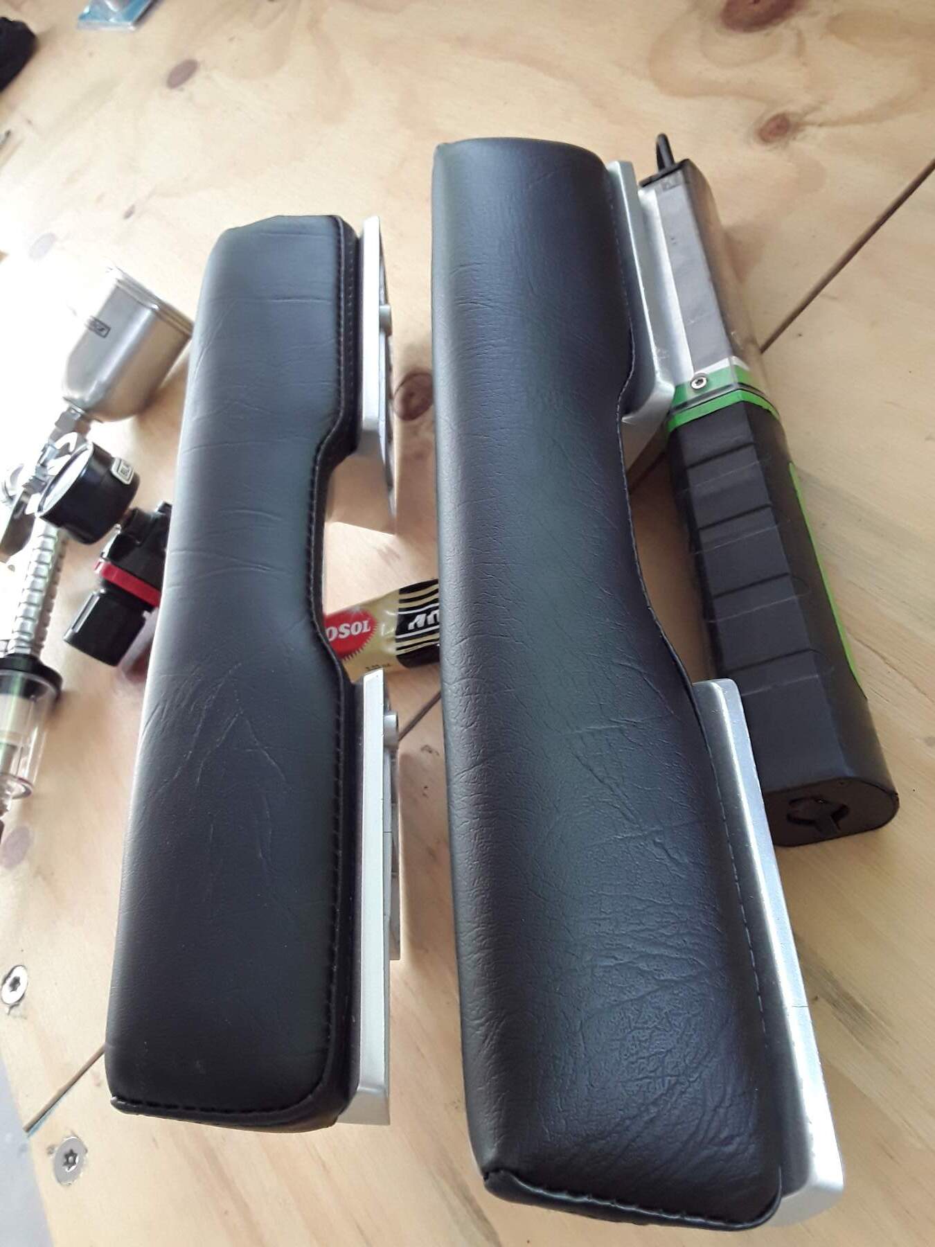

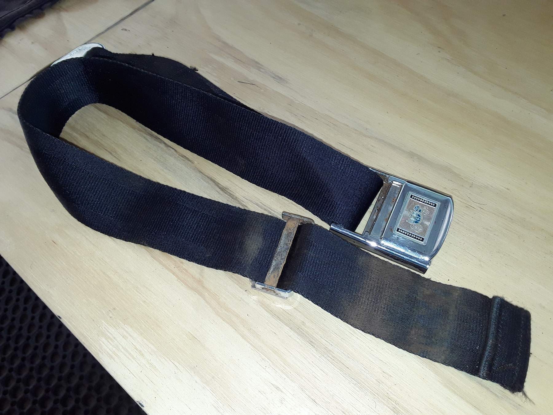

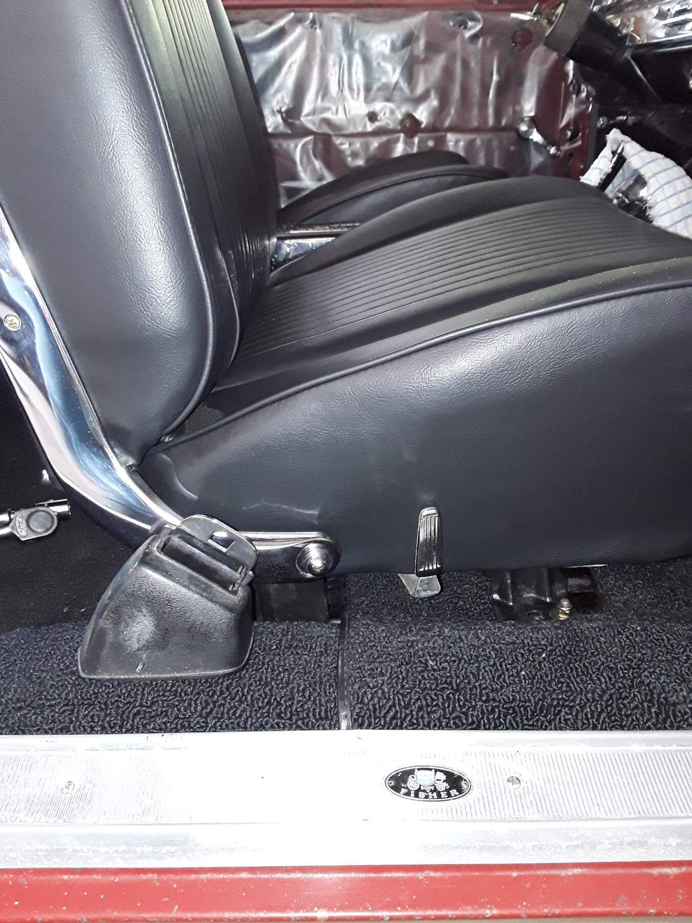

Anyway, let's move on: today I got some shit done. I installed both front buckets and their retractor seat belts. These are notes for anyone else who has got their reupholstered bucket seats back. The little chrome press fit retainers that ensure the seat back doesn't fall out of place require a good, hard shove. I placed the bucket on it's side, then with a folded thick rag, applied as much pressure as I dared, gradually increasing the intensity until it snapped into place - the retainer that is, not one of my vertebrae. They can be misleading: keep applying pressure until it really sits in place. Then it was time to pull apart the rusty innards of the seat belt buckle so as to enable the hapless passenger to tighten their belt as the horizon looms closer ever faster. I had to google the procedure, all you need is a screwdriver and the desire to send it's blade through your palm. Having been a previous victim of screwdriver attack many years ago, I evaded another injury this time. You need to pry up on the chrome piece adjacent to the buckle and slide it back - more difficult than it sounds. Anyway, I cleaned up the rust and now it adjusts like it should.

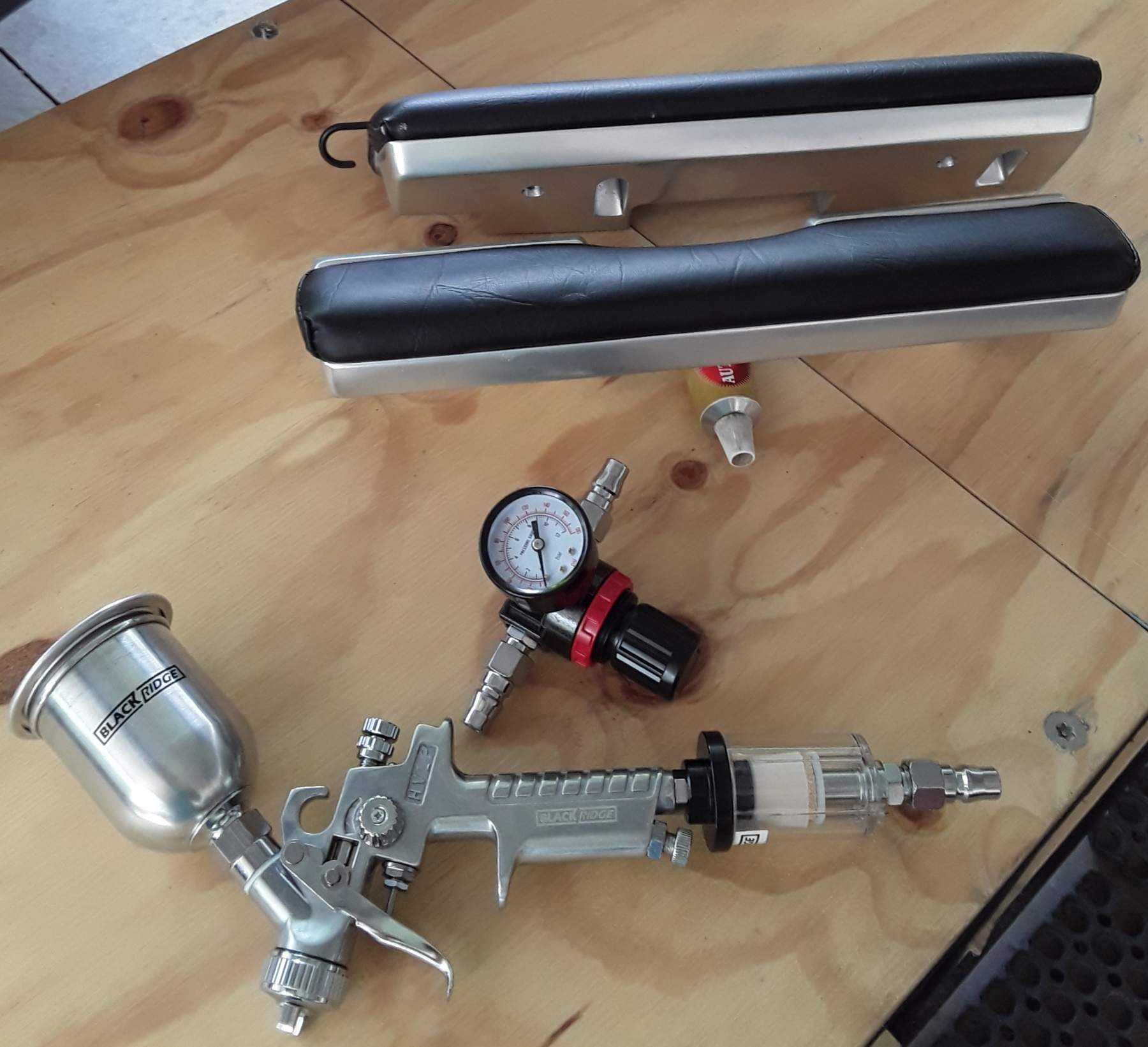

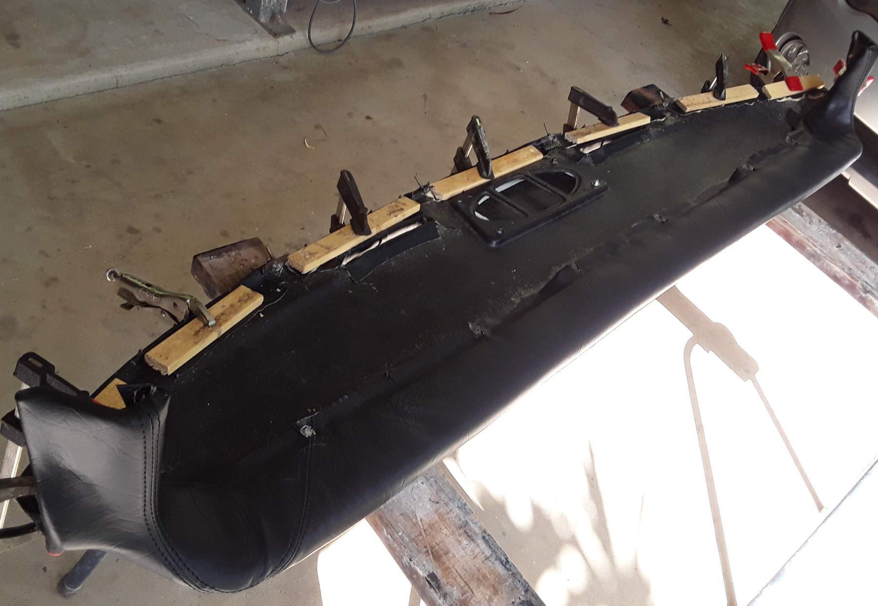

I also attached my newly upholstered front armrest pads to their bases. They are now better than factory, because they're stitched. The final unpleasant job was to undo the dashpad upholstery and remove some of the padding, to enable the pad to sit on the dash the way it's supposed to. It took several goes but I got there in the end. Just waiting for the adhesive to set now, and hopefully I can chuck it back in the car. When my new front door panels turn up, I think that's gonna be it for the interior.
Oh, and I picked up a cheap spray gun set for $80! It includes 2 one litre gravity feed guns, one touch up gun and a regulator. Even if it only lasts for a couple of jobs, it'll do.

the seats look great mate! !! well done:cheers:
