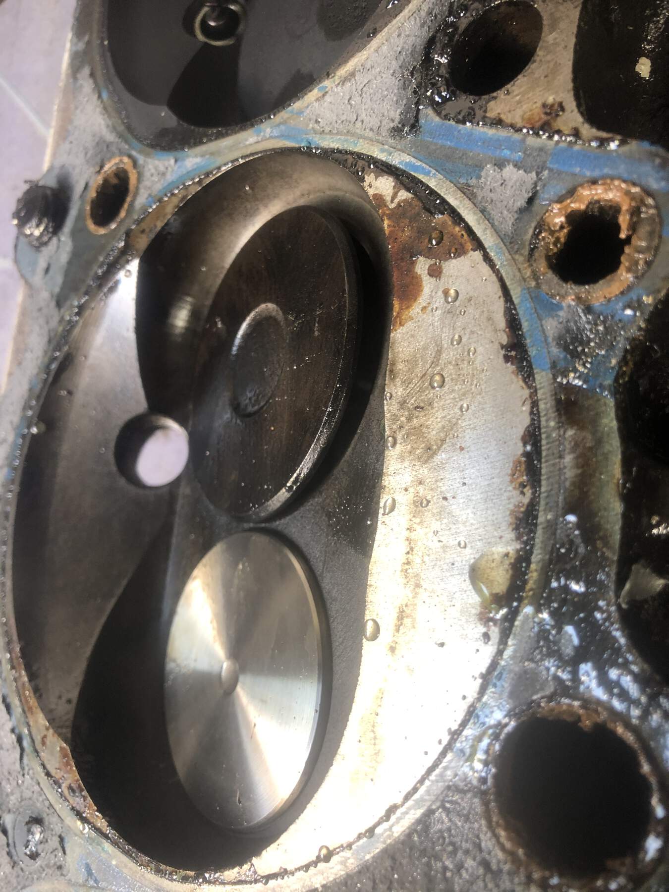

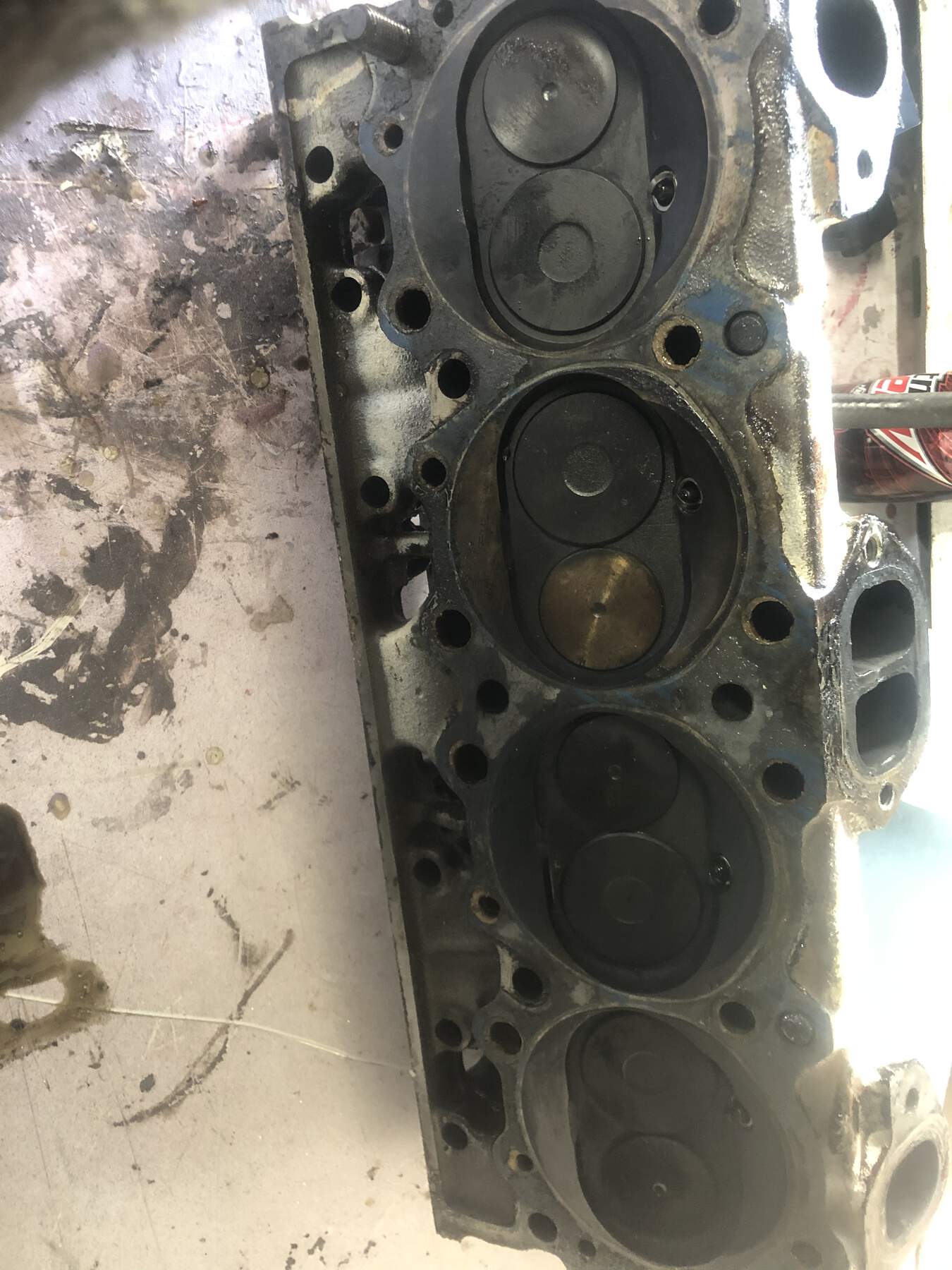

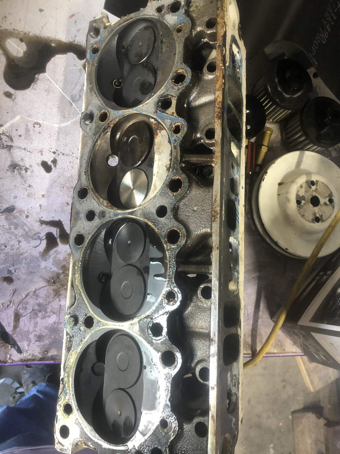

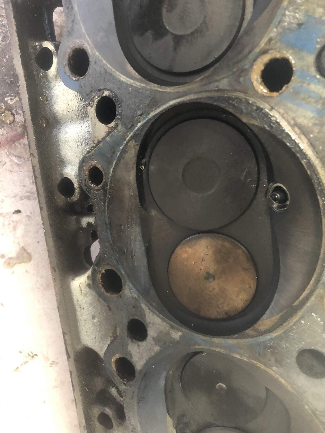

So I pulled the heads today I thought y'all would be interested.
I do believe I see some bent valves.
Glad you found the cause and can finally get to fixin it right.
Yes sir Bear, you are correct.

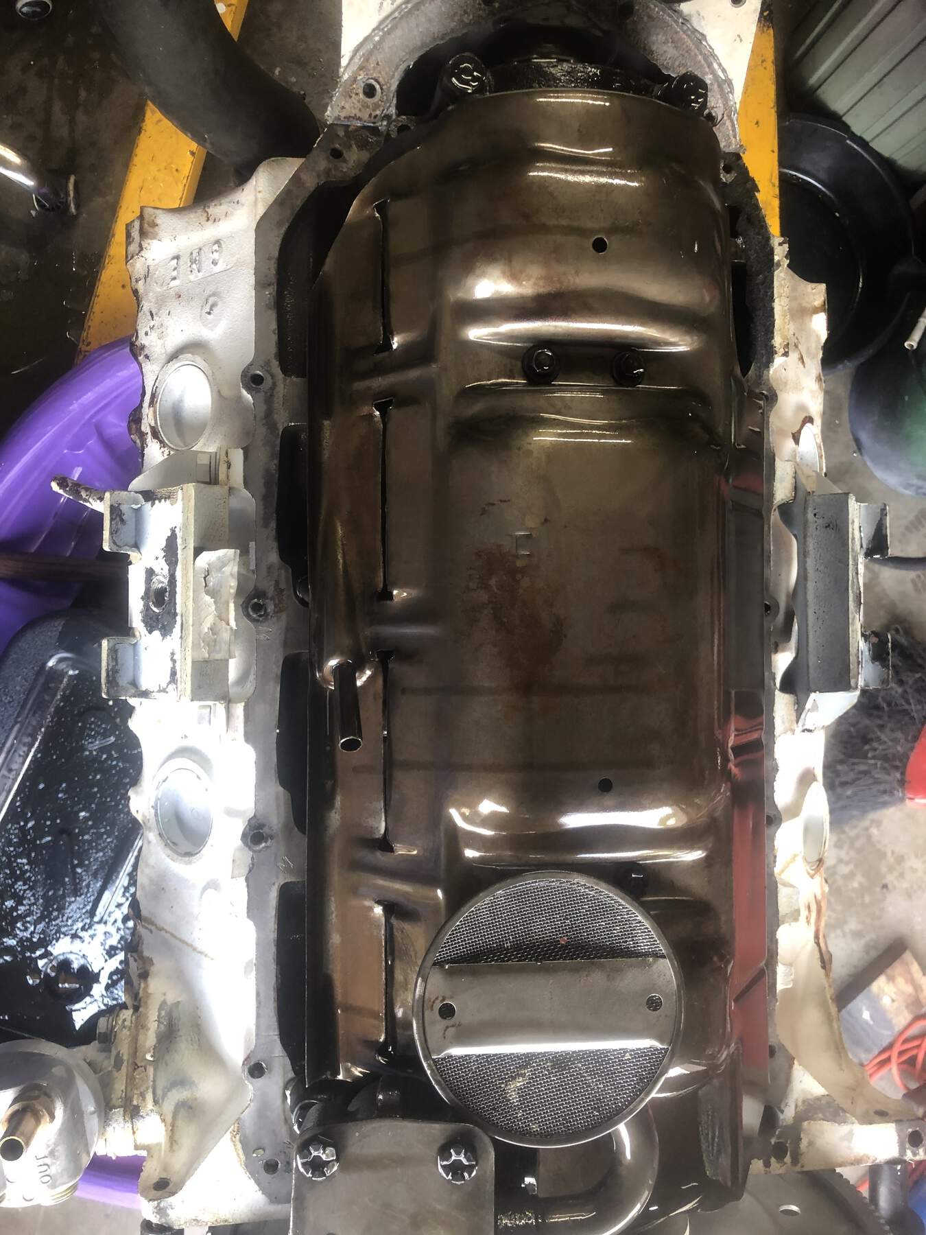

Ok so great news so far. I have found NO metal in the oil. I did actually expect to find I tiny bit from all off the new parts breaking in. But none! I even ran it through a filter. I also shut the lights off and used a flash light. So now comes the stupid questions lol. Id still like to open up the oil pump and look/flush it out. Any danger in doing that? Also, it was suggested that I should cut the oil filter in half. I think by Last Indian, how can I cut it open without creating metal dust during the cut?

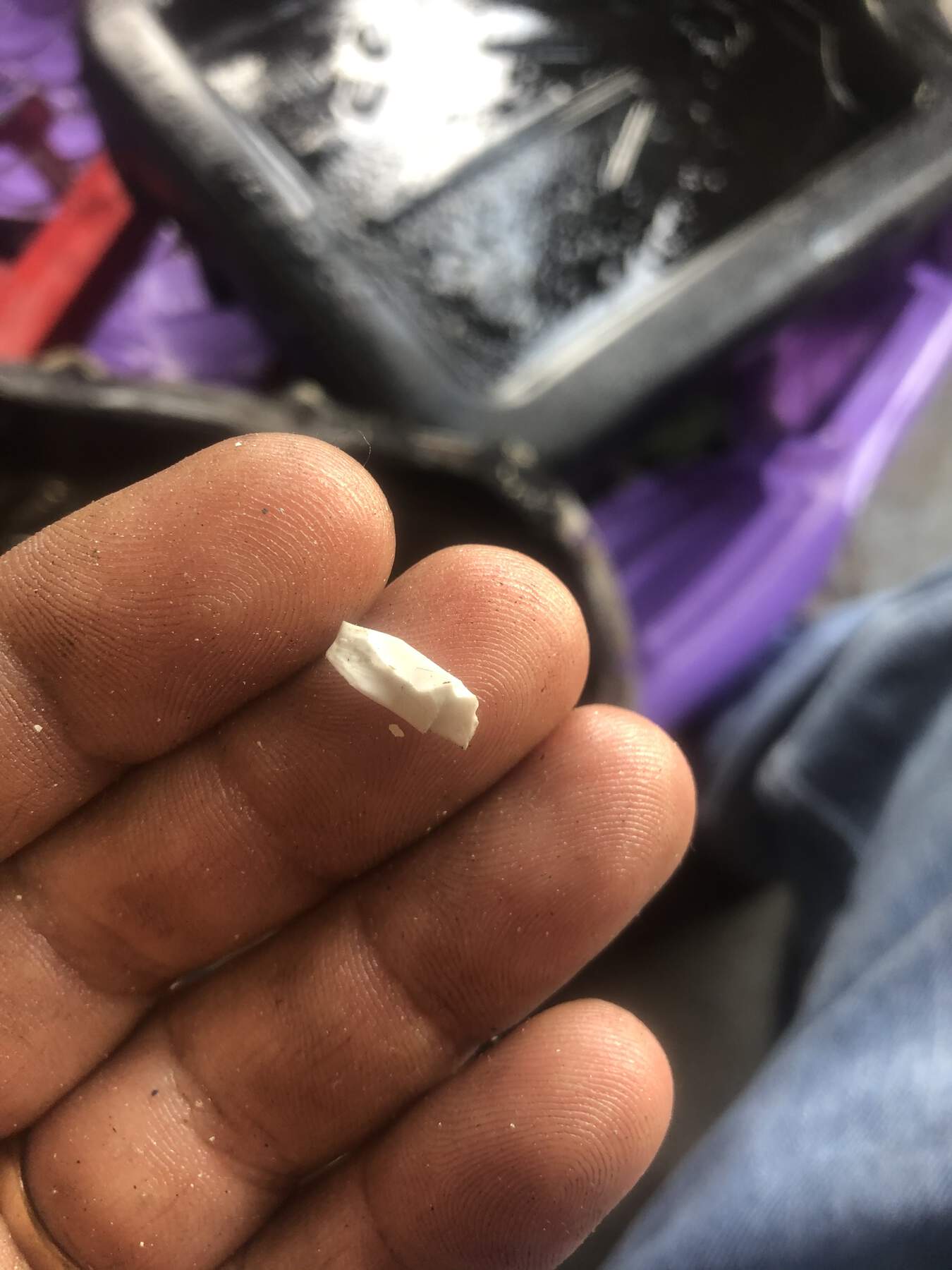

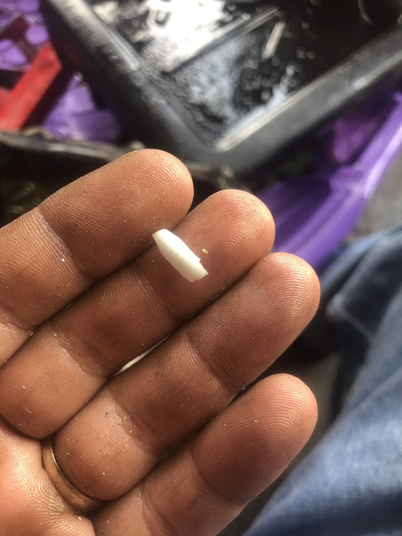

Ohhh btw, I did find this in the oil pan. I have no clue what it is or where it came from. Any ideas? Its bright white but matte not glossy. Its plastic, not porcelain so I'm guessing its not from a plug.
Sounds like you're finally catching a break or two on this.  That's good.  It was me who suggested cutting open the oil filter.  There are some nice tools available for doing it, but you may not want to buy one yourself.  They look and work like large tubing cutters.  The manual way to do it is described here:
What you're really interested in is removing the paper and spreading it out so that you can eyeball it for "shiny bits".

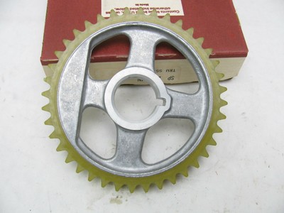

My bet is that it's a tooth from the factory cam timing gear.  There was a period of time when those gears had not metal, but nylon covered teeth.  The idea was that it made the engine run quieter.
Edited by BearGFR
My mistake and apology Bear, I didn't remember who suggested it. Thank you for the pics and I will find a way or buy the tool to cut it open bud. I replaced the gears and chain with a new set on 1st tare down. So that may have been hiding in there someplace. Thanks bro and yes, finally good news lol.
There no harm in opening the oil pump to look inside for any contaminants...When you pull the cover just make sure that you don't damage the paper gasket...The gasket thickness is instrumental in determining the clearance of the gears inside the pump..Also mark the gears with a sharpie so you can be sure that they are oriented in the same position with each other as they were to begin with..Upon reassembly...A very slight amount of wear is normal on the cover...Something else that is often overlooked that is definitely worth checking...When you reinstall the oil pump..Drop the distributor in without the hold down bracket or the  gasket and let the distributor and the oil pump drive just rest in position naturally....Then measure with a feeler guage the distance between the bottom of the distributor and the engine block...Then measure the thickness of the gasket...Most gaskets are around .020 thick..but thicker ones are available... So if the measurement between the two is excessive... more than  .005 - .010  when you lock the distributor down it pushes the oil pump drive rod down on the pump gears too tightly against the cover of the oil pump and will cause premature wear...Send metal shavings through the entire engine and eventual failure of the pump...In order to prevent that from happening you would have to grind down one end of the oil pump drive rod in order to attain the proper clearance...Ideally when the distributor with the gasket..locked in place the pump drive rod should have right around .050 to .060 of up and down play between the pump and the distributor....(measured with a feeler guage at the oil pump)
Looks like a piece of an exhaust valve seal that was in the oil pan.....
Wow, ok you just scared the hell out of me brother Black Top! lol. Maybe I shouldn't disassemble the pump. If you say I need to then I will or can I just flush it? If that was an exhaust valve seal, it should be ok after the shop does the valve job right?  I did cut the oil filter open. Its always so much easier on the video lol.  I found very few metallic specs. I'm thinking maybe from breaking it in. But very few. Everything else is looking at this point. I did however find some white engine paint in the filter, just specs and little piece's from when the engine was painted. See what y'all think.
Wrongway, glad you’re zeroing in on all the things that need addressed. The white plastic pieces you found? What type of valve stem seals did you use? With all the valve related damage you’ve seen it just might be from them!
Very true.  I hadn't thought of that.
