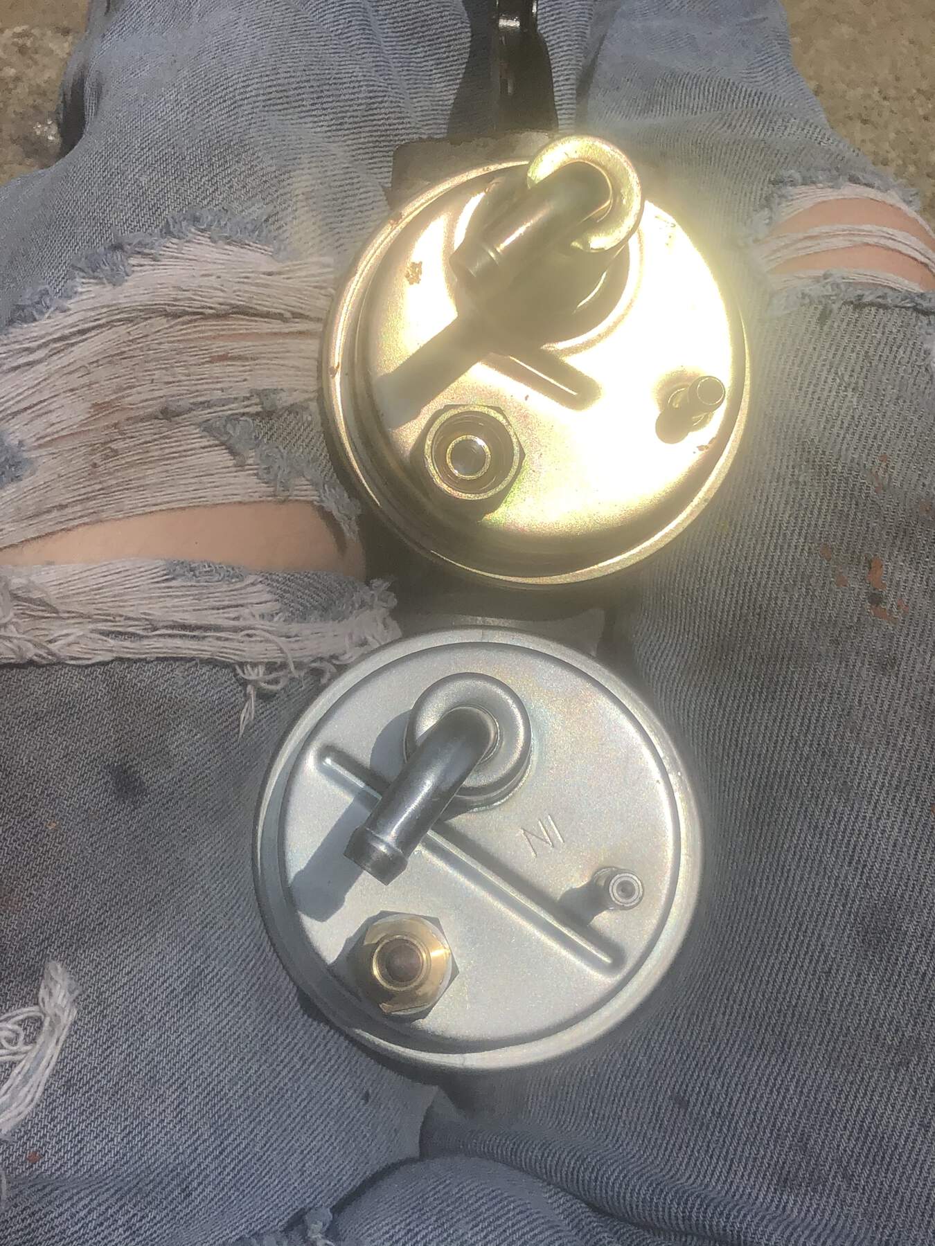

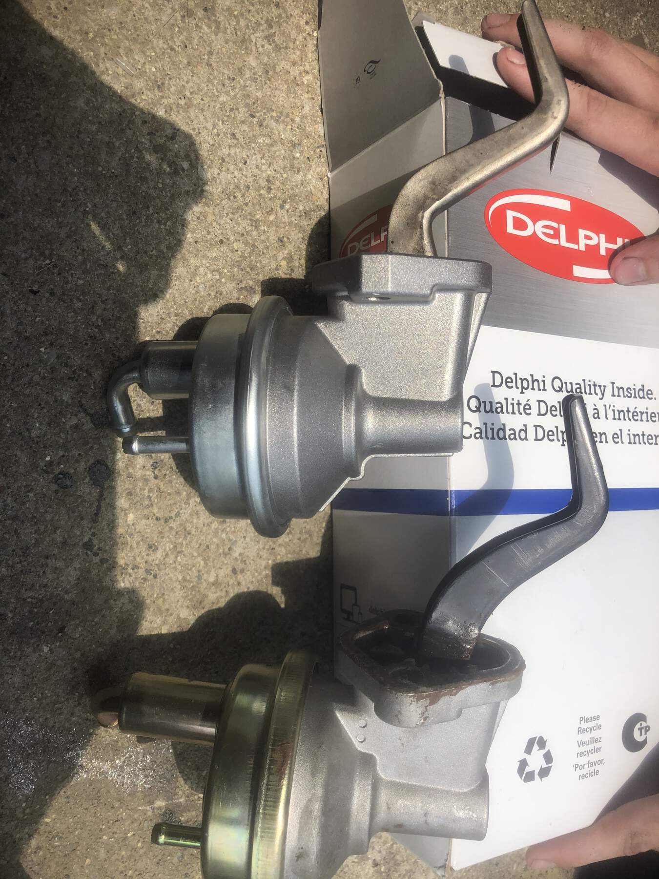

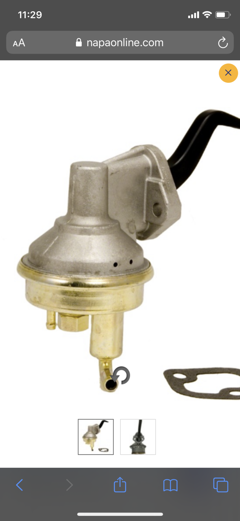

I’m honestly not sure either but looking at the pics on the Napa part# pump and my pump, they are different. The Napa pump (pictured) has a short bowl and the inlet port is clocked in a different position. My pump has a bowl that is 2“- 2 1/2” tall. Seems to me that if it is short stroking the pump maybe the taller bowl is holding more air and allowing in to enter the fuel hose on each cycle. But hell, what do I know lol. I did order the new pump this morning. It should be here tomorrow around lunch time. Napa didn’t have it in stock and said it would be next Wednesday, only place that had it in their “net work” was auto zone, so let’s hope it’s right.
Hi Wrongway. Let's hope so. Since you are in the middle of this whole, look to see if the fuel pump arms look different - either in length or shape between the 400 and 428 pumps. That is the only thing that, in my mind, would make a huge difference. I could be wrong - i've been wrong before too.
Now I know some pumps are indexable, by that, you can unbolt the lower diaphragm assembly and rotate the lower end to move the output line accordingly. However, that should not affect what you experienced unless it was not sealed properly. That said, this would not necessarily apply for a sealed unit (unless the diaphragm was bad to begin with).

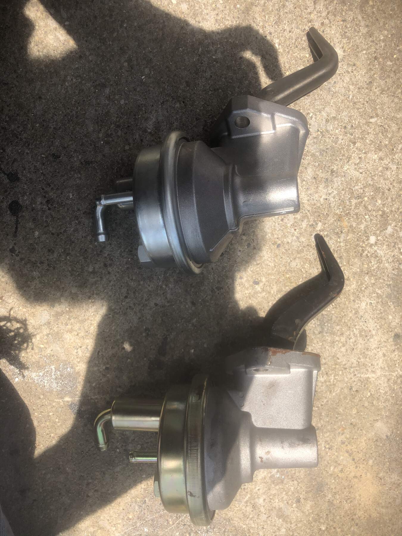

I'll look tomorrow when I get the new pump Frosty and post pics of both units. Y'all have no idea how much I appreciate you taking the time and helping me. Thank you again. I truly had no idea where to go. I was actually considering going with fuel injection in hopes of solving this issue. The conversation of LS swap had even crept into the garage one night. I know she's not fixed yet, but again, thank you all so much.

Wrongway, when you pull the pump tomorrow, see if you can take a flashlight & mirror and look in the opening where the pump goes up towards the cam. See if you can see the cam eccentric and which end is the open end, I.E. towards the front or back!

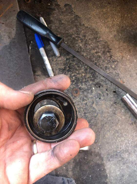

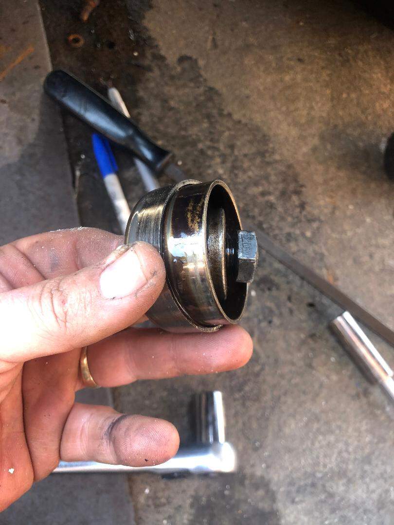

Just came across these from when I had to open it up a few months ago. This was disassembly and I did reassembly the same way. I take pics of EVERYTHING I take a part lol. Then I study them before I put anything back together. I'll still double check tomorrow and see if I can see in there.

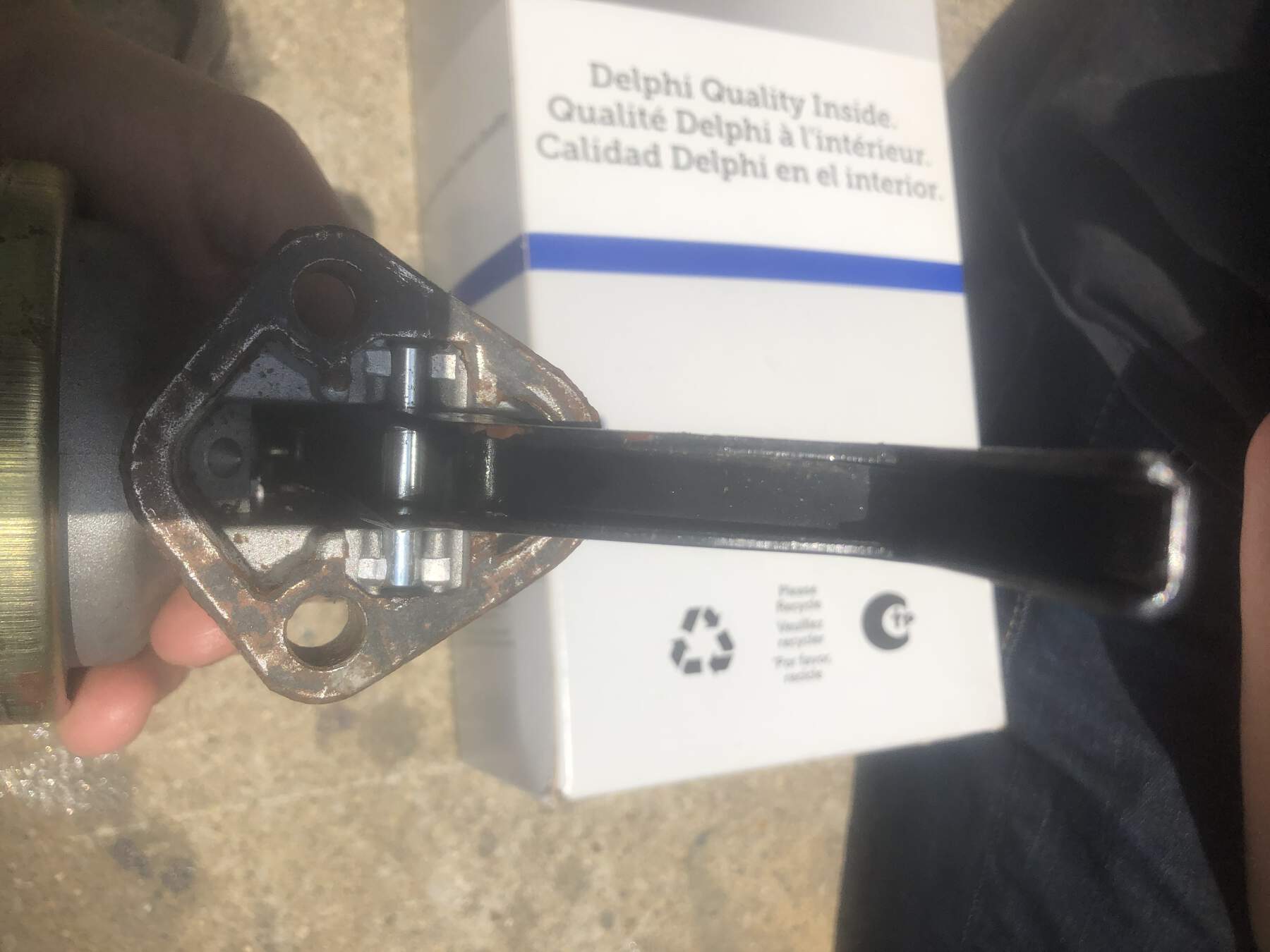

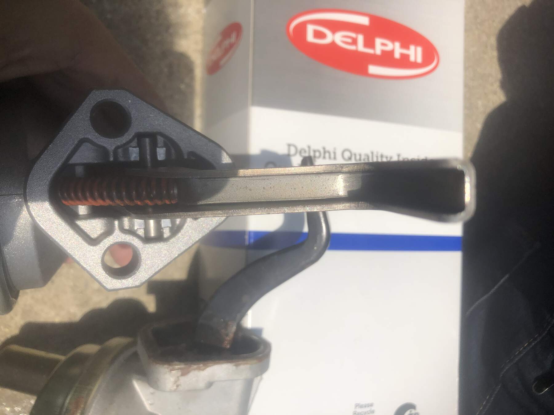

Ok so the only real differences that I see is that the old pump looks like the spring is missing. Regardless, I hooked up the new pump, primed the carb and she started and ran on her own. Awesome!!! No air bubbles either. When I shut her off you can still see the fuel in the line drop back down 6”-8”. Next question is I told u that I ran an aluminum fuel line under the intake, above the valley pan. Should I be concerned about heat or vapor lock? Any more suggestions or concerns about the fuel system?

Pontiac fuel pumps --- are definitely all the same in terms of the pump arm geometry - take that to the bank.  Some have vapor return lines, some don't - that's about the only difference.  If you use a pump with a provision for a vapor return on a car that doesn't have a return line, all you need to do is cap off that fitting on the pump.   It's not like a high-pressure fuel injection system that requires a return to shunt 'bypass' fuel back to the tank.   There's no pressure on that return.  You cap if off (if it's not used) just to keep it from letting fuel vapor leak out all around that hot driver's side exhaust manifold/header -- for obvious reasons :)

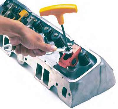

Ok! Thanks for the update - obviously there's a whole lot that I didn't know.   One question though, which rocker nuts are you using?   For your setup, you're going to require poly-locks (the kind that have the set screw in the center that you tighten down against the stud to lock the adjustment in place).  If you're using the original factory nuts, they won't stay where you put them and will always loosen up.  That could be the explanation for a lot of what you're experiencing.  Some site advertisements might leave you with the impression that these are only for roller systems, which is not accurate.  Do you still have any of the original pushrods and some of the damaged ones?  Are they the same length?  What else has changed on your heads?  (valve stem length, springs, spring installed height, etc.)   Whch rocker arms are you using and what's their ratio?  Are you sure that your valve springs allow enough travel and aren't going into coil bind?  That will bend/break parts too and can't be "adjusted out".
Here's and example of using/setting poly-locks
The process can be easier with a tool like this that combines both wrenches:
As long as it starts right up I guess I wouldn’t worry, but a good system should hold pressure between the pump and the carburetor! When the needle valve shuts off the in coming gas flow the pressure should stay between the carb and pump! FYI! What Bear says about the vac is good advice. For me though I think I’d just start with the ether since it sounds like you’re not really sure where the leak is! Start around the carb, than move to the manifold, but first check all your hoses and hose connections.

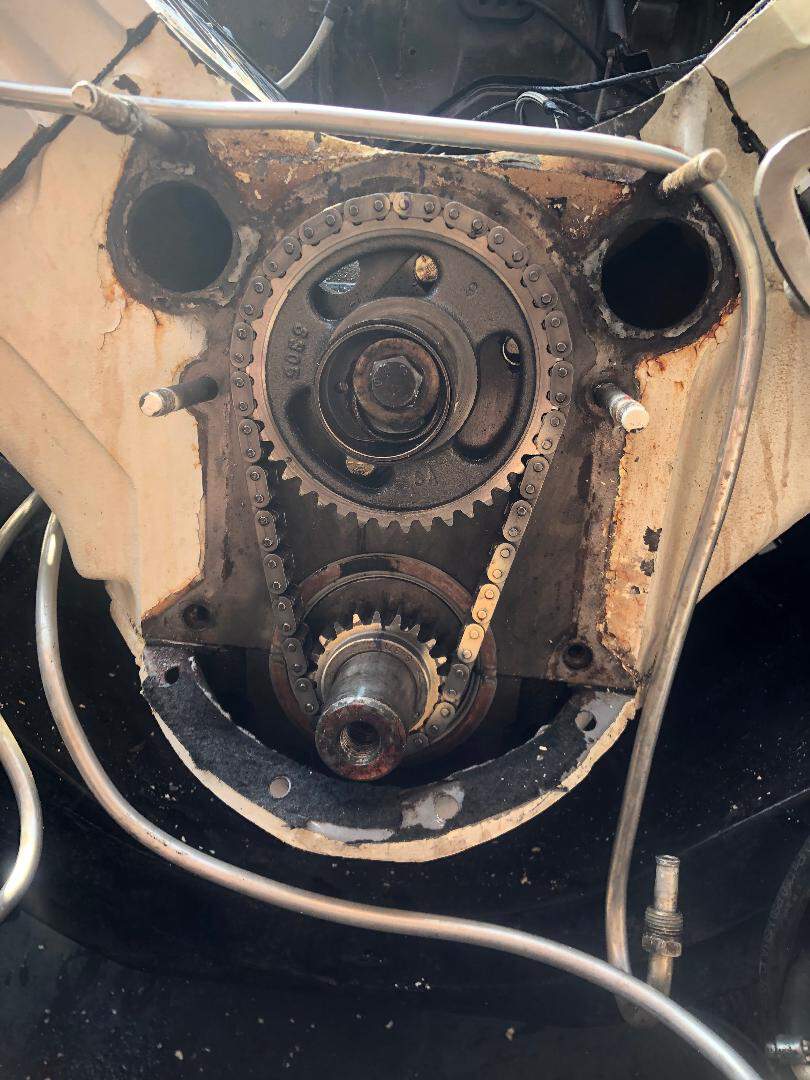

Hope your missing spring isn't floatin around in the timing cover,  would be a mess if it got tangled up in the timing chain.  Might get caught between the main cap and pan as well.  Hope it JUSTA makes it into the bottom of the pan.  I was concerned and brought up the eccentric before and you showed us the pic of the timing chain and was sure you put it back together right.  Hope your over the prob's.
Edited by JUSTA6
Hey Justa, glad to hear from ya bro. In the pic of the timing chain, I sent that because I was thinking the little circle thing in the middle was the eccentric. If it’s not then y’all let me know and tell me where it is and I’ll send pics. I was thinking that was it. Yes I put everything back exactly like that pic showed. Looking at the new pump with the spring. On the inside of the lever there is a small post where the spring goes over it. A spring keeper if you will. On the old pump there is no “keeper” and there is no evidence that there ever was one or that one had broken off. I honesty believe that the spring was not on it when I installed it. At least that’s my hopes. That car starts and runs good now, I think. Engine still seems to vibrate more then I would think it should but I don’t know. I did do the vacuum tests today that Indian & Bear suggested. Running hooked up, Running everything blocked off, didn’t matter. Still showing 7hg of vacuum at 950RPM. I adjust the carb, reset timing and that’s the best I could get. Also, at 950RPM at idle and put into gear she drops to 500RPMs. I did buy a new hand held vacuum gauge and it’s all over the place. The gauge in the car is steady. But she does start and run on her own again lol, that’s something. The videos are of both gauges with the car running. JustA thought, could all of this be carb related?
