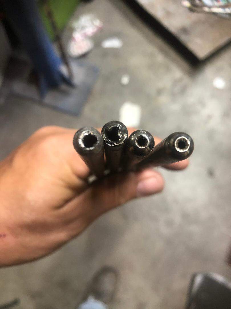

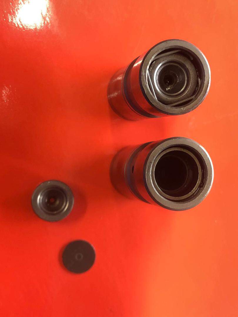

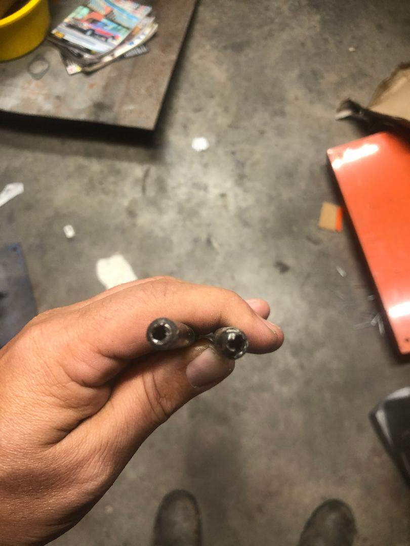

After reassembling I took it for a ride. 2 miles in the transmission went out. I sent the trans in for rebuild. While waiting I put in the wiring harness. Got trans back, finished the wiring and built a new drive shaft (why is another story). Finally about 6 months later I started the engine again. Took her for a ride. She was over heating. Tried multiple thermostats. Had local radiator shop test radiator. Said it was good to check heads. Pulled the passenger valve cover to remove heads. Found a broken lifter. Called COMP cams, they said it was out of warranty by now so ordered a new lifter. While waiting for lifter I pulled heads and found that the head gasket was blown. I was told by the guys at the radiator shop that this happens sometimes during break in on Pontiacs. (Yes they specifically mentioned Pontiacs). So I replaced the head gaskets, installed new lifter and reassembled the engine using ALL new gaskets.  I don't ever reuse a gasket. I used my book for all torque specs and per comp I tighten the rocker's down to 20lb just like the 1st time. Started the engine and took her for a ride, no over heating. Got home, popped hood to check for leaks and such and heard something. I removed the valve covers and found 2 damaged pushrods. (1 of the only parts that were reused). I thought maybe with the rebuild maybe the old pushrods couldn't handle it. Yeah, pretty stupid in hind sight. But I ordered new pushrods. Installed new pushrods tightened rockers down to 20lb & reassembled. Figures crossed I started engine.it turned about a 1/2 turn and I heard a loud noise. The engine was locked up. The breaker bar would only move about an inch either way. I started tearing it down again and found the 7 broken exhaust valves. Called comp and was told that their tech gave me the wrong info. So I ordered new valves. On my bench using a spring compressor I removed all of the old locks, springs and everything. I did not remove the intake valves since they didn't seem to be involved. I used break cleaner and a nylon and a brass bush to clean it all up. No drill or any power, just the brushes. I used assembly lube on the stems of the valves reinstalled each valve with new locks. Reinstalled head, timing and everything else with a all new gasket set. Started it up and it sounded good. So I thought. Just had vacuum issues and tuning. Then I reached out to y'all and here we are bro. Hope that's enough detail, if not just ask whatever you need to know & I'll happily answer if I can. Also, when I rebuilt the engine I did have the machine shop check the block to make sure there were no cracks and bore it 30 over. I did use +30 pistons and rings.

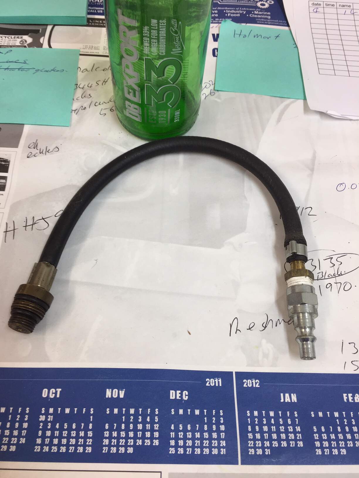

what i did wrong way was i used a compression tester gauge that had a hose and fitting on it , chopped off the gauge and shoved a 3/8 hose tail into the flexible hose with a clamp and screwed a air coupling to that 3/8 thread. easy .... here is a picture of it

hell, if you lived around the corner i would give it too you mate!...🙄...but i am a little bit further away!🙄
I see, good idea. Thanks bro

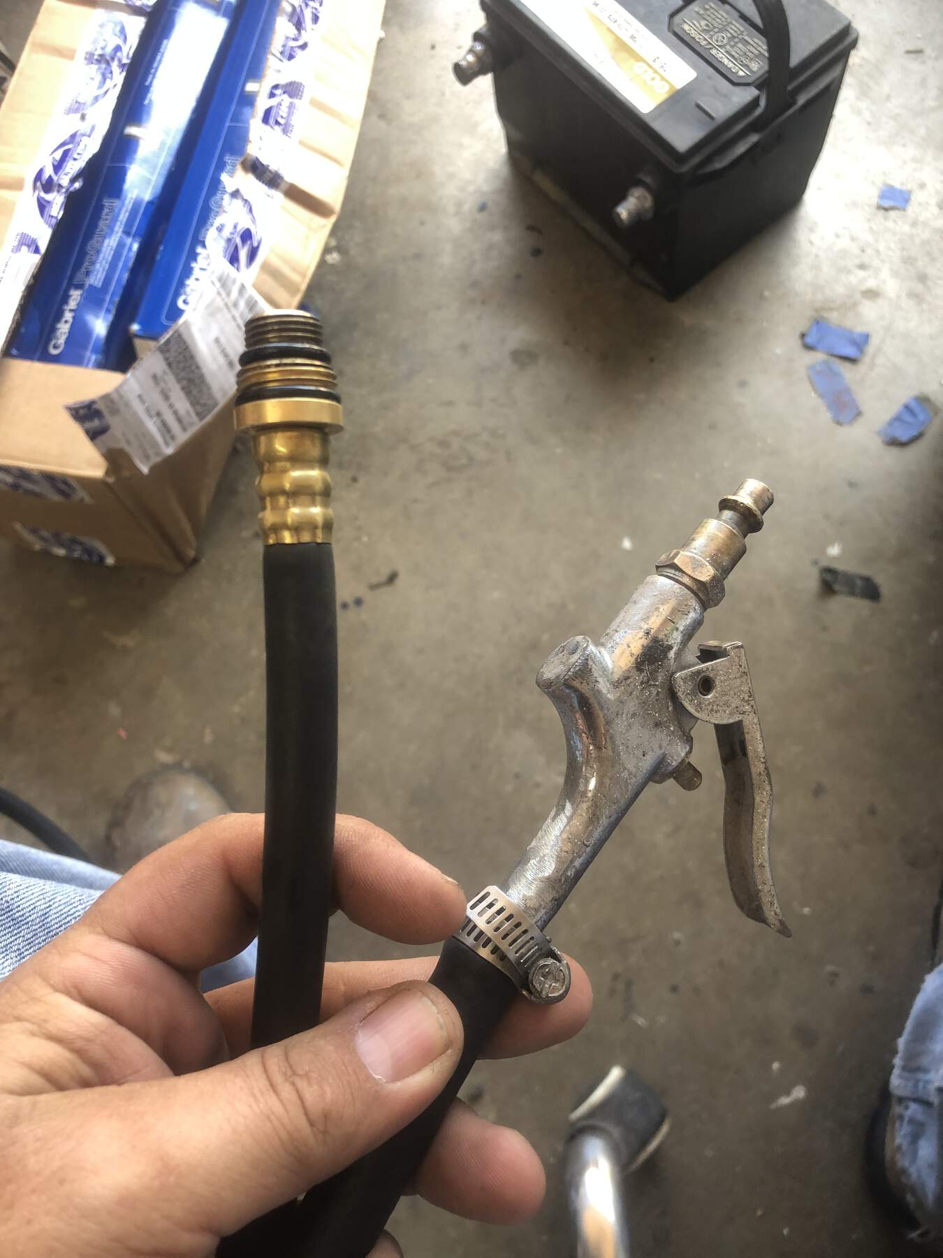

Ok, so the air test is done. Here's what I used. The end from my compression tester with the gauge and schrader valve removed. I ground off the finger hook on the blower nozzle to my air compressor and 3/8th hose in between. I put 100psi in to both #5 & #6 cylinder's separately. Both cylinder's pushed the air out the exhaust. Just out of curiosity I hooked up to the #8 cylinder at about 80psi and it turned the fan about a 1/2 inch and I stopped.

Ok, so the air test is done. Here's what I used. The end from my compression tester with the blower nozzle for my air compressor and 3/8th hose in between. I put 100psi in to both #5 & #6 cylinder's separately. Both cylinder's pushed the air out the exhaust. Just out of curiosity I hooked up to the #8 cylinder at about 80psi and it turned the fan about a 1/2 inch and I stopped.
oh nice fitting set up mate👍
 and you found your issue👍
Well alrighty then.  Sounds like you got two exhaust valves that aren't sealing.  That explains the rough idle and the wonky/low idle vacuum.  Count your lucky stars it's not worse, although I think you mentioned at least one piston had a pretty good divot in it.  I'd get that checked out and try to determine how thick the metal is there before reusing it.
