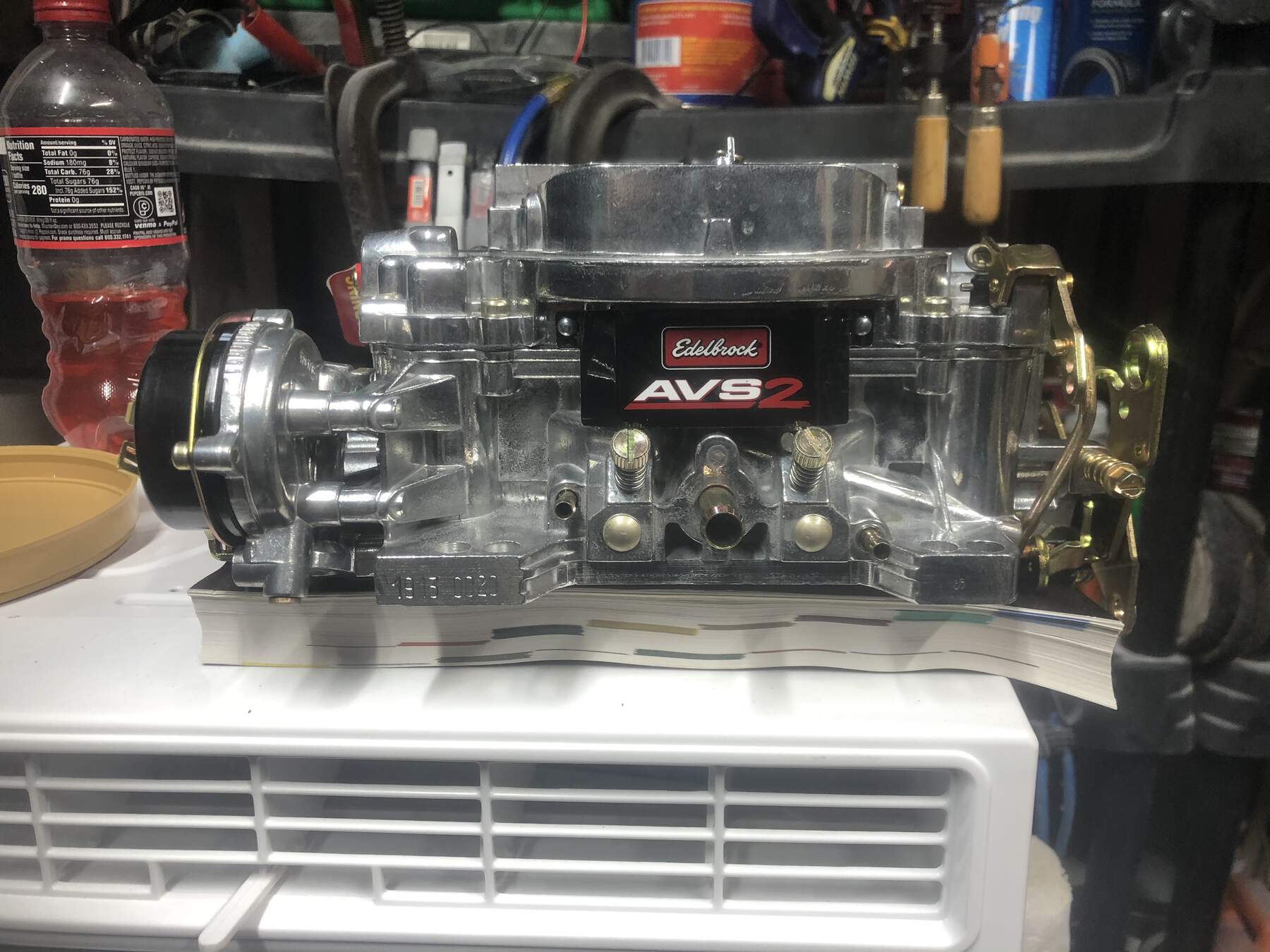

Yes the OEM duel plane is a great manifold! It’s what I would have used! And yes the carb you show is a spread bore as Bear said, but it’s not quite as simple as that!
You pick a manifold for a specific set of engine perimeters and than a carb to enhance those! In that process you may want too take some advantage of some specific power band area because of gearing, transmission, etc. all of those things will influence what gasket and or spacer you use! These are choices you need to make, but if you pick this or that, mix and match so to speak this can cause you some real headaches later on! So I would just encourage you to step through this logically and not in a hurry! So when you’re done; you’re done!
And FYI, those butterfly things are throttle plates! And that’s what I was speaking of before. The back ones need set a specific way! Even from the factory they are not always set correctly for a specific setup!
Wrong way, i am with Last Indian on this one, its a recipe :o

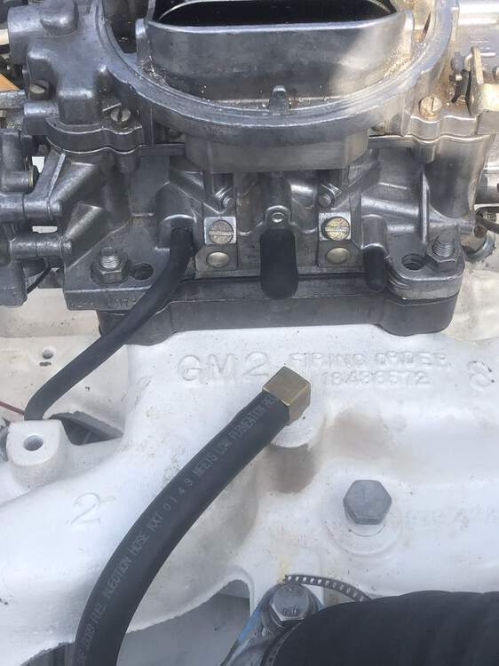

 that pic of a square bore spacer and gaskets is not your set up, last indian will give you the plus's and minus about a inch spacer.
 my though is dont use a spacer, think old school Q jet and have a full gasket that separates the primarys from the secondarys
  Its the best set up for street use:cheers: dual plans rock for street :dancingpontiac:

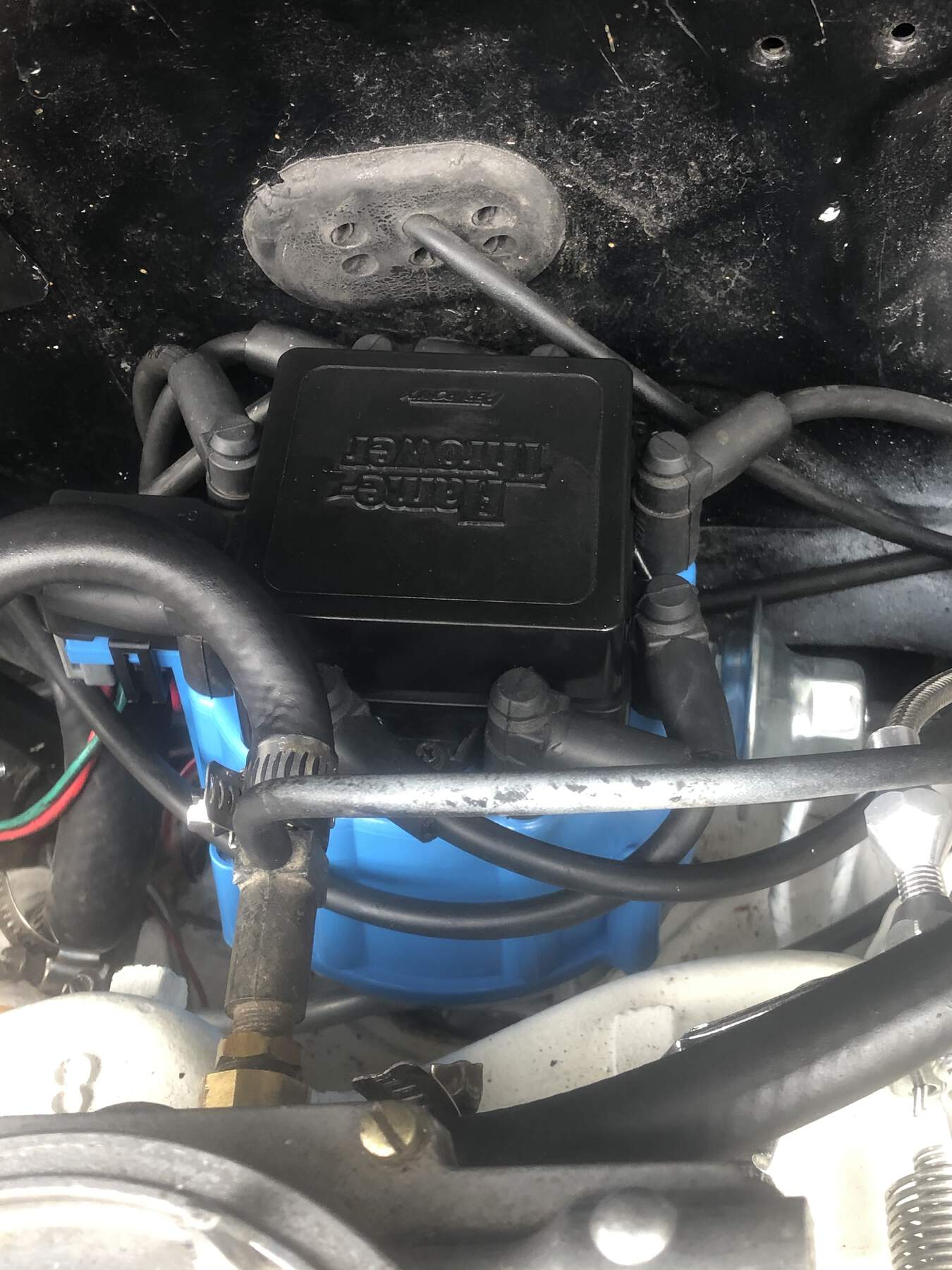

I should have also included in my last message, what made me suspicious of ignition was the combination of that bouncing vacuum gauge needle, the rough idle,  and the ticking sound I think I'm hearing.  Having an intermittent misfire condition (caused by a plug not firing consistently, due to a bad wire, arcing, etc.) is one of the primary causes of both low vacuum and a bounding gauge reading.  It's not the only possible cause, but it's one of the easier things to check for and deal with.   An idle mixture that's extremely lean OR extremely rich - enough in either direction to cause a misfire - can cause the same kind of gauge reading, but it's not going to cause an audible 'tick' along with it.   BUT - you're there and I'm not, so like I said earlier - maybe I'm hearing something in the recordings that isn't really there?

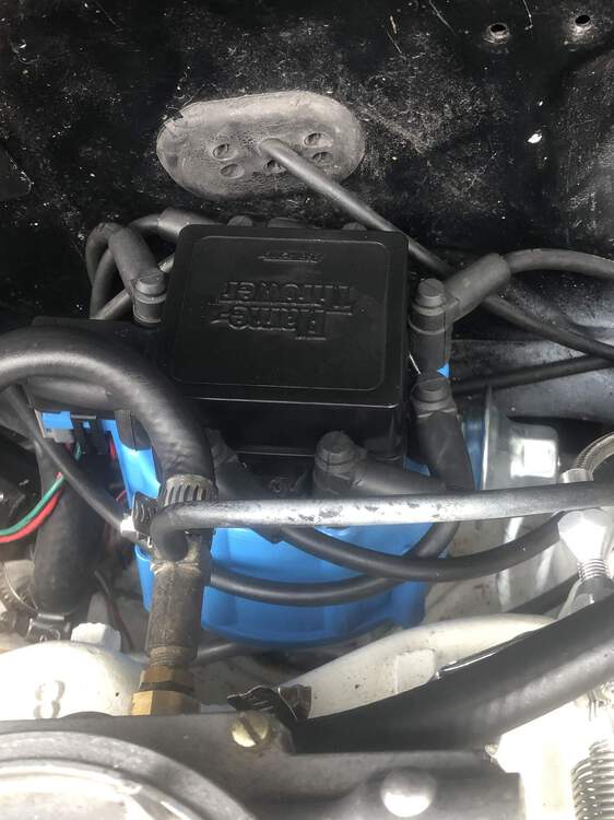

The spacer plate is fine, if that’s what you want, but what’s important is that you have the correct gasket that mate the spacer with the manifold, that you have the correct gasket that mates the carb to the spacer & that you have the correct spacer material! Those are all relative to what you are trying to do! Example a 1” - 2” spacer is used often to increase low end torque & help with fuel atomization! A fiber composite material spacer is used to deal with heat that can cause fuel percolating, and so on.
the front cap you show in this picture should be manifold vacuum!

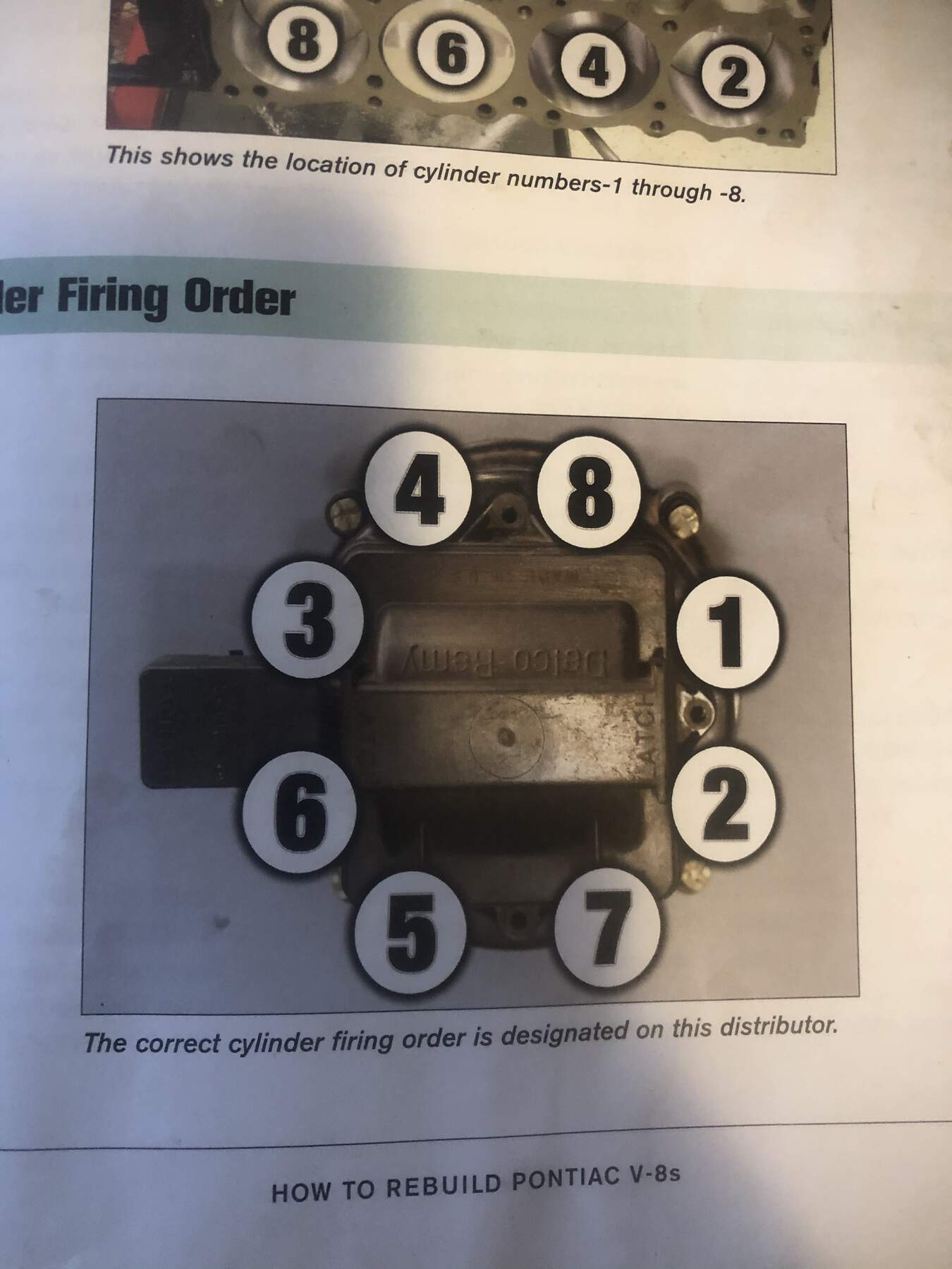

One last thing! I know JustA asked you, but I’ll ask again and expound on it! Do you have the distributor & the engine wired right? Looking at the top of the distributor going counterclockwise. It 18436572 for firing order & siting ing the drivers set, #1 cylinder is the first cylinder on the left at the front of the engine.
I have seen more than one veteran mechanic get this wrong just because they were preoccupied with a problem! Just double check it! I’ve seen guys flip flop 5 & 7!
Pretty sure bro. As simple as this is going to sound. I always pull out the book and set it on the front end. With this picture open, standing in front facing the windshield. I run all of the drivers (1-3-5-7) side then the passenger side (2-4-6-8). I double check each wire before putting it on the cap. I’m pretty OCD about that. I to have seen people wire the cap wrong. The distributor position is, the vacuum advance is on the drivers side and the HEI plug is on the passenger side. I will double check the wiring again. If there’s anything wrong with any of how I just explained that please let me know bro.

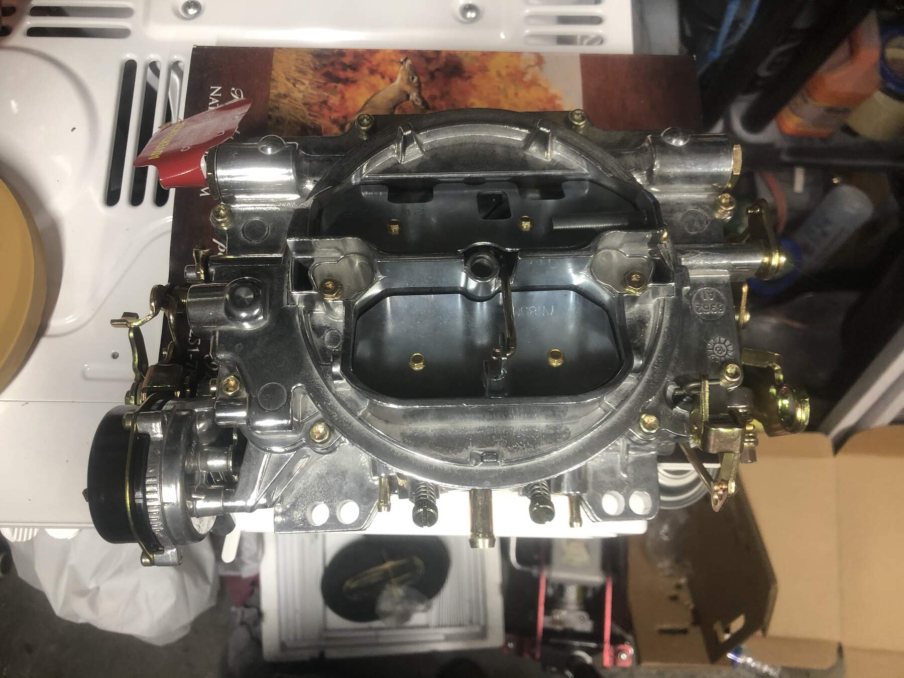

Also, with all the talk of carb gaskets and right and wrong set ups I came across something interesting in the deep rock book. It shows my spacer and say DO NOT USE THIS TYPE. Says it will cause a vacuum leak. I did spray the base with ether and had no change. But I still found that interesting being that’s one issue we’ve been chasing.

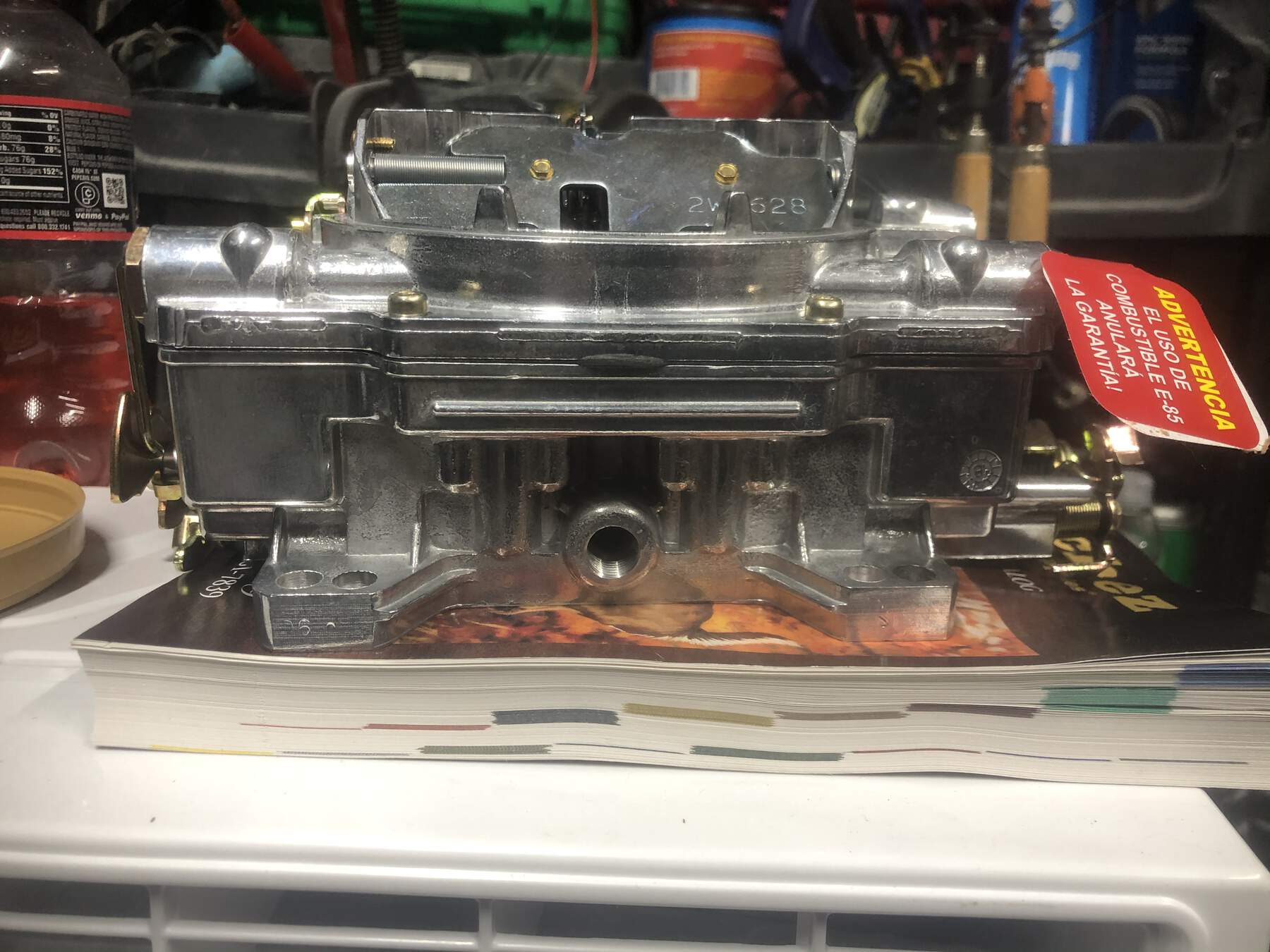

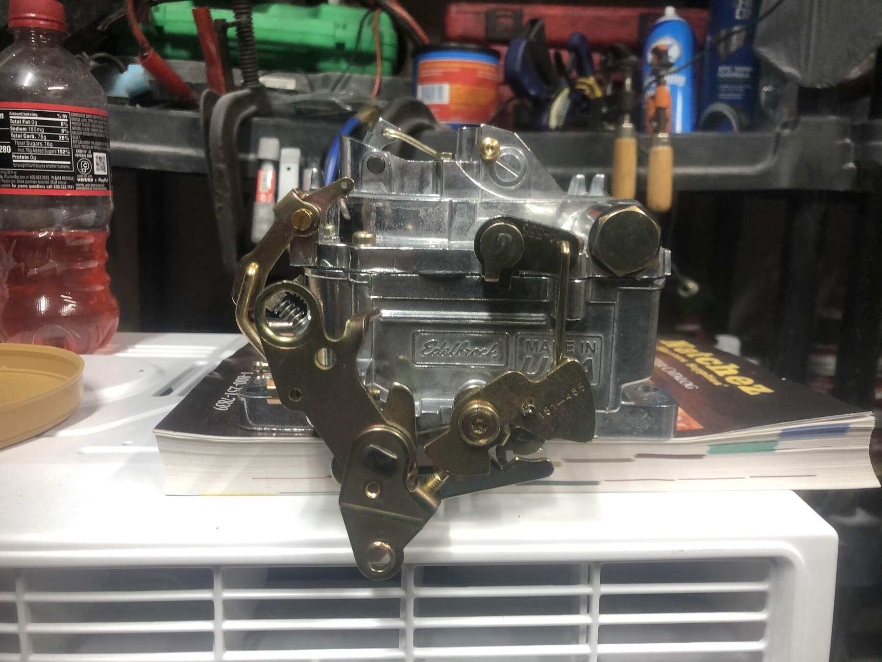

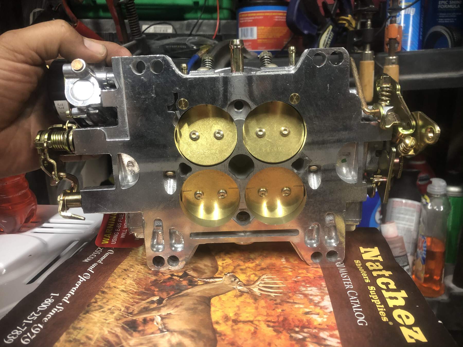

Interesting!   When you posted the photo of the bottom of your carb, it's obviously a spread bore but perhaps the pattern and placement of the throttles in the base plate is different from a QJet.   It'd be worth measuring them to see if they match up to the same measurements on a QJet.   Do you happen to have a Pontiac QJet laying around?  I've got several if you don't.
(A Pontiac QJet will have the fuel inlet fitting coming in straight from the front, while a chebby one will have it coming in from the side - but the throttle bore dimensions on both will be the same.)
Measure:
  • The diameter of both primary and secondary bores.
  • "Center to center" distance between the two primaries, the two secondaries, and primary to secondary.
Also earlier you asked why the factory vacuum gauge needle doesn't 'bounce' like your new one does.    The most likely explanation is because that factory gauge movement is damped -- intentionally designed to not react instantly, so that what it shows you is actually an average reading.   I bet that the midpoint of the fluctuating readings you see on you new gauge (half way between the high and the low end of the sweep) corresponds to the reading you see on the factory gauge.
