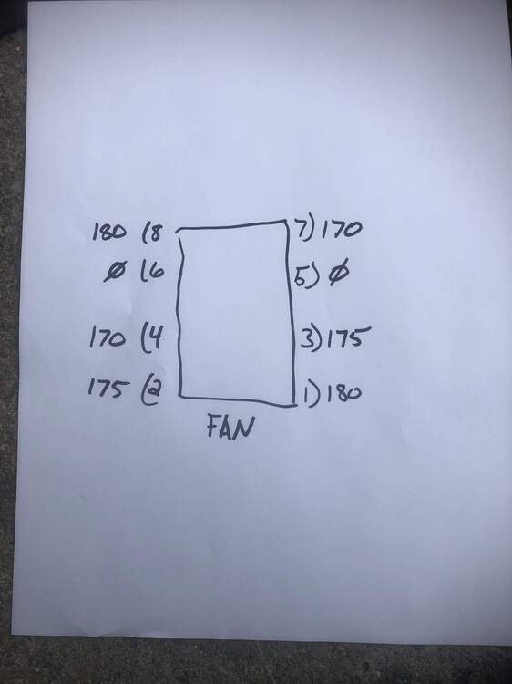

Well, I’ve got good news & bad news. The good news is rain let up enough to do the compression check. The bad news is the rain let up enough to do the compression check. So the #5 and #6 cylinder have 0 compression. Hope you can read this, here’s what I found.

wrongway, i think it would be worth doing a leak down test too, to find if its rings or valves causing the issue.
 the 2 pots with no compression suggests valves not sealing and possibly even cam timing too

Yeah, I don’t think a leak down is going to answer any questions! I also don’t think this is relative to the timing set! There may be a problem there, but that’s not causing this oddity of compression numbers! The first thing that comes to mind is the intake manifold! The odds of both heads having a gasket leak in matching position cylinders is highly doubtful. Plus the variation of cylinder pressures could be rings, but coupled with the zero pressure readings of 5 & 6!? If it were mine I would bite the bullet and pull the intake & drop the exhaust manifold! Then you can see the valves.
When you if you pull the intake pay close attention to the intake gasket on both heads! Most likely there will be signs of leakage or poor sealing at 5 & 6 if there was gasket failure. If you find nothing there, you’re going to have to pull the heads!
If you do any or all of that let us know what you find & we’ll try to help you plan the next move.

Lack of gasket seal on either intake or exhaust isn't going to cause zero compression.  Both of those spots are either before or after the valves, so as long as the valves are working and sealing properly you'll get a good compression test even with the intake manifold and exhaust manifolds completely removed and the ports open.
Wrongway, just to verify so please don't take offense... When you ran the compression test, you ran it with the throttle blocked wide open and all the spark plugs removed, right?  That's required to get valid numbers.  Otherwise the engine won't be able to pull enough air to fill the cylinders or spin fast enough to get a good reading.
Still though, the readings should just be low, not zero.
 I think I remember you said that you had to replace some valves because they got bent?   Were they on #5 and #6 by any chance?   I hate to say it, but considering the zero compression on those two, I bet if you pull the heads you'll find holes knocked into the tops of those pistons from when they hit the valves and bent them.

I agree Bear, but I didn’t say the intake caused the compression issue. I said I would pull the intake and drop the exhaust manifolds so he could see the valves!
Reason being without a borescope not many other ways the see the valves without pulling the heads. Because if it’s not valves it only leaves rings, and zero for a ring issue is not likely! And inspecting the gasket when removing it to me is just logical!

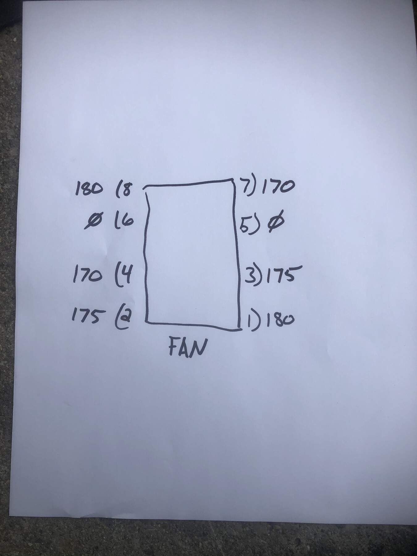

I take no offence at all bro. I forget, miss and do things wrong lol. Speaking of which, no Bear, I pulled a plug, ran test, replaced plug and moved to the next cylinder. I was not aware that all plugs needed to be removed. I figured they needed plugs in to build up pressure. Guess I need to redo it, sorry guys.
Yeah Bear you remember correctly. I broke 7 out of 8 exhaust valves. Snapped in 2 pieces. That was when I had ran the rockers down to 20lb. I was using OEM push rods, I ripped the tops off of 2. I replaced them with a new set of comp push rods. Reassembled and on 1st start up snapped 7 valves. That was when a comp tech supervisor told me they misinformed me about running them to 20lb and instead needed valve lash. I had the heads off, timing and pulled the cam to check it. Concerned it could have damaged it. I did not see any cam damage. The only damage other then the broken valve's was a small divet in the top of one of the pistons. I honestly don't remember which cylinder. It looked like the stem came down and stabbed it. Its about the diameter of a pencil eraser or a bit smaller. Maybe an 1/8" deep. It did not go threw the piston. I didn't think it would be enough to hurt anything. All off the other pistons still looked good. Replaced all 8 exhaust valves with stainless reassembled again. Started, drove it, no vacuum and y'all started helping me figure out why.
So before I tear anything apart do another compression check with plugs removed?
Oh, and yes I did use new gaskets each time I reassembled the engine and I used Indian head shellack on the head gaskets and exhaust manifold gaskets.

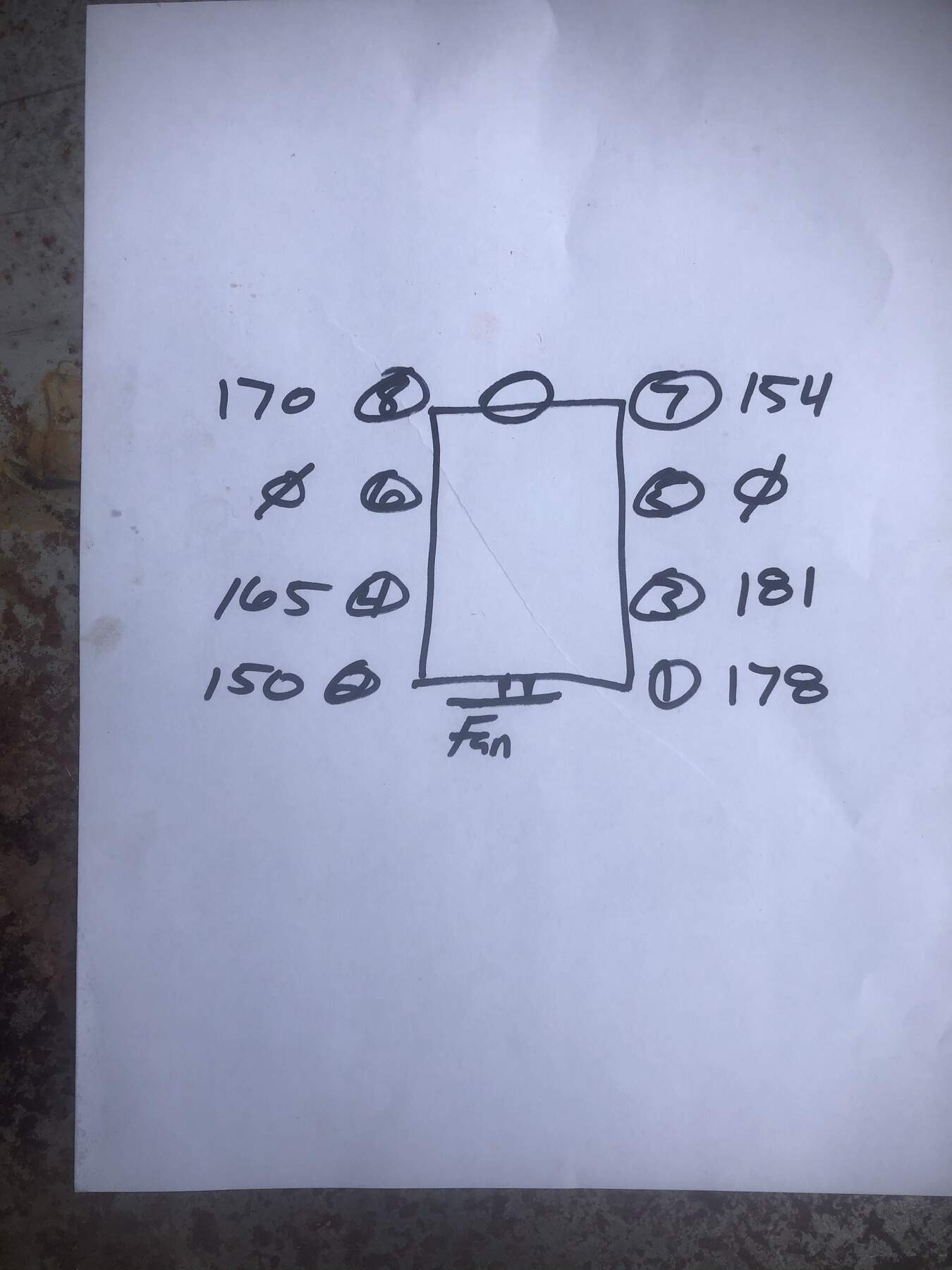

Ok, new compression test. Plugs all removed. Wide open throttle.

If you suspect a valve sealing issue...A good accurate way to check if your having valve sealing/bent valve/weak springs issues without tearing the engine down...Remove all the rockers...Then take a long straight edge and lay it across the tops all the valve stems....They should all be the same height..If there is some of the valves that are lower than the others by .002 to .003 or more...(Use a feeler gauge between the tops of the valve stems and the straight edge)..That is a real good indicator of a weak valve spring/slightly bent valve stem..ETC..which will cause the valves not to seal correctly and not hold compression...If you have a couple of the valve stems that are higher than the rest of them...That is a really good indicator that whoever did the heads cut the valve seats too deep..If that is the case and when you set the valve lash the same on all the valves the taller ones will  not close completely or tightly enough because they are actually set too tight..If that is the case You can grind the tops of the stems to the same height as the rest of the valves...Provided that they aren't anymore than 4 or 5 thousandths higher than the rest of the valves...Anymore than that and you would have to use an adjustable length pushrod on those particular valves in order to keep the geometry the same on the whole valve trane...Also this may sound crazy but it might not be a bad idea to make sure that all the push rods are all the exact same length...While I'm thinking about it upgrading from 5/16s pushrods to 3/8s is a very cost effective worthwhile improvement....
Edit...Also if all the valve stems vary slightly in height from each other...and they are all not all the same...It can also cause erratic vacuum readings and crappy idling issues....Due to all the valves not traveling/opening/closing the same distances....Hope maybe all this helps you too figure out what the problem may be.....Without having to take everything apart....

Well sir, that cylinder pressure is escaping to somewhere and that's a fact.  I assume that after you had the mishap with the exhaust valves that you had the heads redone including having all the guides checked, and the seats reground, so if that's the case  then it's not likely the leak happening at the valves.  You mentioned a divot in at least one of the pistons.  Maybe it weakened the metal there enough, made it thin enough, so that it wasn't able to hold up to combustion pressures.
Do you have an air compressor?  If so, maybe get a hose fitting you can connect to a spark plug hole and try to pressurize those cylinders.  You probably won't be able to - and you'll hear the air hissing out from somewhere.   Where you hear it leaking from will tell you where the leak is.  If it's loudest at the carb, it's an intake valve. etc.   If it's loudest at the dipstick tube, that means it's getting past the piston.

Well done Wrong way. a good test:cheers: you have 2 pots with dodgee valves mate

i am with bear here, compressed air will tell you where all that compression is going.( leak down test)
i had this same issue with my  96 dodge ram, i found a broken valve spring was causing the issue.
have a really good look at the valve springs on those two pots Wrong way... you may find the issue :cheers:

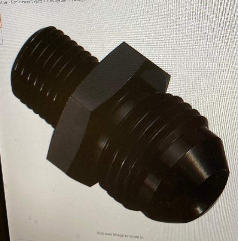

Fitting is ordered to air up cylinders, be here Friday. Do I still need to get a set of gauges for a leak down test? Or will airing up cylinders take care of that?
Depends on what the fitting is or looks like! If the fitting is conducive to putting a gage on it and you use a female air chuck on the fill side that would surffice.

I would just ensure you have a good air tight hose and connection to each of those cylinders in question mate and ensure that both the valves are completely shut  ( take covers off and check for broken springs turn motor over till you see both valves are shut)
 And listen😜 you will either hear air coming back up the carb or out the tail pipe or both!

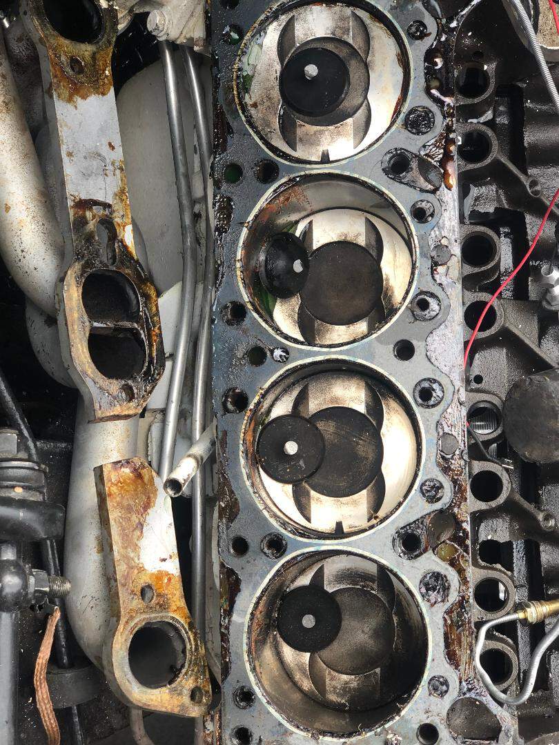

I didn't see any kind of cracks or anything that looked out of sorts. Is it to late to disassemble and take pics or grind or lap valves or? Is that something I can do here in my shop? I know this probably isn't the "proper" fitting but its all I could find with the tread size I found. I figured I could connect pieces to do whatever y'll tell me to with it, hose, gauge, chuck, whatever.
When I reran the valve's the other day as Bear advised I didn't see any broken springs but ill check again kiwi.

You can use an old spark plug and knock the ceramic center and the metal electrode out of it with a hammer and a punch and grind or cut the electrode off the bottom and weld a Male fitting to the remaining outer part of the plug...That fits your chuck on the air hose and use it for pressurizing the cylinder..
Did the original valves have a three or four degree angle valve grind on them..?? What about the valve seats..??
It's not too late to disassemble the heads and grind And/or lap the valves in as there is only a very narrow area (only a few thousanths wide) that actually contacts the seat the other two or three angles are ground to facilitate efficient velocity and airflow..The thing is the expense of New Head and related gaskets...I would not reuse head gaskets once they have been torqued whether they have been run or not..
You should be able to determine the original valve angles by using the broken valve faces (hopefully you still have the broken parts) as a guide using a protractor to find the angles... If you duplicate the original angles they should match up with the valve seats...  You can have a machine shop grind the valves only (cheaply)...To your specs..Then lap them in  and reassemble the heads Yourself...You can also closely inspect the guides and the springs/locks/retainers while everything is apart...
But before you do all that do your air test first and then decide where to go from there...
