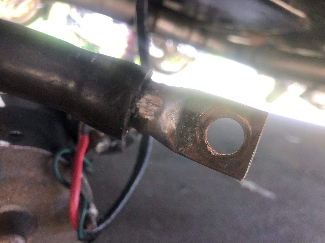

Ok, so I pulled out the dip stick, removed valve covers, plugs out, no dust cover. Still did it. Put a bar on the crank pully and as soon as I started turning it she went click. On 2 full rotations only the 1 click. Cranked the ignition and the sound was still there. Again had buddy turn by hand with me underneath. Felt and heard click from starter, 1 click only. As always I've included pick and videos. My thoughts are that's something was hitting the battery cable on the starter while cranking and only softly pushing the battery cable on hand crack. I'm not sure how, but there are marks on it. In the 2nd video of the bench test I held the starter "on" longer to hear how sounded. The starter seems to function correctly but I'm not sure if that's the way it should actually sound. Going to reassemble and see what see does.

Well upon further review I can't see anything that could be hitting that cable. Its not near the starter gear or flywheel .

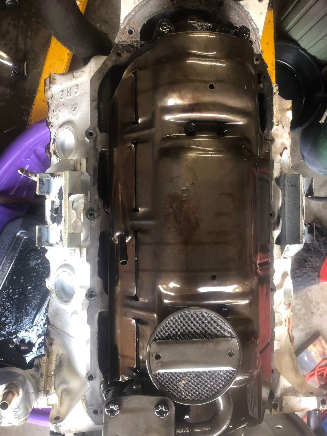

Have been away for awhile... But I'm  back now........Does the engine have an oil scavenger tray in the bottom...?? If so It's very possible that one counter weights on the crankshaft might be hitting it or rubbing against it once on every revolution....
Edited by TWO LANE BLACK TOP
Hey bro, welcome back. Not sure exactly if this is what your talking about. But this "pan" is what's inside of my oil pan. But if a weight or something inside was hitting on rotation wouldn't I be able to feel it when i rotate the engine by hand? When I rotate it by hand she's smooth.
i think its worth trying another starter motor Wrongway, know anyone you can loan one off? it looks a very standard gm unit
That's called a windage tray. It's purpose is to keep the crank from picking up a whirling mass of oil, which robs power.  You've got one of the nice full length factory trays. No longer available from anywhere. The later model and repop trays are 3/4 length.  I can see the lower dipstick tube right where it's supposed to be, too, so it's not likely that what you're hearing is coming from the dipstick.

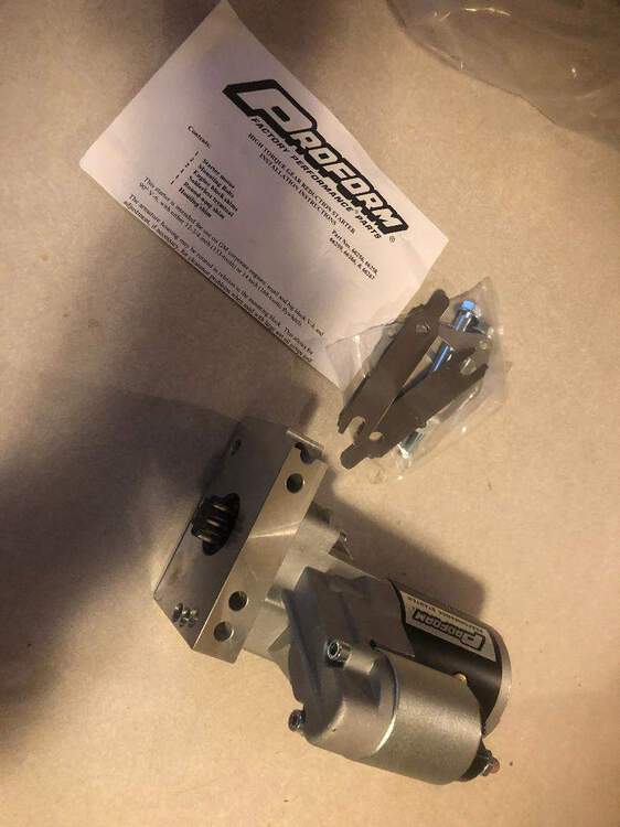

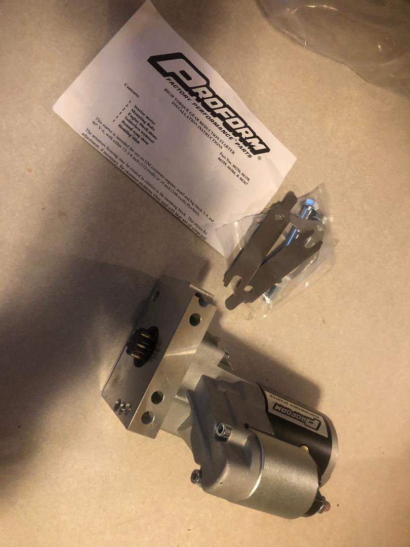

Went and borrowed the starter from then parts house. Plan on installing it tomorrow. I went with the mini high torque. I've been told a few time that Pontiacs have a problem with starters getting hot. Here's what I got.

very cool Wrongway.
