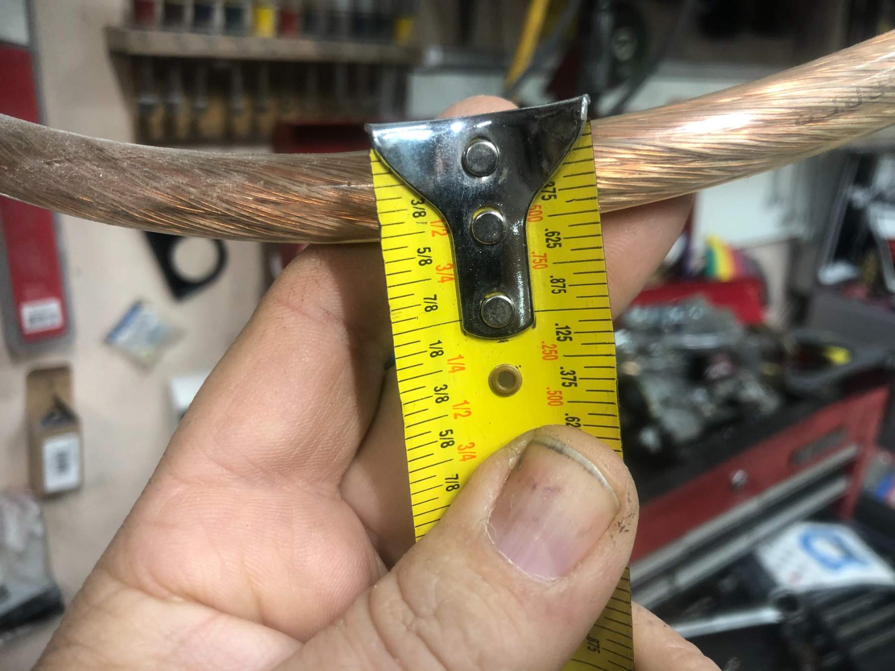

The first picture is the ground strap to engine. The second is the ground strap to body. Can a ground strap actually go bad? Could they be to small? They measure 10" long but only 1/4" wide?

they sure can, looking at those measurements its quiet bad, they both should be well below zero , after all its just a bit of wire the power should be able to get from one end to the other with next to no resistance.
one trick you could try Wrongway is to clean up the crimps and solder the crimp only, or justA buy some new ones
my 64 has the same earths, what i am going to fit is a earth strap the same size as the positive lead is that runs to the starter from battery straight to the block. and then a 6mm strap from motor to body but using new stuff. 👍
This is what i will use its about 3/8 and i will solder flat eyelets on both ends, i dont trust crimps:) and this is pretty much justA for the current draw that the starter pulls👍

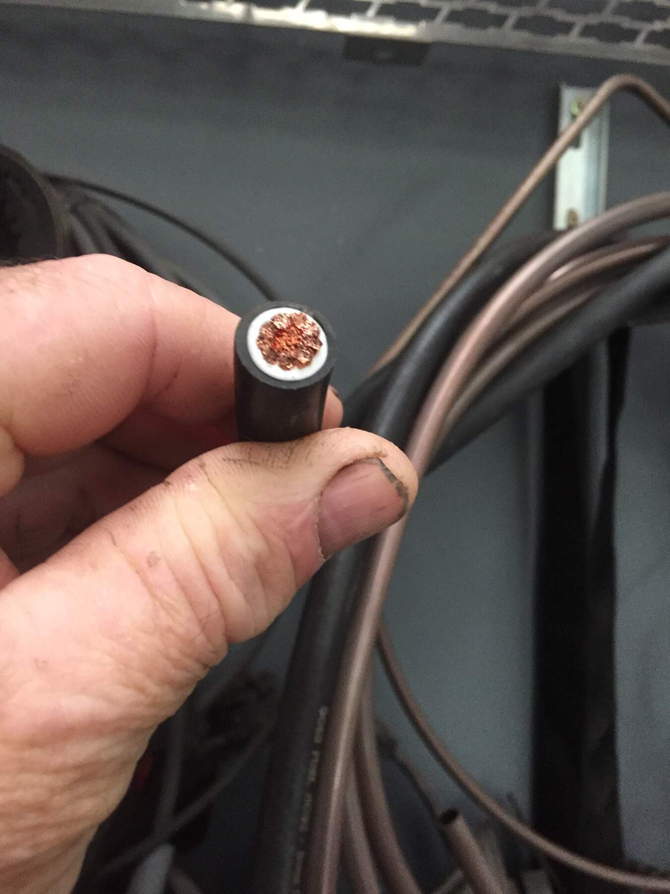

So my ground from the battery to the engine is 2AWG. The same size as from the battery to starter. Would that be good for the grounds also or is that to big? I don't care about ordering new straps and soldering on the ends. I just want whichever will be better. Is it possible for the ground strap to be to big?
I don’t see any harm in it being that size mate .... have you ohms tested that cable from the battery to the engine ?
other than aesthetics the ground cant be too big. Kiwi has you on the right track for sure.
Ok great guy's thanks. So I'll order some ends for this cable and use it for new grounds. No Kiwi I didn't pull the negative from the battery to block yet. I will bro. I kind of got distracted teaching my son how to use the bench grinder and watching how safe he was.

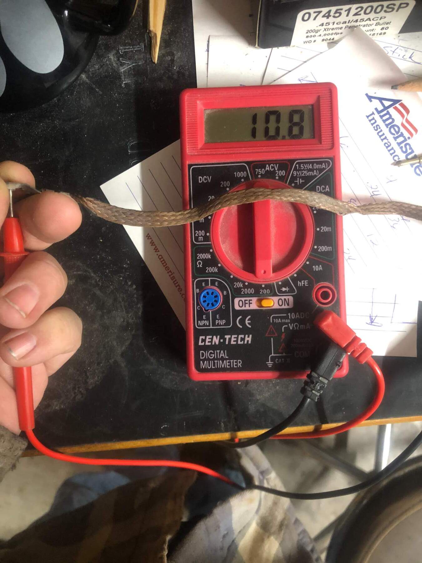

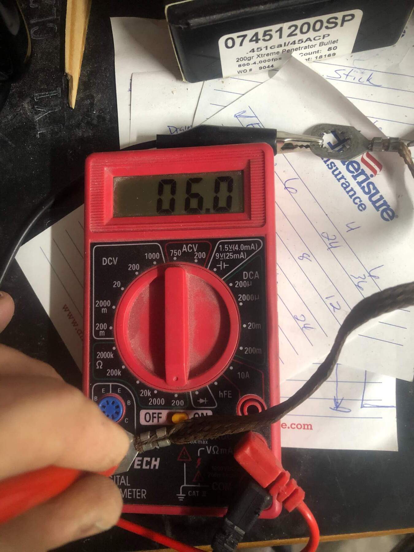

do our little test mate... ohms test between the housing of the dissy and the block.that will ensure you have a good ground
 like we talked about with the earth straps, you want something like 0.1-0.3 ohms of resistance with your multi-tester
