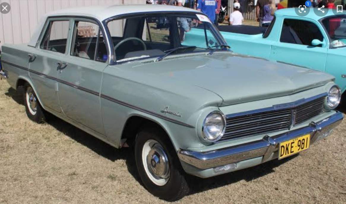

I'd like to chime in with a similar story (I'll keep it as short as possible - am conscious of hijacking these days!) I used to have a 1964 EH Holden which had a following almost as popular as your 57 Chev. It was a handsome, capable car and was ideal for Australia back in the early 60s. Anyway, I had some headers fitted. When I got the car back, it wouldn't idle properly and would almost die then inexplicably rev to about 2k all by itself then almost die again before repeating. I didn't have a clue! One day, I'm staring at that engine doing it's thing and it was like my hand was guided by a superior entity: I reached under the inlet manifold (it was a 6 cylinder) and there was a huge square hole! THEN I realised what had happened: the exhaust shop had removed the old exhaust manifold that was bolted to the underside of the inlet manifold and had acted as a heat riser but nobody realised there was a hole underneath. Anyway, I replaced the manifold with a later one and a 2 barrel carby and she ran sweet ever after. I have been relentless about vacuum leaks ever since! Attached is a file photo of an EH.
Compared to poor Wrongway, mine was an easy fix. Good luck, mate.
