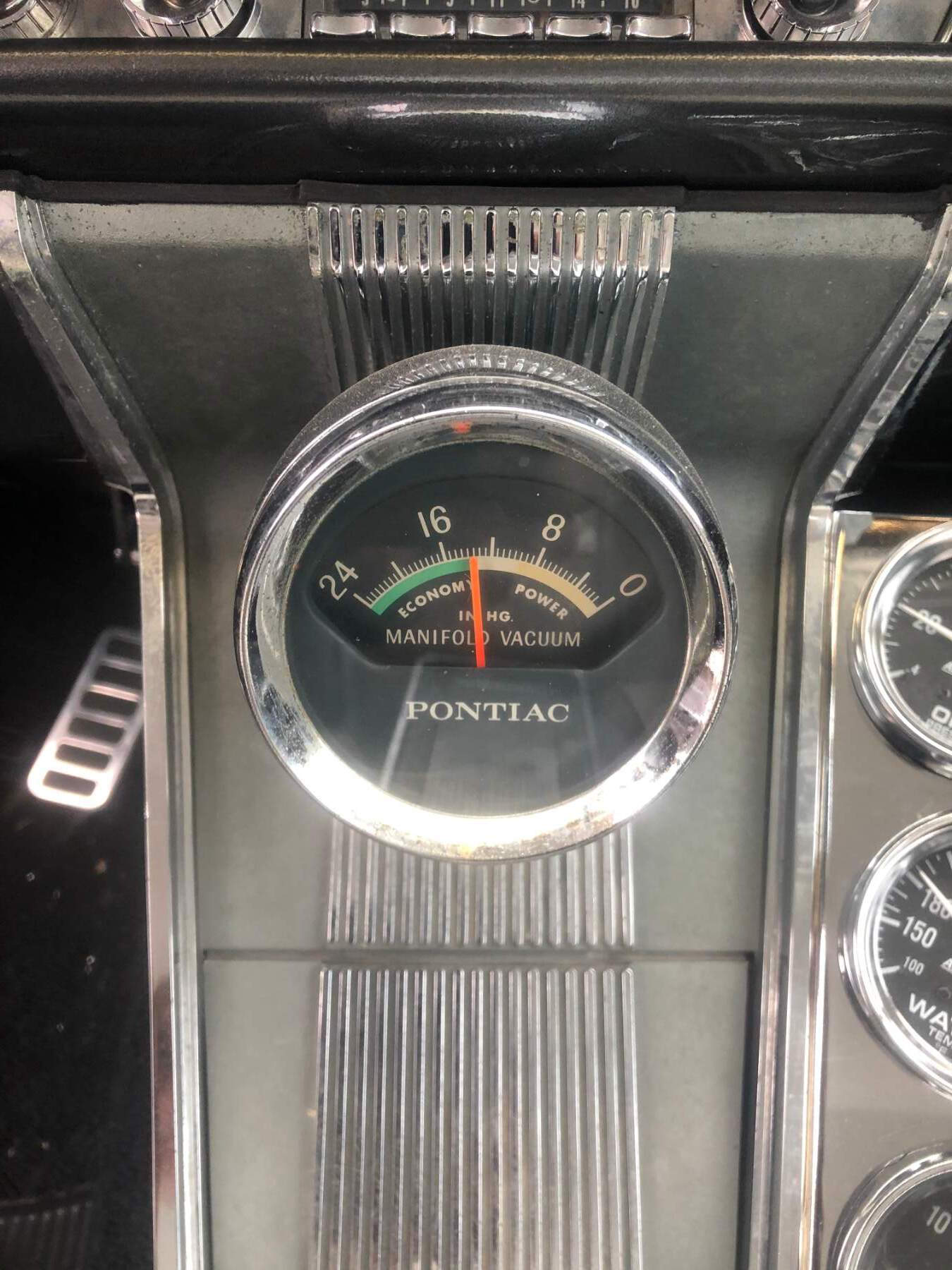

Ok, so hopefully I explain this right lol. So last night at 900rpm I was at 10.2 degrees of timing. (timing mark pointed at the 0 on the pointer.) I checked it this morning before any adjustments were made. At 2500rpm that gave me a total of about 22 degrees. Yesterday I advanced it as far as it would let me and still be easy to start (10.2). I did go farther but she either wouldn't start or she was hard to start. All that was with the distributor vacuum still hooked up to the carb. After that (since I'm by my self right now) I idled the car up to 2500rmp using the idle screw on the carb and capped of the distributor port at the carb. I then advanced the timing to 35. Backed the carb down. Gave it a couple of min and turned it back up to 2500rpm and double checked the advance. After turning it back down to 900rpm I checked the timing there. Its now at 23 degree's at 900rpm and 14-15in on the gauges and really hard starting. I know I'll need to pull timing out but should I go back to the 22 degree at 2500rpm or??? As always I've included videos lol.

Okay, I'm just shooting from the hip here because I'm in the car and on the way home from gallbladder surgery. Never and I do mean never adjust timing with the vacuum connected. That invalidates everything.  I'm not familiar with that distributor and I can't really go look it up bouncing along the road here in the car, but I'm hoping that it has a means for adjusting the amount of total travel it has in it. It sounds like you need more.  Also, did we ever validate that when your balancer indicates top dead center that it's not lying to you? That can be important.

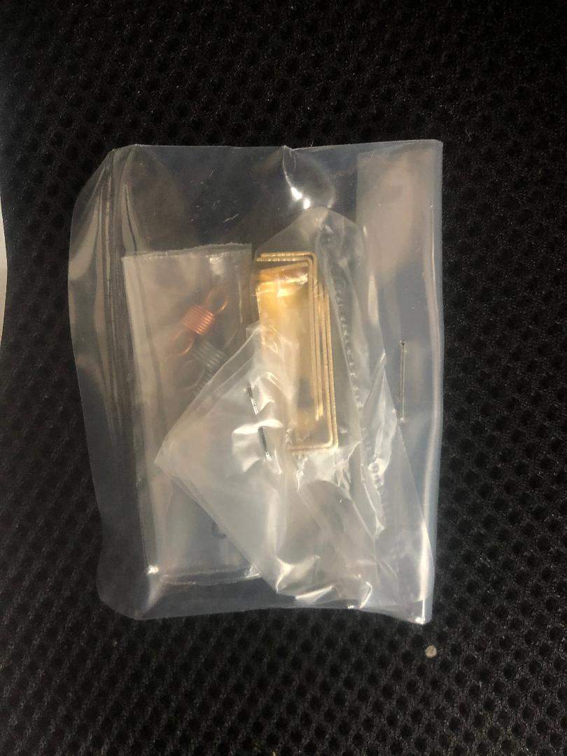

If I'm reading the documentation correctly that distributor has a maximum of 24° mechanical advance but it comes in a relatively high RPM even with the lightest springs on it.
Just as a starting point and to see how it acts, I'd put the lightest copper springs on it and set your initial timing to 10° and see if it likes that. Of course that's setting it with the vacuum hose disconnected and plugged.

I called summit and got the part number for the springs. After looking them up I know that I don't have a set. So I've got a set on the way bud. I will let you know when I get them installed. Thanks bro, feel better.
Got the springs in today! I'll get them installed in the next day or so weather permitting.

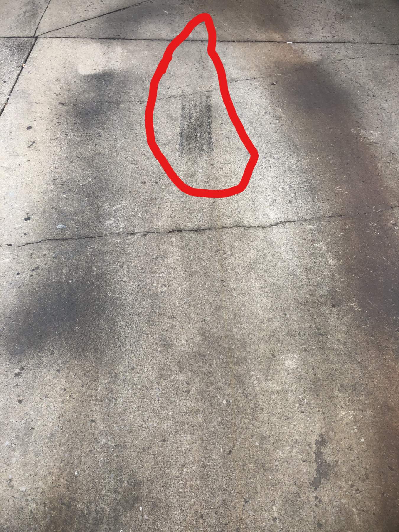

Ok so I changed out the springs. I set it at 10 degrees of initial timing after letting her warm up. The put the copper (lightest) springs in. Hooked up the timing light and the screen went black. Switched to RPMs and it showed 930. When I hit the throttle the screen went to 000 then went blank. I played with the connections and it didn't do any good. The timing light is dead. BUT, the good news (I think), When we started all of this I had no power. Couldn't even do a break torque or spin the tires at all! So I backed her up to get my buddy's bike out and pull in another bike I'm getting ready to paint. When pulling the car back up, I barely tapped the gas and she spun the tires!. Wasn't trying to spin them but she did! So in my head that's a good thing right? Guessing that I need to replace my timing light and double check that I'm all in by 2500RPM still? Any opinion on this timing light, "Innova Digital Timing Light 3568"?
