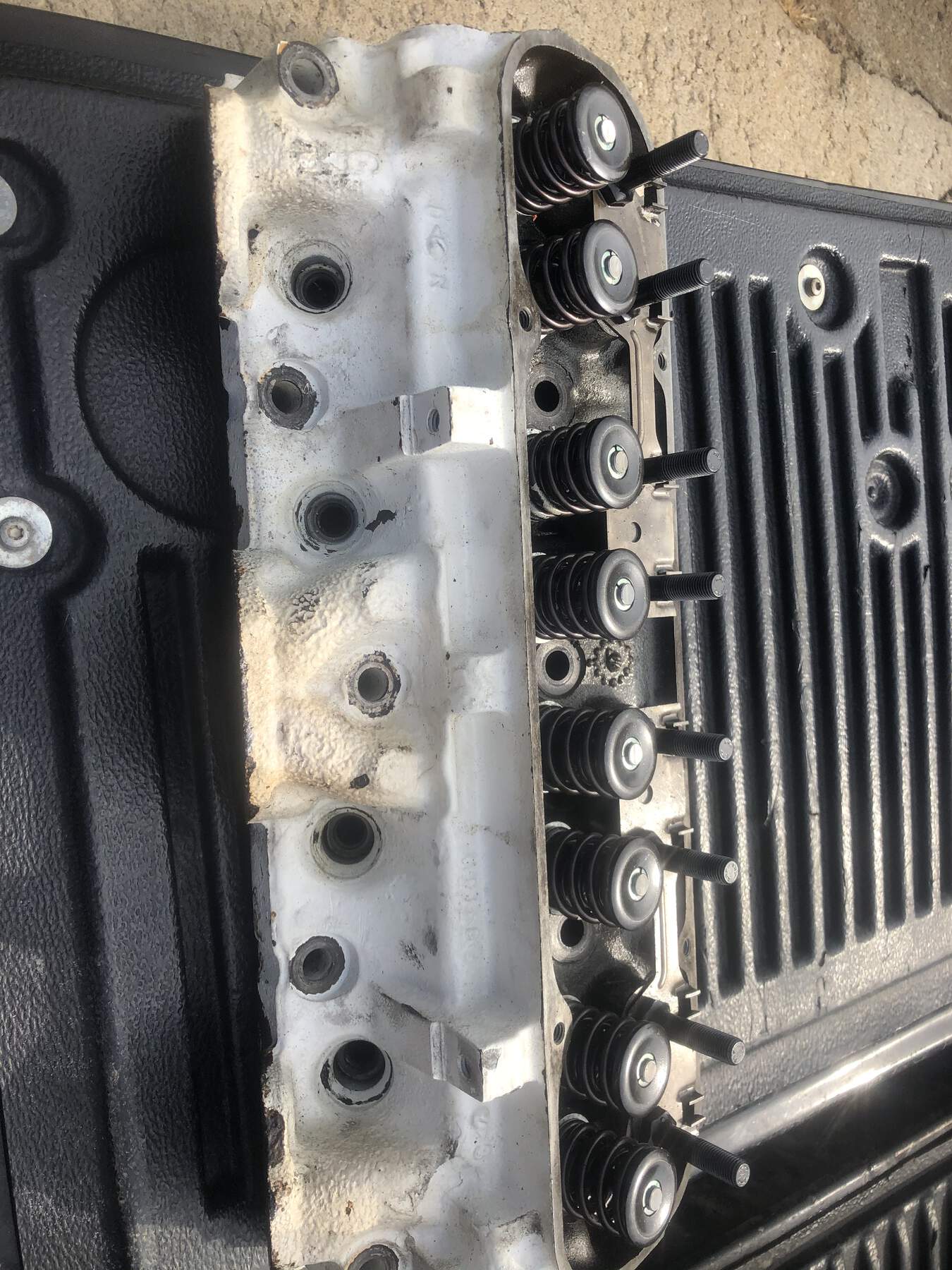

So I got a call from the machine shop today. I've been trying to decide whether or not I should be concerned. Figured I get your thoughts. When I 1st dropped off the heads I was told it would be $200 to inspect and rebuild the heads plus parts. Cool no problem. Then he told me that did not include cutting new valve guides. That he broke the cutting bit last year and since nobody is really running cast iron heads anymore that it just wasn't cost affective to replace it. As long as the guides aren't bad he can do the job. If the guides are bad he'll only charge me $50 for the inspection. Now I have heard good things about this shop so I figured I would at least get him to inspect them for me and go from there. FYI, the next closest machine shop is 2 hours away and said I would be waiting 3-4 months to get them back. So as I said, I got a call today. I was told that he could not get my springs to compress. His machine was not strong enough. I told him that I have a compressor that would compress them (another post World War II tool Frosty lol).That I had already compressed the exhaust valves once when I replaced them and that I would bring mine down in the morning and remove them. So I'm not exactly sure about how I should be feeling right now about this shop. Don't get me wrong, I have no problem helping somebody out or loaning a tool or giving him a hand. I guess I'm just concerned after everything we've been through with this engine. I'm thinking I should just go get them in the morning. So what would y'all do???
Edited by Wrongway
Yes, I would have a concern! A shop who’s lively hood runs on doing machine work on engines who doesn’t have the equipment to do it would make me question their ability!
Edited by Last Indian
You JUSTA can't seem to catch a break man.  While it's true most all heads are all aluminum these days,  kinda funny he's accepting work knowing he doesn't have the tools to work on it.

How much would a valve guide bit run?   Spring compressor is simply unexcuseable if he really does headwork.

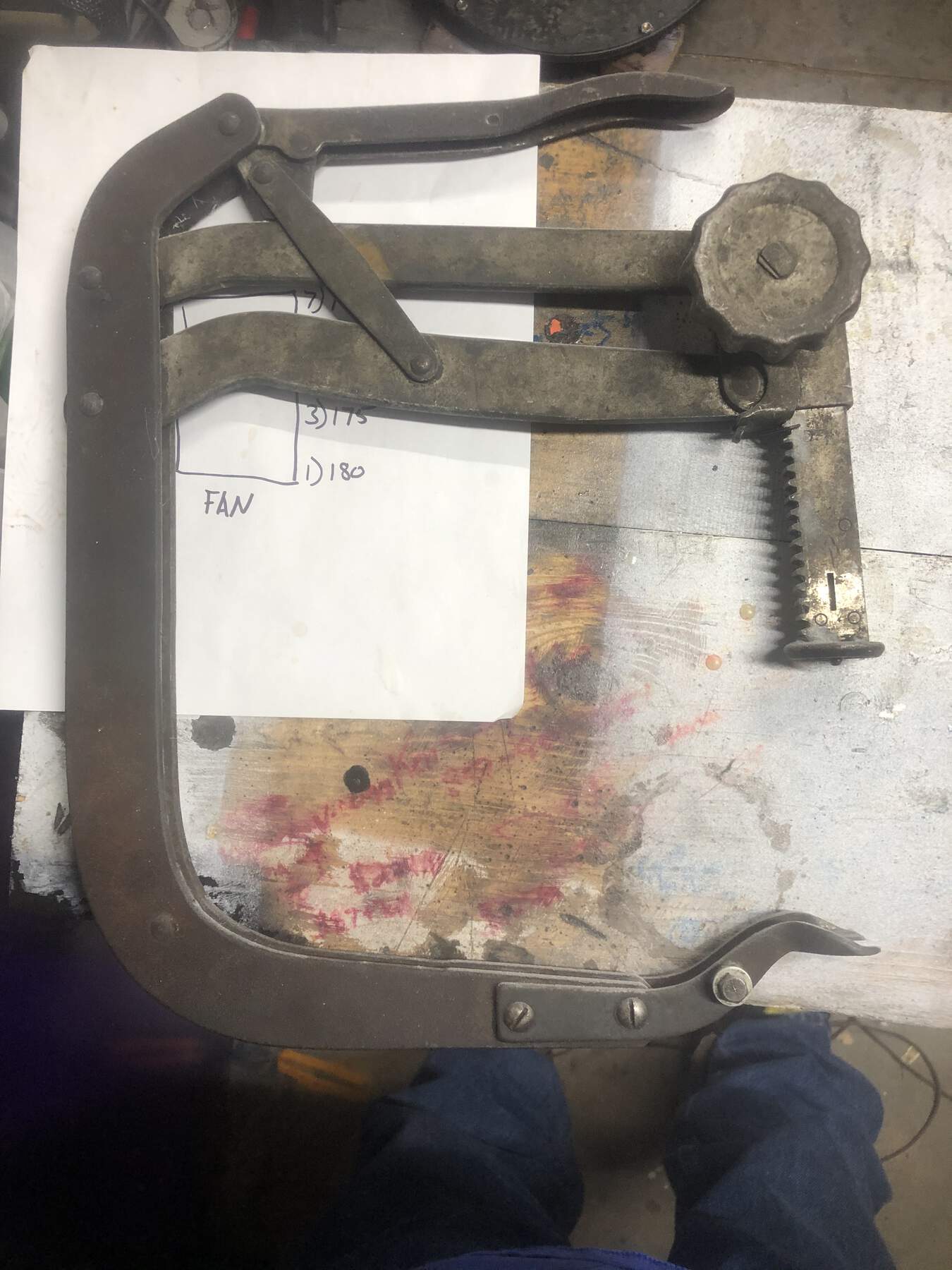

I'm not sure on the cost bro. I didn't ask. I just got back from his shop. I asked what kind of tool he was using to remove the springs. He took me into the shop area and showed me an aluminum air version of my tool. He explained that every time he tried to remove a spring that the fork would separate. He said he was able to remove 1 exhaust valve and he has never seen springs this long. (Get this lol) then he tossed a CAST IRON ford head up on the bench and showed me how his tool "normally" works! Yup, another cast iron head. While he had the Ford valve out he went on to show me how to check the valve guides. Said if I could get the valves out that I should be able to check them myself. The way he showed me was wiggling them. I told him I figured there would been some sort of fancy measuring device to check them. He said there was no way to measure them that his "wiggle" test is the way everybody does it. Is this correct? If so was he right, is this actually something I can do here in my little shop?

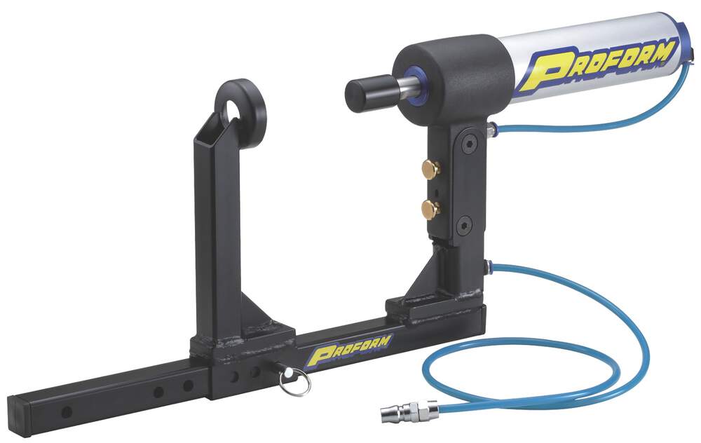

 When I'd expect a pro machine shop to have something like this:
proform-pneumatic-valve-spring-compresso
See the difference?  The ''business end" is a continuous ring - nothing to separate.

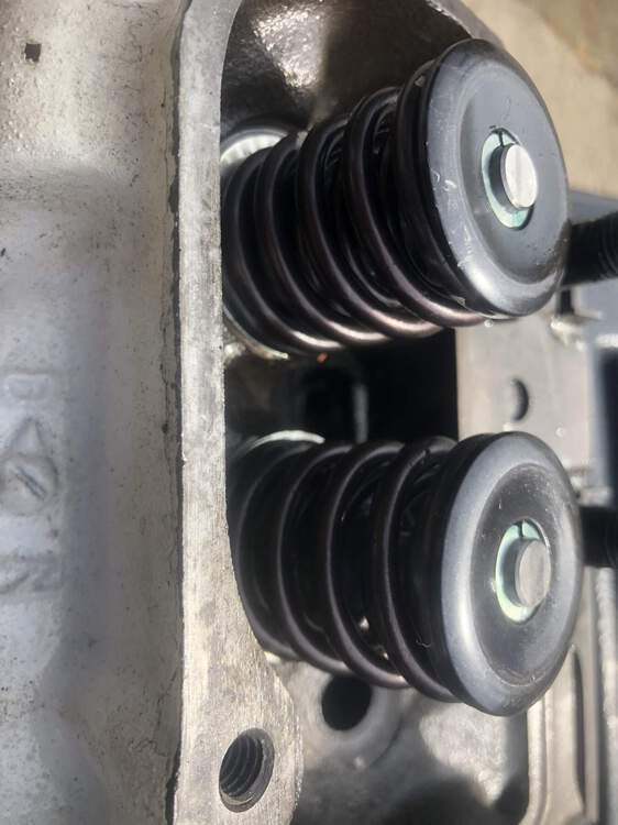

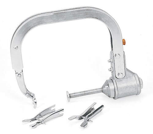

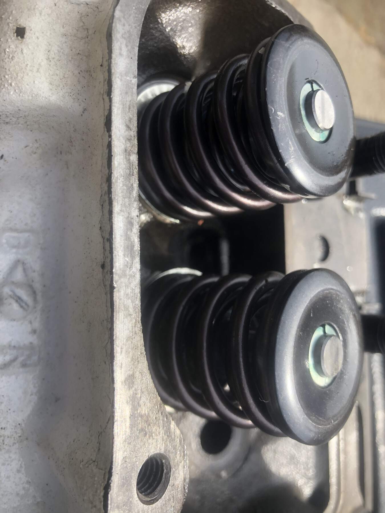

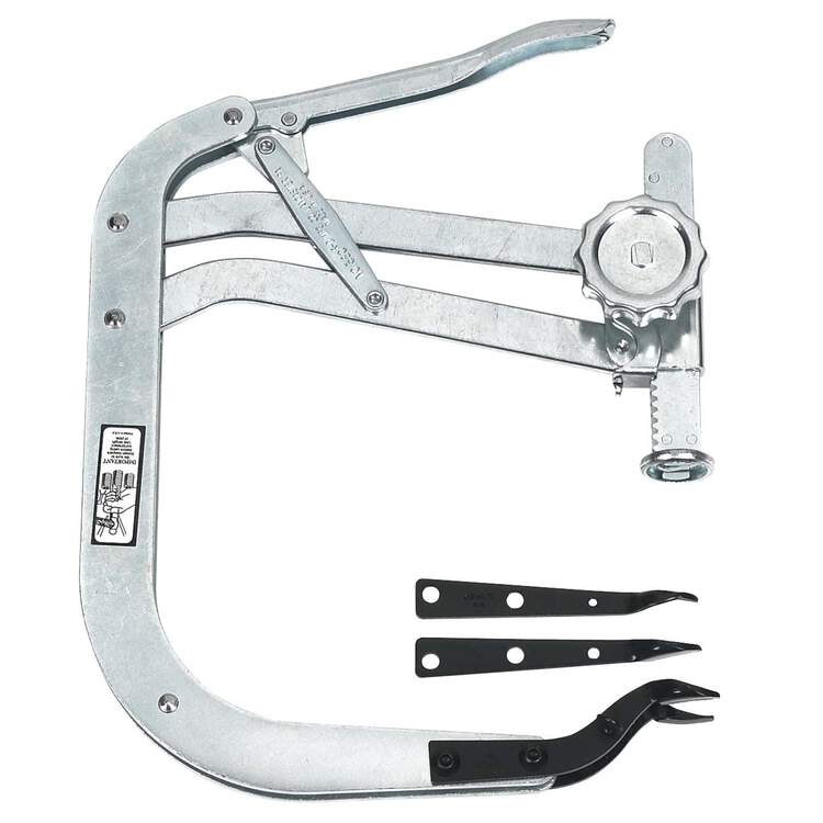

Yes Bear, your correct sir. His tool looked just like the 1st pic below. Only well used. The 2nd pic is of my actual compressor that I used last time. I'm in Kentucky Bear,  little town about 20 miles south of Lexington. The 2 hour drive I was speaking of was to summerset ky. The reputable shops iv heard of are down there. I've got an appointment to drop the heads off Saturday morning unless yall say that I can do it. I may be able to find the info on the springs. I no they are the double springs. I ordered them from Comp at the same time I ordered the timing set, cam, rockers and everything so that I knew they would all work together.
Ok then, yeah - having the spring specs or even Comp's part number so we can look them up would be very helpful.  Since it's all aftermarket stuff, did you check and verify your spring installed heights and also make sure that when combined with the cam you're running, they aren't going into coil bind?   All that is supremely important.  Its very common with aftermarket springs to need to either cut the spring seats down, or shim the springs up to get the installed height correct.  Otherwise, the spring won't perform as rated.  Either they'll be providing too much pressure which can cause premature wear on the cam and also risk going into coil bind, or not providing ENOUGH pressure in which case the danger is that the lifters might not stay under control and can be "thrown off" the cam at peak lift - engines don't survive that.

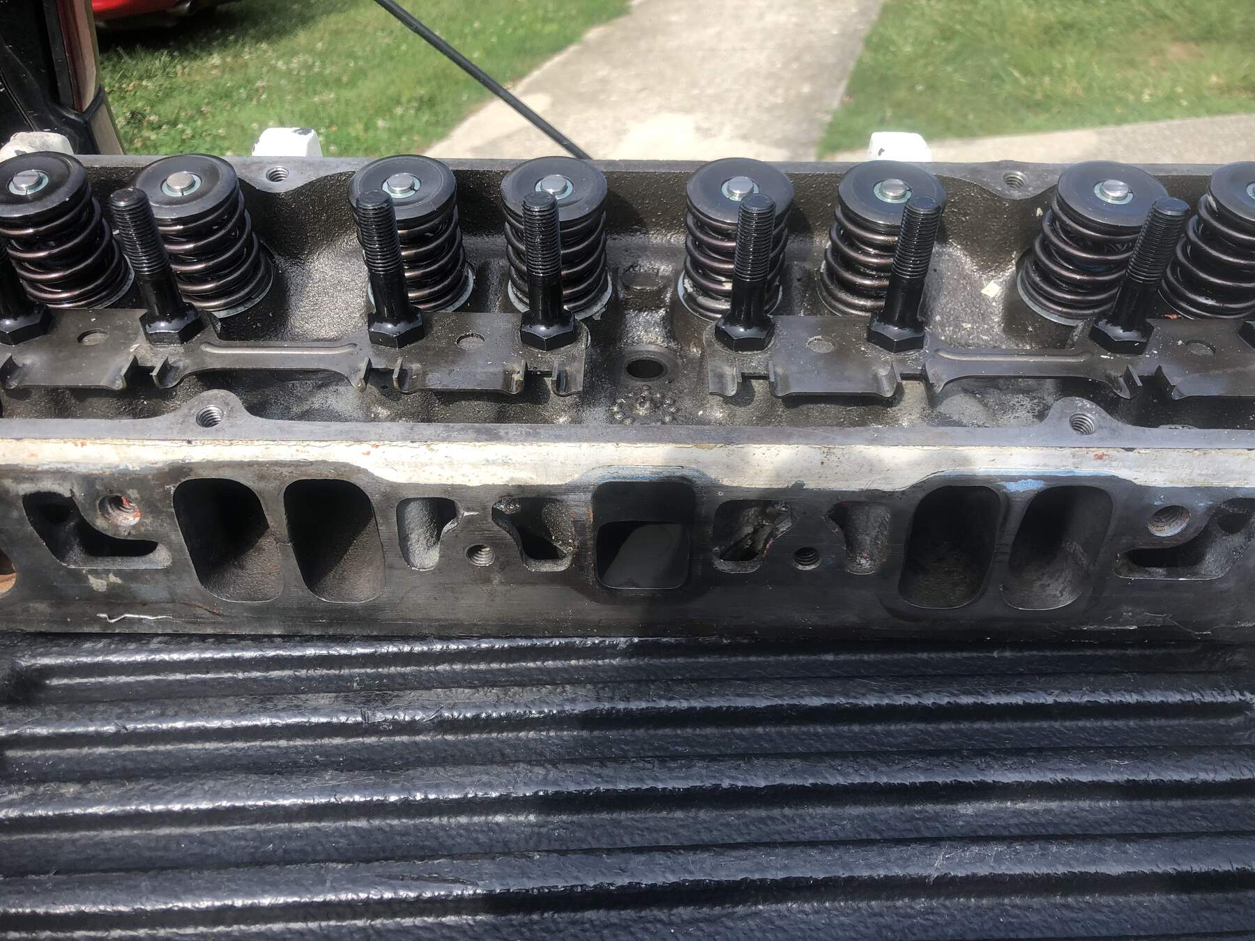

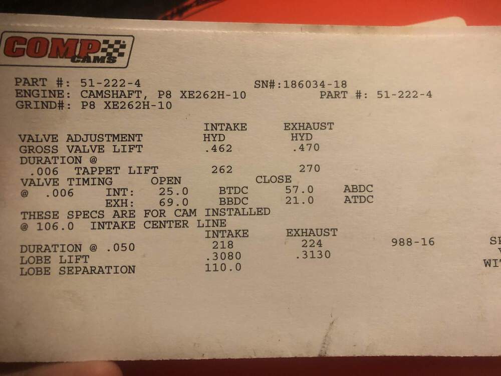

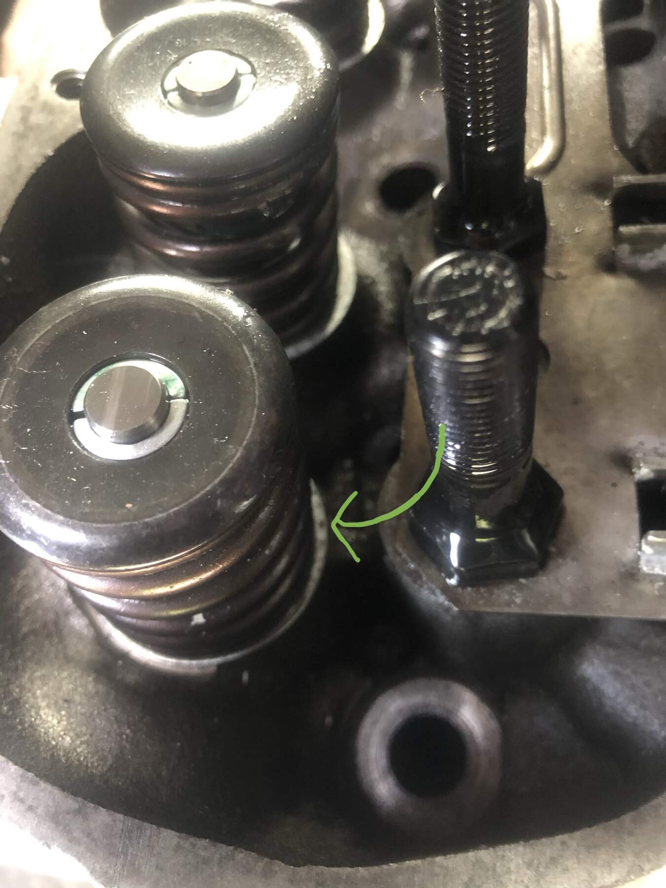

Ok bro, I do not have the specs but the comp part# is K51-222-4 and I checked summit and the number works to pull up the complete kit that I bought. I believe that the 1st shop I took it to when I had the heads rebuilt put shims in. When I replaced the broken valves I seen flat disks with a number stamped into them underneath the springs. You can see them sticking out just a bit in the 1st picture. I figured they were shims. I did watch the springs as I rolled the engine over a few times by hand when assembling it and didn't see any binding. I also had the engine running with the valve covers off while checking rockers and didn't see any binding.

Great - ok I see your cam specs.  I called Comp myself and asked about the springs, the part number he gave me (SKU 995-15) I don't find on their web site but the rep gave me the specs on the springs.
Installed height: 1.700
Seat Pressure: 115 lbs
Open pressure: 336 lbs
Coil bind: 1.150  (so the max safe valve lift is about .490: 1.700-1.150-0.060 safefy margin = .0490)  - which is within range of what that cam makes assuming 1.5:1 ratio rockers (.462/.470)
All that of course assumes that the spring installed heights are all set correctly at 1.700

The springs you have, I assume they're "right" for your cam because they're part of the kit.  They aren't super stiff by any means, so your machine shop should have had no problems at all working with them.  By way of comparison,  my engine has a solid roller cam that's significantly more "rowdy" than what you have so it needs stiffer springs - and those springs generate 220 lbs of seat pressure at an installed height of 1.920 - nearly twice as stiff as what you have - and I can manage them with a manual spring compressor like this one:
https://www.proformparts.com/product-detail/66832/engine-valve-spring-compressor-heavy-duty-model-manual-clamp-style
So, I'm going to agree with others and recommend that you make the trip to a different machine shop and have them go through your heads.  Get a full valve job on both intake and exhaust, check the guides, verify the spring installed heights are all 1.700, and install new valve stem seals - this "style" - whatever size is right for how the tops of your guides have been cut.
https://butlerperformance.com/i-24453462-pep-500x-11-32-viton-valve-stem-seals-620-od-pep-343500-16.html?ref=category:1234798
Also have them verify that at .470 lift the bottoms of the retainers have adequate clearance to the tops of the guides.  Here's a good explanation of areas that need to be checked for proper clearances.
