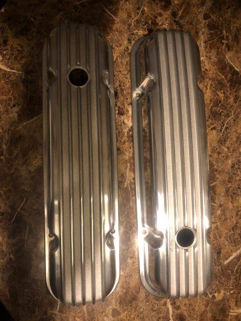

Got the valve covers today!

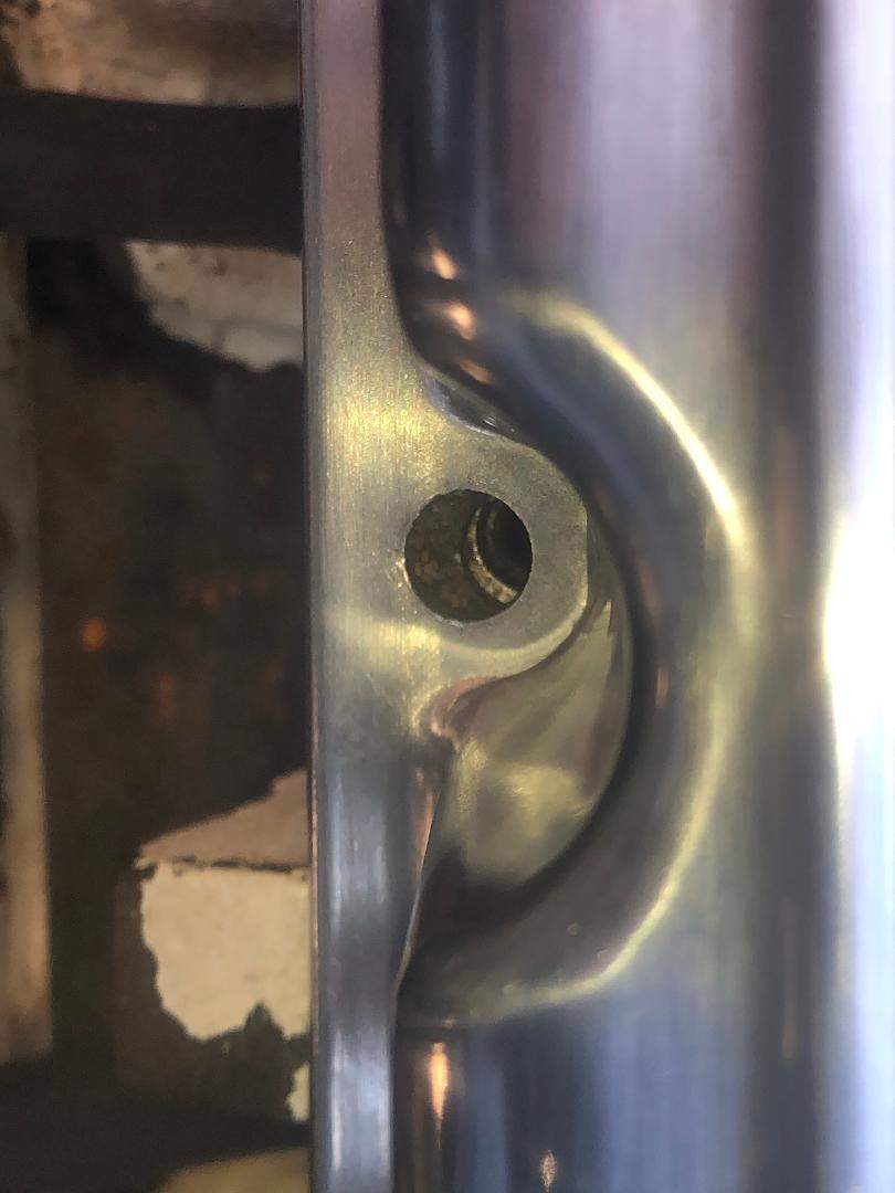

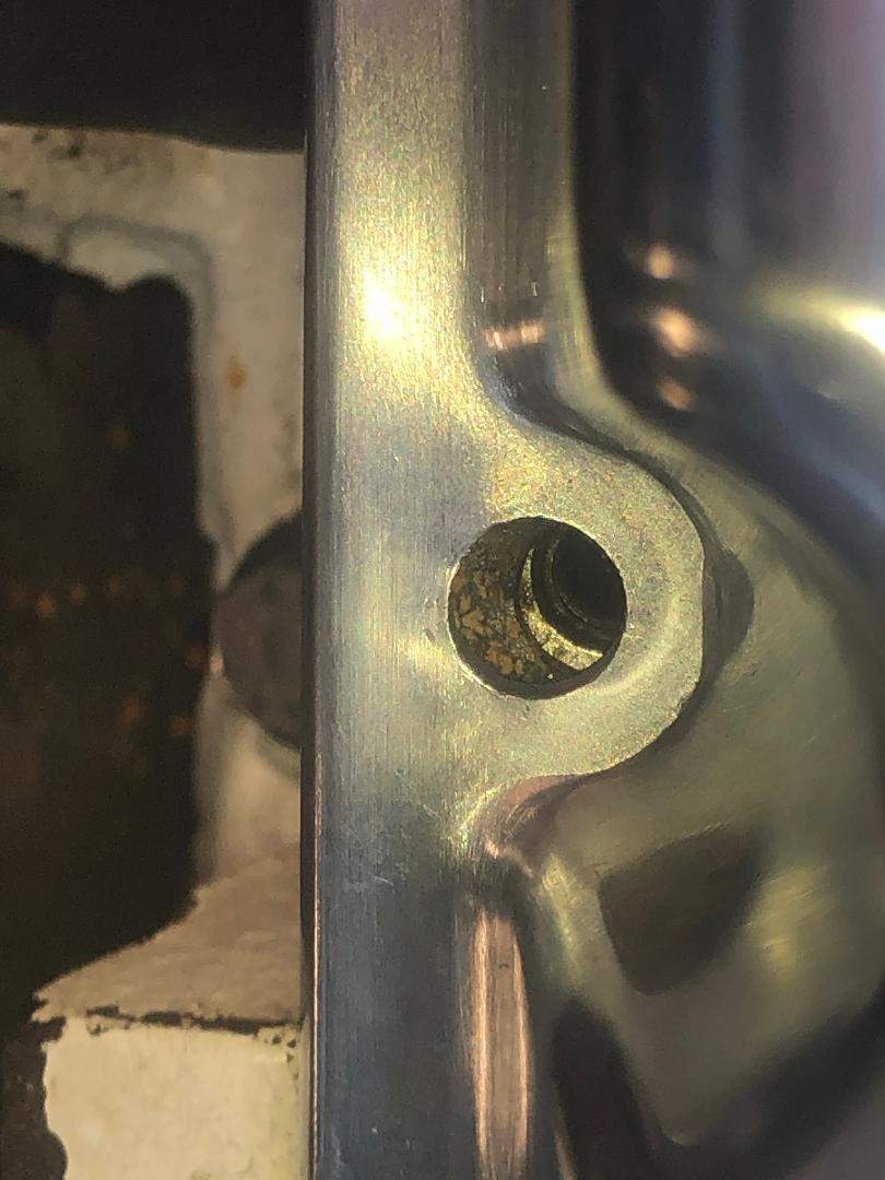

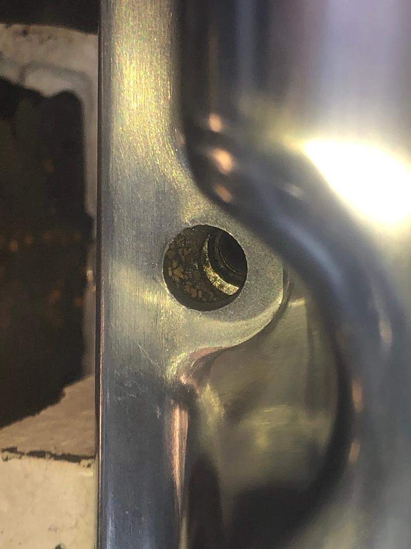

Well, the holes in the valve covers didn't line up. I reached out to the company I got them from and was told that I should drill them out to fit. Thinking that this was kind of an odd response I did just that, and yes I did order the valve covers for my engine. So I drilled the holes out from 5/16 to 7/16. They still didn't line up so I sent them back this morning. I could've went a bit bigger but I was afraid of leaks.
wow, thats heaps out mate! that also means that the gasket surface will not be correct either!!
they are a poor casting in my book mate, defiantly send them back😞
I couldn't agree more brother
