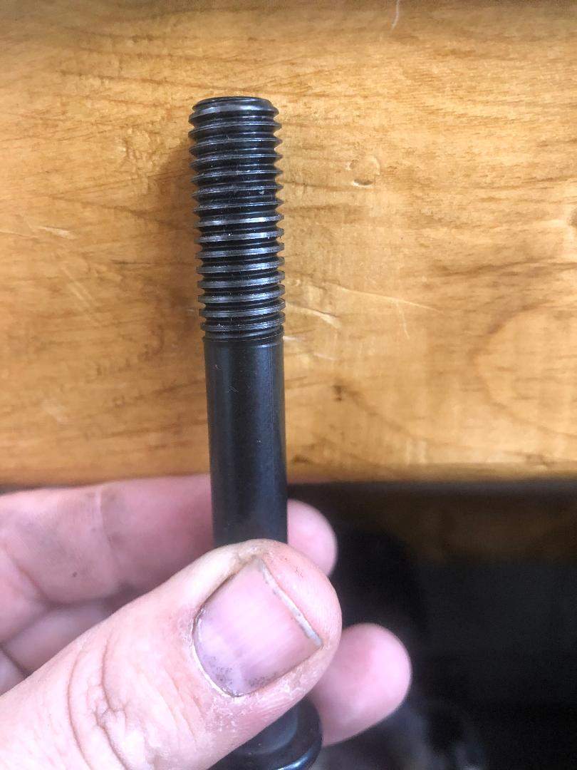

UPDATE: So I got ready to start reassembly last week and while cleaning the head bolts I found 2 of them that looked bad to me. I think this is what they mean by stretched? The bolts are ARP and were put in brand new right before we had the valve breaking issues. I reached out to ARP to ask about warranty and to no surprise they were not under warranty. I told the ARP guy exactly what happened and that I knew it was not their fault and I was only asking before ordering the 2 new ones. They actually still sent me 2 brand new ones no charge and no shipping. That was a surprise. So huge shout out to ARP for their customer service! Bolts arrived yesterday and I installed the heads last night and let them sit until today. (Had an old timer tell me years ago to do that with head bolts to let them destress. Is that true? Does it really matter?) Today I installed the lifters, pushrods, rockers and set the valve lash. I WAS going to finish putting the rest of the engine back together and decided to stop and check in with y'all. Just wanted to make sure there isn't something else to check or any advice from y'all before I continue? And yes I know it needs new paint lol but I'm waiting to make sure she's right this time.

Good catch on the bolts.  That's why ARP is such a trusted name in the automotive world.

No that’s not a stretch bolt! That’s a thread problem! Something somewhere is shaving the thread! A stretched bolt is detected by measuring the bolt length.

I've been thinkin about that too while mowing the lawn. How do ya screw up the top half of the bolt?? Looks cross threaded.  Thinkin I found the problem with my middle carb and flows along the same line as Wrongways bolt.
But if it was cross threaded wouldn't the whole bolt be messed up? I did clean out all of the bolt holes and thread the bolts in to make sure there were no issues. The ARP guy said that when a bolt is messed up at the top its normally from over tightening. He did not see the pic and I did tighten to ARP specs.

I have no answer for ya.  Only way I could see that happening would be streach from overtighten, but that usually happens on the non threaded part.

No it’s not cross threaded! The threads are actually sheared, flattened or a form of galling! Several thing can cause this. When rebuilding or just replacing certain components of an engine it needs to be cleaned, thread chased and deburred very well. Anything and I mean anything can mess up threads! When you chase threads you blow out the holes really well, but you should use a chamfering tool at the top of the thread first then chase the thread. Likewise all the clearance holes need cleaned of carbon so running a corresponding drill through then will do wonders, but again chamfering the top and bottom of any clearance holes that you can first Is very beneficial.
Any small piece of metal chip or hard carbon or any thread or clearance hole that has a buggered finish can step up a shearing scenario for threads. I have seen head gaskets shift enough on removal of bolts to get caught and gall or shear threads.
Wrongway you’ve got a lot of time and money tied up in this! I know it’s a pain, but I won’t advise going back if you need to and dotting every I and crossing every T.
My two cents worth!

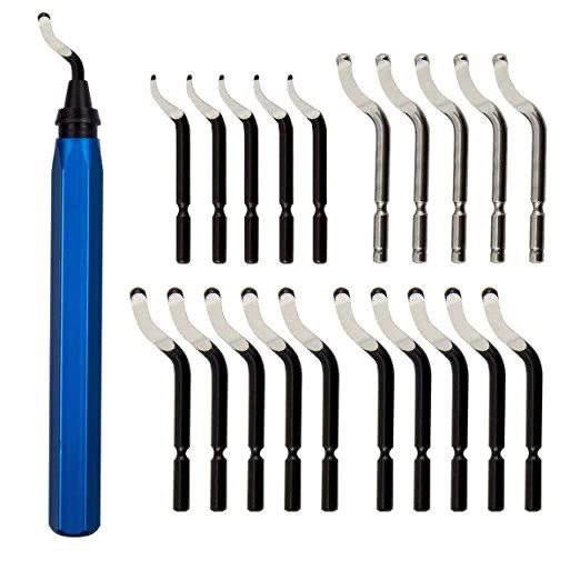

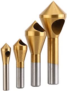

Nope! That real is the best you can do! JustA make sure visually that the look good! Also look at each clearance holes edges, both ends, these are basically the heads! Sometimes these holes will get a rolled edge that juts out into the hole! This actually reduces the hole size, this is one of the burrs I mentioned. This is the reason to use a chamfering tool to give a slight chamfer to remove it. You can also use a deburring tool.
these are chamfering tools. You can use them in a drill motor.
These are deburring tools.
