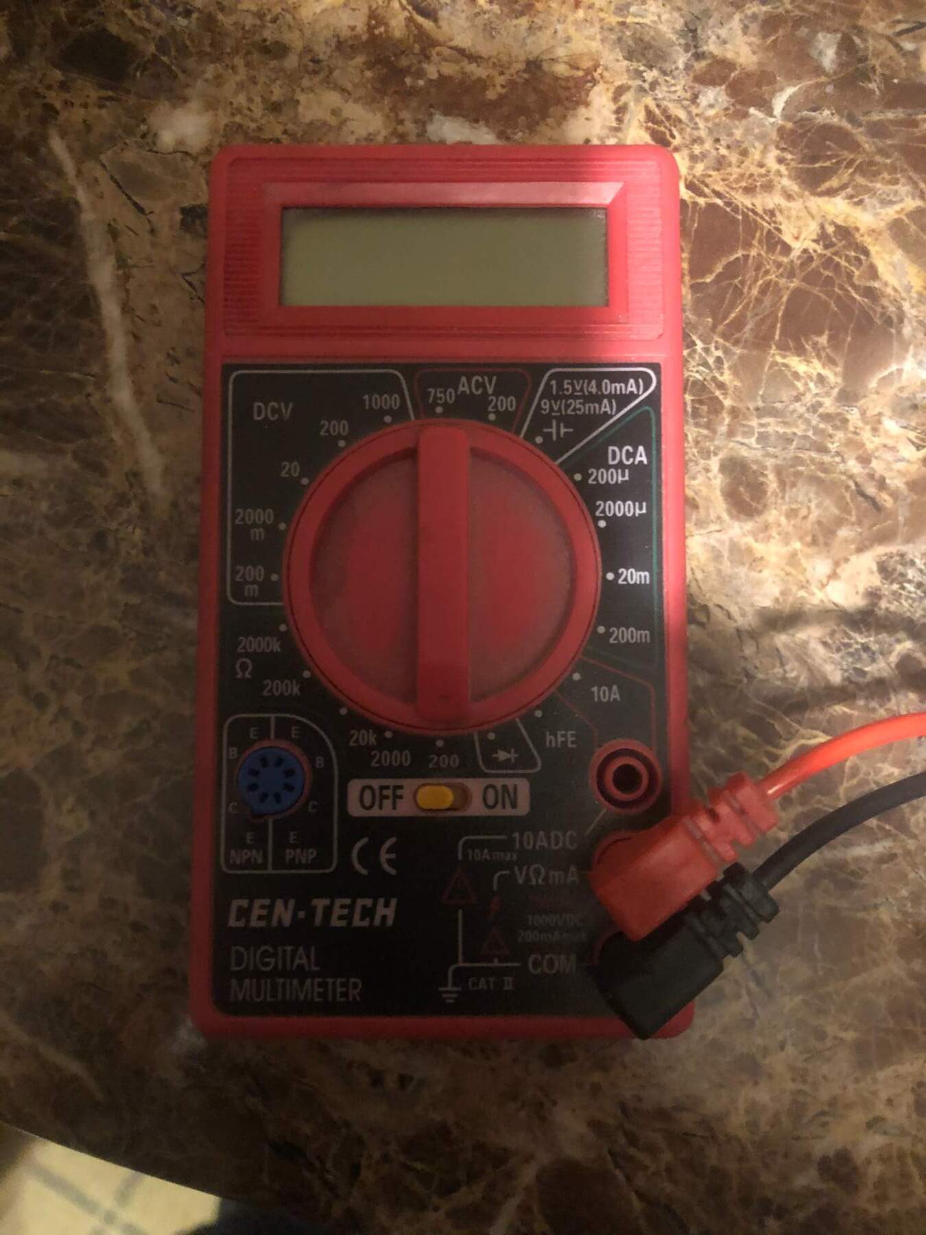

Ok so this is the first resistance test iv done. I read up on how to do it online. So If I did it incorrectly just let me know and I'll redo it. I included a pic of where I sent my meter and I checked it In multiple spots.
At the intake 00.1
At the bottom head bolt 00.1
At the valve cover bolt 00.1
My thoughts were that the bolts ran down into the block.
At the body strap bolt it flashed between 00.1 and 00.0
At the hood hinge bolt 00.1
I figured the hinge bolt went into the body.
Again, If I did it wrong or you need/want my to test somewhere else just let me know.

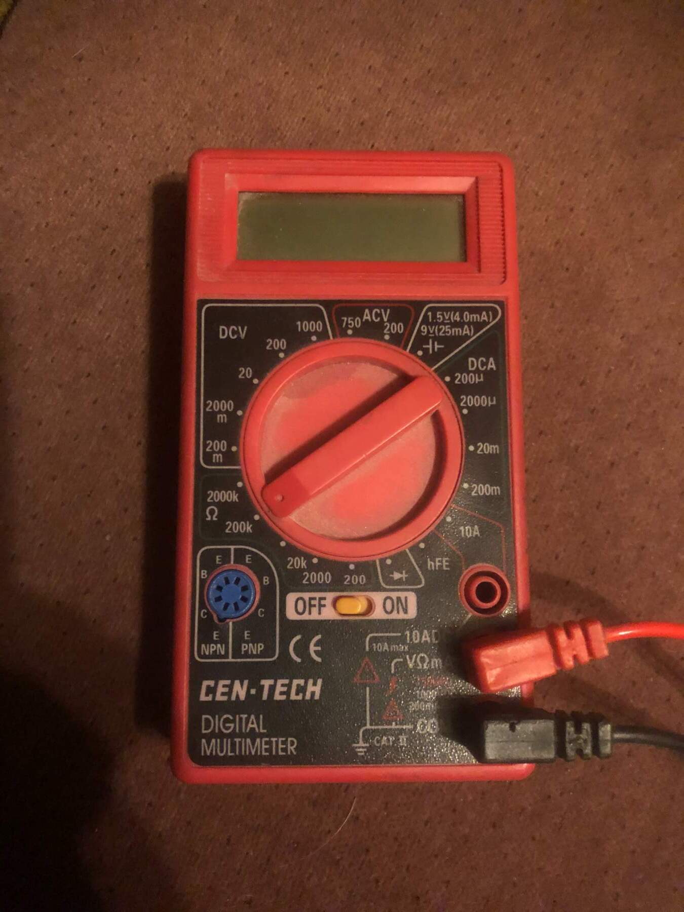

Your setting on your meter is too high mate turn it down to 200 ohms

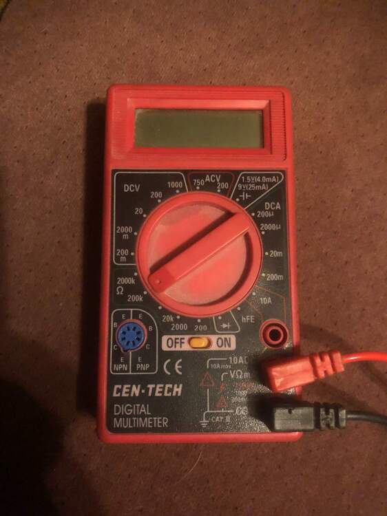

Ok bro, take a look at that pic. Is that where it needs to be? If so...
At the intake 5.8
At the ground strap bolt 6.5
At the intake 5.8
bang on mate,,, that tells you there is resistance in each of those earth straps, pull em sand the surfaces and hell, even test the strap with your ohm test. basically you should be some were in the 0.1ohms  ish area for a good low resistance earth strap.

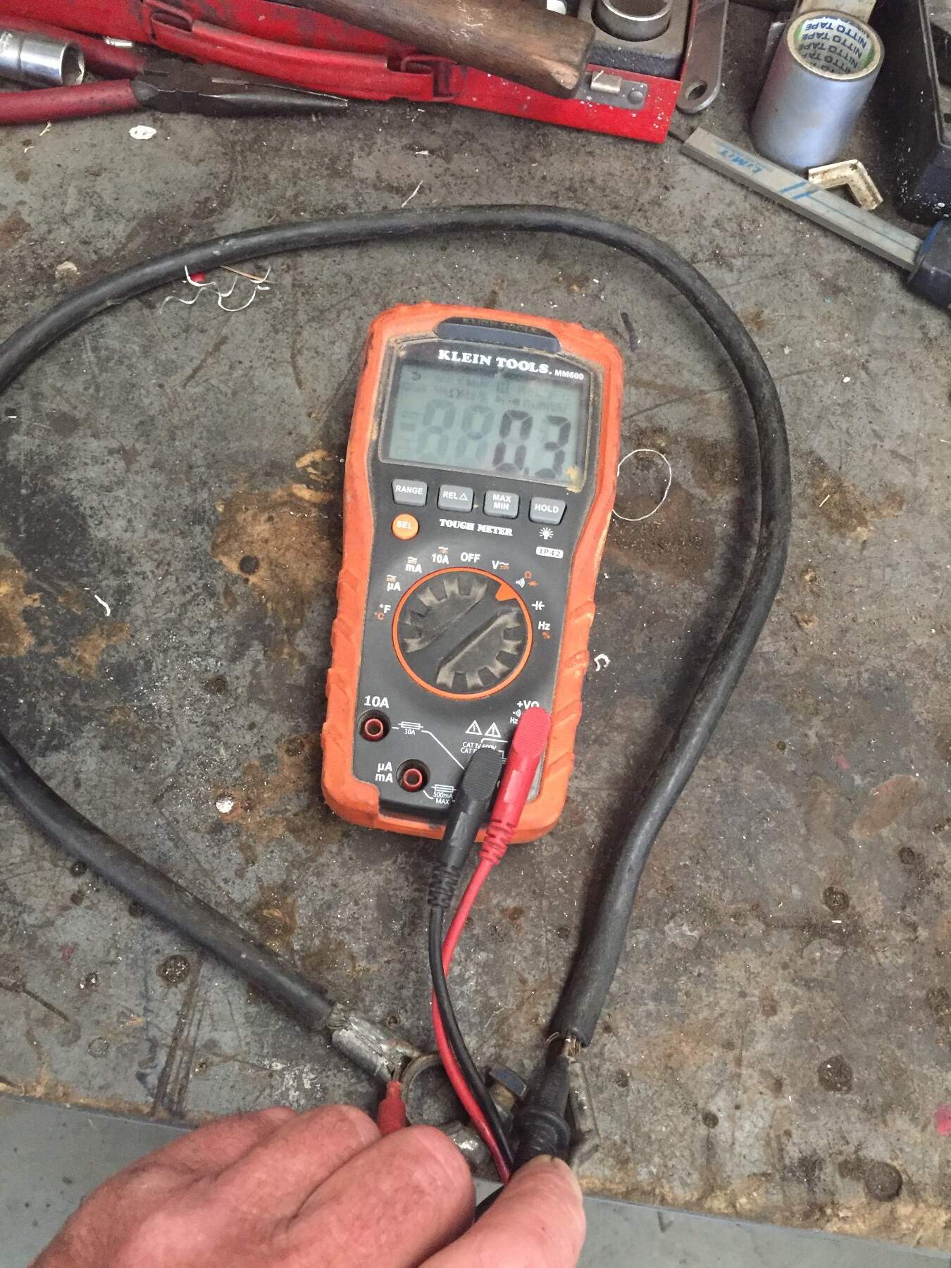

here is a dirty old earth strap and this is what you want to see as the level of resistance this ones 0.3 ohms
