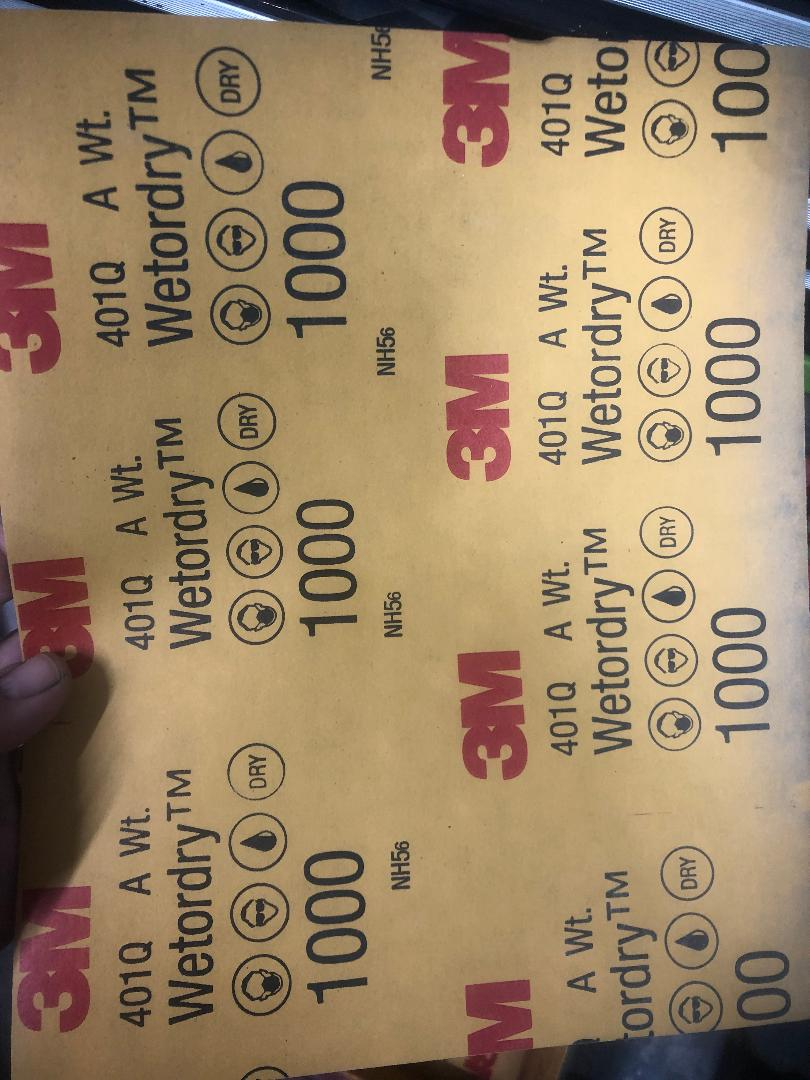

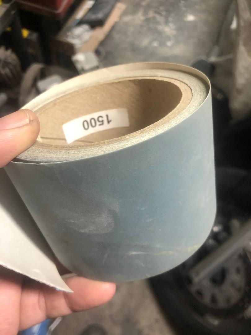

Does it work ok to use the foam pads I already have wrapped around a small block? Or do I need to get paper sheets?
Thanks,
Bear

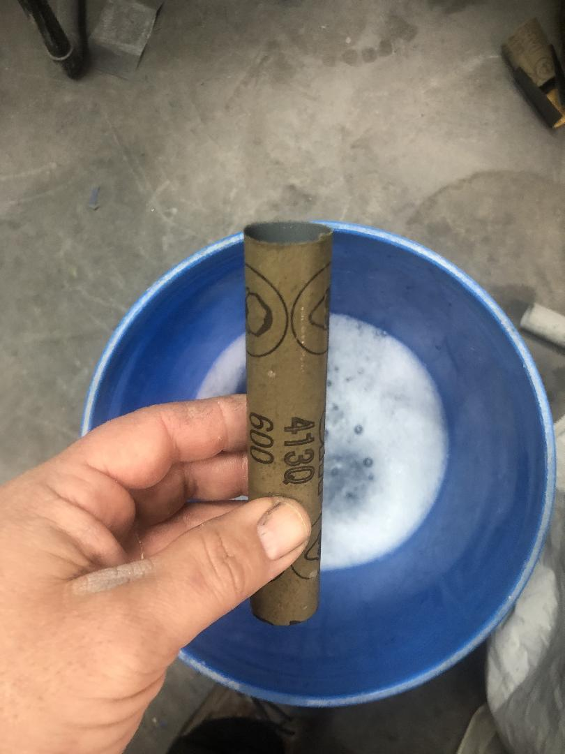

That's really your call bud. I do prefer the sheets and rolls. The sheets I can cut to work with all of my blocks. It'll give me 2 for the long blocks, 4 for the shorts and 8 for my minis. But If you do use the sheets make sure you "pre load" them. Its not a necessity but it does reduce the risk of scratches, holds water better and you get better "glide". All pre loading means is that after cutting them to the size you need you toss them into a bucket of water or soapy water whatever your using until they roll up. That's how you know their ready.
