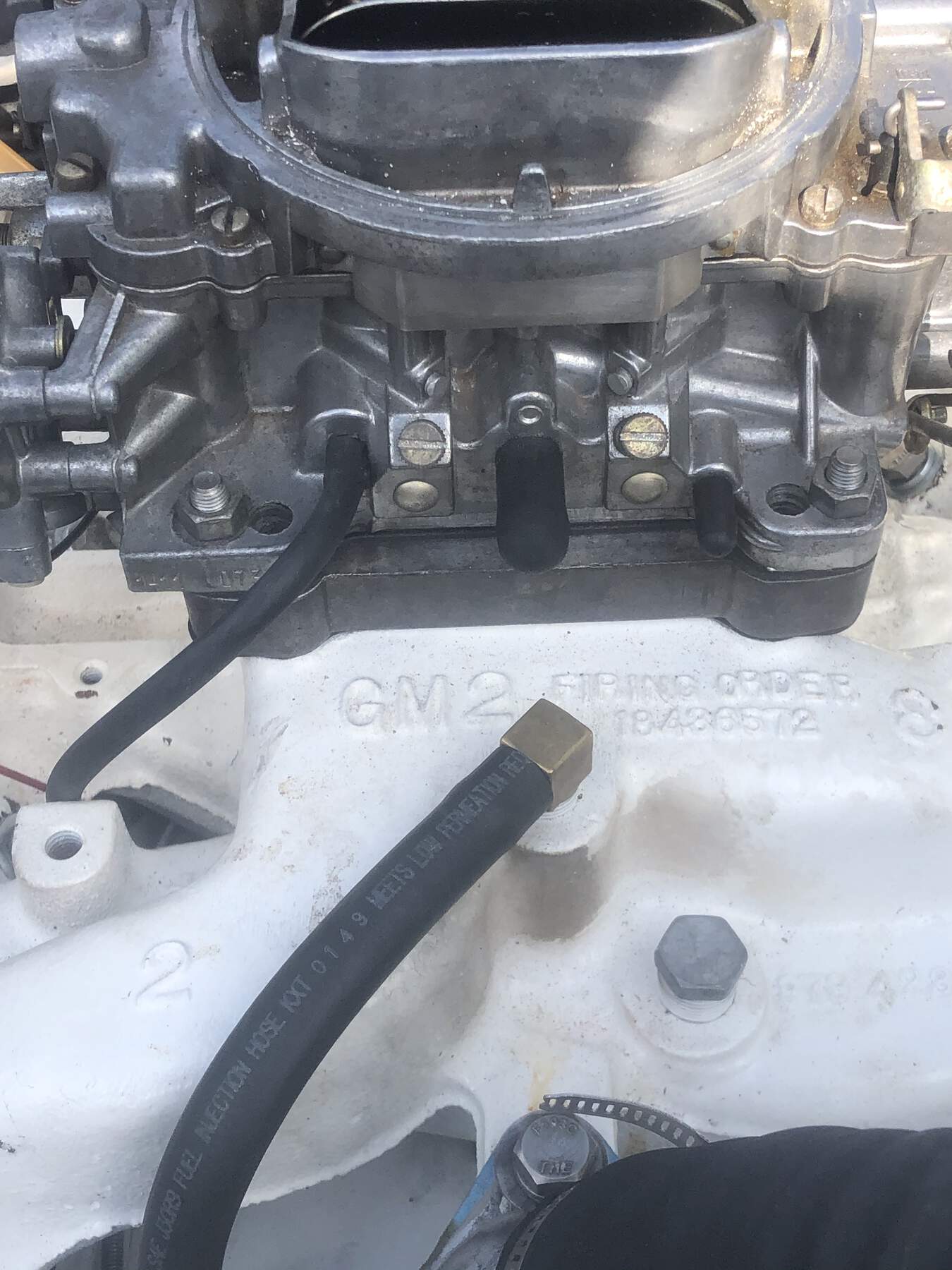

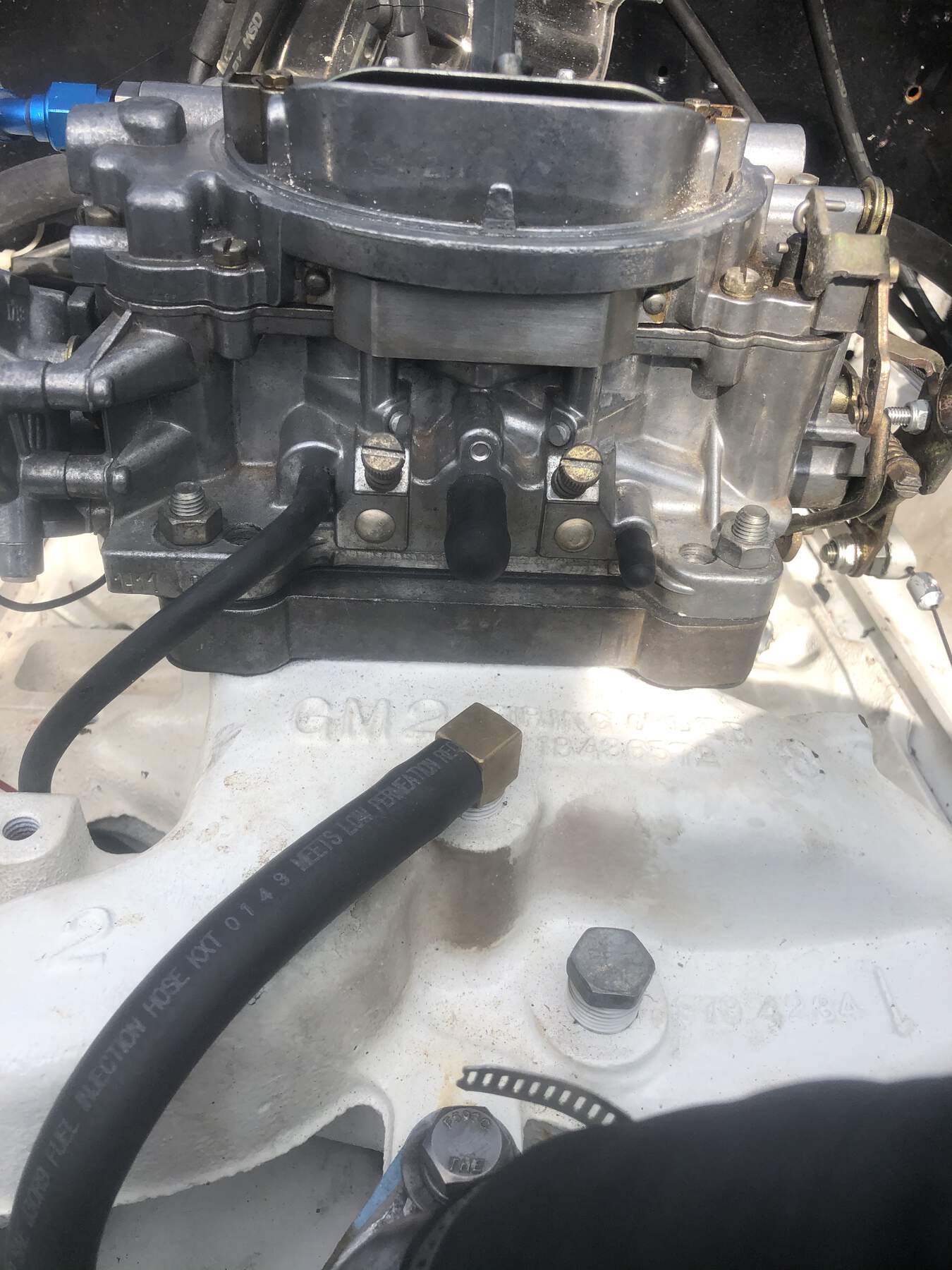

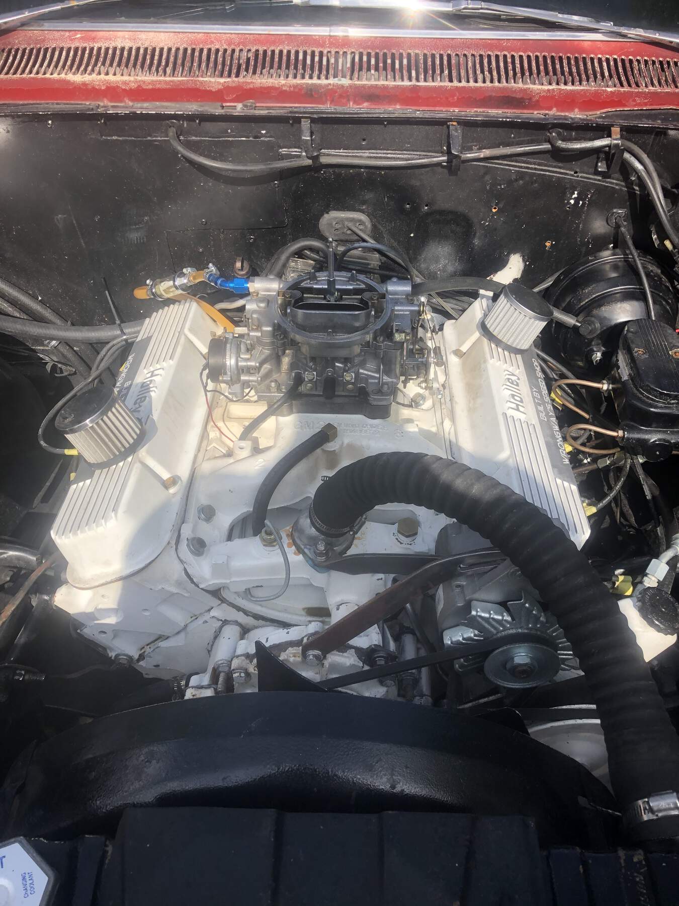

Wrongway, do me a favor take some good pictures of the carb & manifold where the carb bolts to it, also showing the vacuum connections. Also check your firing order! And bring #1 cylinder up on tdc manually, take off the distributor cap and see where the rotor is pointing! If it’s not pointing directly at #1 pin in the cap, you’re off a tooth, because somethings off! That motor is idling way to rough!

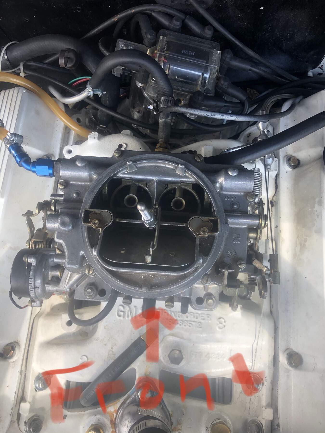

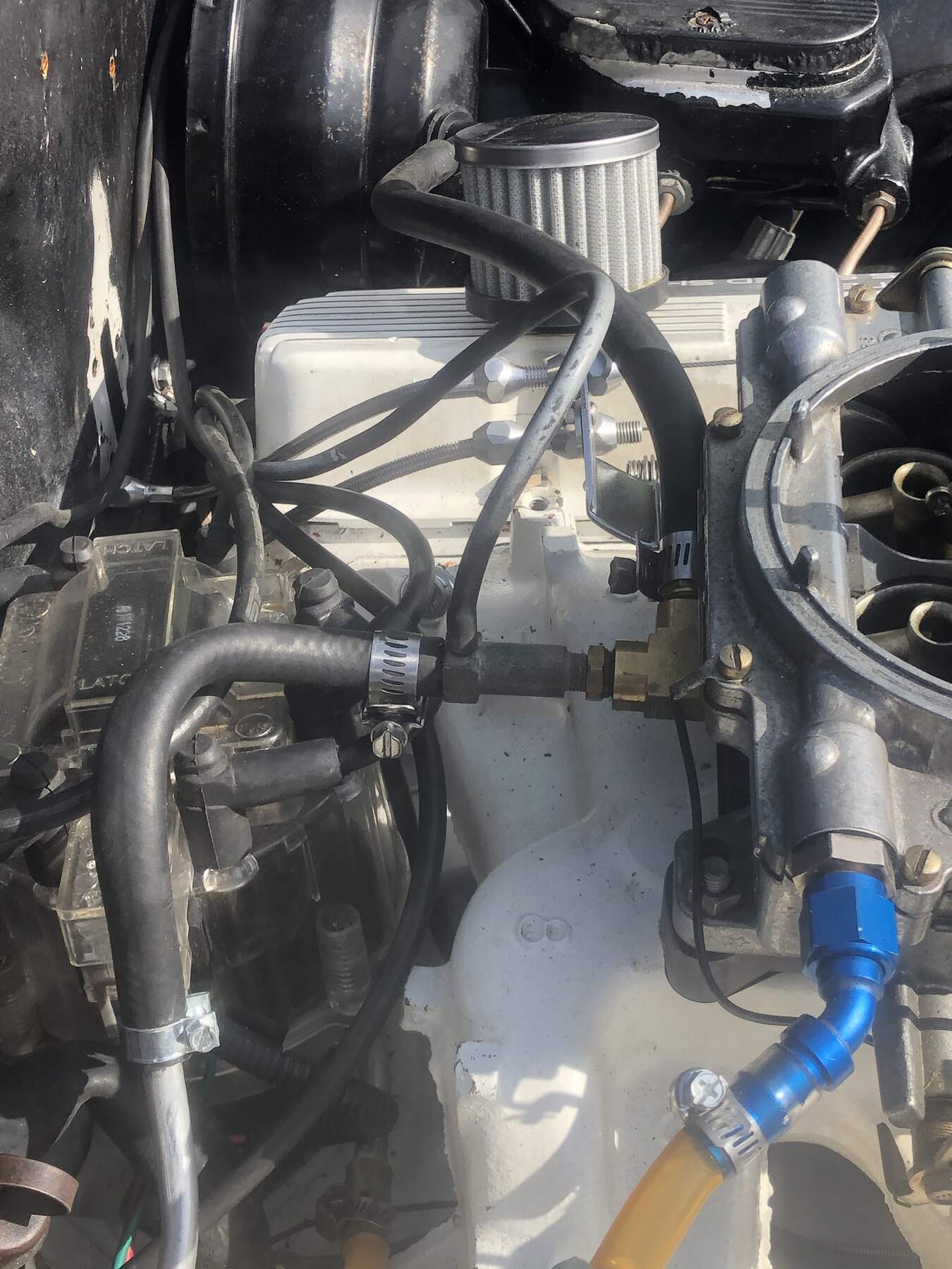

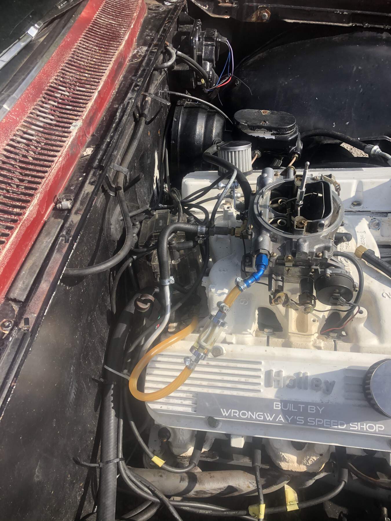

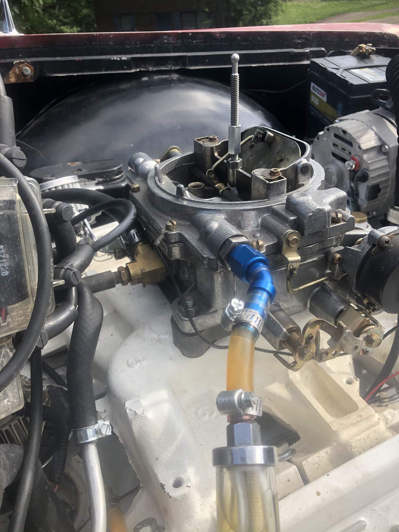

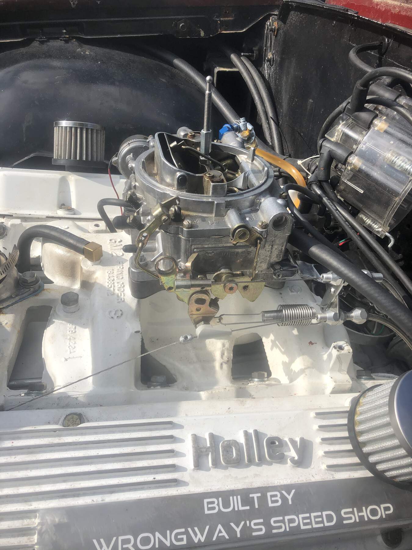

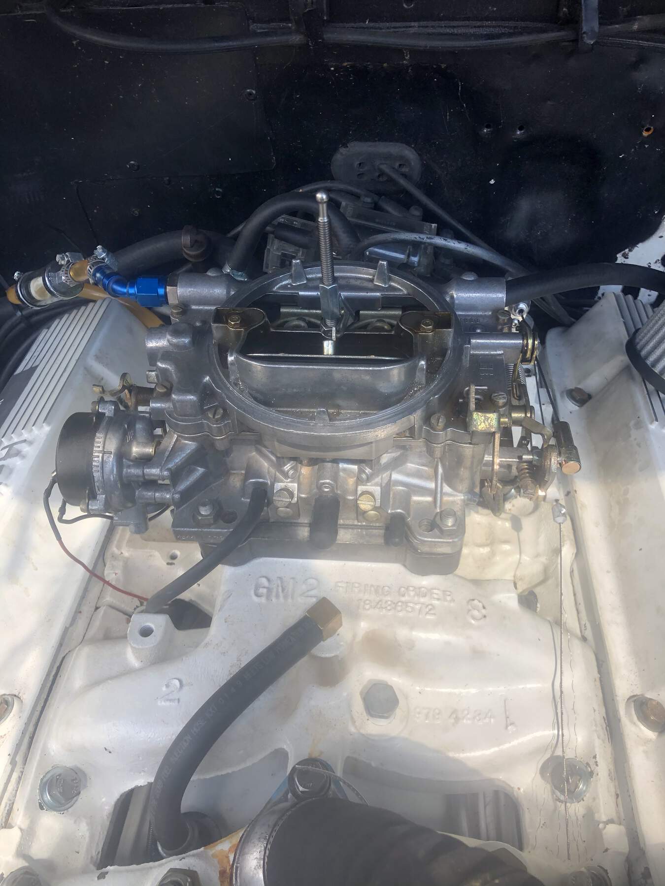

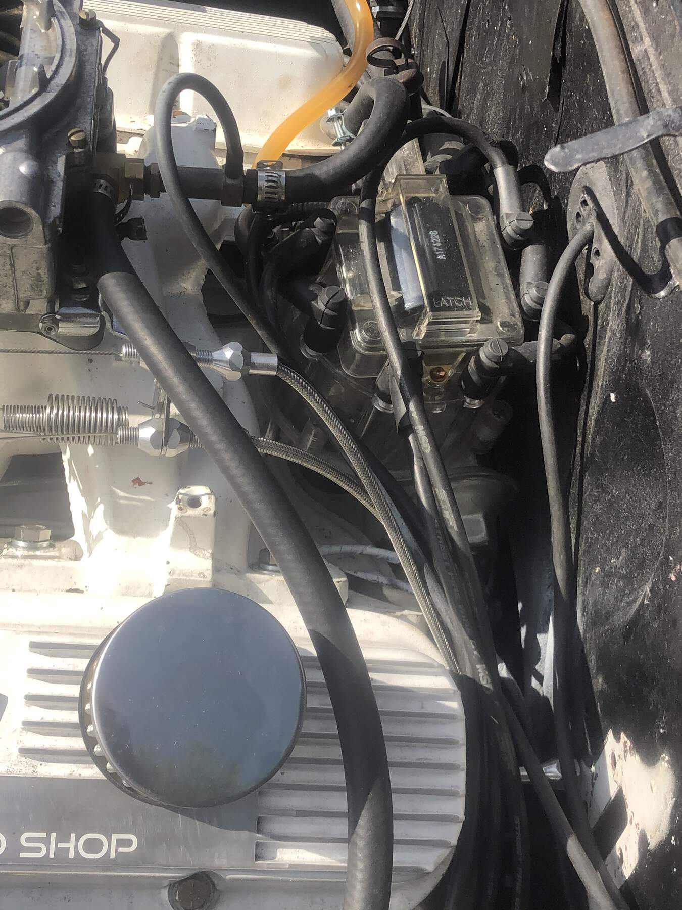

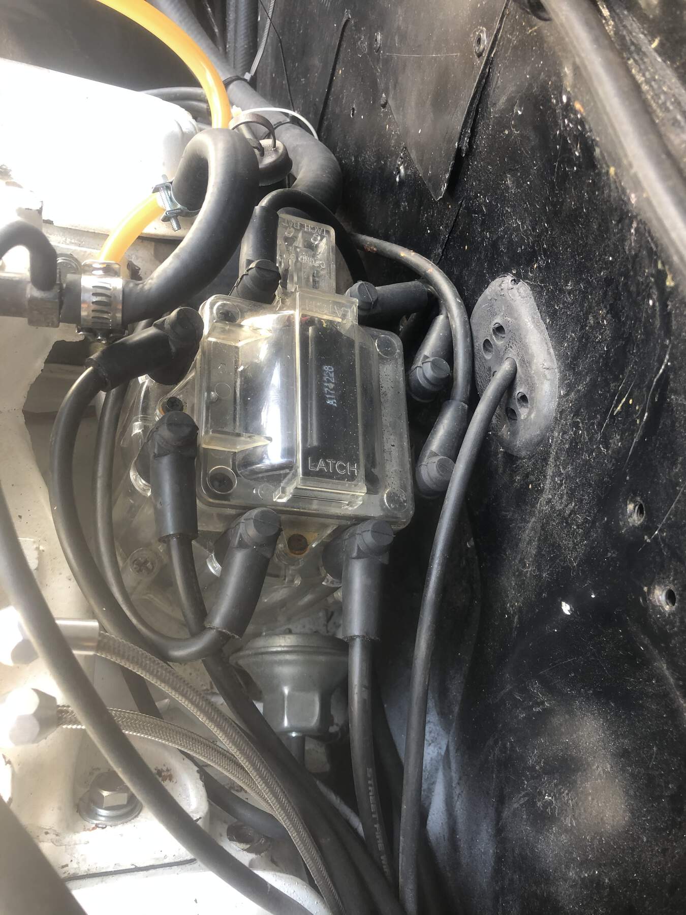

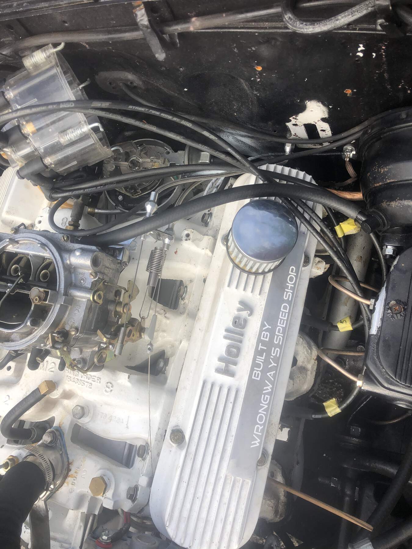

Here’s the carb, intake, vac lines pics
UIn these pics the engine is at TDC my rotor is way off. But could it start and run the way it is??? I’m going to reset that now

No Justa, no open ports on the carb. The carb was rebuilt last year but I've been wondering if its just "worn out". If that's possible. I turned the idle screw today an 1/8th of a turn with no drop in RPMs. Another 1/8th of a turn dropped 400 RPMs. Then when you shut it off and restart it the RPMs are a couple hundred different, like 1000 at shut off and 750- 800 at restart, and yes I let it run a few minuets between adjustments for the engine to catch up to what I did lol.

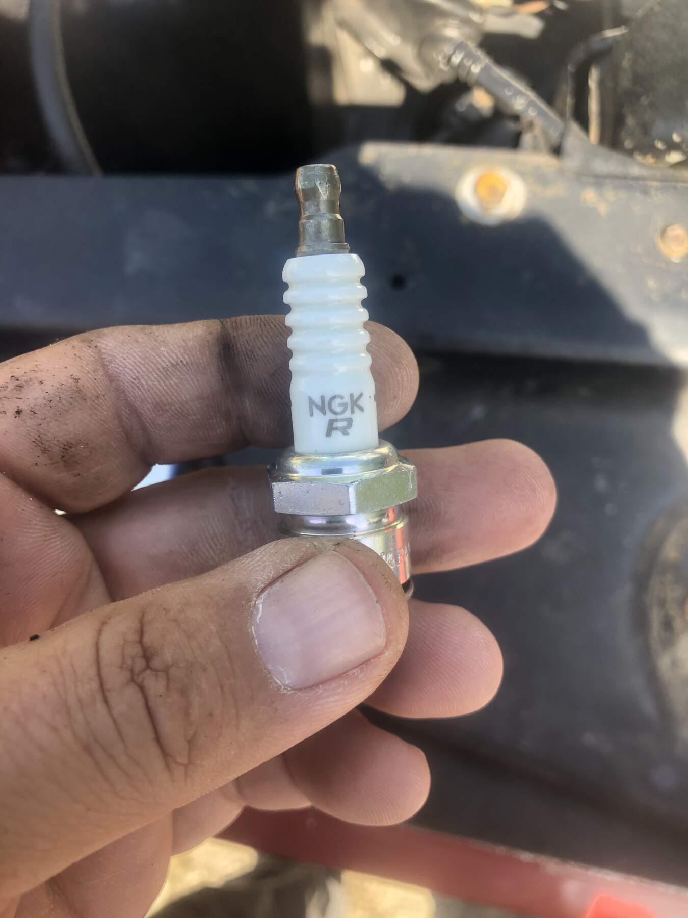

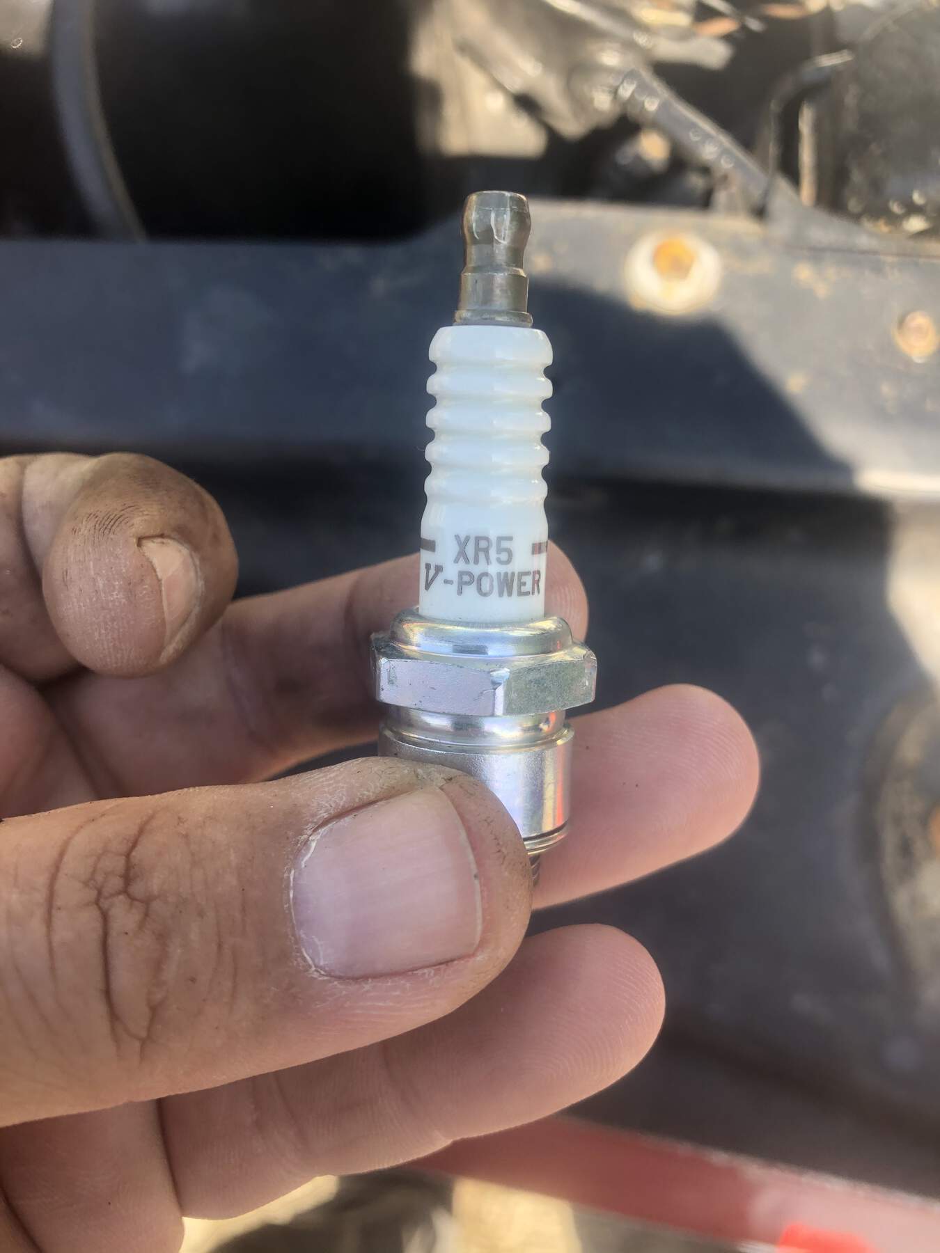

Nobody has mentioned plugs yet.  Couldn't hurt to pop em out, clean em up and make sure each one is firing before dropping them back in. This would check each plug wire for ya as Bear suggested he may have heard a ticking noise. Vacume leak seems by far the biggest prob to figure out.
Yes sir you are correct and she’s got new plugs and wires but I will spark test each one and get back to you.

One thing strikes me though, at this point we’re still at either fuel, spark or vac! So based on that, two of the three interface more so, fuel & vac! You say idle is the issue more so the upper rpm revs!? So try this get the engine warm, then while idling squirt some fuel down the front two barrels see if it smooth out, bogs down or what! Then if it bogs slowly manually at the carb crack the back throttle plates.
If either of those cause an improvement you need to go through the carb and mak sure you have manifold vacuum, where needed is manifold vacuum & Venturi vacuum, where needed is Venturi vacuum.

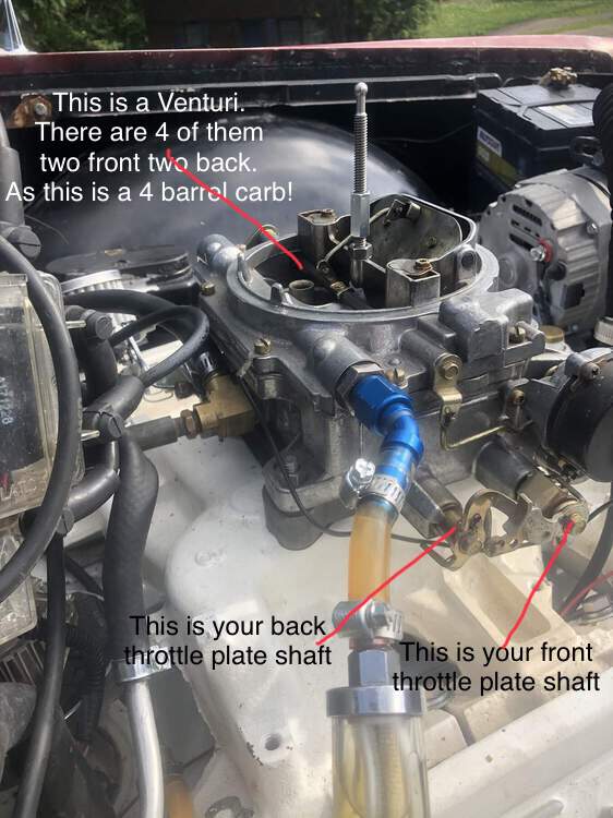

Hey bud, I have no Throttle plate at the back of the carb that I know of and which ports are Venturi vacuum? Also, I’m running a 1 wire HEI distributor of that matters.
Ok, I’m starting to think more and more it’s the carb!

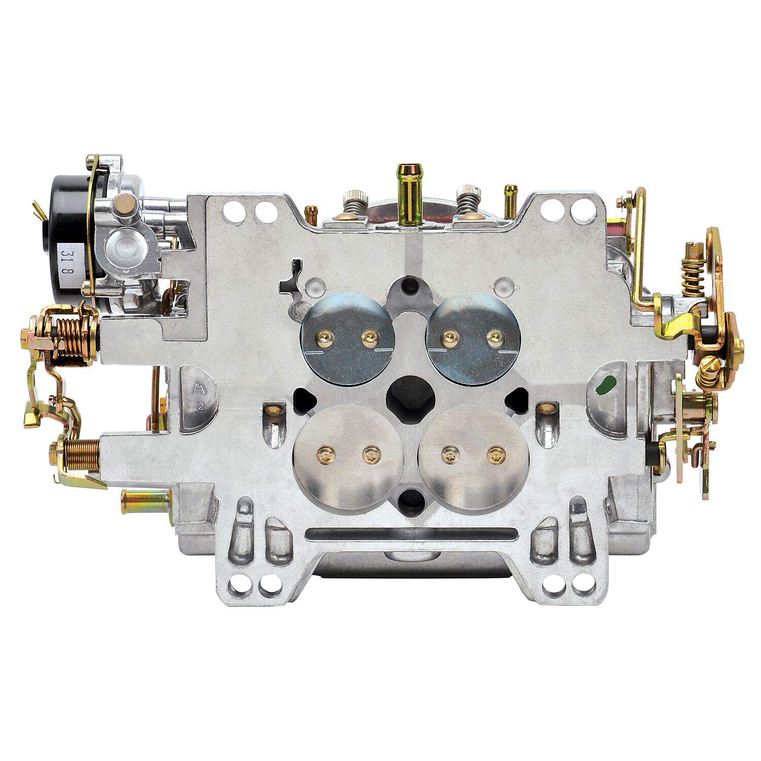

A 4 barrel carb has two front ventures and two back ventures. The back throttle plates have to be adjusted correctly or the car won’t idle right! It can also effect performance when you punch it.
venturi vac increases as the throttle increases while manifold vac decreases when throttle increases! They are use for different functions. For both the motor as well as the car!

I’m not sure you got it, but on your old carb, on the passenger side of it, at the bottom is where the two, front and rear throttle shafts are.

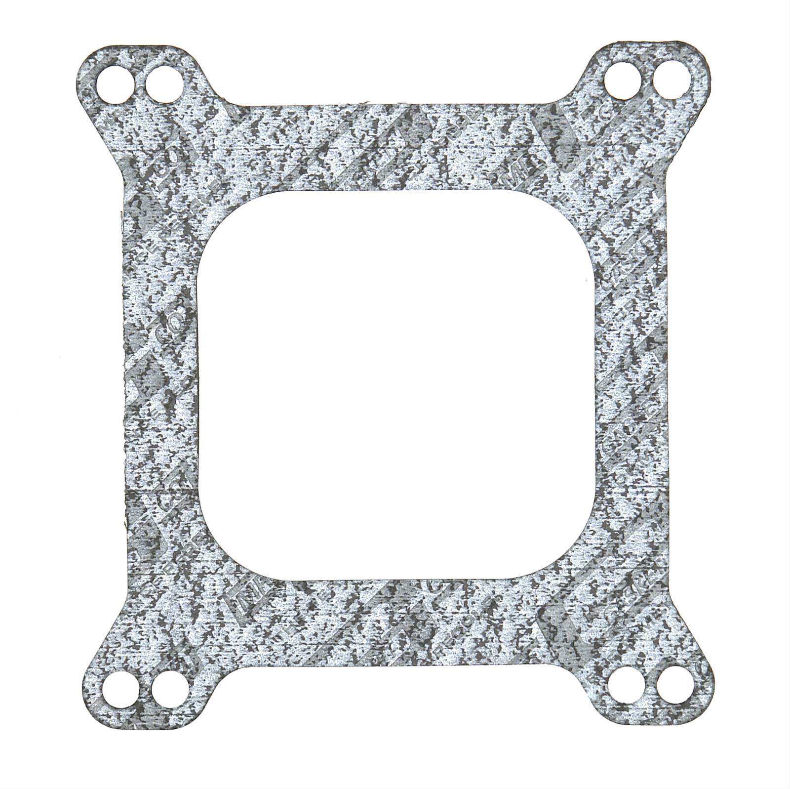

still the bigger question is this! Since you are buying a new carb, you need to make sure you get the correct carb to manifold gasket! The wrong gasket will give you nightmares. The manifold you are running is stock right? If so it’s a duel plane manifold! Are you sure that carb is good with a duel plane? Duel planes work best with a divided gasket and the right bottom porting placement in the gasket to matchup with the carb to manifold. Yes you can do mods to basically do away with the duel plane function, but those need to than match a new type gasket! Just make sure it all goes with each other!

Ok, that's a spreadbore carb - similar arrangement to the QJet, so you're running the correct manifold.   I still think I'm hearing a ticking sound, so if it's not spark jumping somewhere my next suspicion would be a loose adjustment on a lifter.  We know you've got aftermarket stuff and adjustable poly-lock nuts from a previous exchange.  When you first adjusted them all, how did you do it?  What sequence and how did you verify each lifter was on the cam base circle (all the way closed) when adjusting?

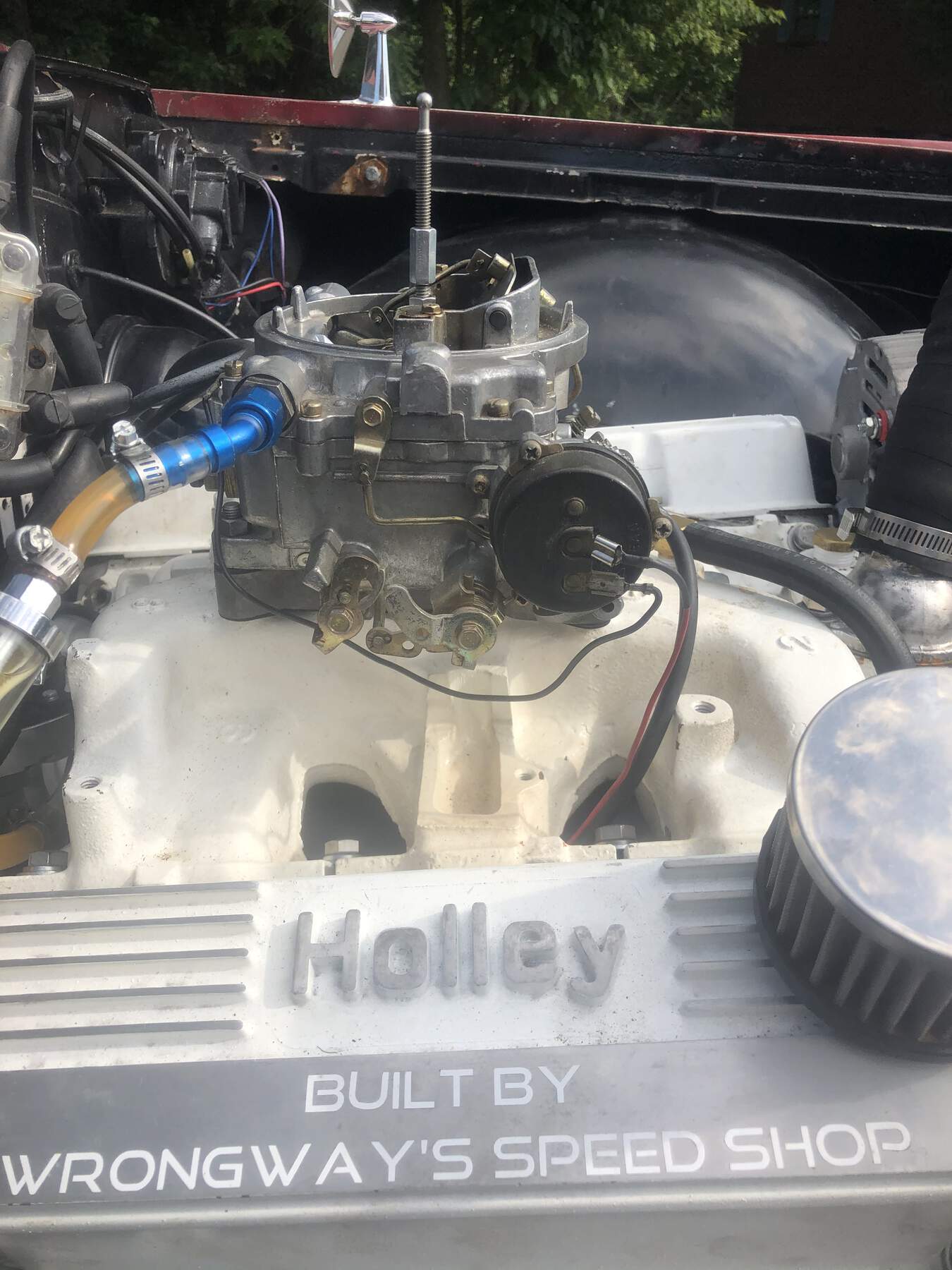

Yes the OEM duel plane is a great manifold! It’s what I would have used! And yes the carb you show is a spread bore as Bear said, but it’s not quite as simple as that!
You pick a manifold for a specific set of engine perimeters and than a carb to enhance those! In that process you may want too take some advantage of some specific power band area because of gearing, transmission, etc. all of those things will influence what gasket and or spacer you use! These are choices you need to make, but if you pick this or that, mix and match so to speak this can cause you some real headaches later on! So I would just encourage you to step through this logically and not in a hurry! So when you’re done; you’re done!
And FYI, those butterfly things are throttle plates! And that’s what I was speaking of before. The back ones need set a specific way! Even from the factory they are not always set correctly for a specific setup!
