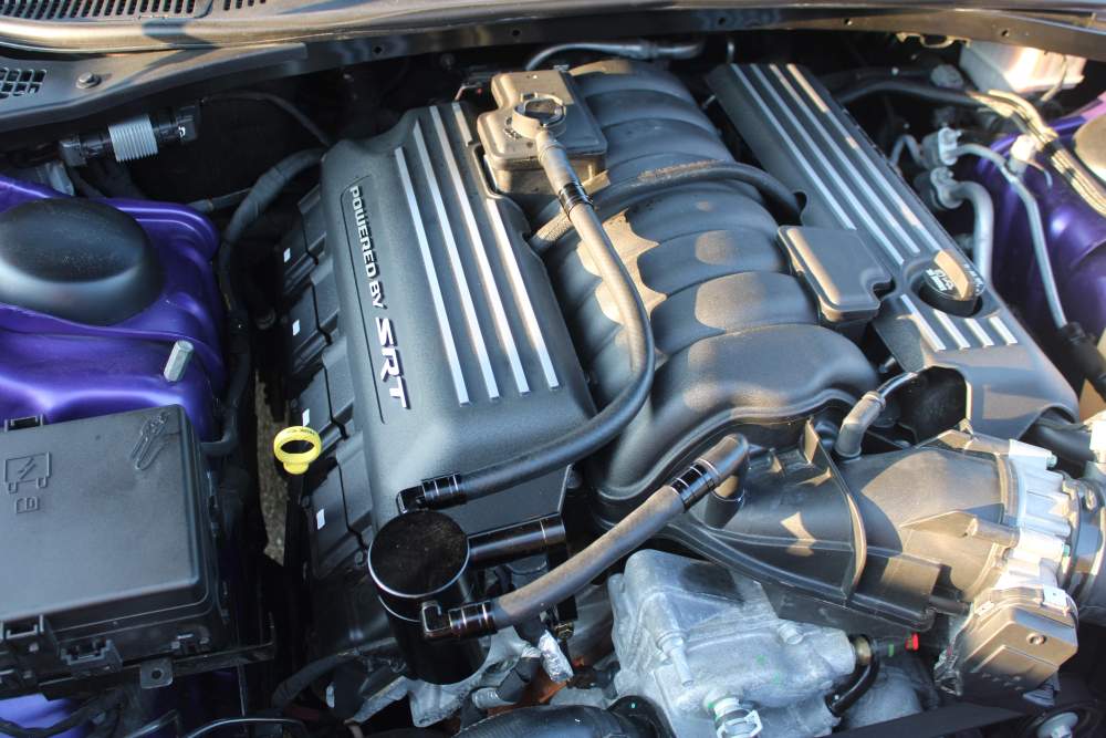

This happened a couple of weeks ago but it took me that long to find time to upload the photos from my Canon DSLR.

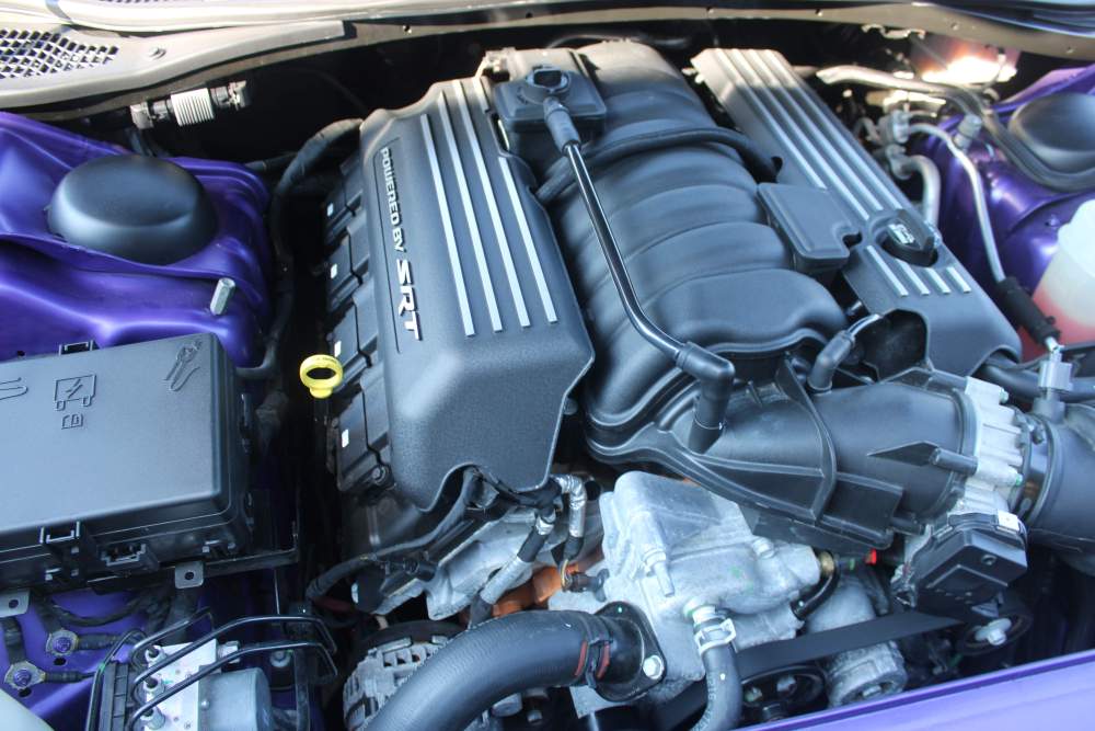

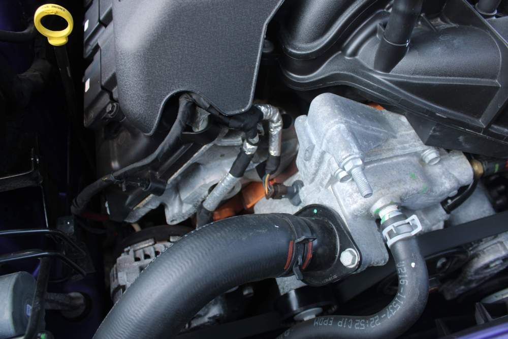

I am installing my new Motoraid 180 degree thermostat and oil catch can. Here is what I am starting with. The thermostat is right there and the bolt that will hold the catch can is actually being used (at the moment) to hold part of the wiring harness.

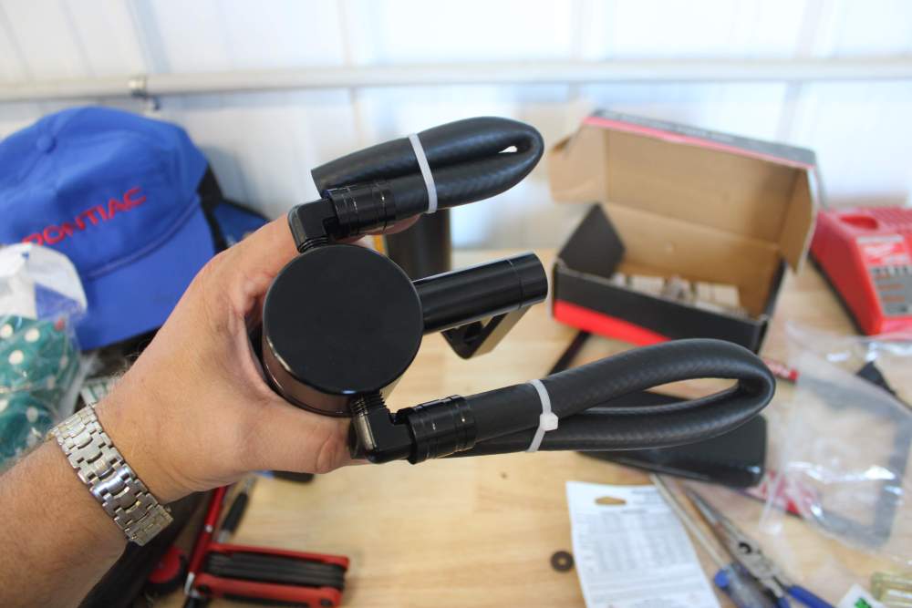

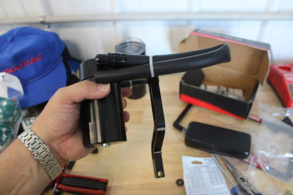

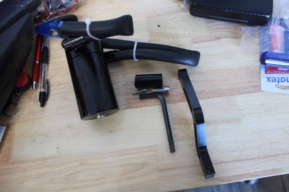

Here is the oil catch can - some assembly required.IMG_1255.thumb.JPG.38fee65991549783bcc2df3ef8a21b41.JPG
Notice the two screws.....the small threaded screw holds the can to the extension above the screws. I used Loctite on that thread. Then the large screw holds the Z-shaped bracket to the extension. Again I used Loctite.

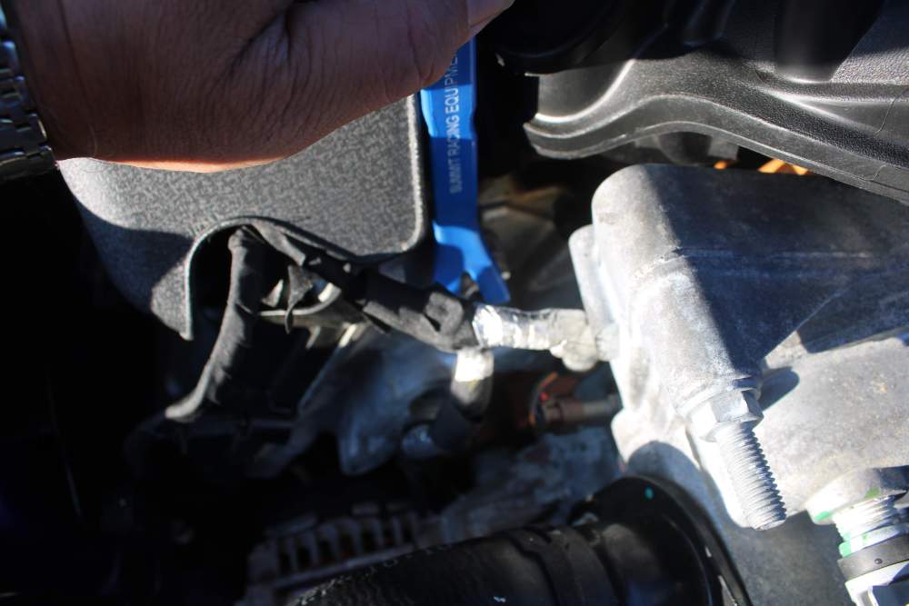

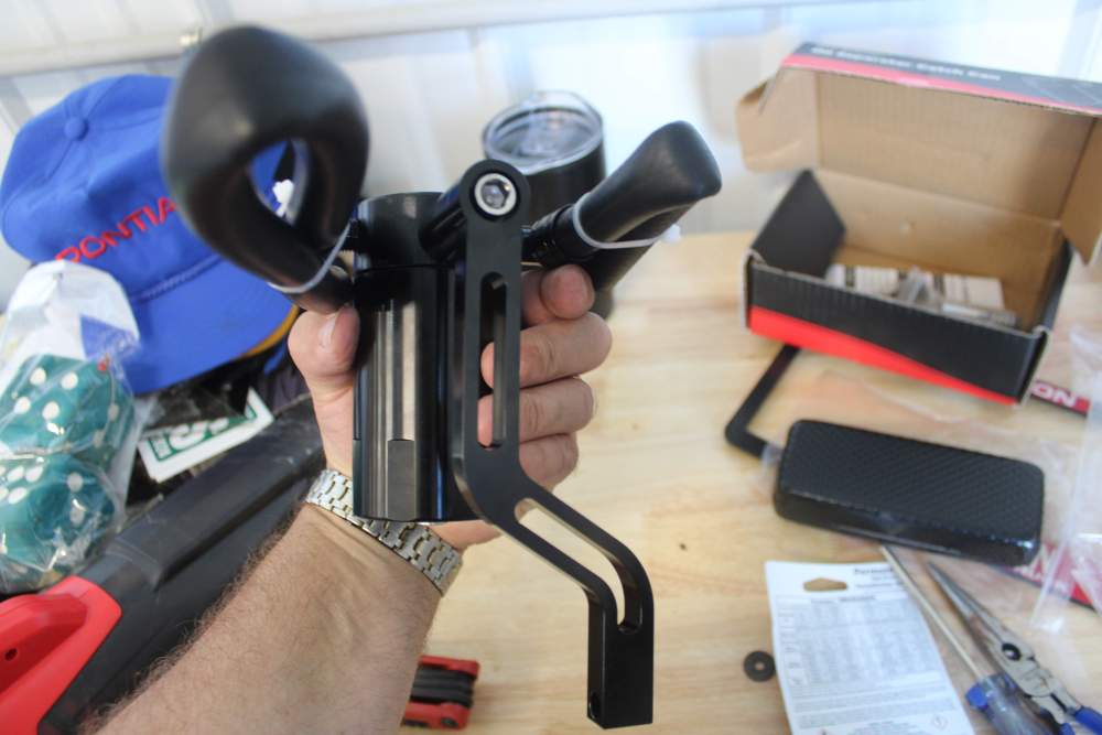

Used an interior trim removal tool to get the wiring harness off of the bolt hole used to retain the catch can. The bolt was included in the kit.

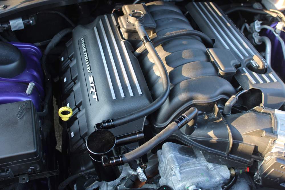

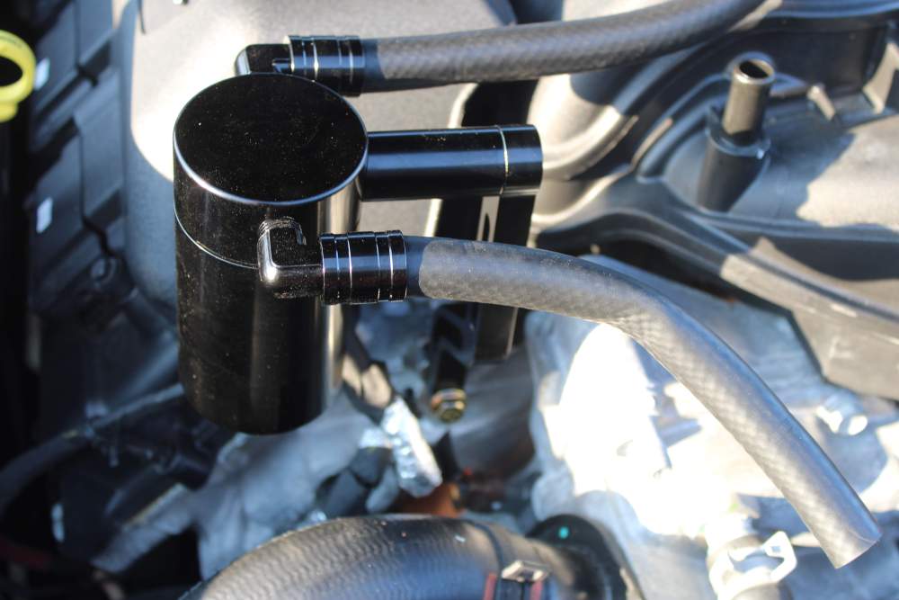

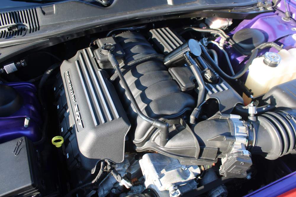

Here is the finished product ready to go in the car. I had to reverse the left and right hoses once I realized that they were on the wrong sides because one hose is longer and the other shorter. The longer hose has to run to the PCV outlet, the smaller one has to run to the intake manifold.
Here is is finally installed. I again used Loc-Tite on the bolt to the engine. I will get a zip tie to clean up the wiring.

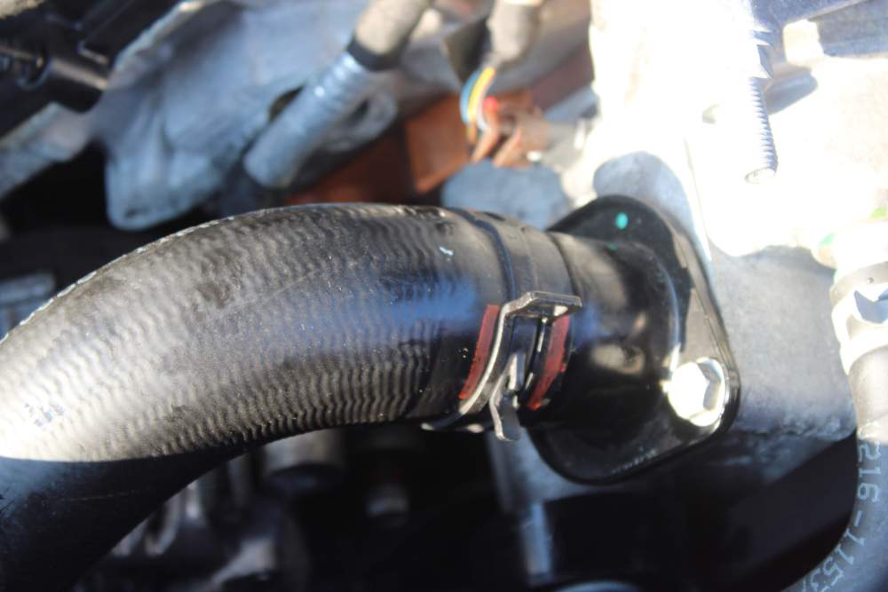

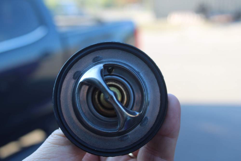

Here is the new 180 degree thermostat. The air hold has to be installed at the 12 o'clock position to allow any trapped  air bubbles to pass through.
A 10mm is all that is needed. 110 in-lbs is the torque spec (yes inch pounds)!

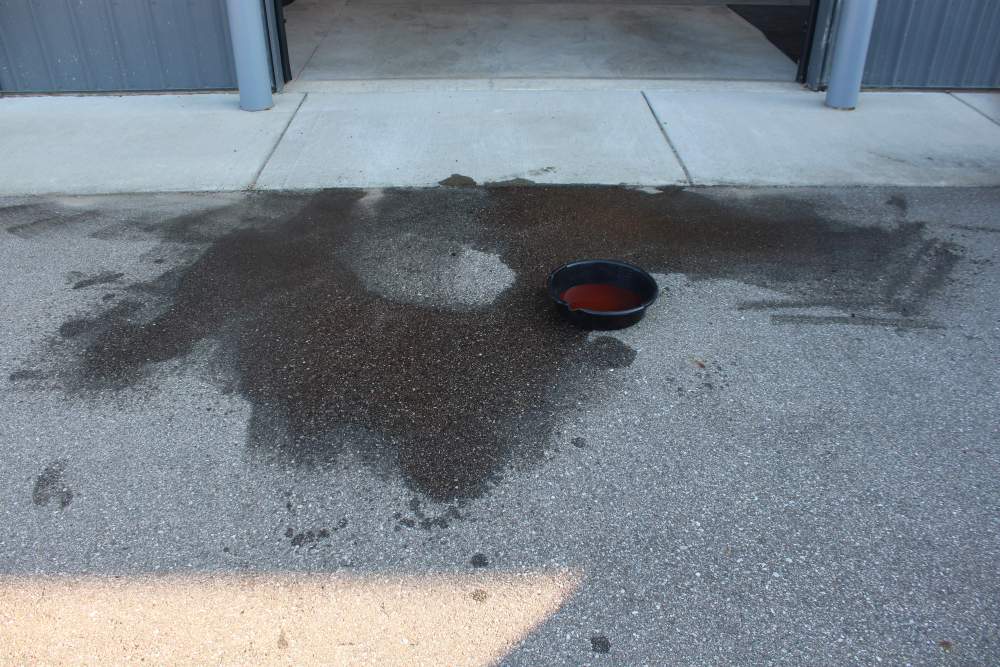

I am not happy with the mess I made with the antifreeze. More came out than I thought. Now I need to top of the anti-freeze. Sheesh.
Job done. What little antifreeze I caught was poured back in. I will need to buy some more to top it off. IMG_1267.thumb.JPG.9a76900ce66c091baca1303ee41d39ec.JPGIMG_1268.thumb.JPG.565a006d60222061fe45005c859fa952.JPG
