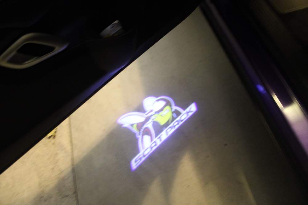

Saturday I had a few minutes to work on Violet. I installed the new "puddle lights" (from China sadly - grrr). It was as simple as popping out the old light, unplugging it, plug in the new one, and push it back into the door. A flat head screwdriver is all you need to pop it out.
Old puddle light - meh.
New puddle light - very cool!

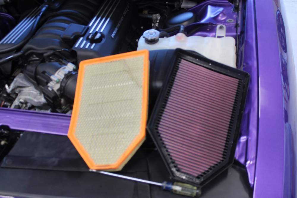

I had to buy some zip ties for the shop. While I was at the parts store, I noticed they had a K&N air filter for the car, in stock and on the shelf. The stock paper filter is still really good but since it was there I grabbed it and installed it. I'm keeping the stock one as a spare.

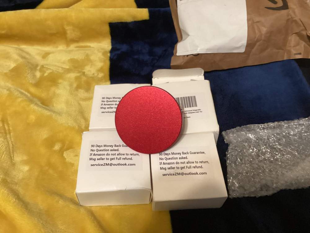

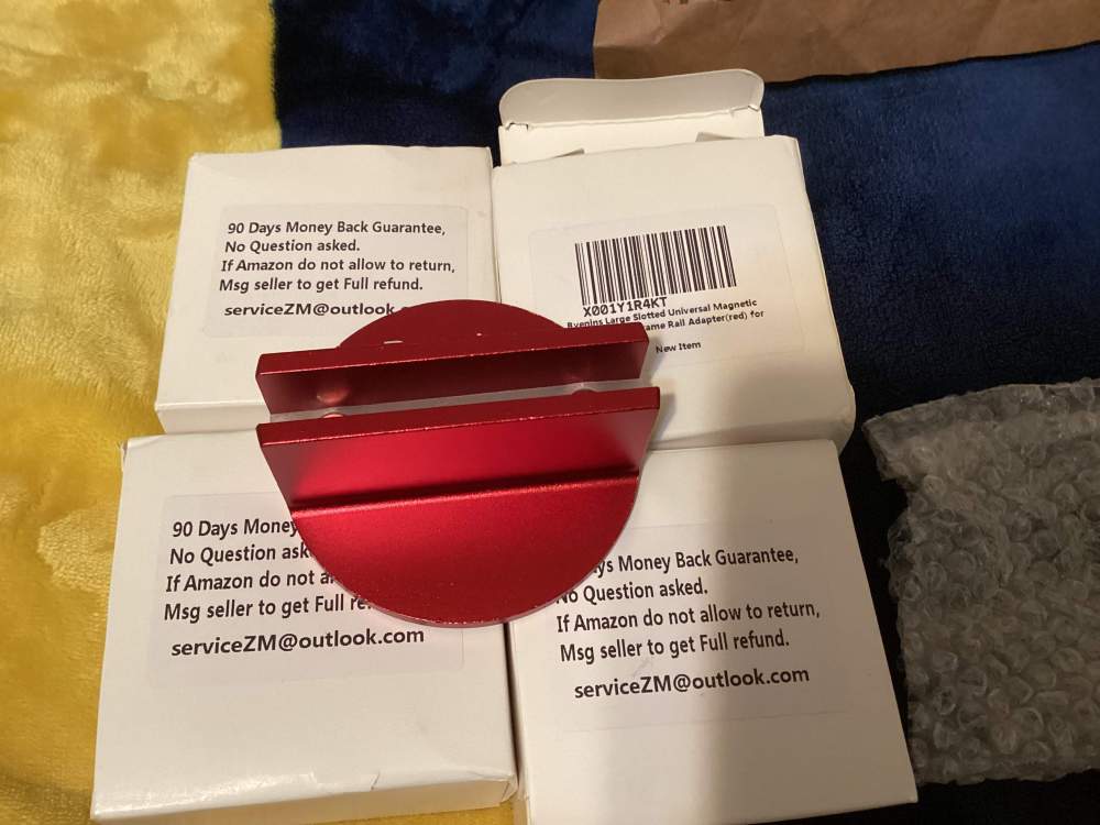

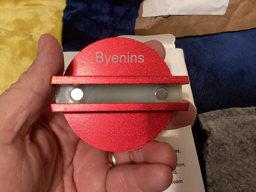

In order to install my skip shift eliminator on Violet, I need to jack the car up to get to the transmission. The jacking instructs point to some indentations in the rocker panel. These are actually pinch welds. I am afraid jacking up there will bend or crush the pinch welds. However, I found a neat little item to help with that. On Amazon, they are called Large Slot Universal Magnetic Jack Pad Weld Frame Rail Adapter. They are $10 each, I bought four of them. This is what they look like.
IMG_0347.thumb.jpeg.7486a7ae7e0b371a010e7f24ae7739e6.jpegIMG_0348.thumb.jpeg.a6a9aadb130ce7c298994dc09c93c9e7.jpegIMG_0349.thumb.jpeg.e7312841af0ebe0515d29b11e79bd7c3.jpeg
Now I can place these over the pinch welds and jack the car up without fear of crushing anything. So, with luck, I’ll have the skip shift eliminator installed by end of this long weekend.

One other thing...The oil on the K&N air filter Can And will damage the the Mass Air flow (MAF) by eventually coating the The sensor wires and the inside of the MAF With the residual filter oil..Causing Premature Failure and Drivability issues for a negligible power gain if any at all...Again Justa my 2 cents..

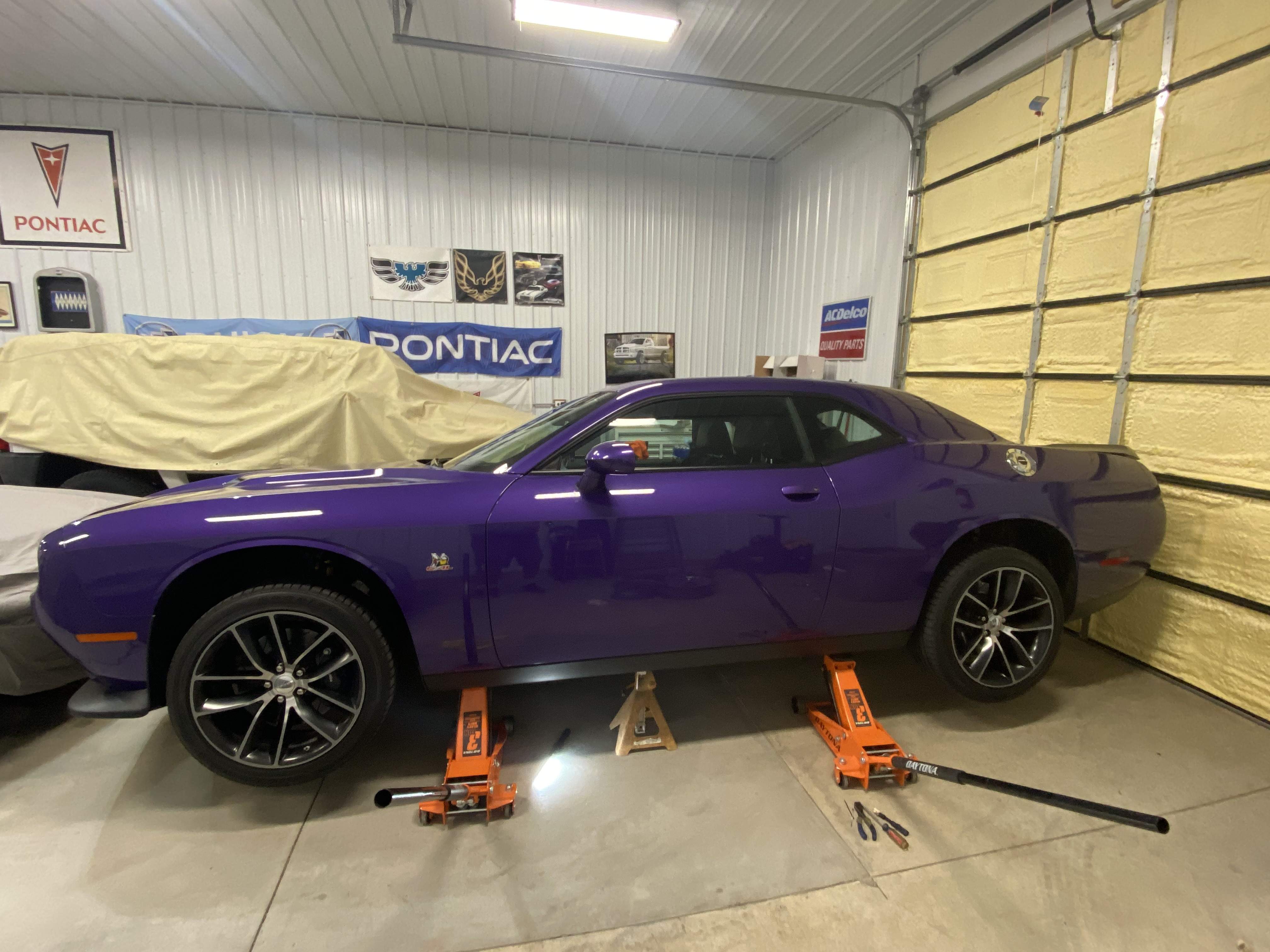

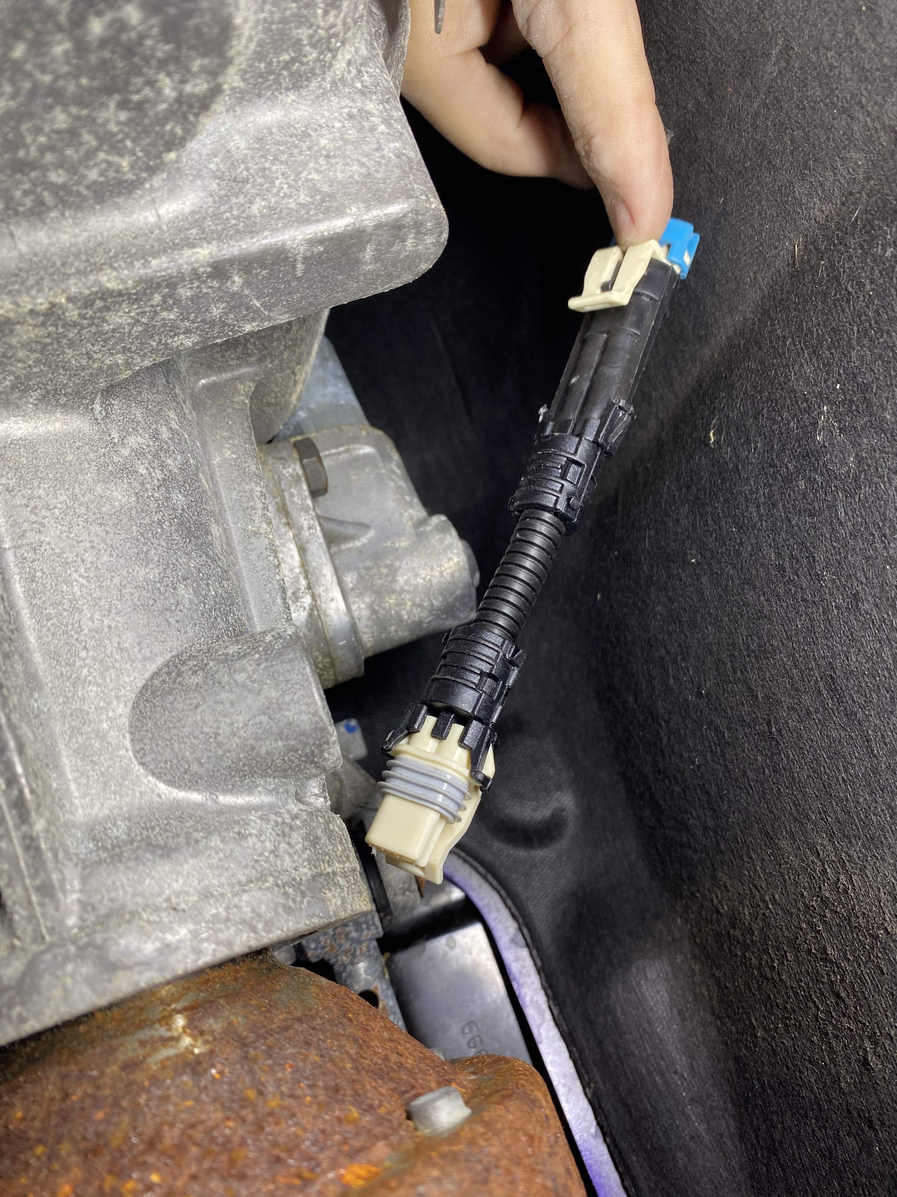

I was finally able to make some time this afternoon to work on Violet. I finally had time to install the new Speedlogix skip shift eliminator. It allows the use of 2nd and 3rd gears, even at high revs and speed in 1st. Without it, at high revs and speed, it will force you to shift from 1st to 4th. The eliminator fools the skip solenoid. A light on the dash still goes off that it is skipping but it really still allows you to shift from 1st, 2nd, and 3rd.
 I jacked the car up using my jacks, i definitely wanted to heed Two Lane's warning. I placed a jack stand at the end of the subframe connector so I had a solid point for safety. Let me say that it was cramped getting my hands up in the transmission tunnel with the jack stand on one side and the jack on the other. I had to crawl between the front jack and the jack stand to install the eliminator.

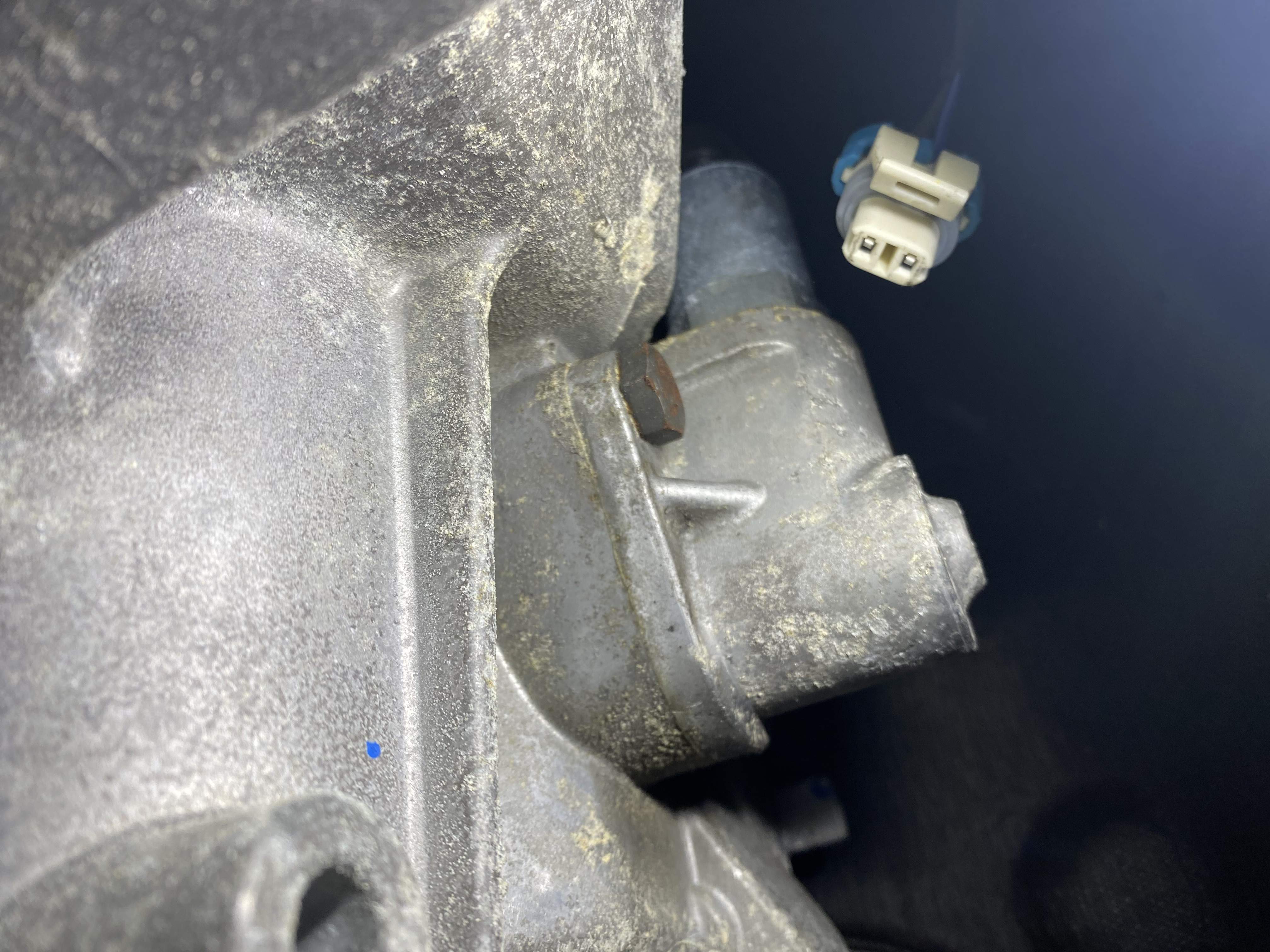

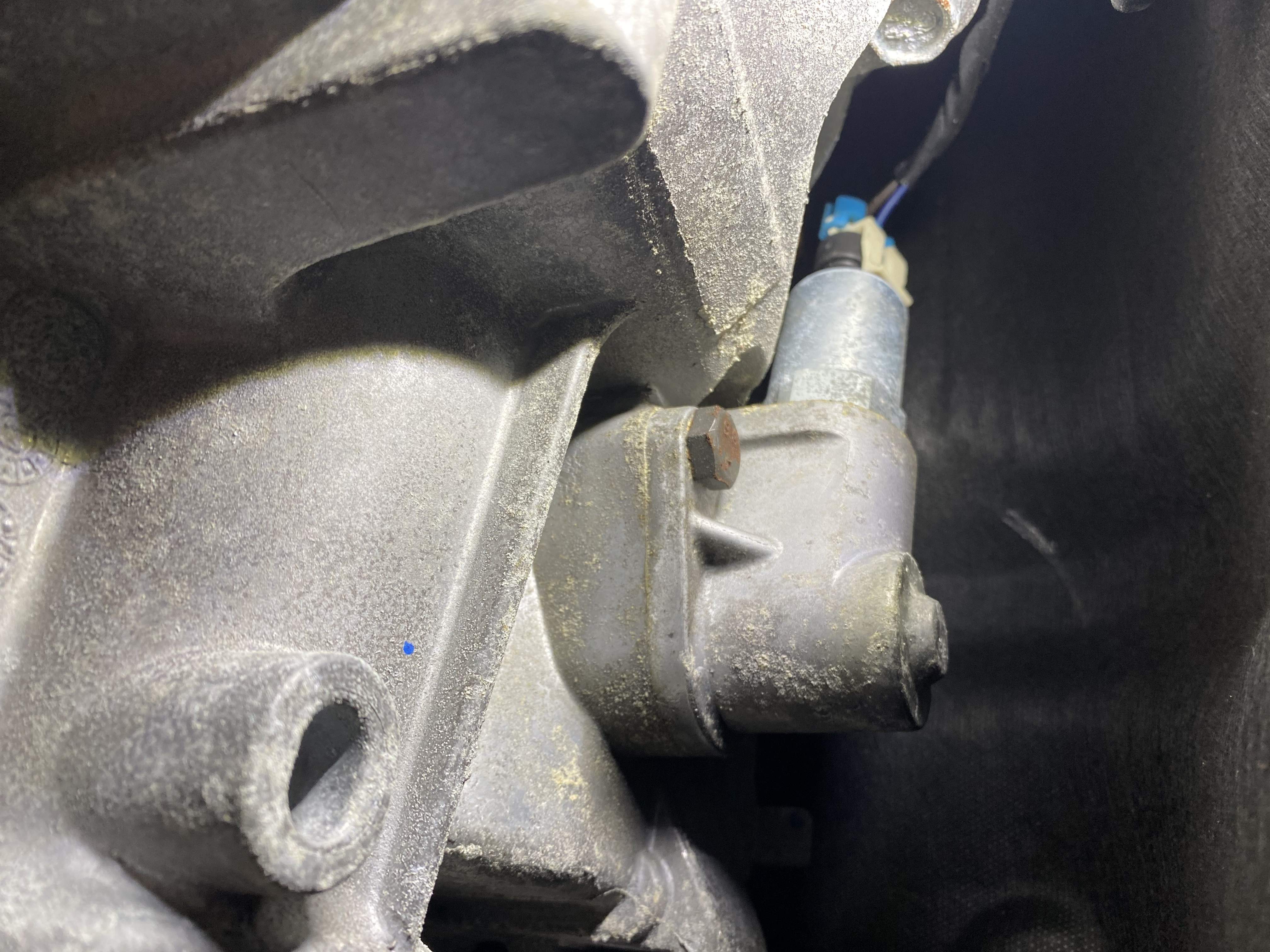

A simple long flat blade screwdriver will let you unplug the skip shift solenoid on the transmission.
That was easy. Now the tough job. Plugging in the new skip shift eliminator. This job is easier on a hoist. Not so much lying on your back trying to get one or both of your hands in there at awkward - almost impossible - angles.
The job is half over. Now the real trick of plugging it back into the solenoid. Ugh. That was the toughest part.
Once I got the damn thing plugged in, I took it down off the jacks and jack stand and went for a small test drive. It works! I revved the thing to the moon, almost 4500 rpm in first and shifted cleanly into 2nd and then 3rd, repeatedly! So that is something else off my to do list for Violet.

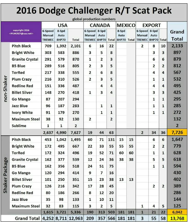

I just found out some interesting piece of trivia. It would appear that of 13,768 R/T Scat Packs built in 2016, that Violet is one of 216 (US production, non-shaker hood package, Plum Crazy with a six-speed manual) or one of 342 (total US production Scat Packs in Plum Crazy and a six-speed), or one of 532 Non-shaker Scat Packs. That's cool....

I will cut and paste the table once i get back to my PC Kiwi.

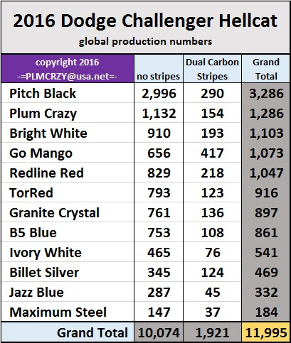

1,286 Plum Crazy Hellcats were made in 2016, 154 with stripes, 1132 without stripes. No breakdown for export, transmission, or possible right hand drive. 11,995 total Heelcats were produced in 2016. Plum Crazy was the second most popular color for Hellcats behind Pitch Black. Black was almost three to one to Plum Crazy.

Here you go Kiwi.
