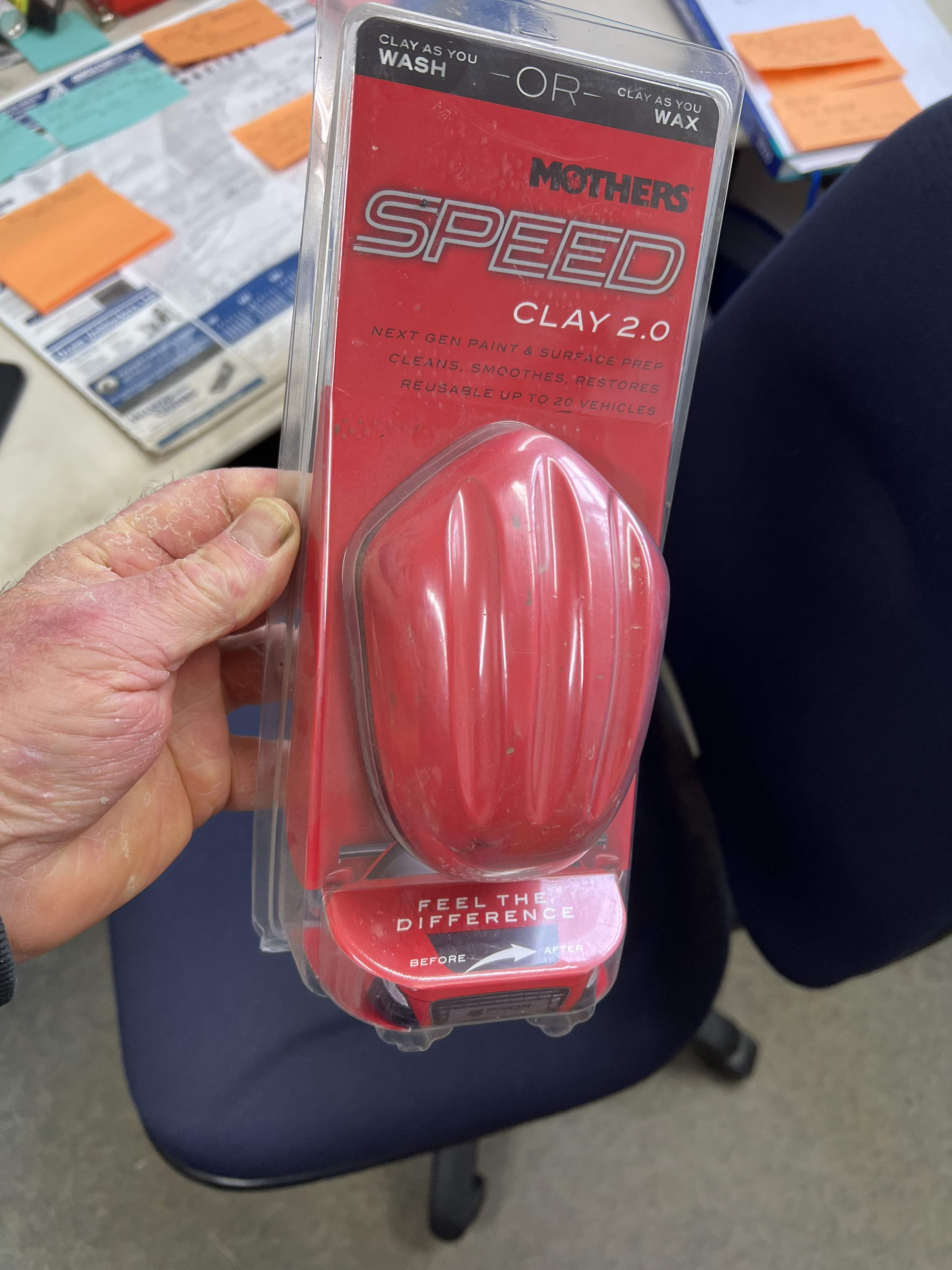

I was talking to the guys at 303 while I was on Power Tour. You need to keep these synthetic clay bar buffs or mitts wet and lubricated! Yes I know how this sounds! Kiwi, you have a dirty mind! I respect that! rofl
Seriously though, that is the key. I used it like a regular car wash sponge with some gentle scrubbing motions. If you let it dry out, it drags as you would expect.
I so agree frosty ! Lube is key !!! rofl
Back when I first discovered the synthetic clay bar it was like night and day compared to the stupid old clay ! You couldn’t buy them in here in nz so I grabbed 2 of these mothers ones when I was in Hawaii at an auto store and I find it easiest to use them while I wash the car . The wet surface works great !

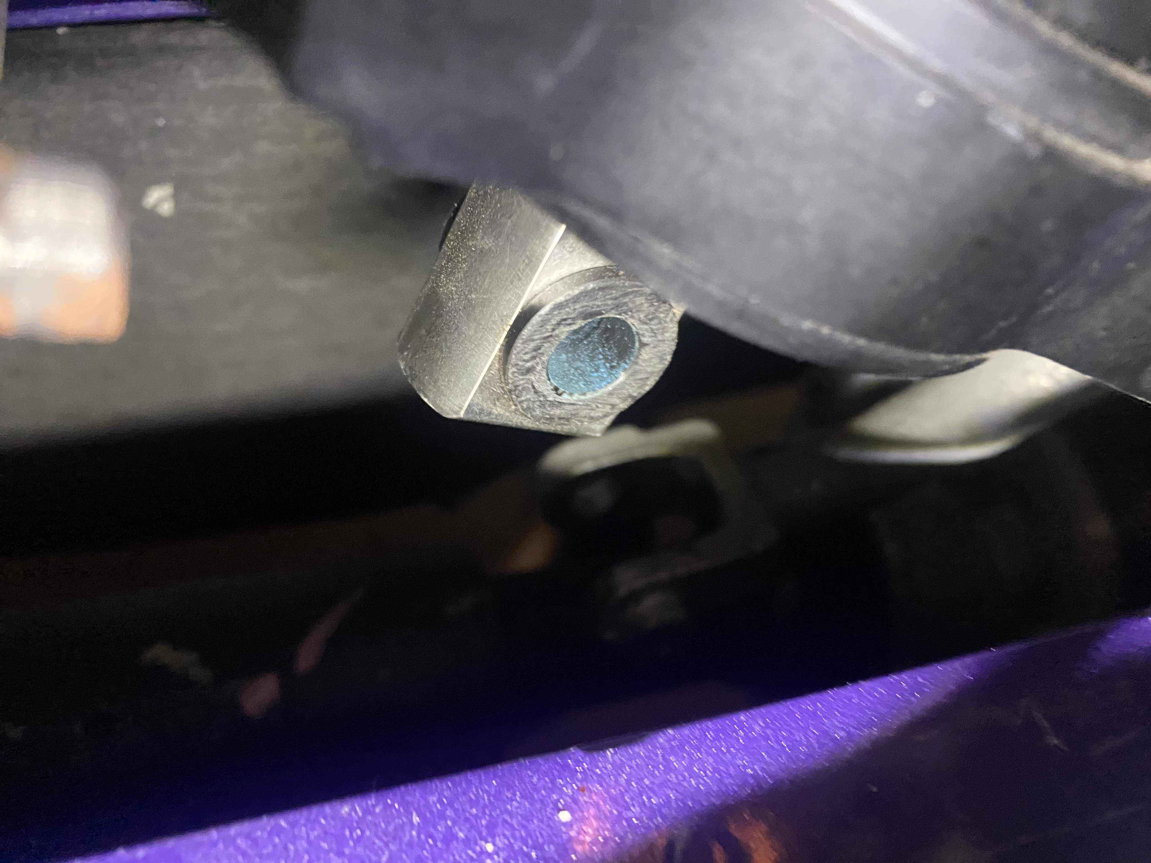

I get to the garsge mahal, jumped in Violet and I take off towards the cruise. I don’t get a 1/2 mile down the road and all of a sudden, i have no shifter!!!!! We are taking no engagement, just a limp stick that doesn’t do anything (watch it Kiwi!rofl) It was stuck in either first or second gear. I managed to get Violet turned around and back to the garage. I went to the cruise in my pickup and watched the cruise go by for over an hour.
After the cruise ended, i yanked out the shifter console. It gets faster the more you do it! I found the problem!
The metric bolt that connects the shifter to the transmission fork is gone! Obviously it backed out. So now i need to run to the hardware store, get a new bolt and some thread locker, and really torque that f’ing thing down.
I am happy that it is a simple fix. It just annoys me with three cars are down at the moment. Ugh!

but theres a reason that bolt walked out ! i see a fork, is it threaded mate ? maybe a longer bolt that goes right through and add a nylock on the other side and a touch of grease to the shank so it doesnt bind with that alumium block ?
you are not going to want to "really torque that f’ing thing down." the fork will crush against the shifter and make it hard to move, i am wondering why this fork doesnt have a pin and retaining clip rather than a bolt ?

The transmission retaining fork that the shifter slides into has a threaded nut welded to it. It's fixed. I agree that I don't want to over torque it, I am just pissed. Still I do need to cinch it down tightly and I was serious about the use of thread locker.

Is there a way or a provision to allow you to use a safety wire through the bolt and tied...So it Can't back out..??
Interesting idea Two Lane.
With the stock bolt, the answer is no. The bolt engages the cast nut with nothing outside the nut. However I had to replace a bolt. It was an 8mm-1.25 course thread about 30mm long. My replacement bolt is 40mm long. Therefore I could drill a small hole at the end safely wire it. I did use thread locker.
I spent nearly three hours getting that bolt back in and then putting the whole damn console back together. I did a test drive and she shifts beautifully. I didn’t make it to the second and final night of the rolling cruise though town sadly. However Violet is fixed and ready for Woodward on Saturday.
