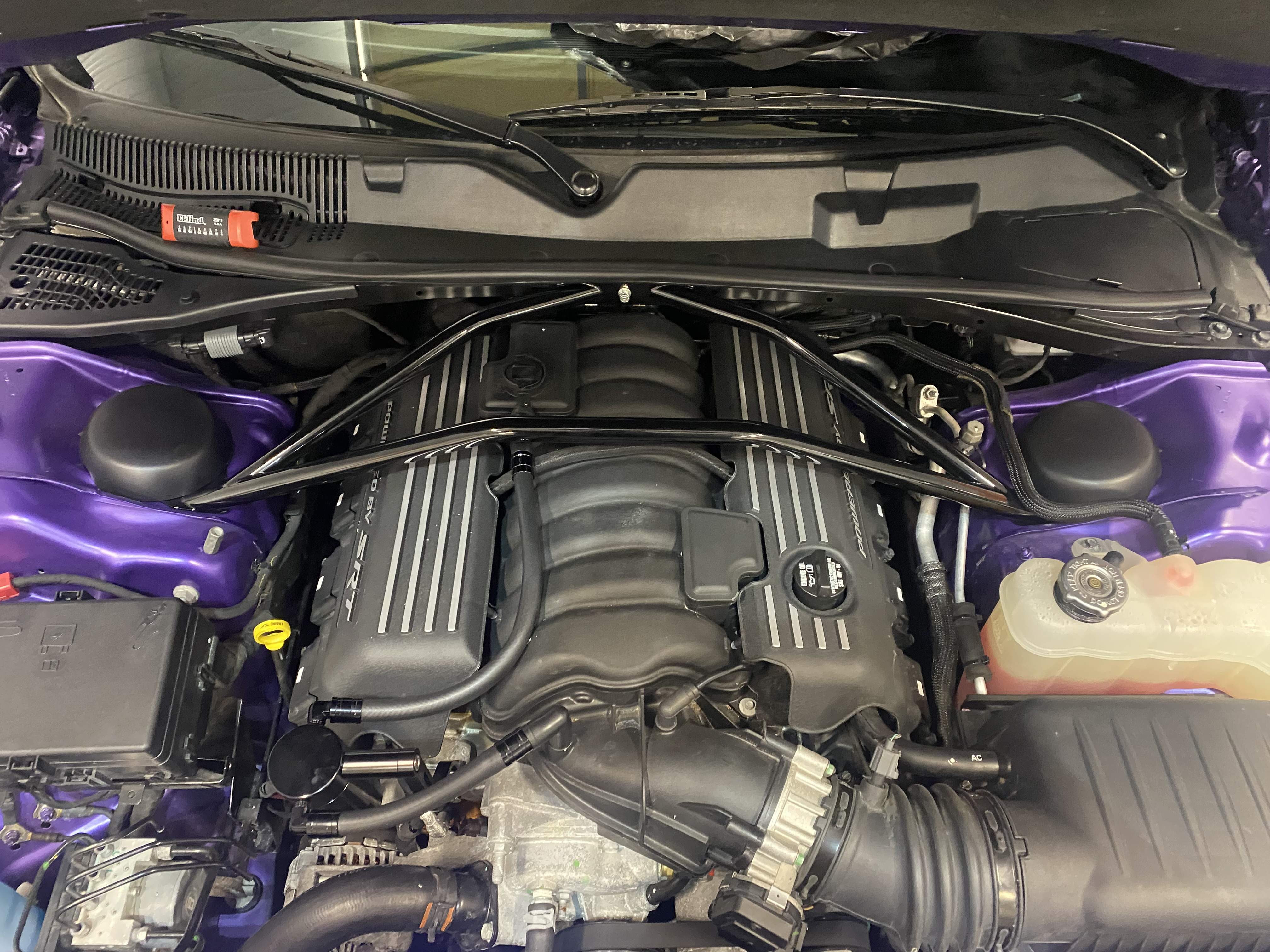

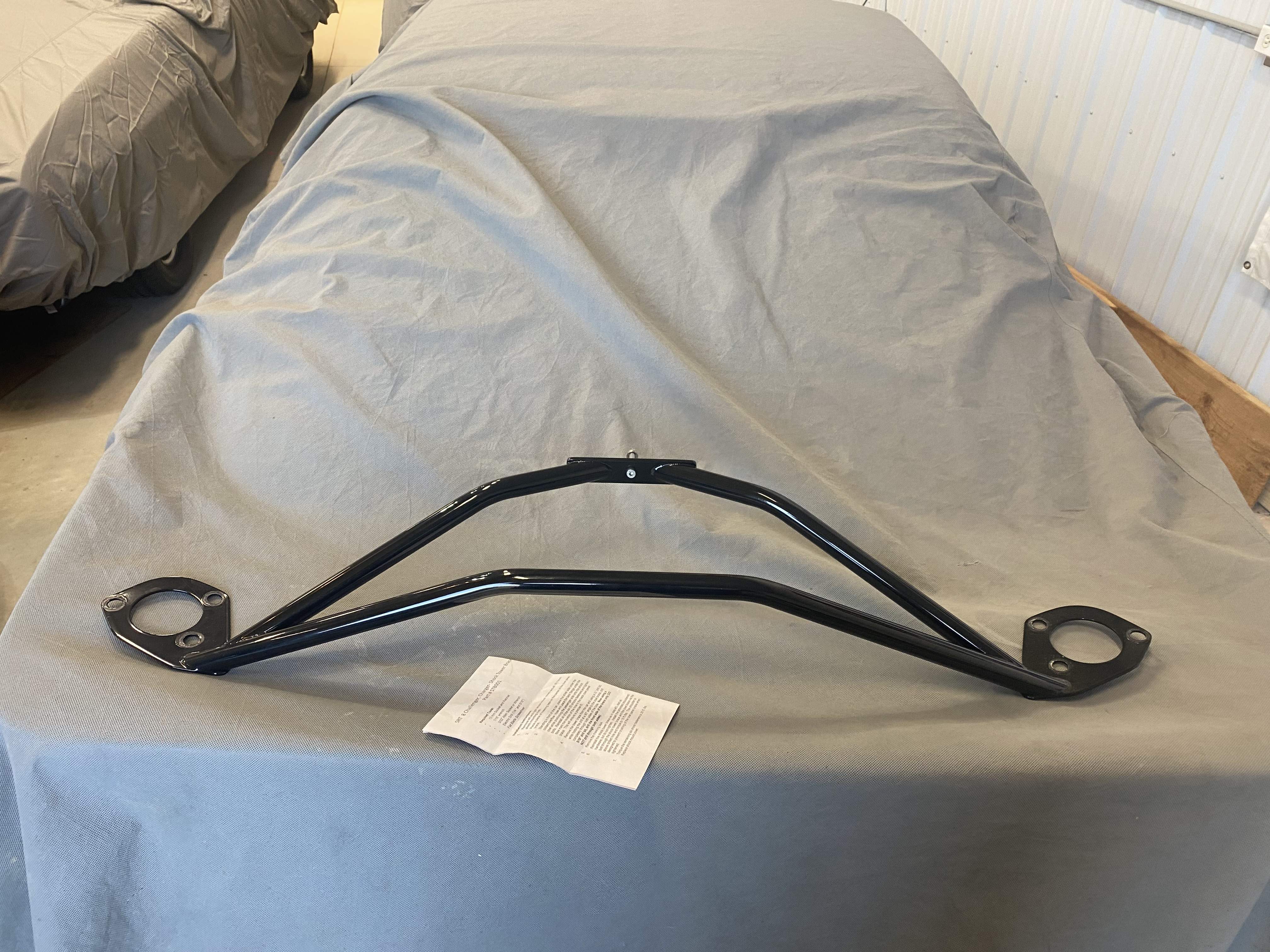

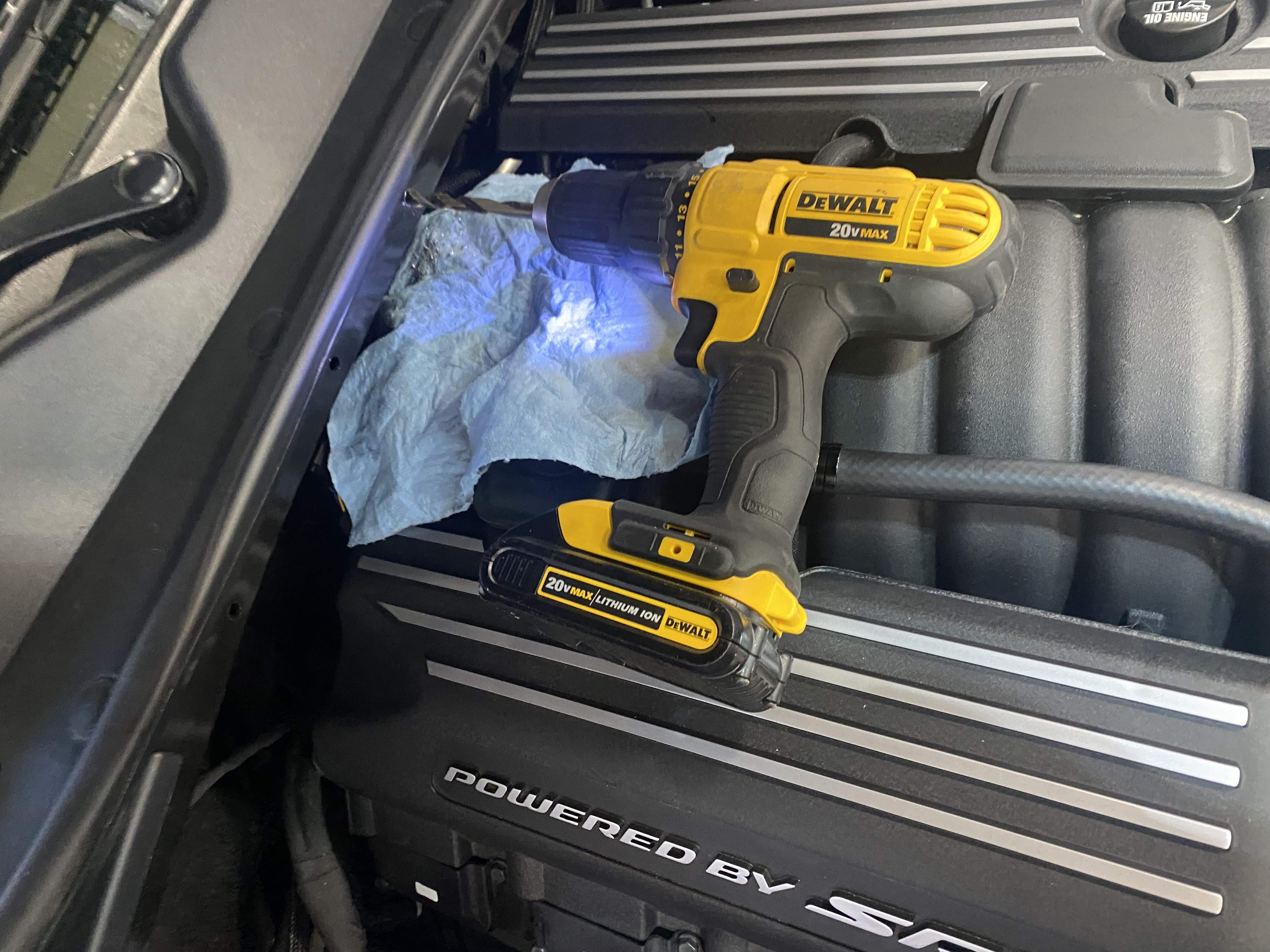

I installed the Petty Garage front strut tower brace tonight. It was easy but it didn’t take me 5 minutes Fitzy. I had to install it, mark an area on the upper support brace, drill a 1/4” and then a 5/16” hole through both sides of the brace and install the through bolt.
IMG_3036.thumb.jpeg.95e5adeae7c76f33b72018c4c0b41688.jpegIMG_3038.thumb.jpeg.5e4bbe6ed3c559fd08b1a870ab58e95a.jpeg
Drilling the through bolt. I torn up my ring finger. Once i got through the brace, my left hand scraped the engine cover and torn my knuckle.
Nuts torqued to 35 ft-lbs. Covers put back on.
i have not test drove the car yet! Hopefully the rains will hold off this weekend long enough to take her out.

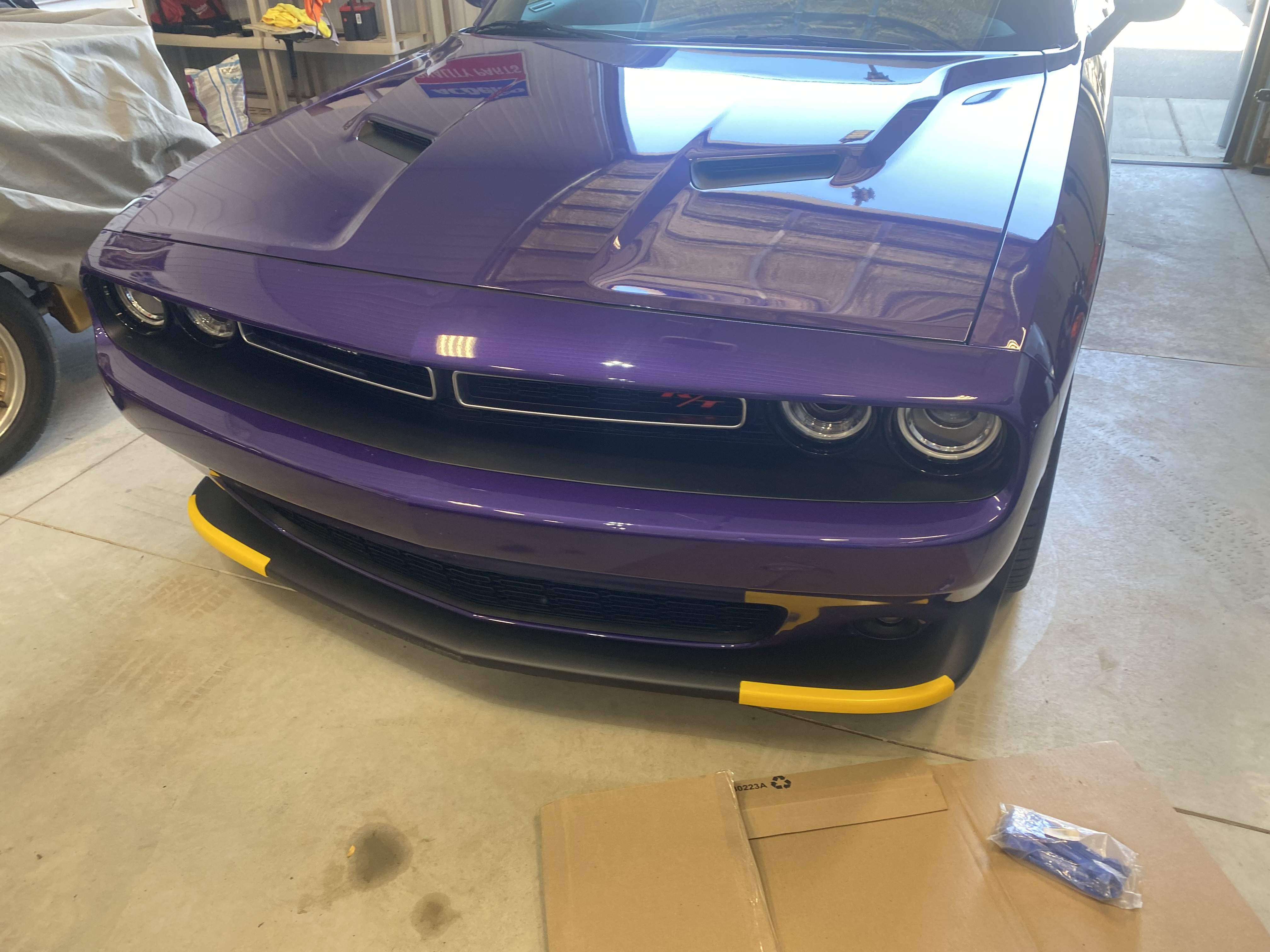

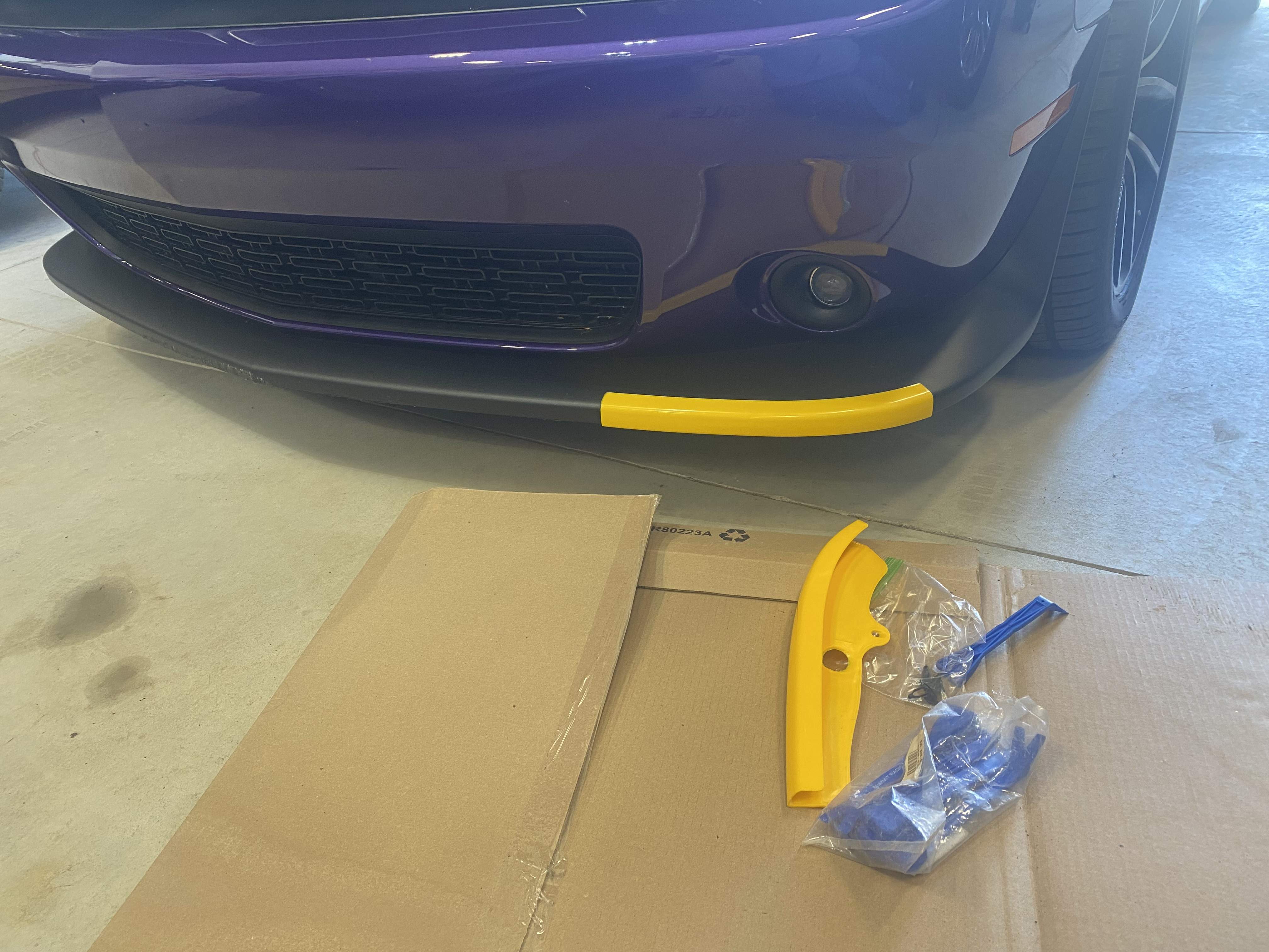

I thought I’d get more done today since the weather finally cooperated. I bought some front splitter guards off of Amazon for $25. This was a five minute job Fitzy! They slip over the splitter and are retained with a single push pin/tab that goes in a pre-existing hole! Easy pezzy!
When I backed Violet out of the garage, I was getting a low tire pressure warning on the LF tire. New tires, only a couple of weeks old? No way!
Turns out I have a bad LR sensor. So I am spending my valuable wrench time sitting in the tire shop to get a new wheel sensor installed and the sensors reset. Ugh!
Believe the guards are factory.  Wifes friend had me remove them after bumping something and it was hangin off her new car with less than 40 miles on it.   If they were mine, I'd paint em black.  Justa me.
I actually like the contrast between the yellow and black.
A lot of Challengers and Chargers you see on the road have a yellow or green stripe all the way around the bottom of their air splitter. They, or the dealer, have failed to remove the shipping guard that is used to protect the splitter while in transit. This can eventually damage the splitter due to it's rigidity and weight. The guards I got are a couple of ounces and are easily removable.
There are also aftermarket guard pieces that go across the splitter that looks like the factory shipping guard but are actually much lighter and more flexible.
no matter what you do its going to get curbed Frosty !
i am as careful as possible and still i have scuffed the bottom of my splittter !
i simply clean it up with a file .
I hear you Kiwi. I get it!

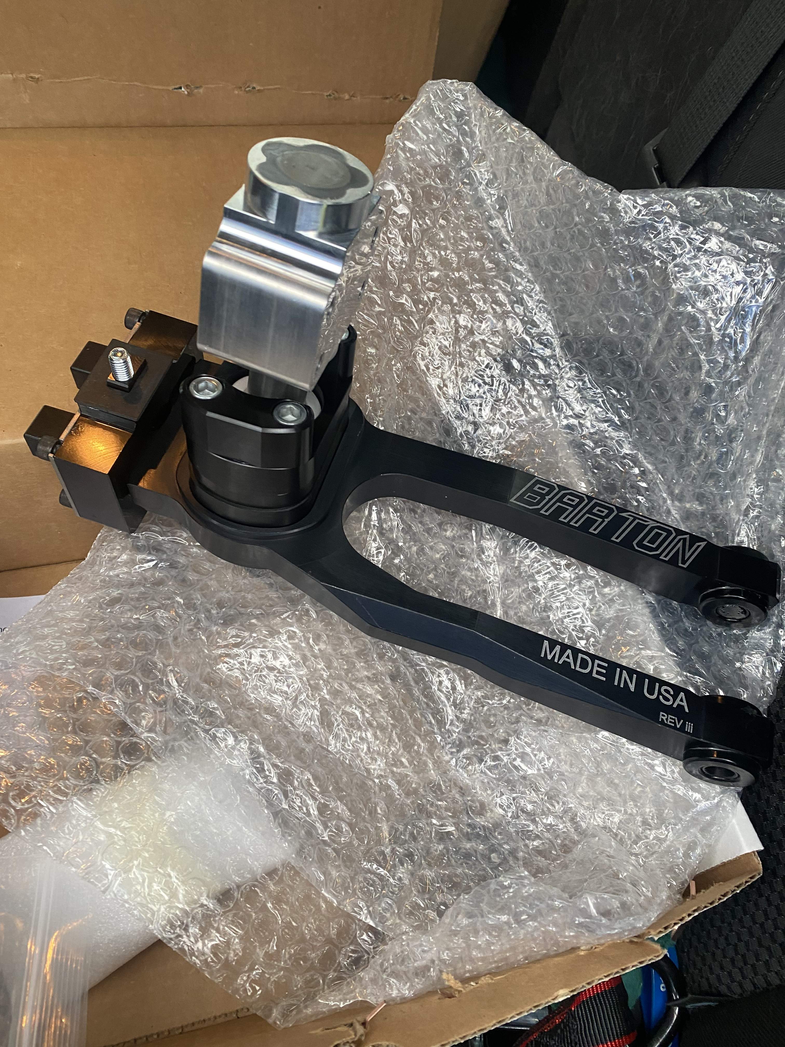

I justa hit send on my order from Summit Racing. I justa ordered a Barton short throw shifter for Violet. I could not find any deals online on Marketplace, eBay, Craigslist, nothing. So I bit the bullet and ordered a new one. So $500 later….I should have it before the weekend. This is the cheapest one I could find and it lets me keep my Hurst pistol grip handle.

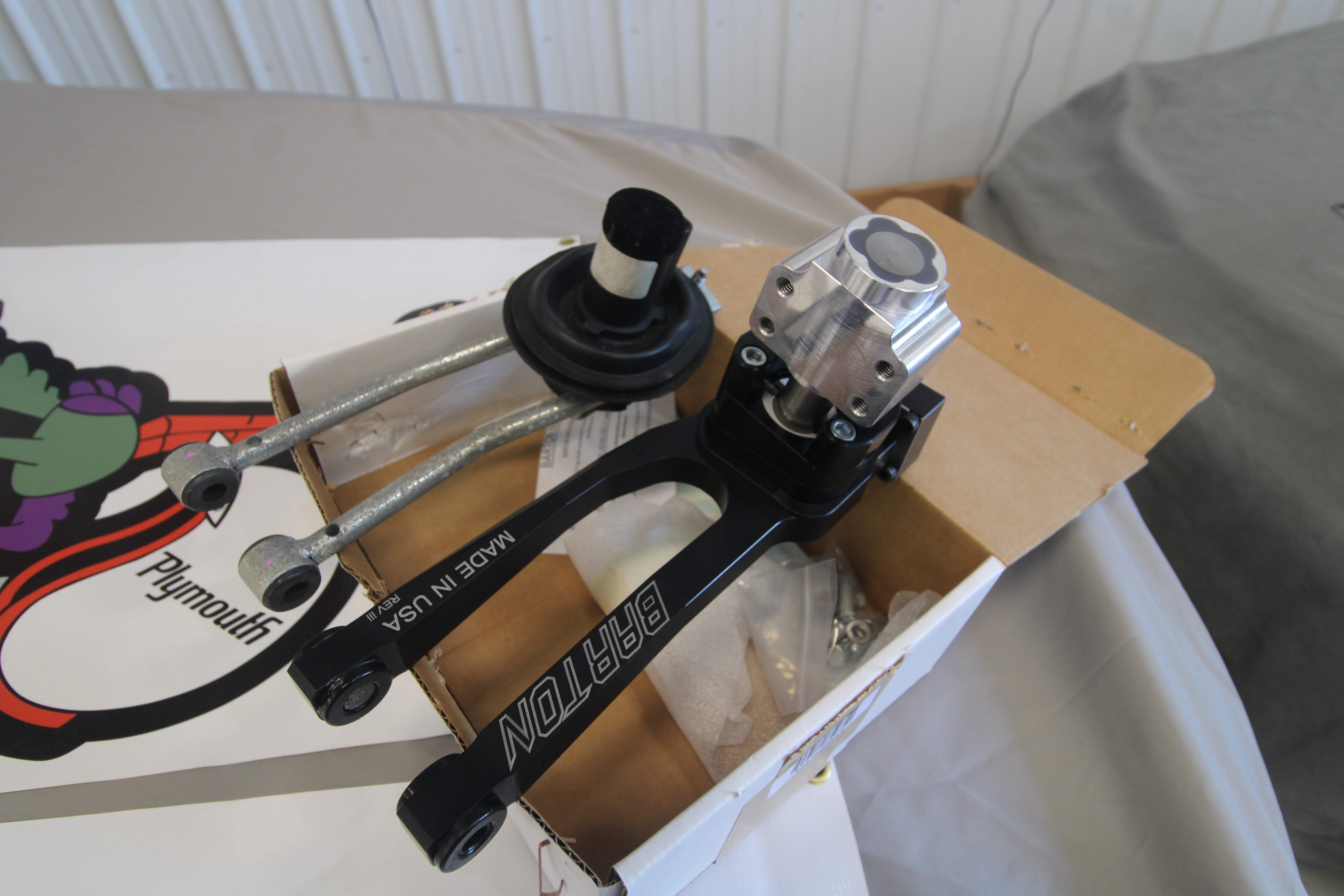

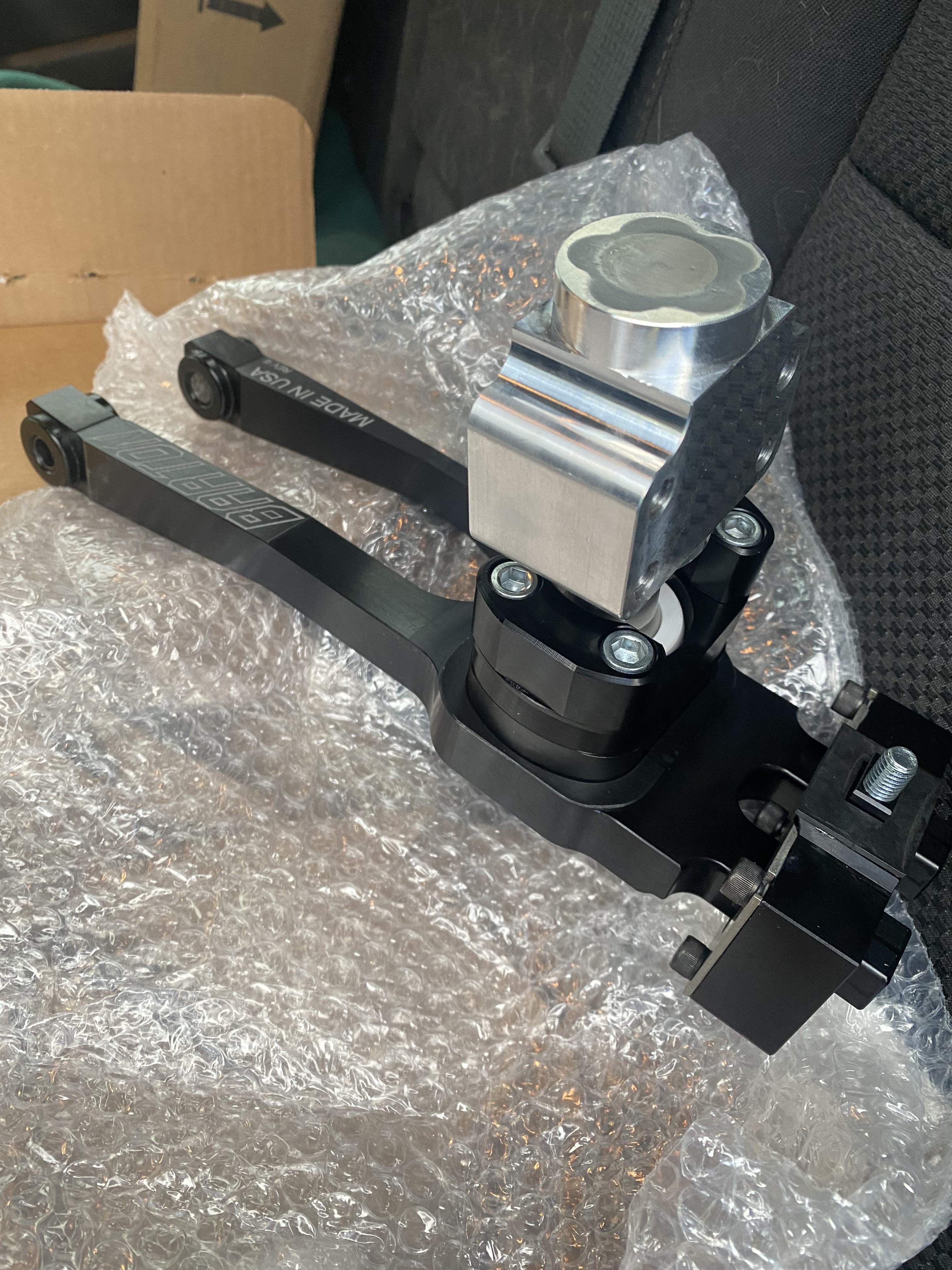

My package from Summit Racing came today!
Where’s the pics ??????
I haven’t open the box yet. Had to deal with the grandson the rest of the evening.
Here you go Kiwi! Fresh out if the box!
I hope to have some wrench time tomorrow (Saturday) to finish some things on Lucy and then start installing this into Violet.

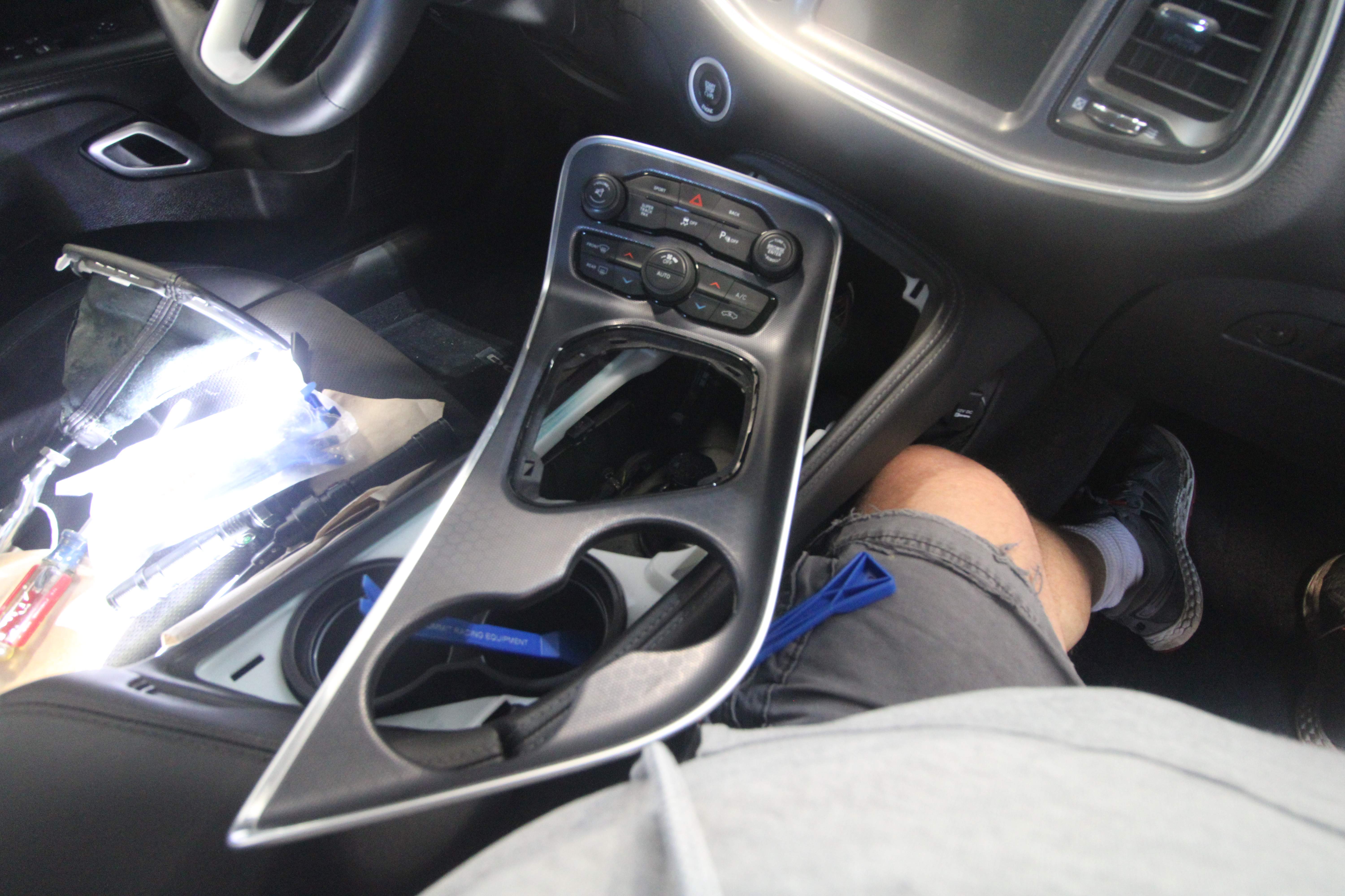

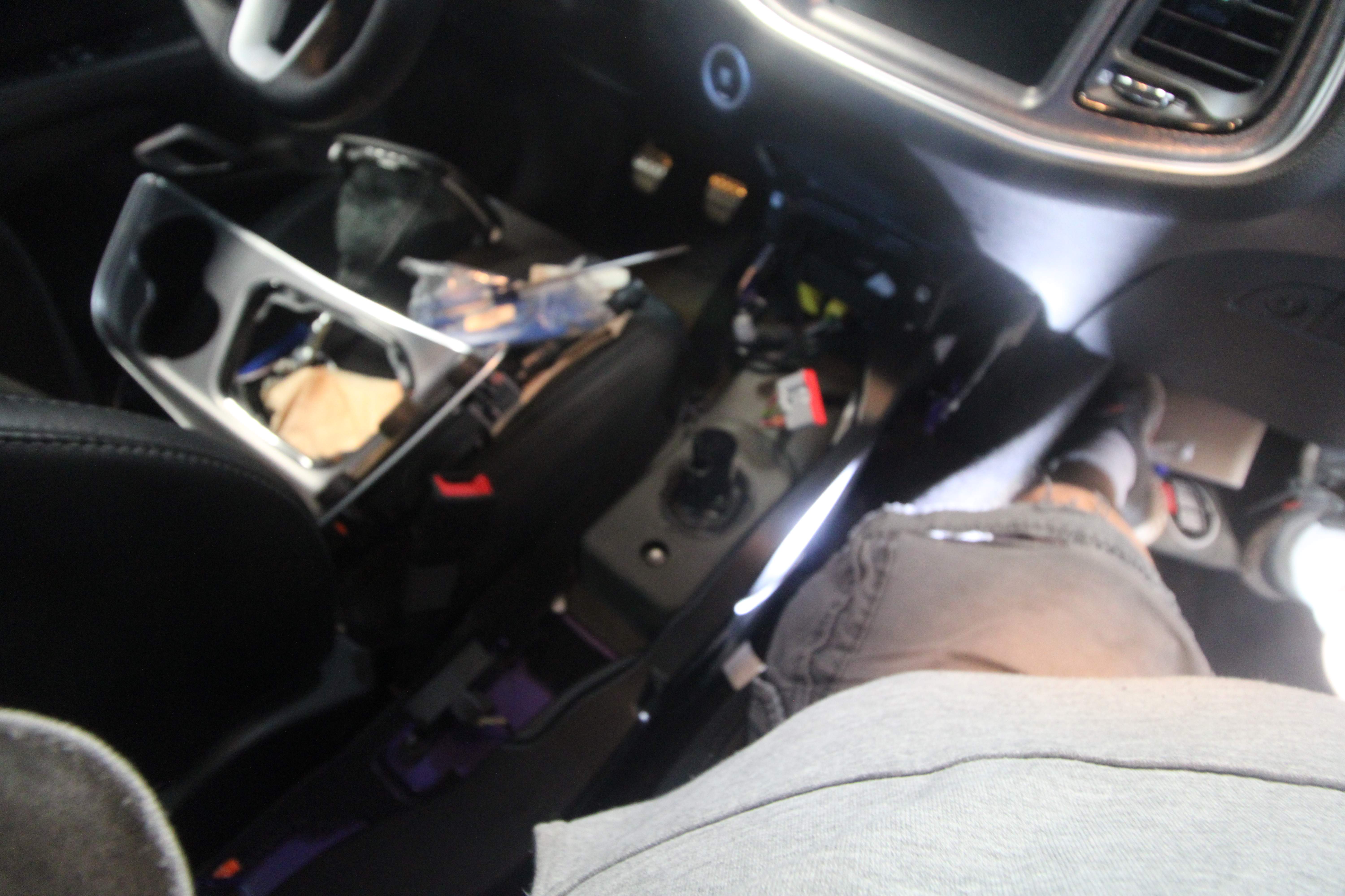

Today I spent wrestling the old shifter out and the new Barton short throw shifter in. I do mean wrestle. I watched 3-4 different installation videos for this and they make disassembly and removal of the old shifter look easy peasy. Ah no.
First you have to wrestle off the shift boot ring. Pops right out? Oh hell no. I had to use interior pry tools to get one end started before the rest popped out.

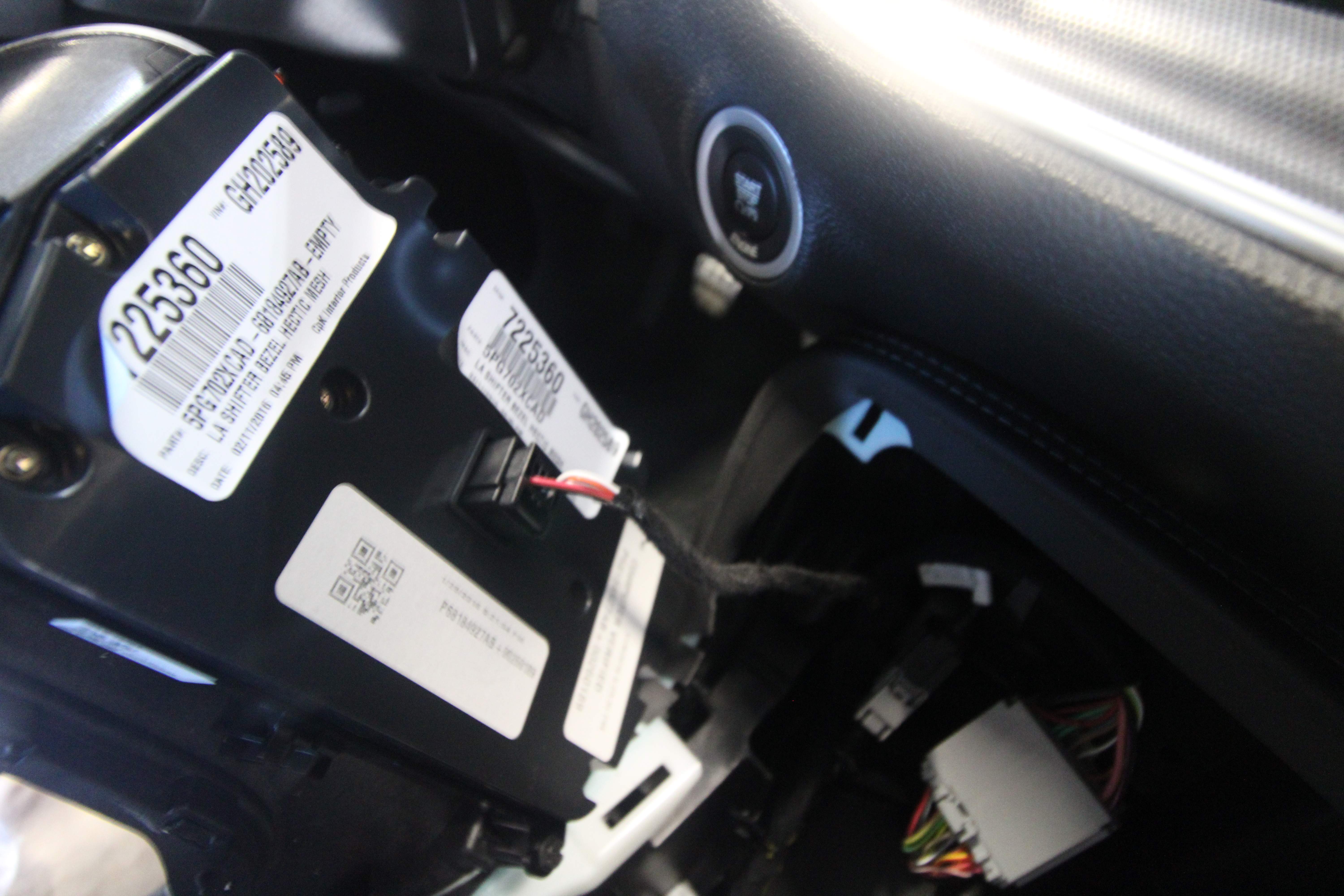

Now we remove the top console piece and disconnect the electrical connection on the back, Again plastic pry tools needed here.
IMG_1886.thumb.JPG.2dca7447c0e8a24282bc629abea9090a.JPGIMG_1887.thumb.JPG.c0e586c613a759f6af16a3c802d8eee2.JPG

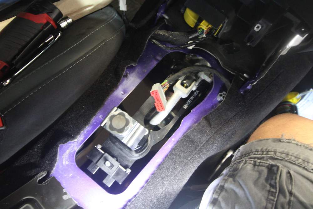

Now we have to remove two screws at the back of the console (we have to move both front seats all the way forward to get to them) and two Philllips screws at the front. That was easy peasy. Now remove 2 more electrical connections. Then you remove an AC tube that runs along the passenger side of the console.

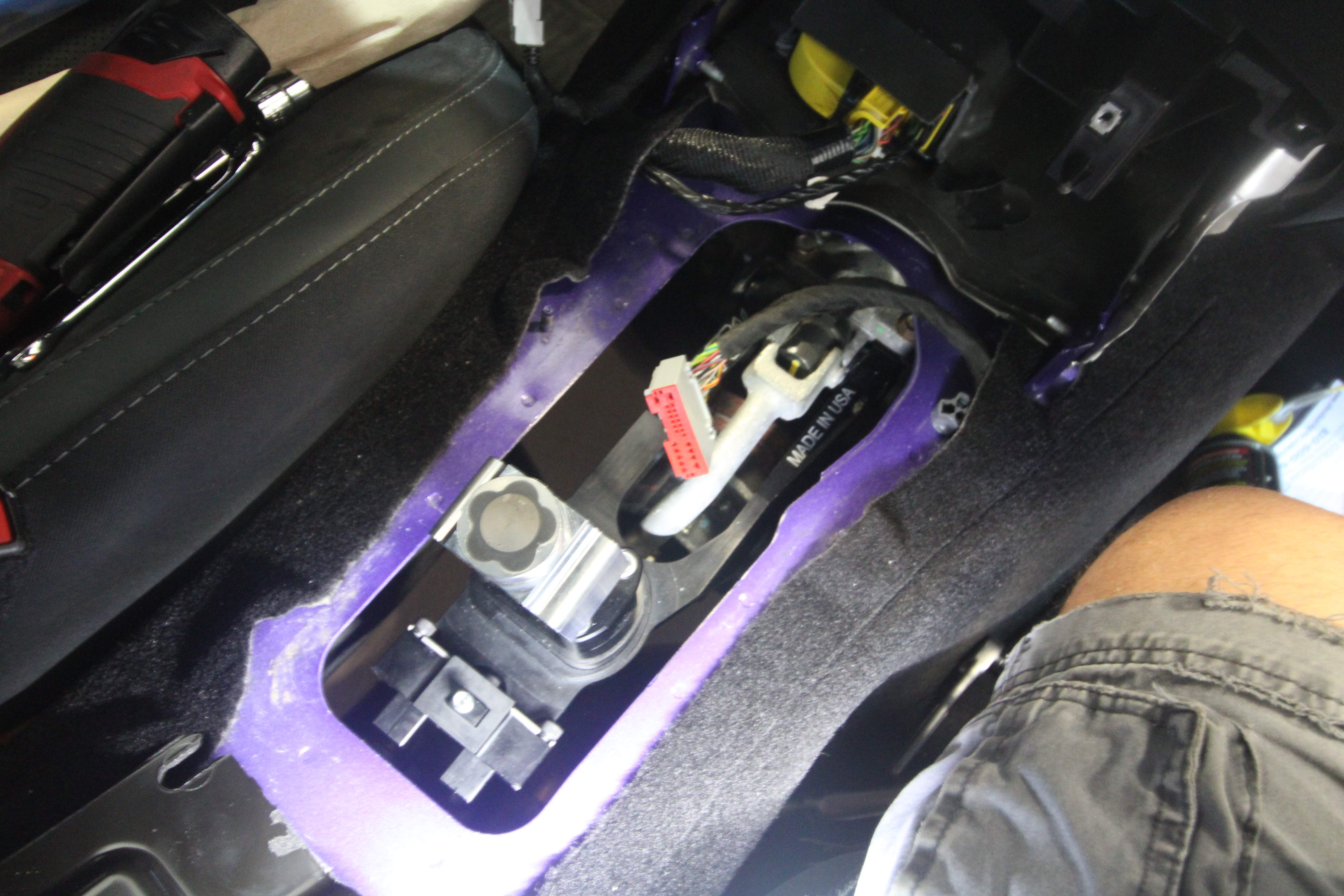

Now we peel back this plastic rubber mat to get to the metal shifter cover plate. Remove 6-10mm screws. Remove 1-13mm retaining screw to the shifter. Remove the metal plate. Now we have access to the shifter.IMG_1889.thumb.JPG.487f557765ee4270e00f63b57426f522.JPG
Now the real fun begins. The stock shifter is held in by a 10mm bolt to the reverse switch and two retaining pins at the front two forks. Getting the driver side out is easy. The passenger is terrible! There is exactly enough room for the pin to slide out of the passenger side. Be careful not to drop it or falls past the transmission to the floor!

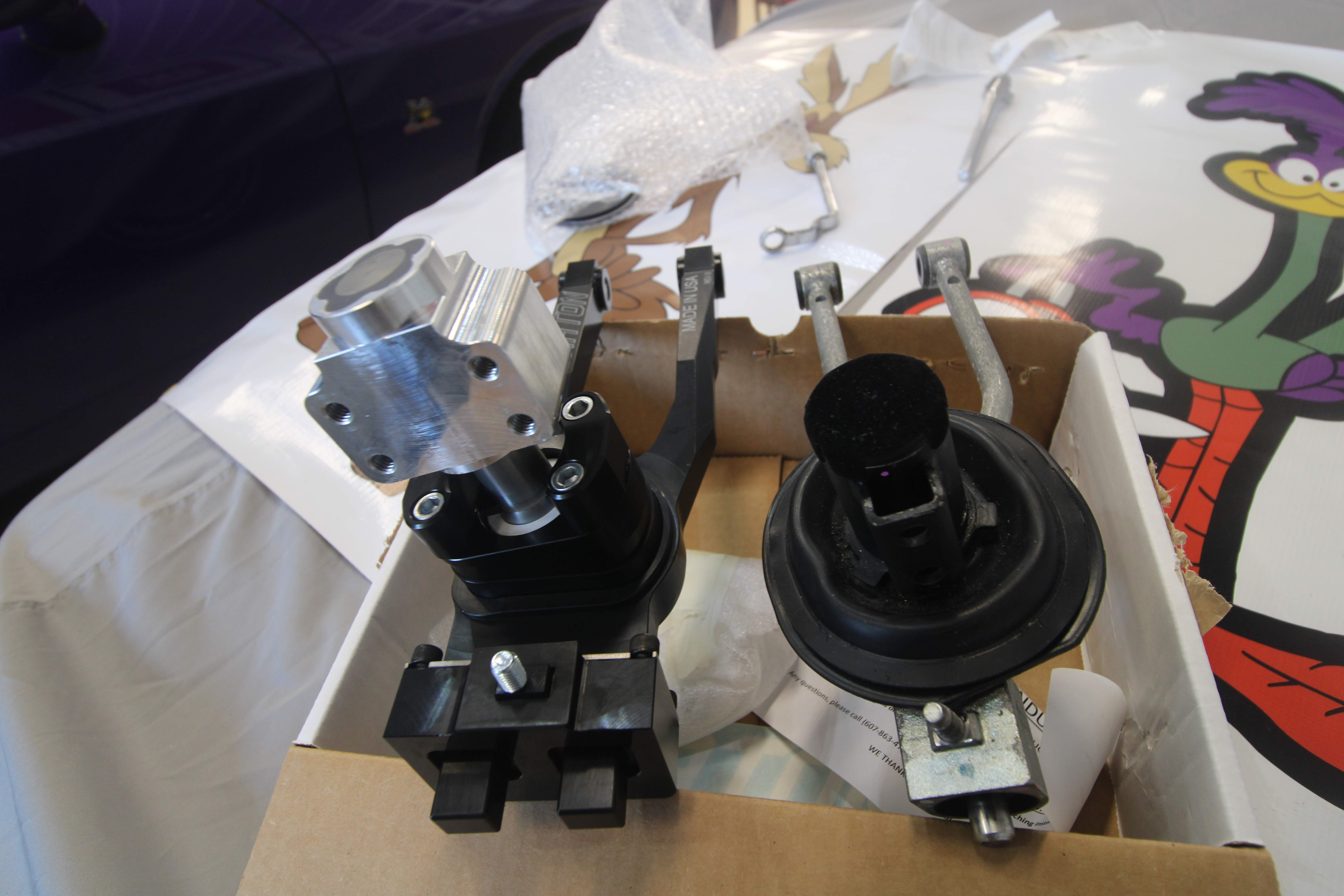

Yes! I finally have the old shifter out. Here is a side-by-side comparison of the new and old stock shifters. Note the 13mm screw at the back of the shifter. That becomes important later. The four screw holes on the back of the new shifter mount a special adaptor plate for the stick shifter handle.
IMG_1890.thumb.JPG.91d323b6918adf7b6b6f66b84024fc12.JPGIMG_1891.thumb.JPG.faa8be377e3170e2c7e2ea0c3f7faf75.JPG

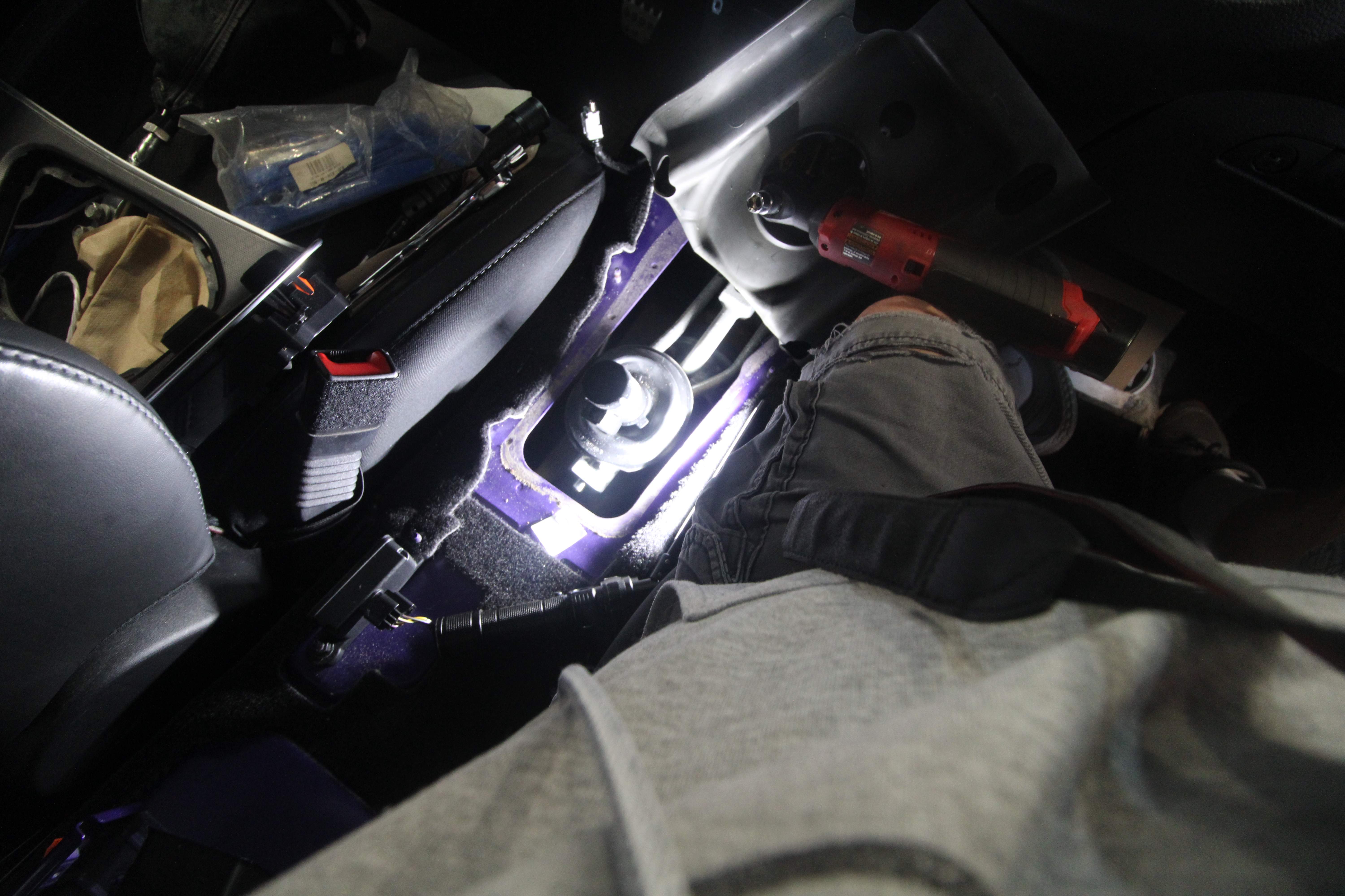

Now the real wrestling begins - get the two front alignment pins in - especially the passenger side. I suspect I spent an hour plus getting them in. Driver's side was not too bad. Passenger side was a bugger! I ended up taking that pin to a grinder and took a couple of millimeters off it so I could swing it into position easier. Finally I got the passenger side pin in.
I must have dropped that damn passenger side pin at least 20 times onto the ground. Each time I had to climb out of the passenger seat, grab my magnetic wand, crawl under the car, get the pin and try again. There were a lot of cuss words too.
I bolted up the 10mm reverse throw screw.
The new shifter is finally in. However the fight was not over.
The next fight was the new plastic rubber gasket that came with the shifter. It goes between the shifter and the black metal retaining plate.
By this time, my son had showed up to the garage mahal. He came to swap his Hummer for his Silverado 2500 High Country pickup. He jumped in and helped me. As God is my witness, it took both of us, four hands to wrestle that new gasket on the metal plate and over the shifter and put the plate in place without the gasket popping out of place. It tooks us at least 5 attempts before we got it right.

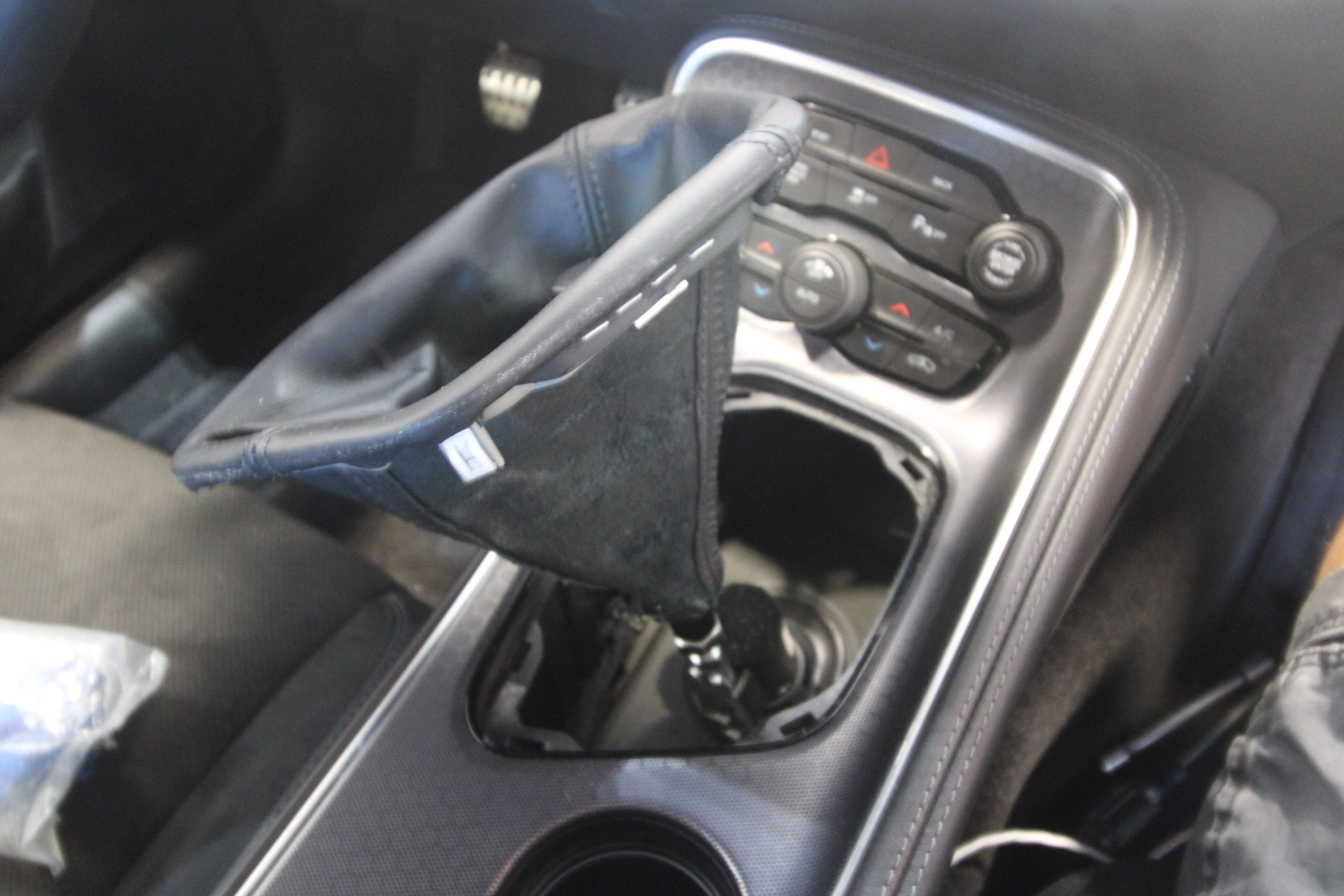

We screwed on the 6-10mm bolts and threaded on the 13mm locator bolt. Put the rubber cover back on. Now we put the console back on. The shifter has a special mounting plate that adapts the stock shifter handle to the shifter. You are allowed to mount the shifter straight up or up to about 30 degrees toward the driver or 30 degrees towards the passenger. We installed the shifter handle straight up for how. Popping off the shifter boot allows you access to the bolts to adjust the shifter position.
AC tube re-installed, the main console screwed back into place, and electrical connections reconnected. Shifter boot on!IMG_1893.thumb.JPG.c194b628b444e8732062d9f0413feb41.JPG

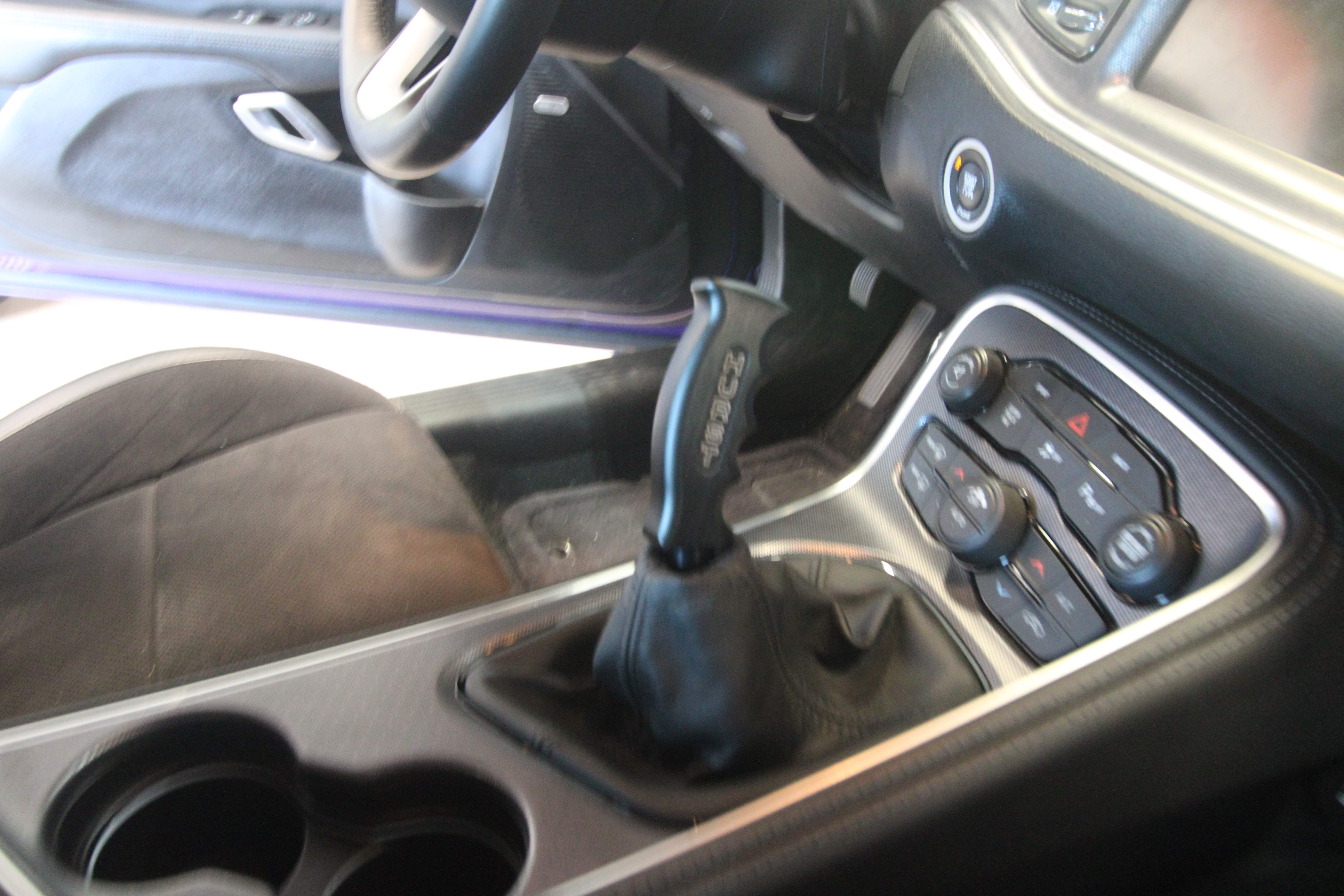

Jacob and I went for a test drive to our local Auto Zone for some Stabil gas stabilizer for his Hummer's storage over the summer. It was definitely a different feel and much shorter throw. However when we got back, we were getting a bad vibration and the shifter was sinking down into the console. As I was putting the car away for the night I realized that we never tightened up that 13mm locating nut at the back of the shifter! Duh! I suspect the test drive knocked it loose! So now I have to take part of the console apart again to get to that screw and nut. Argh!
Obviously I will get back to it later this week.

The question is .... do you like the short shift ?????
