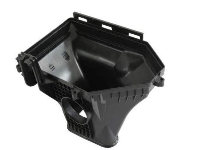

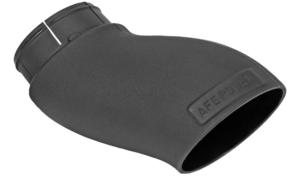

I just ordered a Hellcat SRT Lower Air Intake box, an aFe Power Dynamic Air Scoop, a set of Scatpack / Superbee logo ghost/puddle lights for the Challenger. The air intake replaces the stock Scatpack lower air box. The only significant difference is that Hellcat box has a hole in it for the air scoop to connected between the lower air box and the 'soon to be opened' air duct in the driver's side turn signal.
This is cheaper than a true cold air intake and it does help lower the ambient air temperature of the air going into the engine. So it might be worth 1-2 HP but what's cool to me is that is essentially ram air. That's always cool. I will eventually get a K&N reusable air filter too, but I will wait a while before since the stock filter still has some mileage left on it.

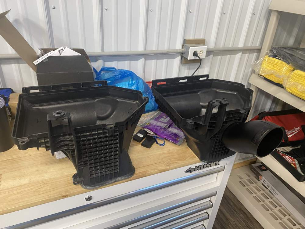

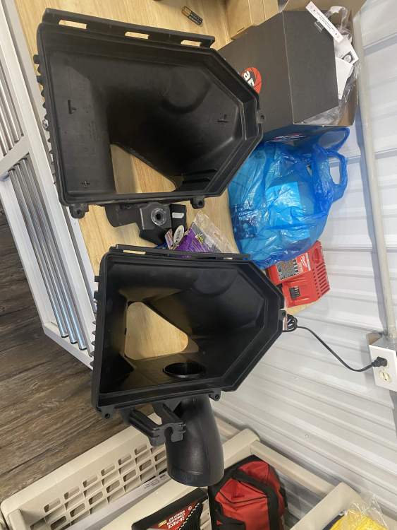

My Hellcat lower intake air box showed up today. IMG_1472.thumb.jpeg.259e3e7227f9824f6e2608688510df7e.jpeg
Obviously this is not how it shipped but the air box was okay. I had already received the air scoop.
I took the air box and scoop to the garage mahal and went about installing it. It took less than 30 minutes.

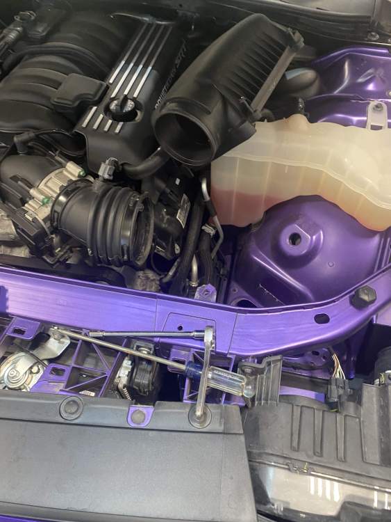

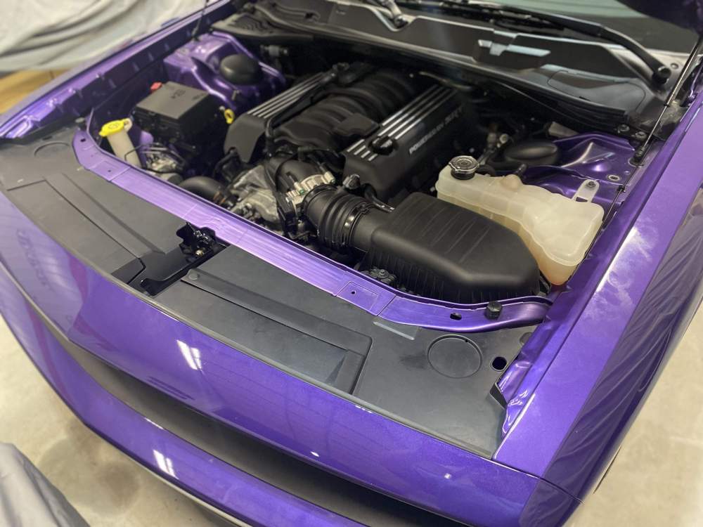

I started with this -the stock air cleaner and box.
First remove the plastic trim.

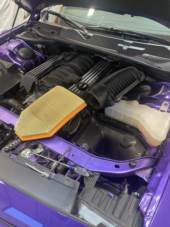

Remove the top of the air cleaner and air filter next.
Remove the single 8 mm bolt and remove the lower air box.

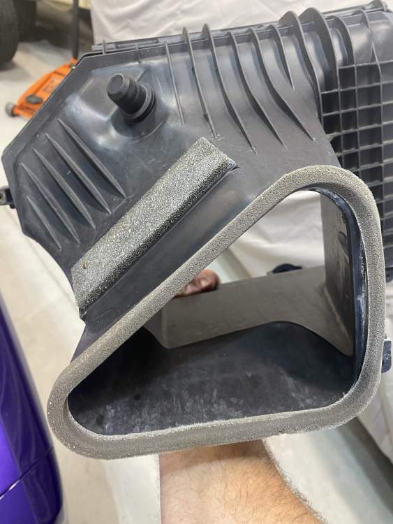

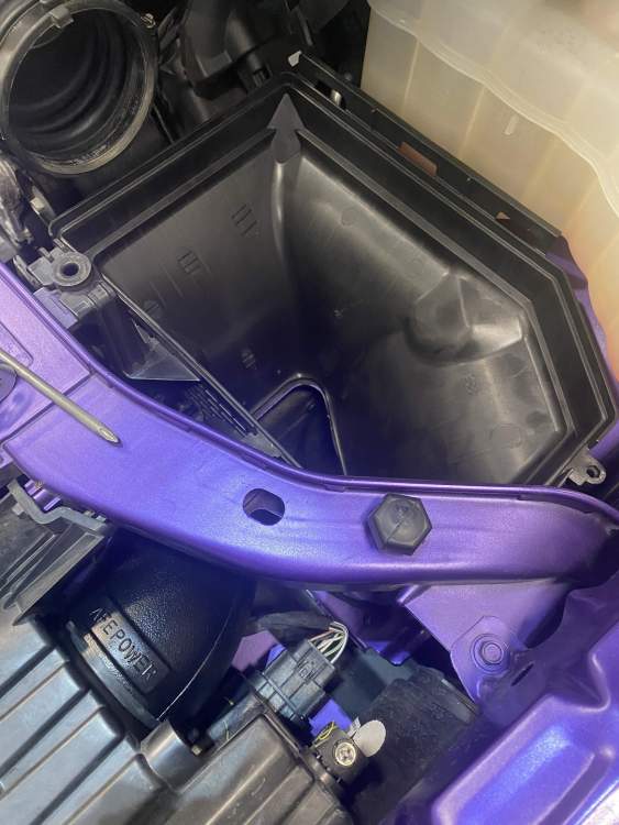

The old box has foam in two places, along the bottom, the new box has none. I stopped at Menards and paid $5 for some rubberized foam strip. I used it on the new air box in the same two places.
Comparing the two air boxes, the Hellcat is a little bigger but the big difference is the hole for the air scoop to attach to it . I have to transfer the 8 mm grommet and cap from the old box to the new box.

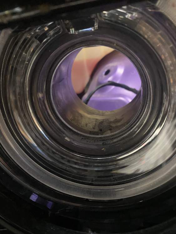

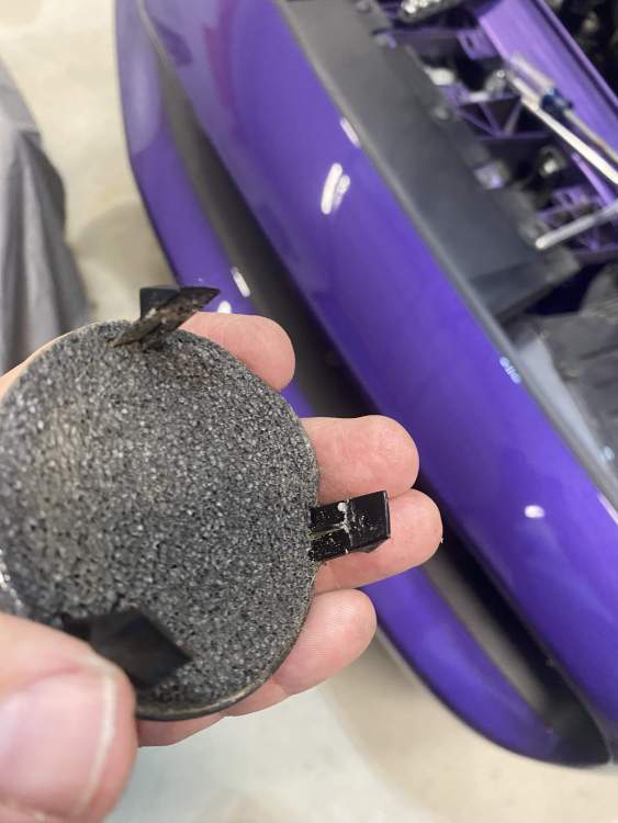

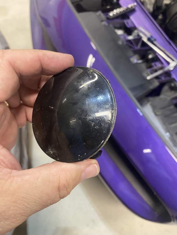

Now I have to remove the cap plug in the driver’s side turn signal. I’m lucky in that my Challenger has the cap held in with three little prongs that you can stick your hand in and easily release. Newer models have retaining screws that are a Lot harder to remove. IMG_1486.thumb.jpeg.97b6721d405d42a1ee45ff873f6d4f8c.jpegIMG_1487.thumb.jpeg.d04afd3fcffaa5ff9861ec4481401726.jpeg
Now the path is open to the engine bay.

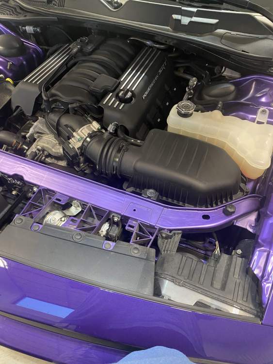

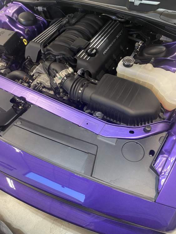

Now slide the air scoop in and plug it into the new lower air box.
Install the air filter, screw the upper cover back on, and put the plastic cover back. All done!
