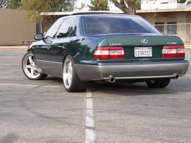

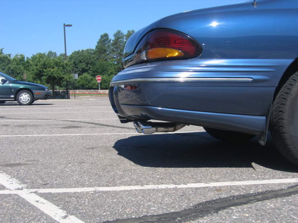

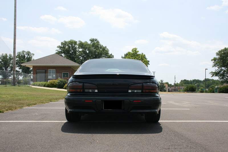

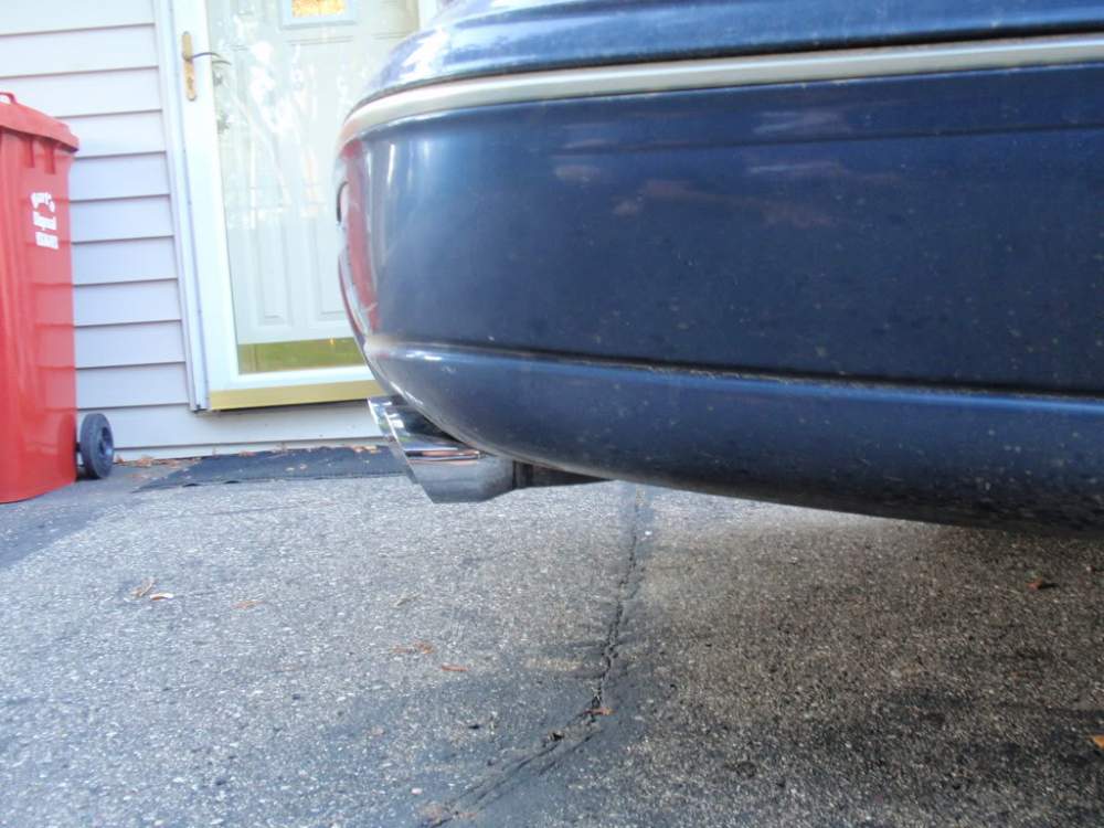

As for the tips..
I'm leaning toward these:
Cutting the bumper like this:
So that you can't see the tips from the side like this:
It'll be more like this:
Here's a pic of my rear for reference:
Tucking them up into the bumper should look really good, much more finished than simply having them hang below.

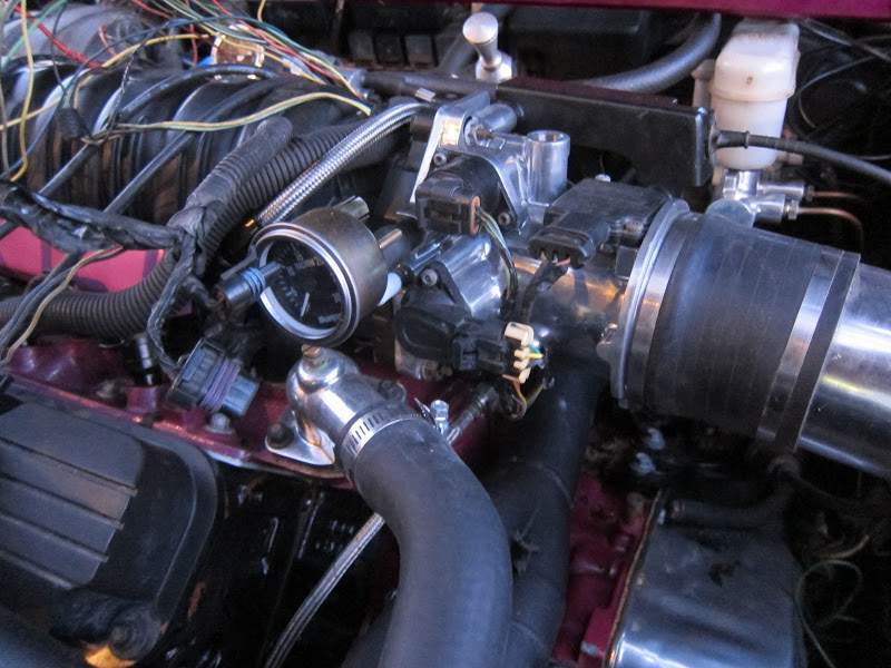

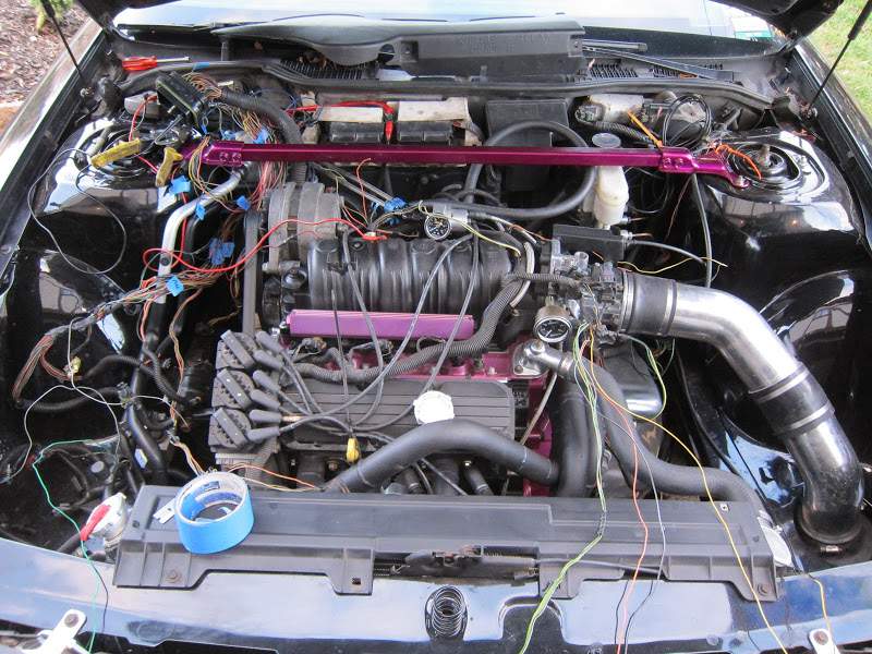

For whatever reason I decided to start on the engine wire tuck in 30*/feels like 15* weather.
I'm using a 95 S1L67 harness to chop up. There's a few differences like the coolant temp sensors, TPS, knock sensor circuit, etc. but it's not too bad. The plan is to run the TPS/MAF/IAC wiring under the TB, meet it up with the relocated coolant temp sensor, run through the injectors behind the rail, pic up the O2 and Alt back there and the wiring that goes to the oil pressure sensor/VSS/T2V solenoid/knock sensor, then head to the firewall. I'm not quite sure how I want to run the front bank injectors. I've seen people use a small hard line before running the injector wiring through and over the plenum.
Here's the bigger part of the tuck.. I'm going to relocate the coil pack behind the lower passenger side radiator and run all the rest of the wiring under or along the lower part of the passenger side unibody rail. The rear spark plug wiring will be apart of this too.
So you wont be able to see any coil packs or spark plug wires, there's going to be no huge ugly harness running across the front of the engine, and minimal visable wiring everywhere else.
Given how I couldn't feel my fingers most of the time, I'm not sure when the next time I'll work on this is. It's definitely an above freezing job.
It is progress though..
