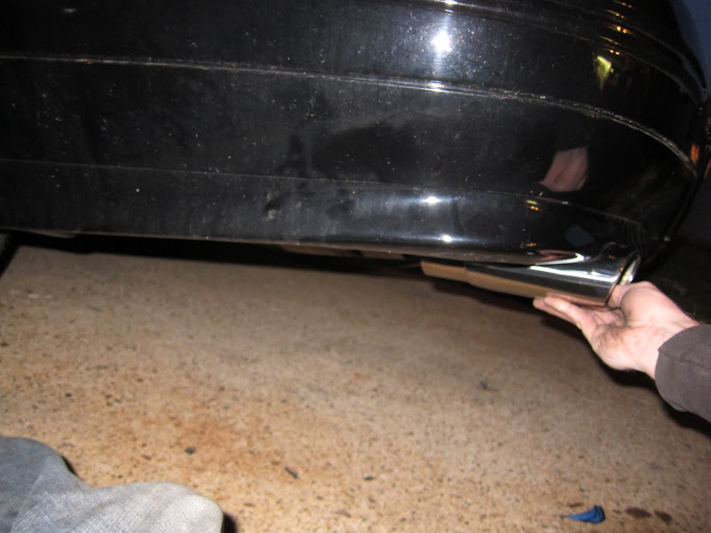

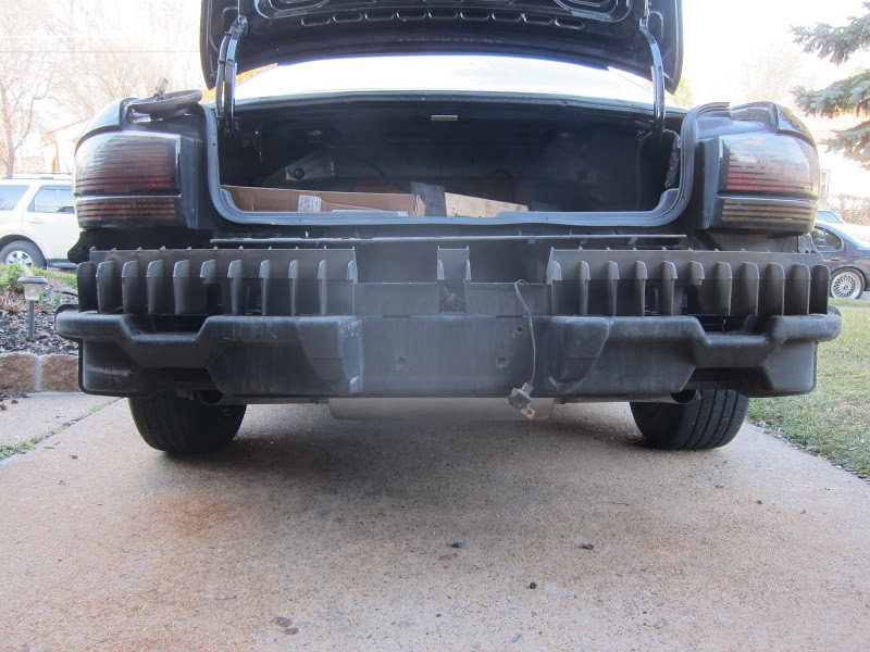

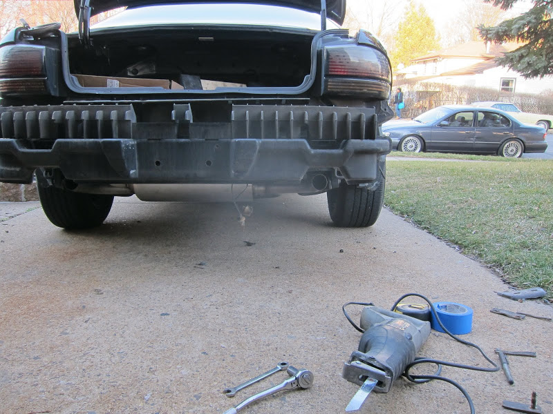

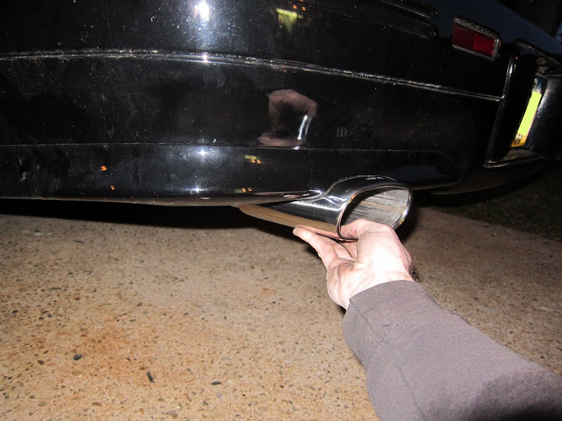

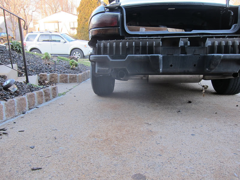

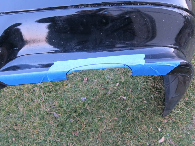

I started on the exhaust tip bumper notching today.
I had to cut out the trapezoidal sections of bumper support in the way of where I want the tips, measured a bunch of times then I slowly started removing material from the bumper.
The notches only allow for a quarter of the tip to be tucked up into the bumper so far. I would like to get it half way tucked with clearance.
I ran out of light but I need SS wire plus a new liner for the MIG feed line anyway.

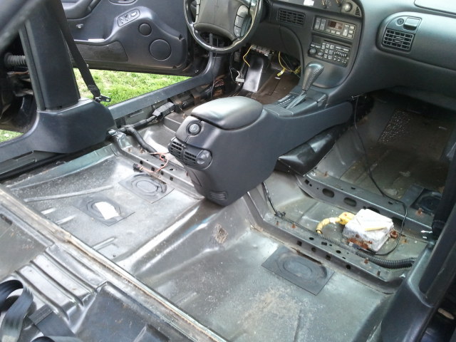

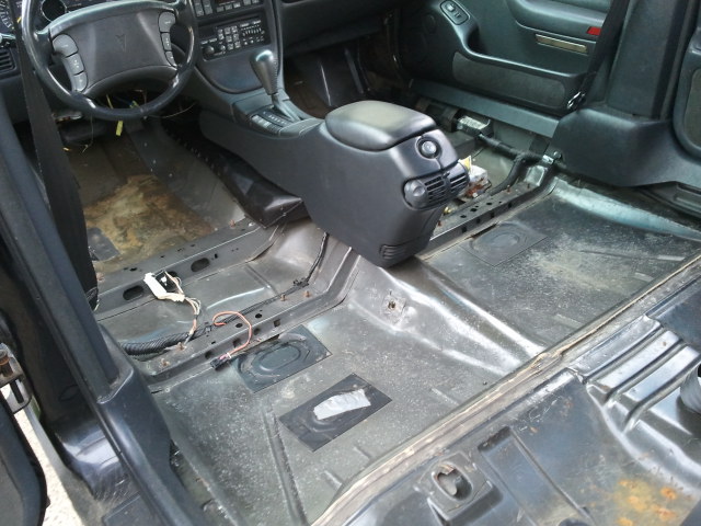

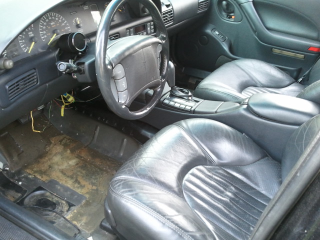

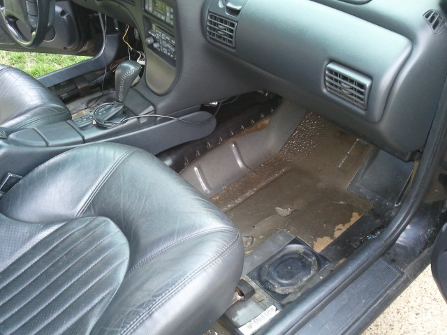

I wanted to get the carpet and padding out due to a water leak I have. I'm pretty sure it's the leak is at the bottom of my rear window and at the top of my windshield. I don't have any immediate plans to fix this since the car is going to be kept in a garage by May. But, I don't want soaking wet padding against metal till it finally dries out. With the car in the garage I can take my time having the glass out, addressing any corrosion etc.
I adjusted the TCC/brake switch and verified the TCC engagement but my mph settings are still goofy from my last tune. My laptop is currently MIA so, I'll revisit this.

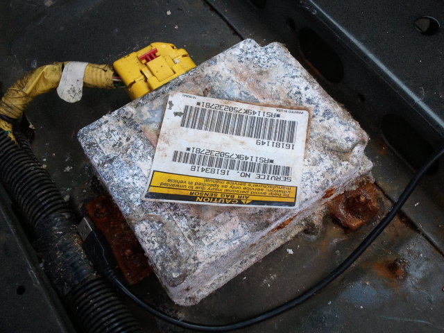

I definitely found why my airbag light is on.. lol. The module looks like it's been in the ocean for a year. I have another one of these modules buried somewhere in my storage space. I'll find it when I move vs. wasting time looking for it.

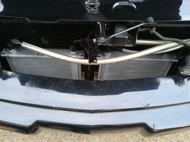

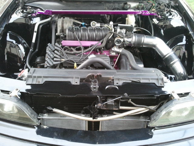

And I finally finally finally got the hood stay bracket back from my painter buddy and installed it. I couldn't mount the oil coolers till I got this in there. The brackets should be pretty easy. The coolers are re-zip tied back in place for now.
And on to the pics.. The interior is kinda beat with no carpet but it'll do for now.
