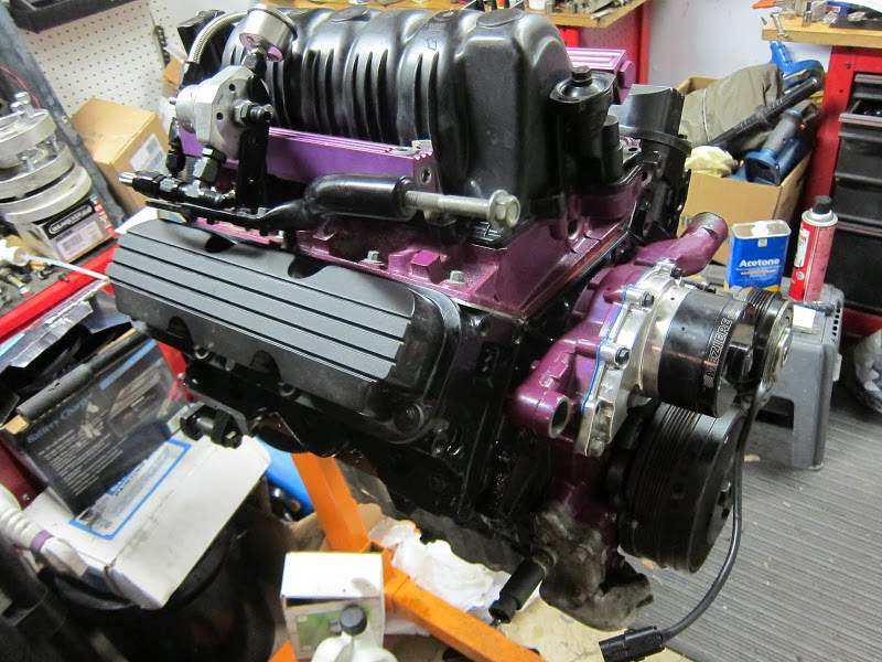

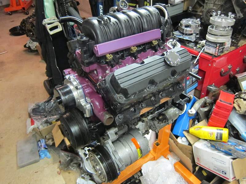

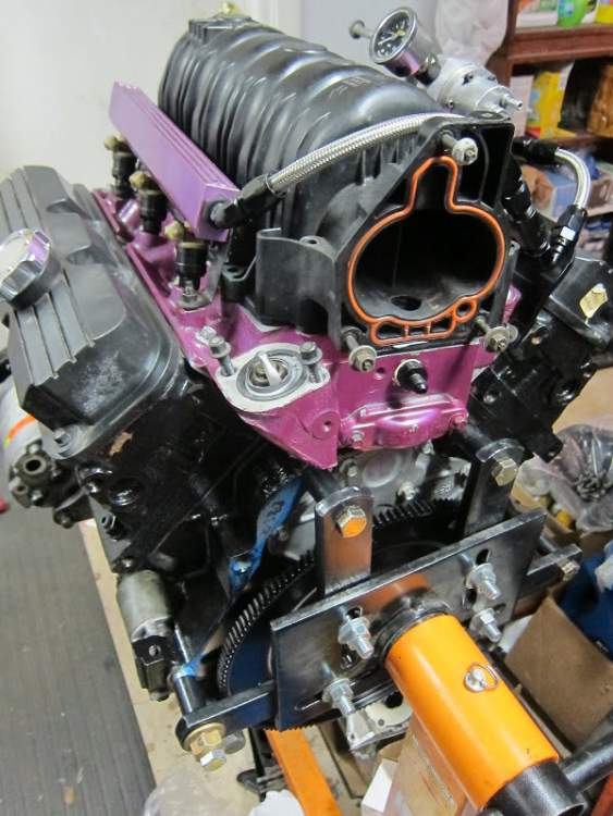

Looking damn good Mike. What ratio rockers are those, just 1.6, for the little less mass/friction?

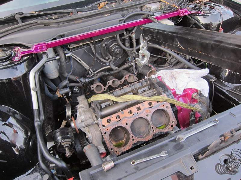

Thanks guys. This stuff really isn't that bad. Cleanliness is just real important as are the torque specs from the lower intake down.
Way back there was a L67 cam install write up that I used for my first head/cam swap (04'). I think it was called Eric Bruno's Cam install guide. It was very well detailed and illustrated. I must have read that thing 30 times before I tore everything apart. I really had barely a clue what I was doing.. But I started Saturday morning, finished Sunday night (worked straight), and drove the car to work Monday. I think I put 80k on that cam too. But, that's how I learned.
Yep, Ed. Just revised 1.6s. I got them for a decent price and said to myself, at this point, why not. It might rev a tiny bit happier with those and the Ti retainers but I don't expect any measureable gains.
The GP still needs some gaskets replaced (lower intake manifold and head gaskets) so I may eventually tear it down that far and see if I can put it together again. :cheers:

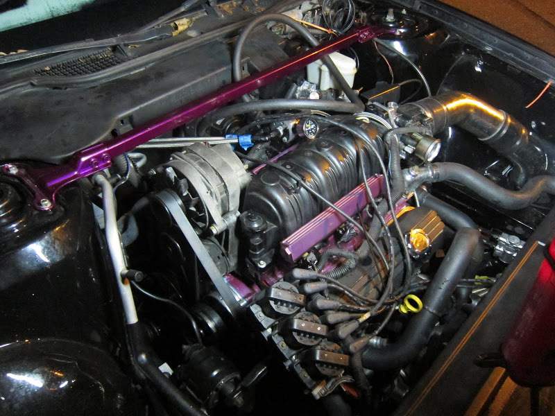

IT's ALivE!
I started it up around 6:30 or so tonight.

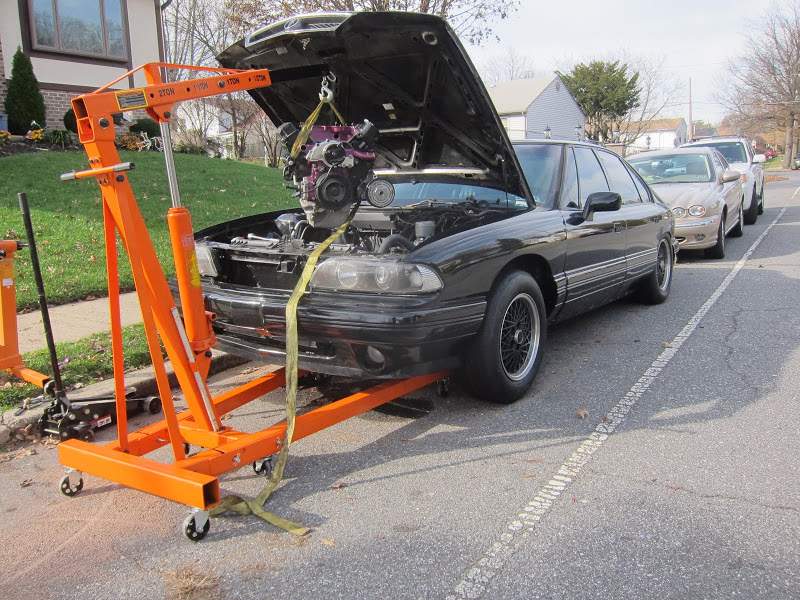

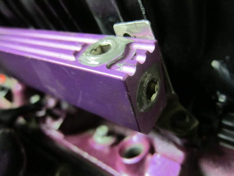

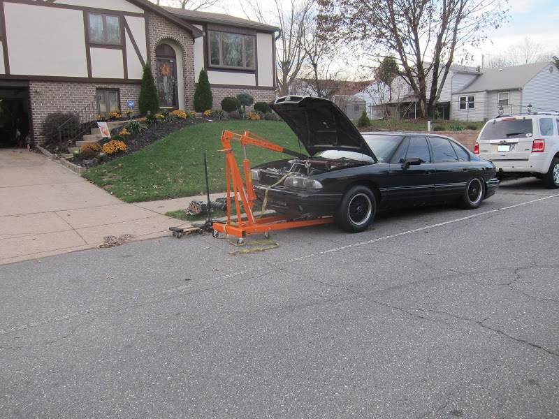

Friday I pulled the old engine and swapped over the ported rear cover, powder coated flex plate, knock sensors, oil level, sealed up the oil pan, A/C compressor, and starter. I also JB welded the problem fuel rail fittings.
Then I took a day off..
Today I popped the engine in, completed all the btch work associated, tired to start it up for about 20 mins, checked spark and fuel, had both?, swapped to another PCM and it sounded better and then started. Wooooo.

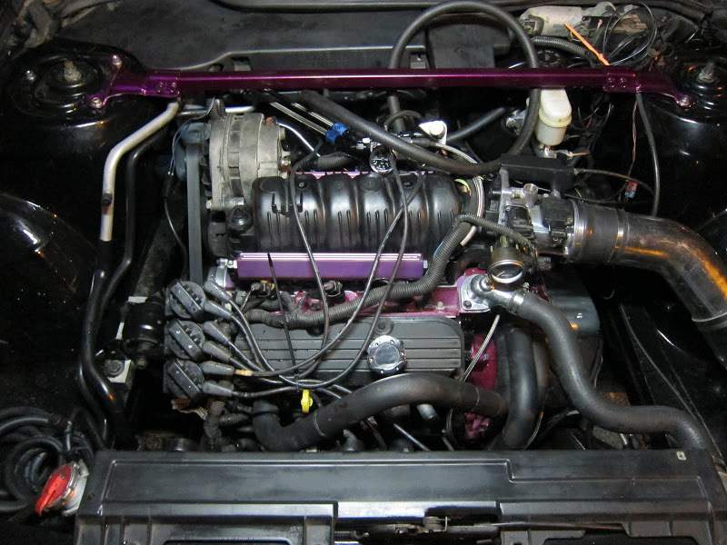

Don’t mind the messiness. The goal of the day was to get it running and bled.
Ahh, I'm so glad you got her running again! And no worries; your messiness is cleaner than my cleanliness. :D

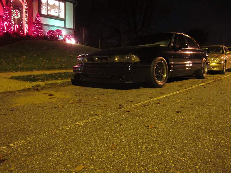

Some good and bad happened today.
The bad was:
It took me 20 mins to get the Bonnie started due to a dead optima and not enough fuel
The hood latch was gunked up enough to where the hood would shut, feel shut but could still pop back open.. and it did while I was driving at 35ish.. the safety latch bracket is still in my painter buddy's possession.. ef em ell. The hood kinked a little on both sides half way up the length which is pretty lame but I bent it back and it's ultimately repairable. Remember that the hood is already damaged from my strut poking it during the accident that put the car out of commission in the first place.. So, I guess it's not terrible..
The Good:
The car is now inspected. So, no more worry about it sitting on the street. And since it sat for a year it was emissions exempt. lol.
With the whole not starting thing.. I had a hunch and added fuel via tuning and I was able to get the car started.
A buddy had a civic overflow bottle laying around for free and had a bracket that wasn't for it but will work to mount the bottle in my fender. So that was a freebie.
And I got a rebuildable 01 VLSD trans for the i30 for $50. He didn't want anything but I couldn't not hook him up with a little $$.
The car runs and drives good for the most part. It needs a tune bad and also needs a flex section in the exhaust so I didn't really get on it. The midrange is definitely beefy though.. I'm also pretty siked the 3.43 trans I rebuild and programmed in.. It goes into all gears no problem.
I lowered the front a little at some point during this whole evolution and there are no noticeable axle vibes. I think the fresh engine mounts might have something to do with that.
And it was cool to see the look on people's faces when I popped the hood. :shock: What the hellllllll??? lol.

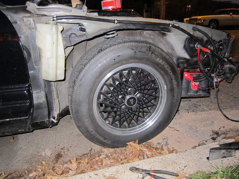

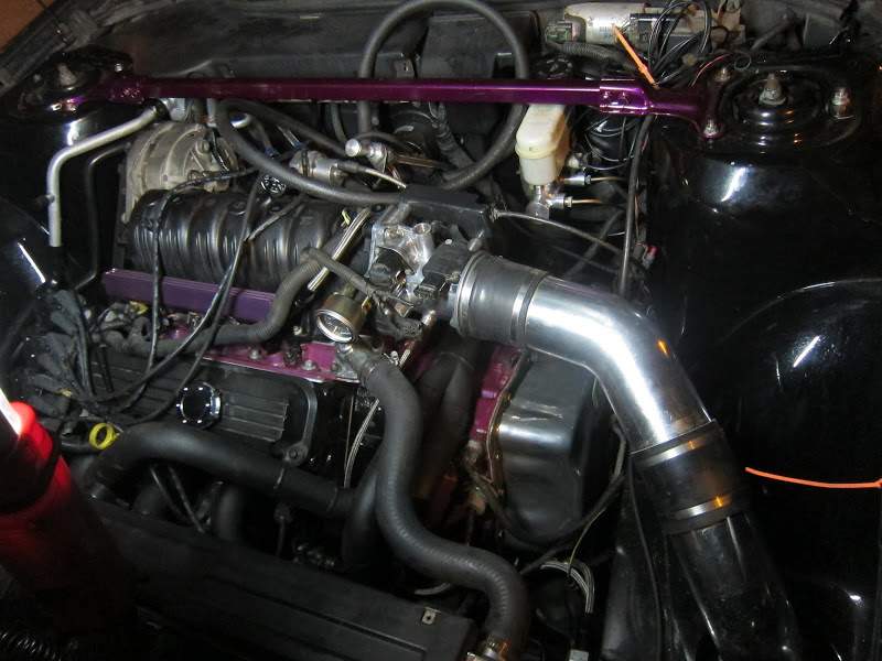

Mini update.
I got the coolant overflow hidden/mounted/connected.
It's only one phillips head screw away from checking the level, which is worth it to me.
