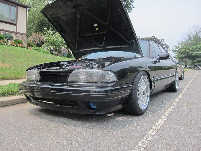

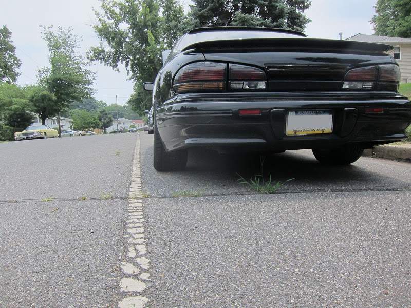

The 275s on a 10" look nasty out back. They fit real good too. I'll try to get pics of that soon.

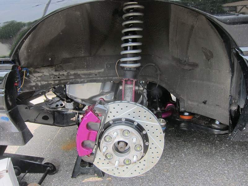

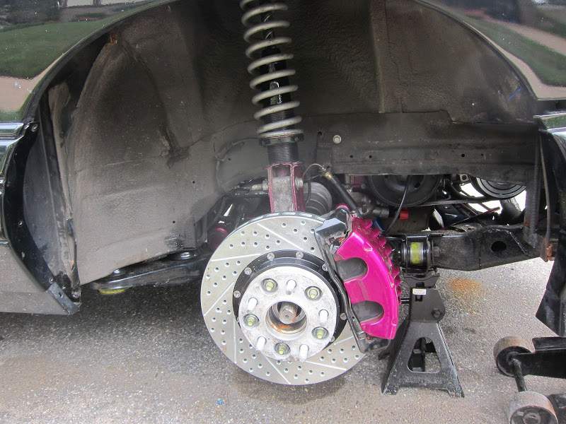

Here are some pics:

I bow down in your presence, sir. That second-to-last picture is my favourite, the wheels look great under the arches!

The rotors are Baer 2-pc 12" made for a F-body. I just had them re-drilled.

those are some epic big brakes for that car. hell i need brakes that big for my big heavy hog...

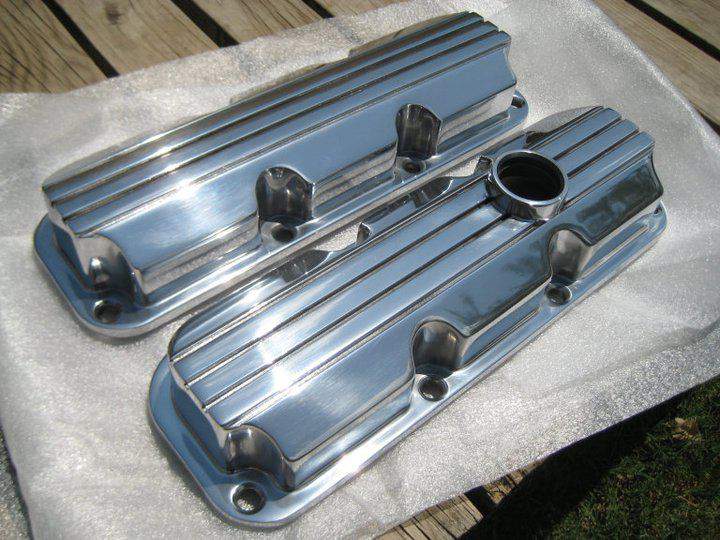

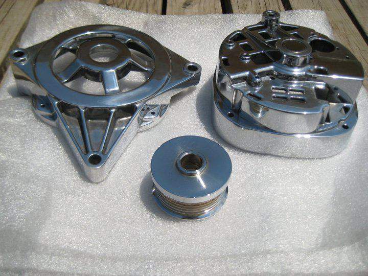

To do a mini recap, I had polished the valve covers and alternator housings and had them powdercoated clear. Bad idea. They oxidized pretty bad under the clear. Polishing takes a massive amount of time and although it killed me to do it, I outsourced having them re-polished. The time was just not there to spend on the parts. I also had a couple pullies chromed while I was at it. I went with a guy well known in the 3800 community, Jason Farnsworth. Here are some teaser pics he sent me:
Excellent work.
Lol. I was just creepin in there last night.

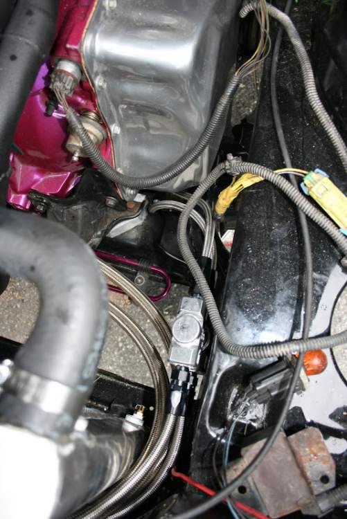

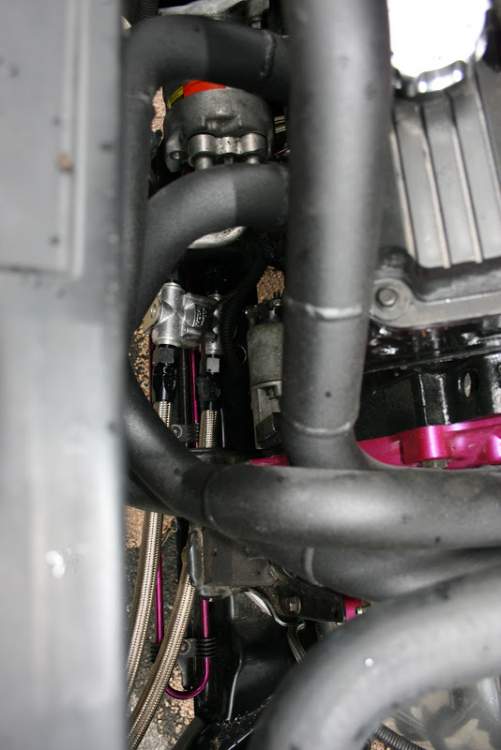

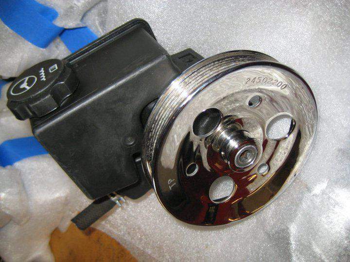

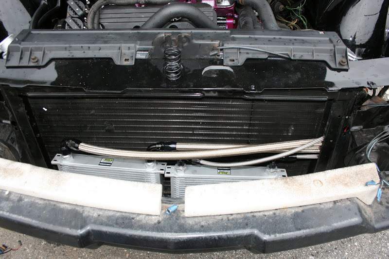

The new p/s pump is in, lines are hooked up and fluid added.
Both coolers/lines are ran, hooked up, and fluid added to the coolers
All the suspension bolts are tight, ball joints and tie rods are greased.

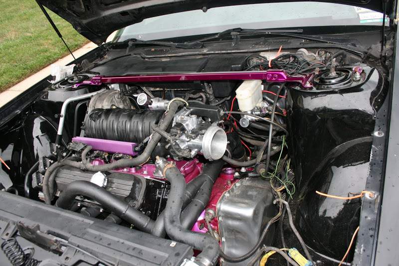

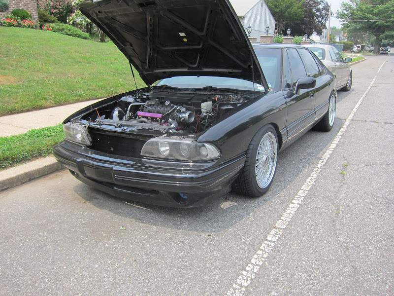

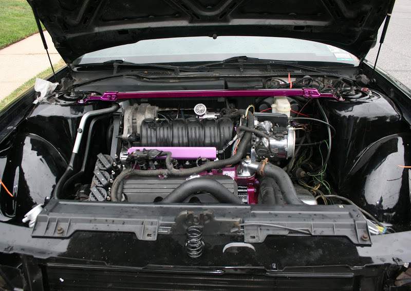

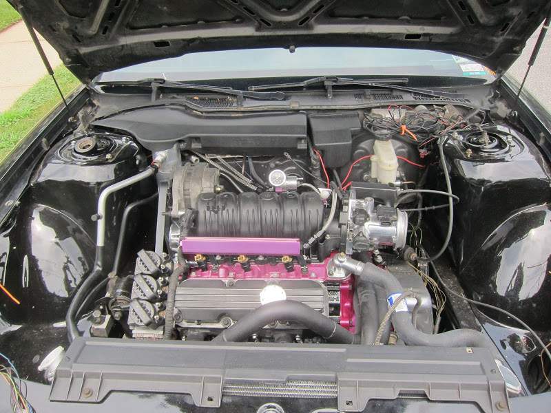

Pics right before the sky opened up Saturday:
I'll worry about the polished VCs and alt after it's running ok and I re-do the engine harness.
Engine bay is looking nice sir!
Why couldent you tuck the harness?
I plan to, just after I know the engine runs right. It's just one less variable for the initial start up and break in.
