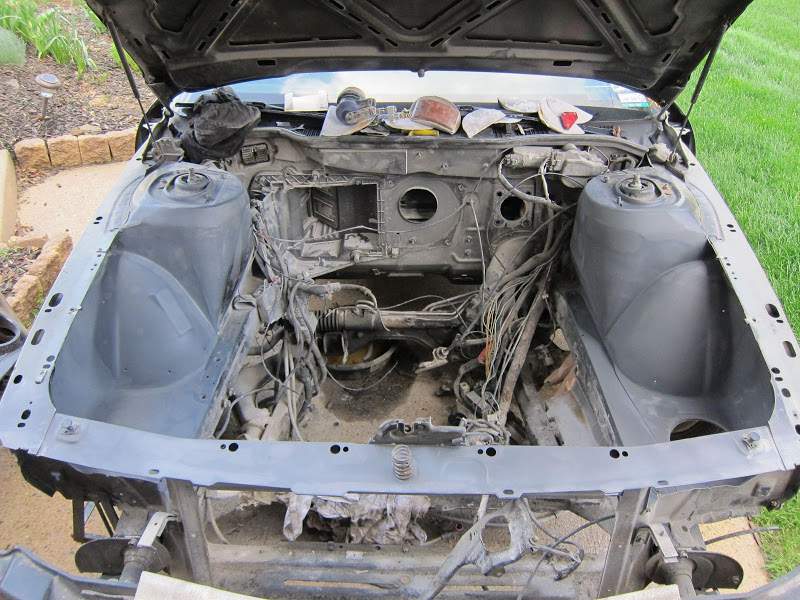

I took a comp day today to get some more stuff done.
The short list:

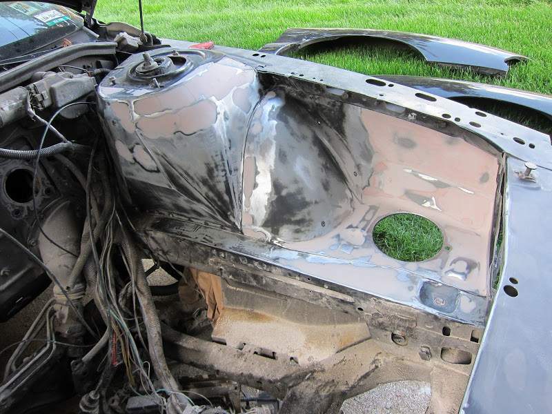

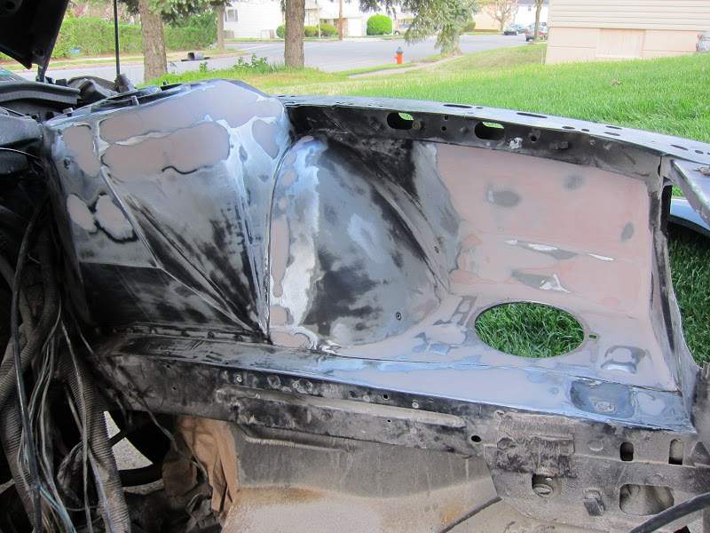

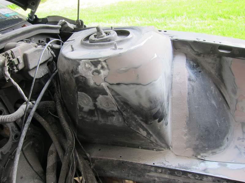

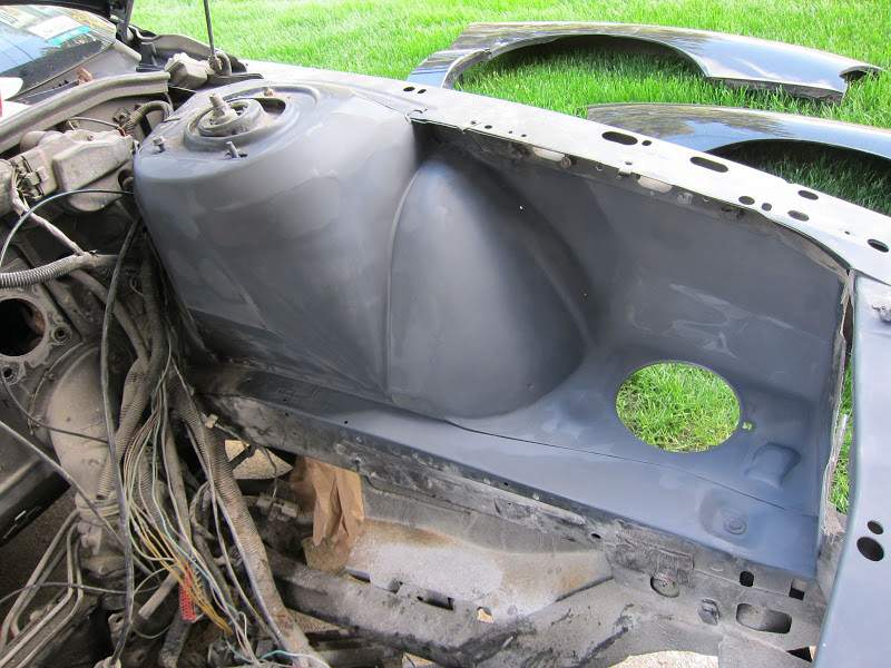

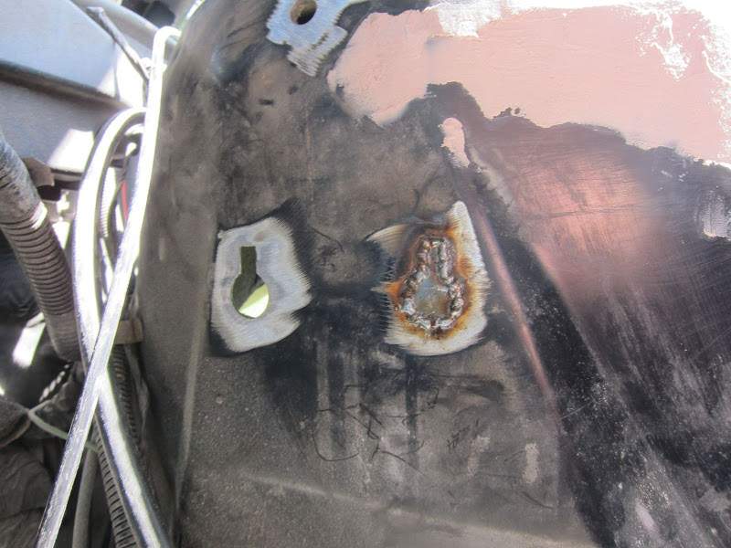

-Finished drivers side bay bodywork
-Mounted battery terminals

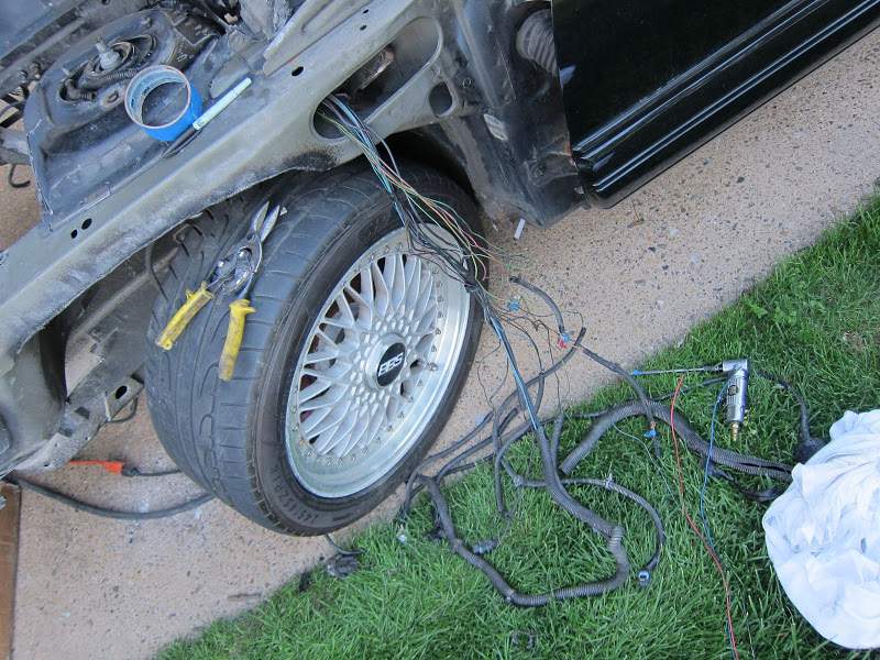

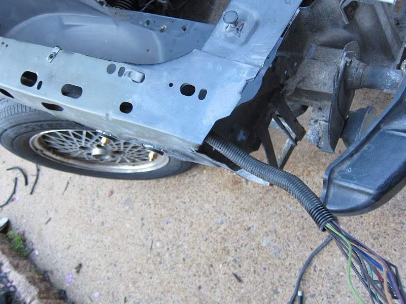

-Drilled hole and tucked passenger side body harness.. (the easy side)
-Drilled hole and started to tuck drivers side body harness

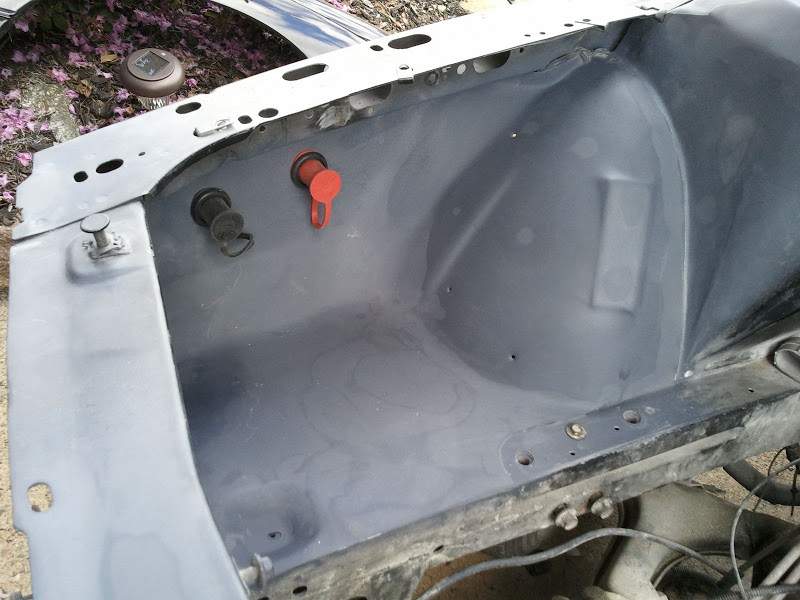

I'm going to get in touch with my painter buddy and figure out when he can come by and spray the bay. I still have some prep left but it's not much.

I'm going to go with the same black as the outside for the bay. (black onyx 202)

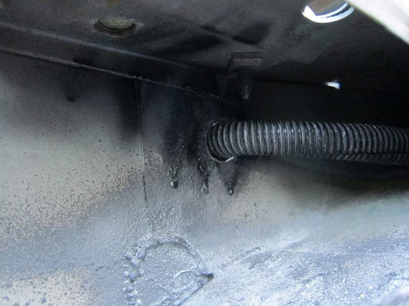

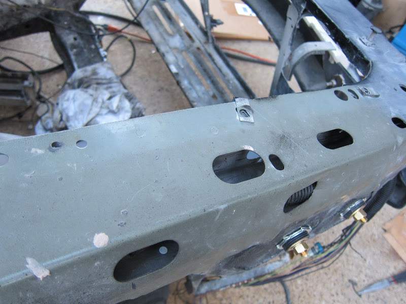

Last night I ordered all the rest of the stuff to redo all the brake lines in Cunifer and to do all the re-routing.
There are 3 lines that have to get from the master cylinder to the ABS distro. I'm running them from the MC, through the unibody behind the strut tower, and through or outside the unibody rail that goes over the wheel well to where I relocated the ABS distro.
I'm using grommets where the 3/16ths lines go through the unibody on the drivers side. And I got a -8 AN 90* bulkhead with 1/2" barb adapters to run the rubber, non pressurized, ABS reserve line through the unibody. I have cushion clamps to mount all this too.
I was able to get a whole firewall grommet set for $20 on ebay and I'll be using those for the electrical going through the unibody as well.

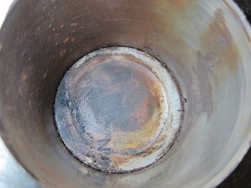

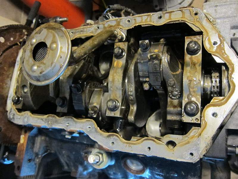

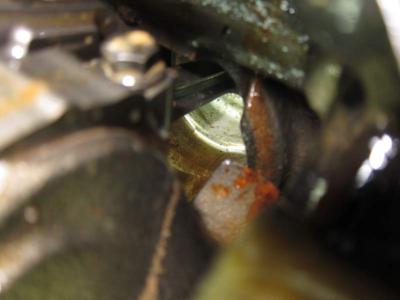

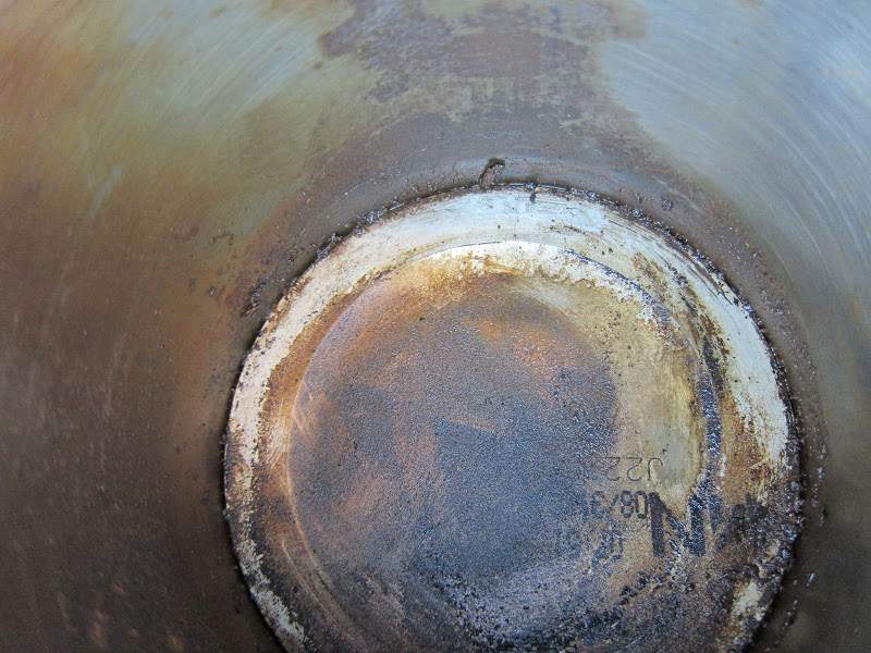

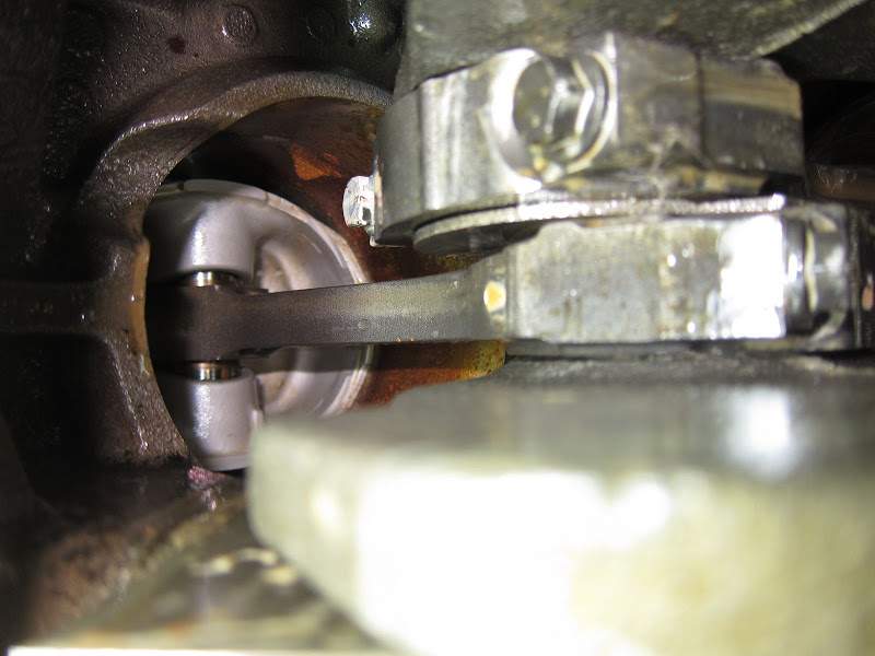

Did the heater core, got further with the wiring, had painter buddy come over to talk about when he can paint the bay(hopefully this week), degreased and cleaned everything in the bay that will be sprayed, , picked up the anodized stuff, stripped down the spare engine on the stand only to find rust.. FML. Water obviously got in there sometime within the last 3 years..
I did technically get the engine for free.. When I sold engines for a bit I made a few hundred and got this engine for free. So, it's not a complete loss I guess.
I'm going to give a good machine shop in the area a call and ballpark a couple options.
I may just opt for a new engine.
I probably could just get away with honing the crappy cylinders out but that just seems halfas to me.
The machine shop wanted 1200 to rebuild the short block.. so new engine it is. I found one with the same mileage (17k) on ebay and bought it.
