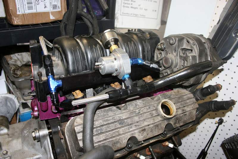

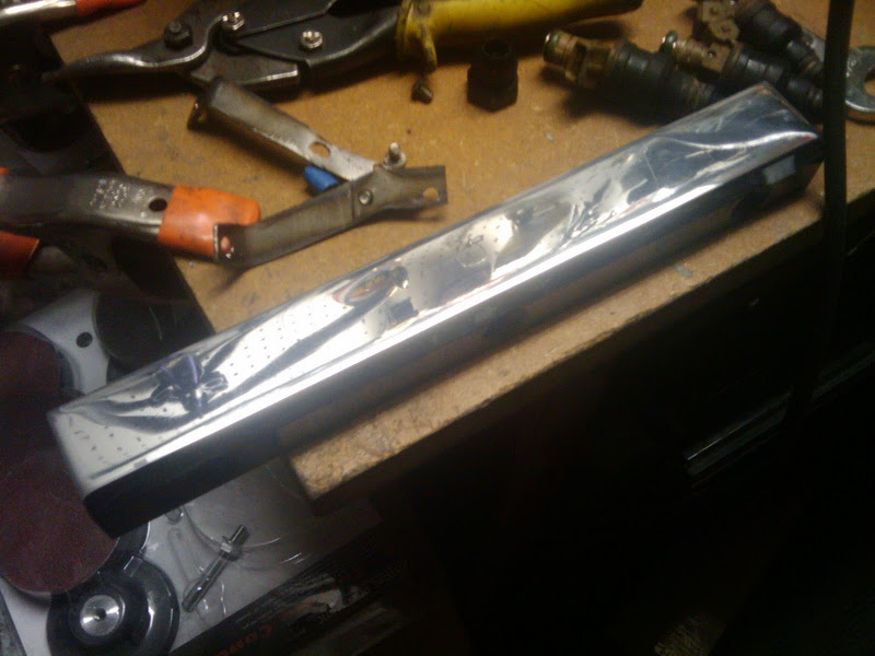

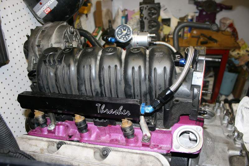

Anodizing the fuel fittings is something I would like to happen while I'm away. So, I started with that. I wanted to get rid of the 'Thrasher' on the front fuel rail before I sent it out. So, I grinded it down, did 180 to 1500 grit, then polished the front face so there are no sanding marks when it gets anodized.
That's all ready in a box. Now, I just have to figure out where it's going.
The rails are for an L67. (injectors are in the heads) So I had to make the legs and FPR mounting.
(sorry that's as far as that's getting polished)
Anything blue fittings will be black to match the rest, and the rails will be purple.

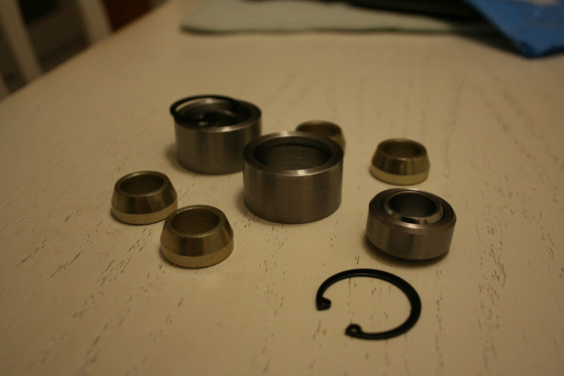

And while I'm on travel I'll make sure to have everything I need to draft the strut top mount in CAD. The top bearings, carriers, and spacers came in.

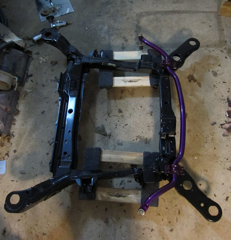

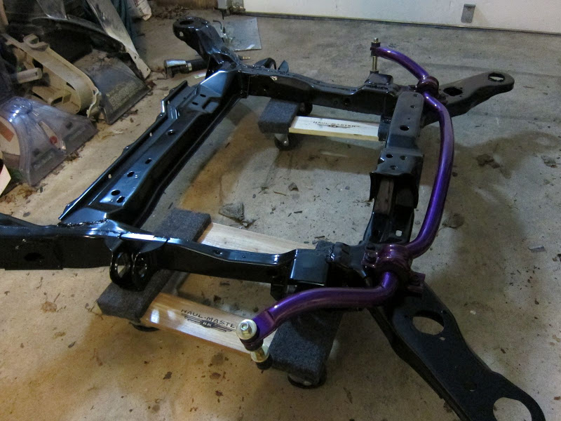

Got a subframe for $25 this morning and dropped it off and the powdercoater's along with: trans side pan, sway, sway brackets, header brackets, FPR/alt bracket, and my valve covers and alt to have un-cleared (they oxidized underneath).
The subframe will be satin black along with the FPR/alt bracket.
Sway and sway brackets will be dormant purple, same as current scheme.
And header brackets will be a textured black to match the headers.

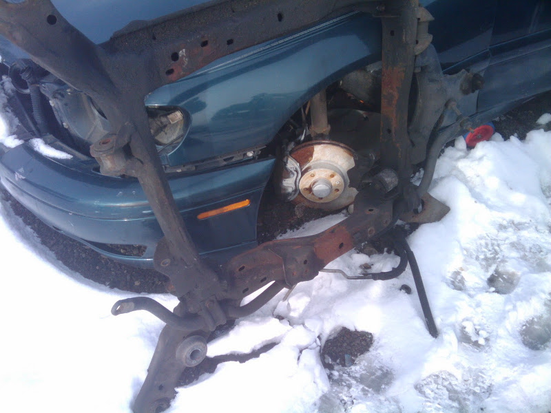

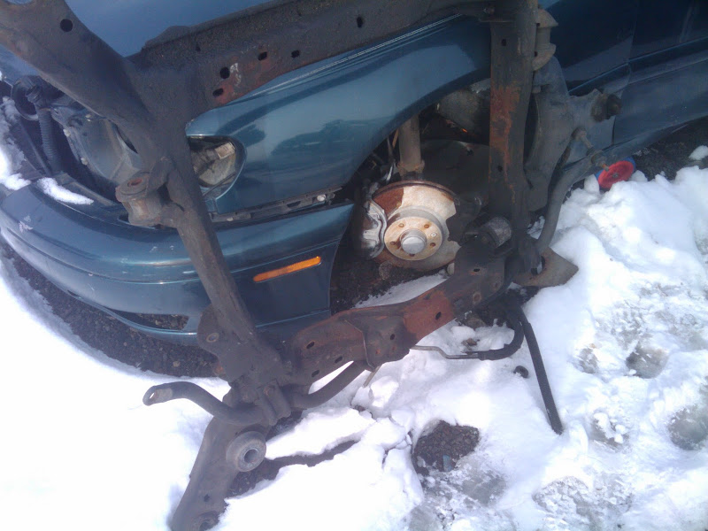

It doesn't get luckier than this.. This is how I found the subframe. I just had to take off the sway, FR control arm, bushings, and seperate it.

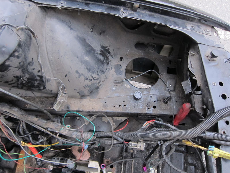

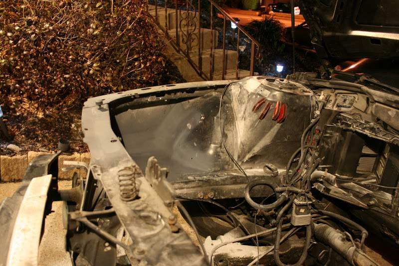

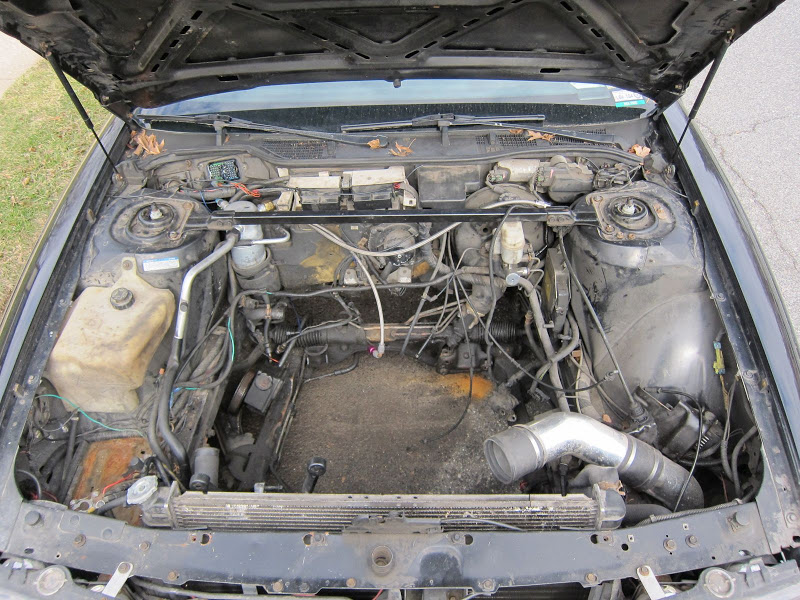

I'm finally making some headway.

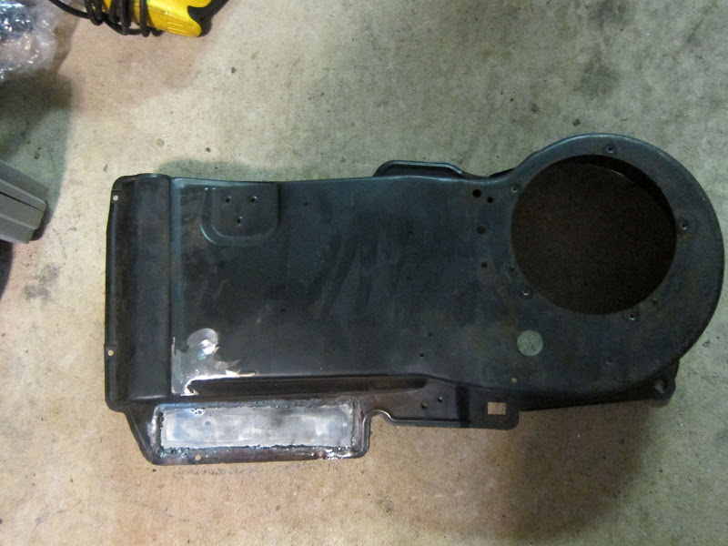

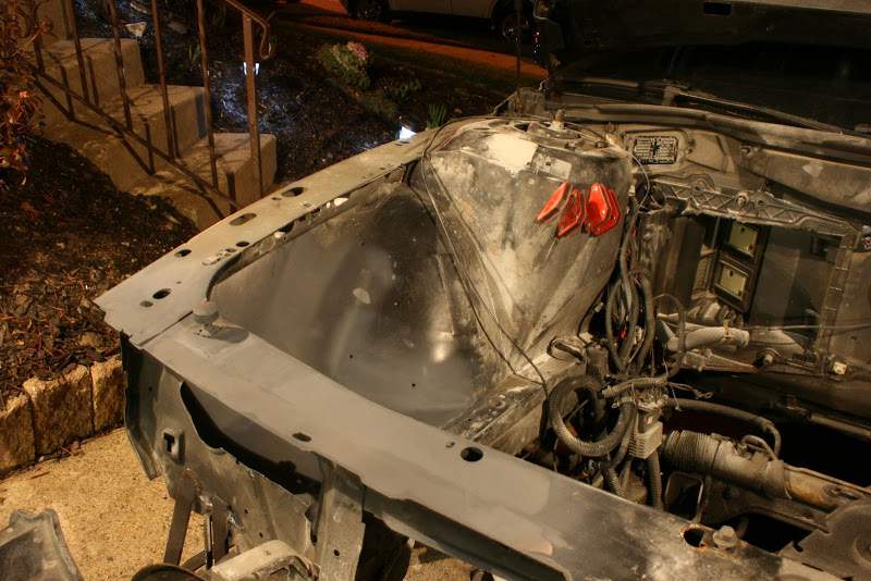

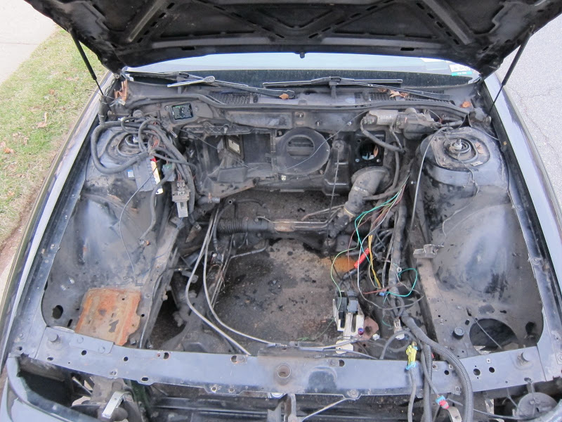

I stripped the bay, picked up most of the stuff from the powder coater, got the car off the street, fixed the blower motor housing where it had rusted through, and got some obligatory in the engine bay pics.
I've been thinking about a solution to the cracked firewall plastic.. I broke off all of the old plastic and insulation when I was stripping the bay and realized that the bare blower motor housing, if cleaned up, would look just fine. I'm going to give it to the powder coater and have it ceramic coated. That will be simple enough to keep a lot of the heat out and make it look good. I'm also going to give them my STB to have done in purple and probably other things as I go.
My electric water pump is boxed up and ready to be sent out for a rebuild, I've got 8 S1 L67 injectors boxed up and ready to be cleaned/tested, and the parts I need anodized ready to go as well.

Ordered: ACDelco rack/bushings/power steering lines/blower motor/booster/proportioning valves/00+ tie rods. Delphi heater core. All oem subframe bushings/caps/spacers/bolts. 20' of red and black 4 gauge wire, remote terminals.
I have the entire body harness from my old car and I'll be using it to extend and relocate some of the engine bay harnesses. The fenders are coming off and the routing will be moved out there held high with coushin clamps.
The next stage is the cut and weld part of the project. I'll be filling holes, fixing rust, making clearance for things, etc.
Other major hit items are the bodywork associated with the cutting and welding, the wiring, and cunifer brake lines.

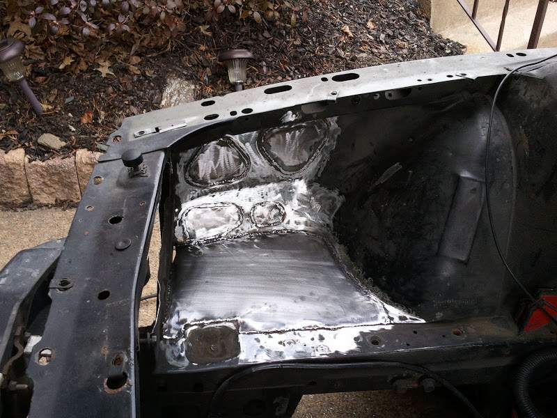

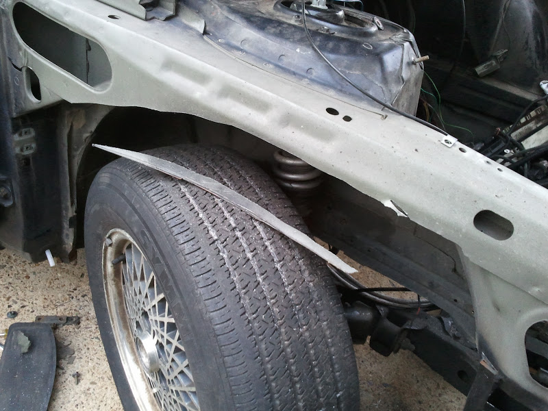

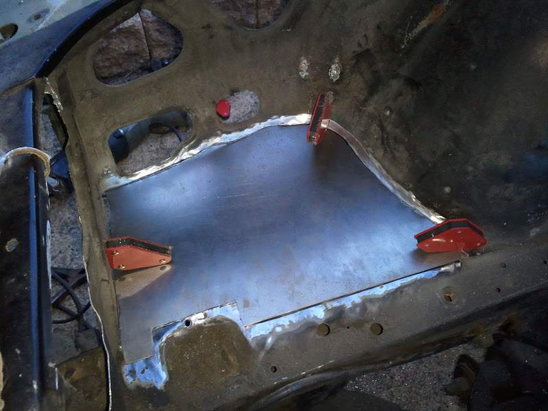

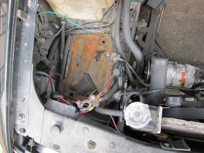

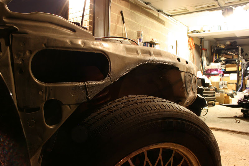

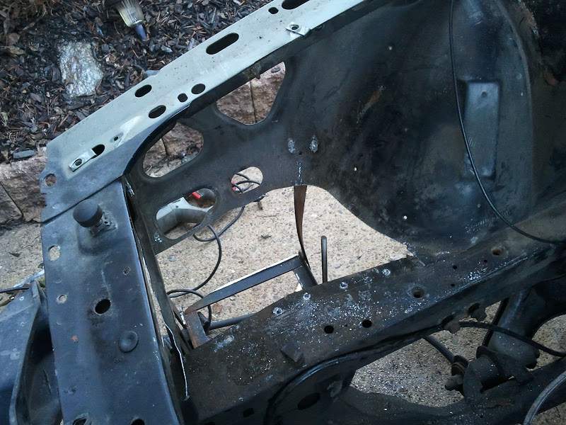

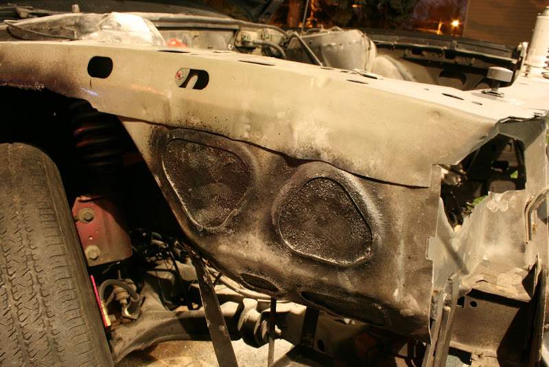

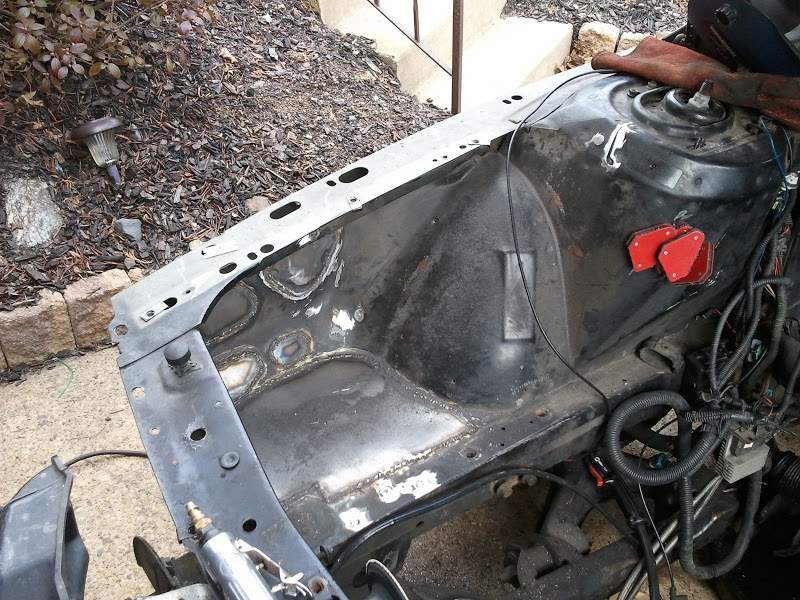

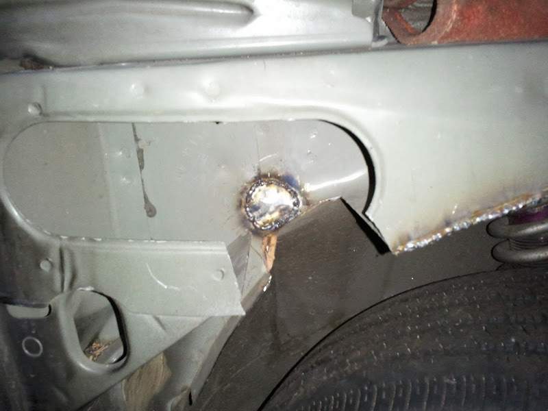

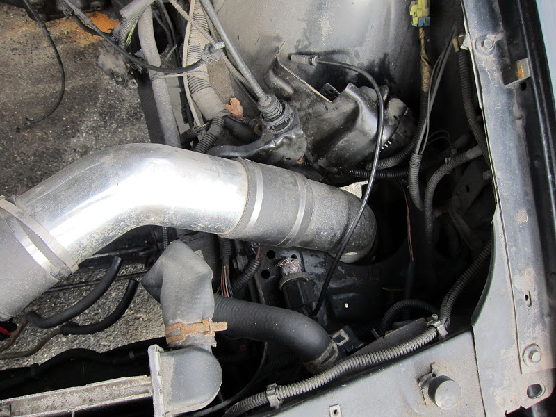

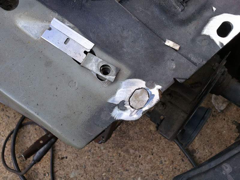

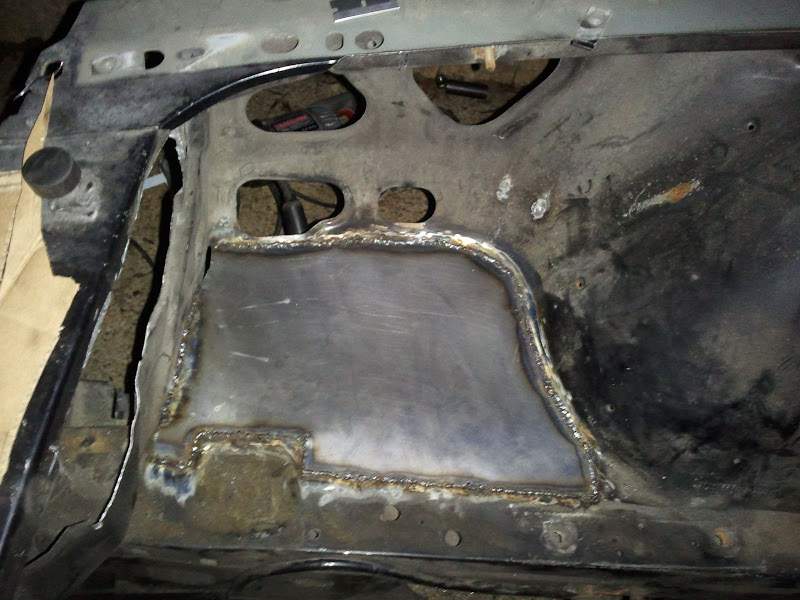

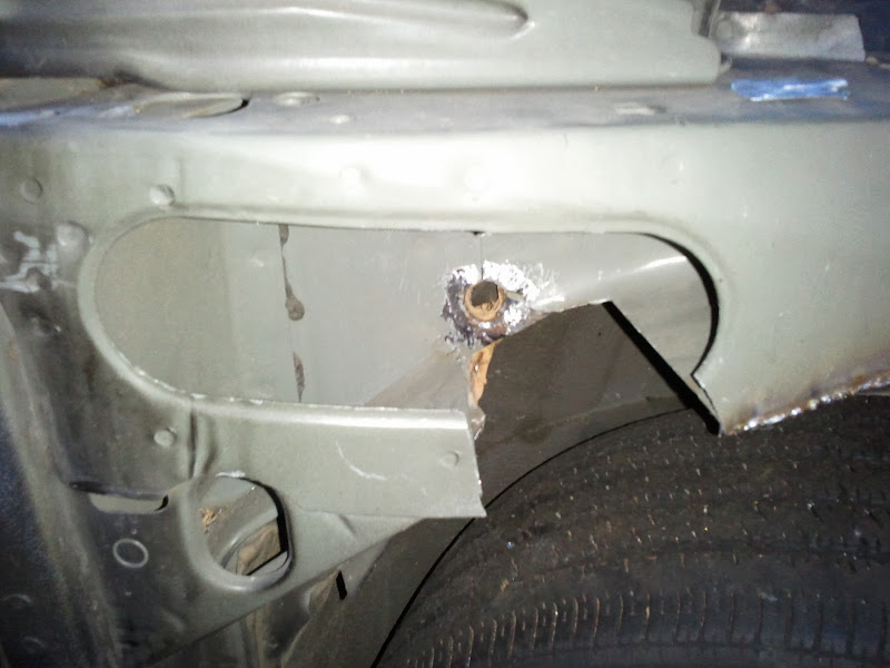

On the passenger side:

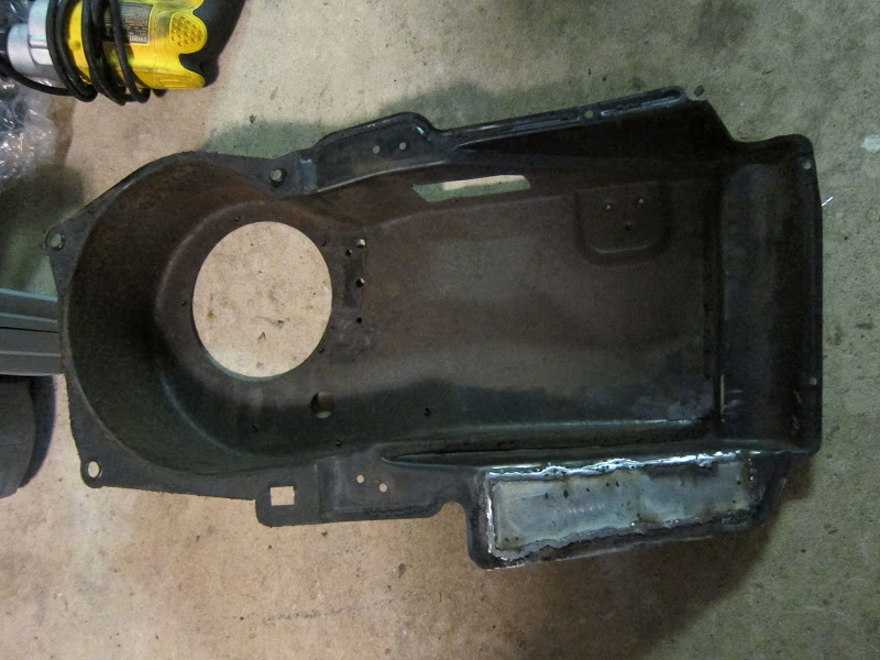

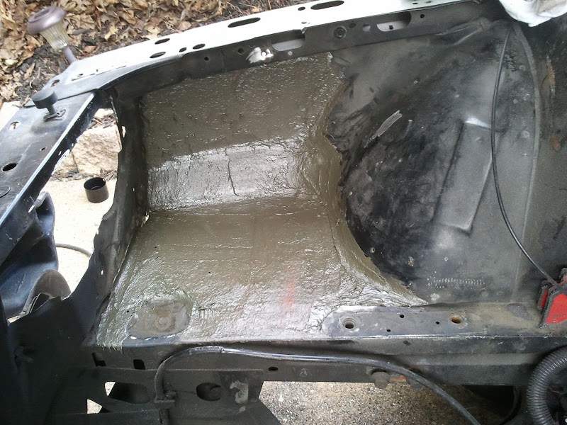

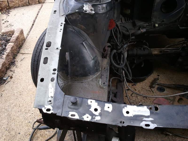

Cut and moved the battery relocation tray up a bit since it was hitting the bumper a little

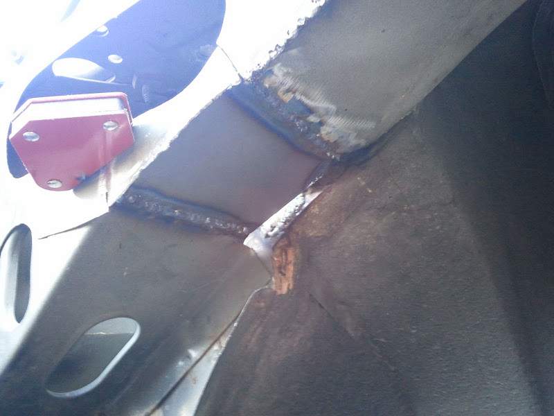

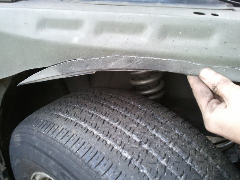

Cut out the pinched seam above tire that keeps me from getting lower and welded it up

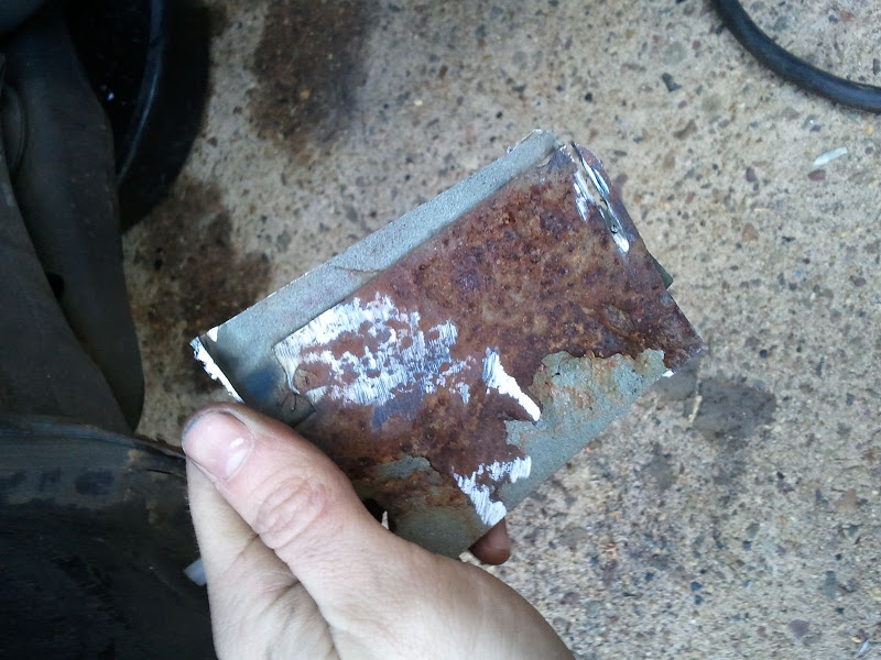

Cut out some rust and repaired

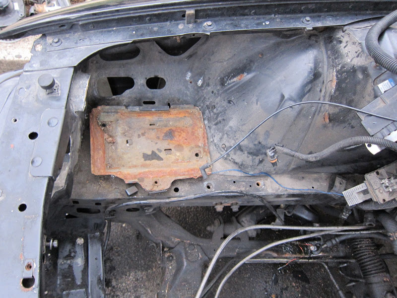

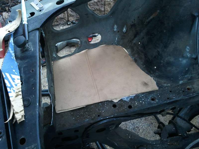

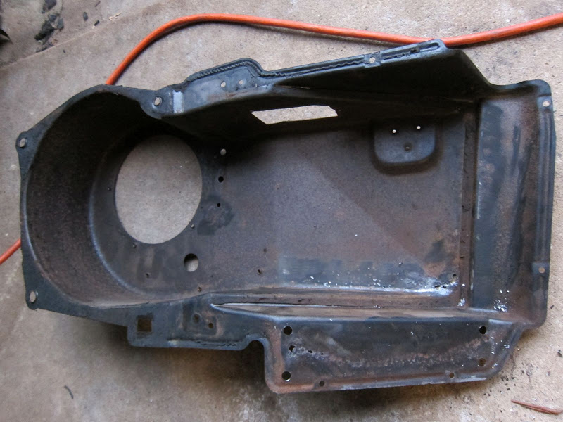

Cut the whole battery tray sheet metal out since it was a mess, welded in new

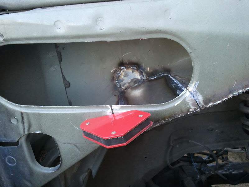

Welded in 4 major holes near battery tray plus a few smaller ones
Welded in half of the rad support holes
Kitty haired the whole battery area and sanded (ready for muddin)
Mudded the rad support
Undercoated the new battery tray metal, welded seam, rust repair
I still have a shiton of sanding left on the passenger side but I threw some rattle can primer on there to keep the bare metal covered. Water can get through but it's better than nothing.
This + the wiring will be the most labor/time intensive parts of the build. How I have the patience for this.. dunno.
Pics:

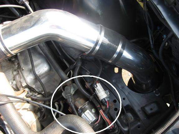

Now I have a question for you guys..

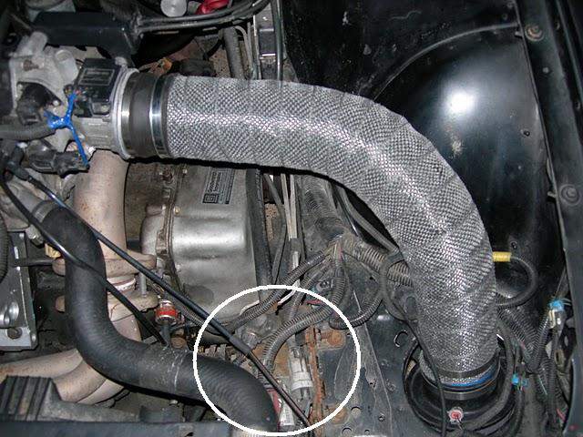

Should I try and tuck the ABS distribution block?
If I do, I'll loose the ability to run a FWI and have to run an open cone in the bay.
I could do something like this to make up for it a little bit:
http://www.rs-quattro.de/treffenoster07/N%...0Bild%20012.jpg
(and it would undoubtedly look less crappy since I have quad headlights)
Insane. Simply insane.
The ABS tuck...just curious, why not make a simple panel to hide it? So you can keep your intake setup the same.
That is another option. But whenever I see those panels I know right away that that person took the easy way out.
I doubt that. The idea of hacking away at my headlight, and leaving a big opening into the engine bay...meh, sounds like it would just lead to some sort of issue.
Looks great and those magnets look like they help a ton.
