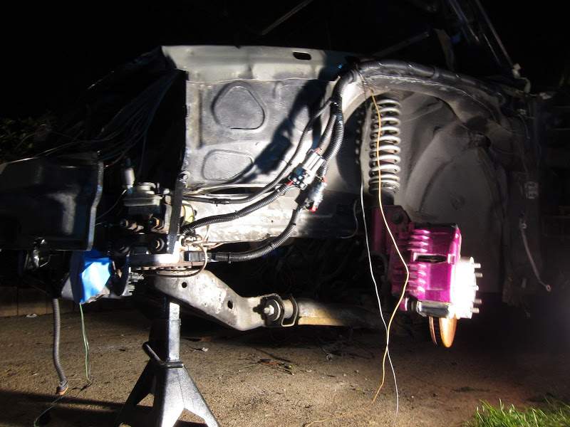

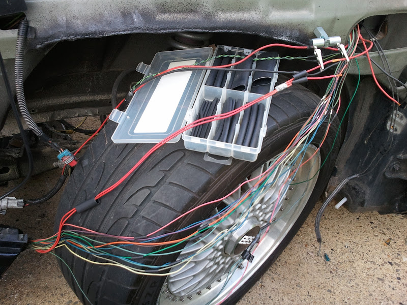

I got out of work a little early today and made some progress with the car.

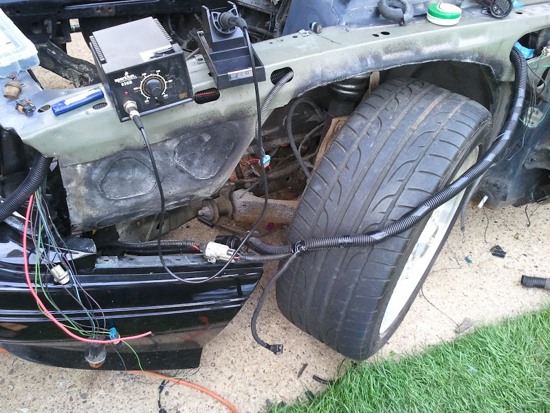

All the ABS and drivers side headlight wiring is extended and loomed. I'm running the ABS wiring outside the unibody with cushion clamps..
Mounted the drivers side horn.
Lost the IAT sensor wires.. lol. I'll find them it just got too dark.

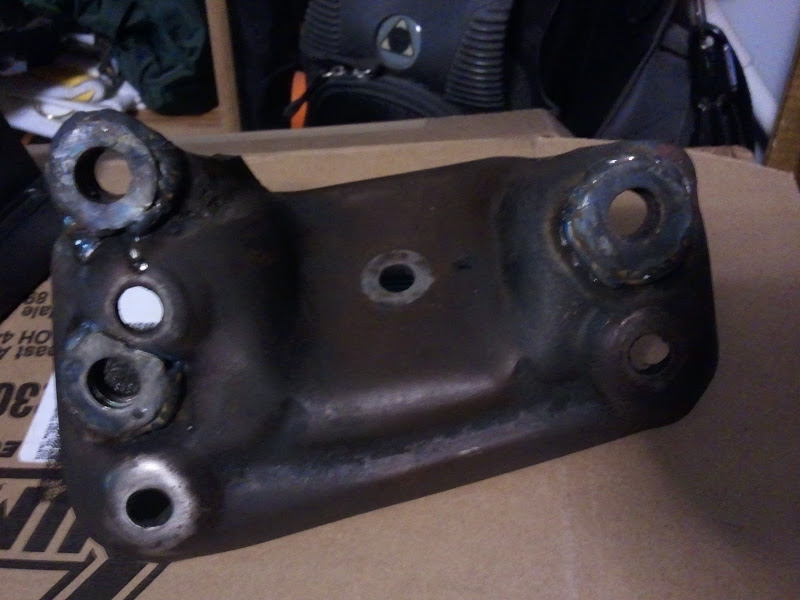

Welded washers to my modified rear trans mount plate. I had the washers there before but just sandwiched in.

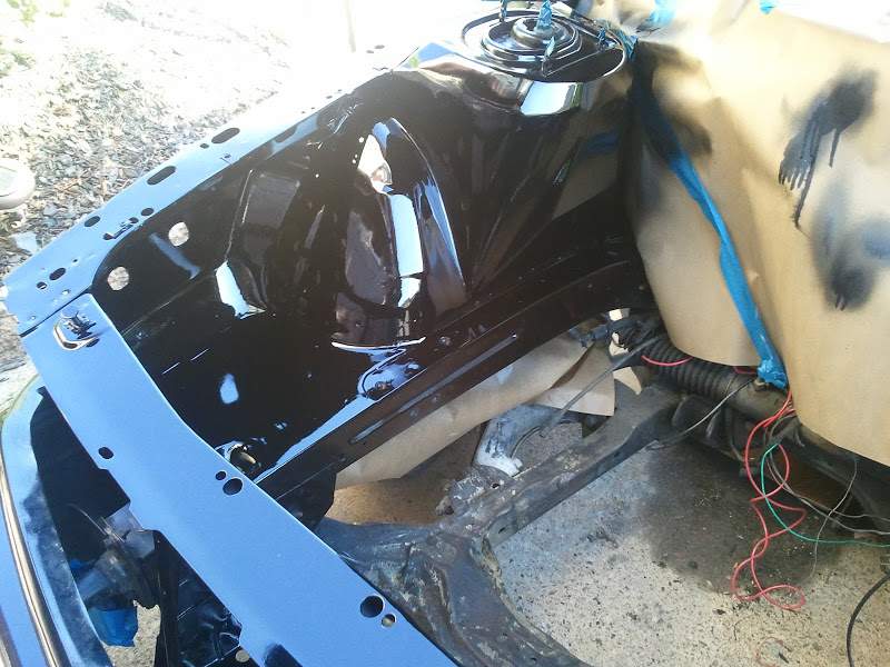

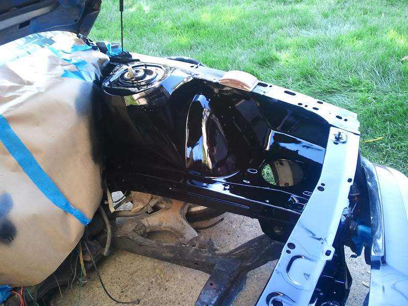

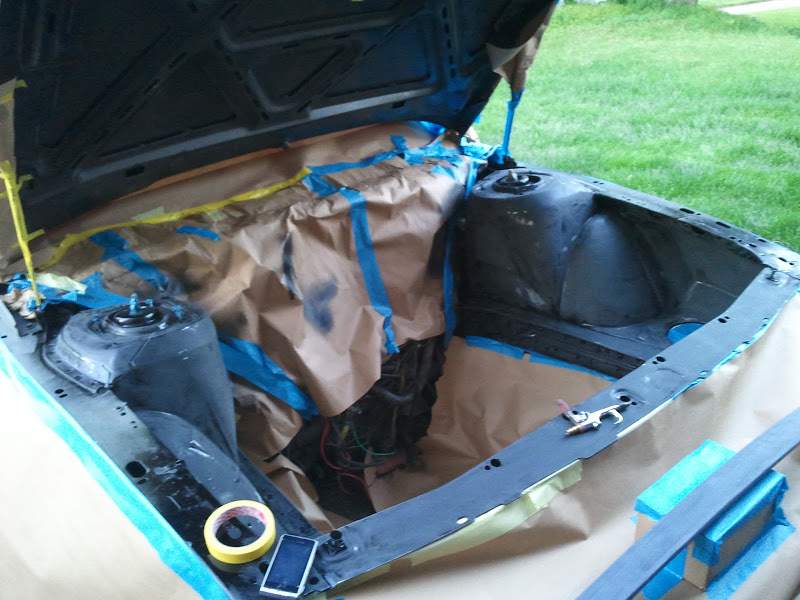

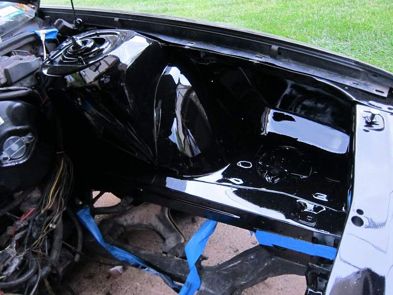

And a twist of luck had my buddy available to paint the bay.
So, the bay is painted!
The drivers side does have a couple runs that need to be fixed though. In his defense, a cold car sucks for runs.. And there's a little bit of dirt from it being sprayed outside in my driveway. Either way though.. I'm siked on it.

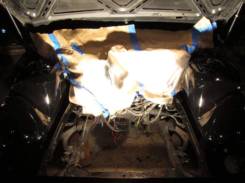

I found a couple more runs this morning. :D
Weather permitting, my buddy will come buy next week to fix the major offenders.
Quick pics I snapped on my way out the door this morning:
Nice, it's getting there ! :D
Veddy noice.
:D :FULL OF WIN !: :)

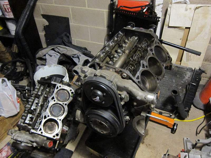

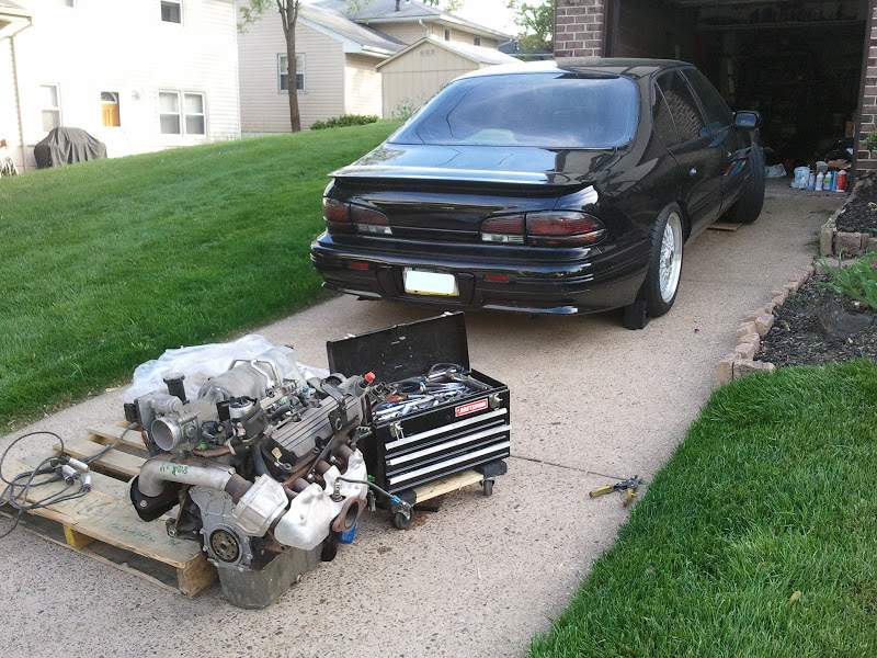

The new engine came Friday. I took everything heads up off, wheeled it up into my garage and put it on the stand.

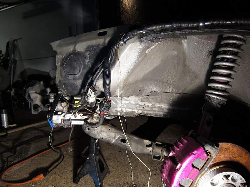

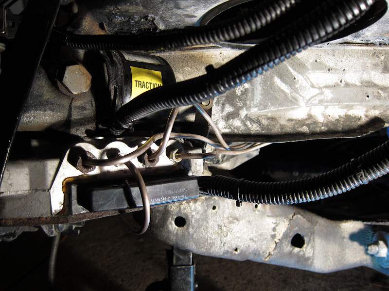

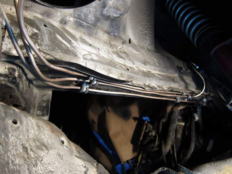

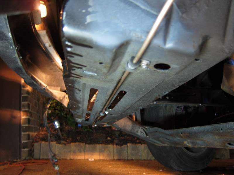

I ran the (cunifer) brake lines from the ABS distro to all 4 corners with new proportioning valves in the rear. I didn't do one section that goes across the rear of the car from the proportioning valve to the passenger side rear wheel. It’s 3 years old and a huge PITA in a slanted driveway. I'll bang it out on a lift eventually.
The Kent-Moore J-45405 flaring kit I picked up not too long ago and used to do the lines is beyond ballin. I'm real happy I got it.
I still have to run the 1 soft and two hard lines from the distro up to the master cylinder. This will come after the paint redo so I can mount the new booster and after I repolish and seal the master.
Those 3 lines are the only ones you'll see in the engine bay coming from behind the drivers strut tower to the master. I hid all the other ones.
The ABS electrical is cushion clamped up out of the way and the connectors all reach without issue.

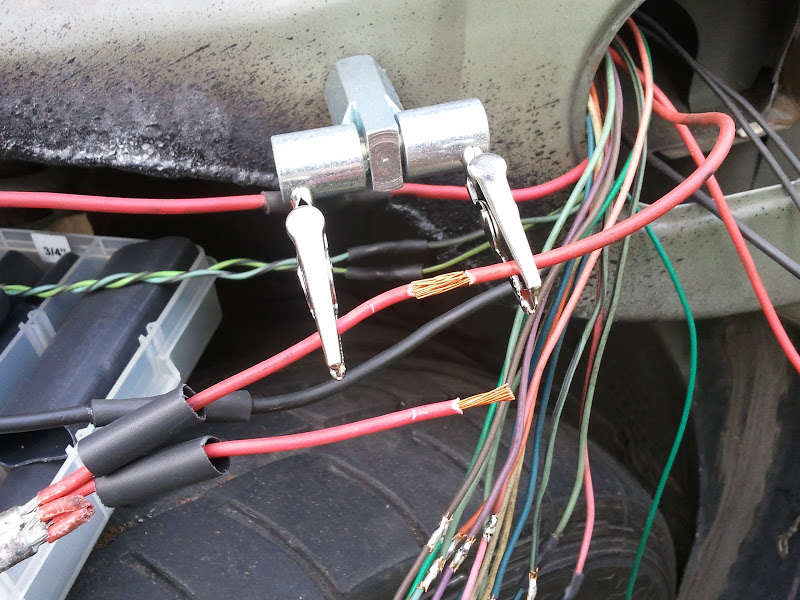

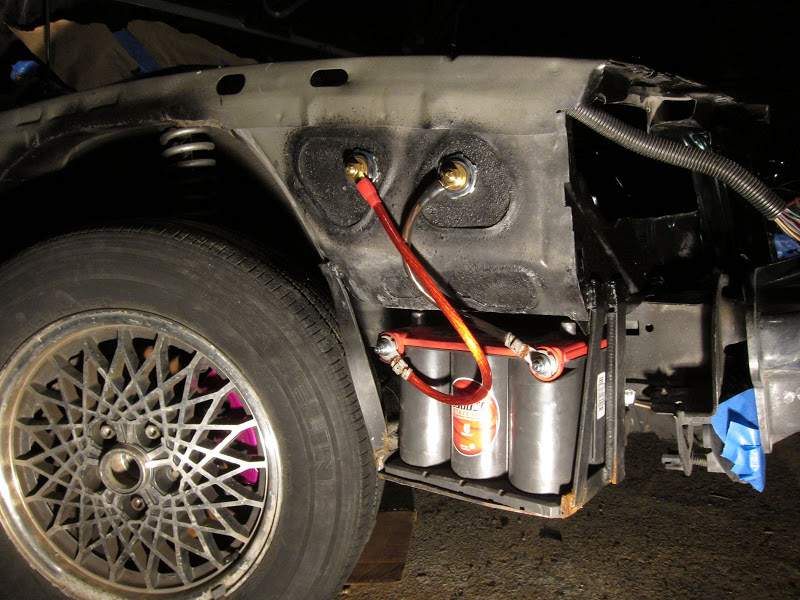

I made the jumper cables form the battery to the terminals. I have the rubber covers for the battery side, they're just not on yet.
Those remote battery terminals are awesome! If you don't mind sharing, where'd you get them? After a recent attempt to boost a friend's car we discovered that it actually isn't possible to boost another car with my GP due to the battery terminal placement. I'm starting to think about making a simple mount for a set of remote terminals so that I can give a boost if needed.

The terminals I got off of ebay. Just search remote battery terminals.
Very nice to see this come along. Very interesting placement for the battery, an A for utilizing space lol.
Looks like the engine is in alright shape

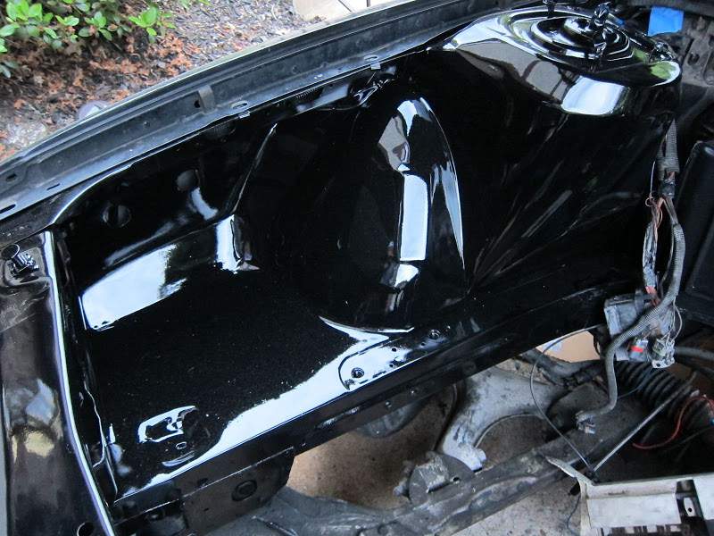

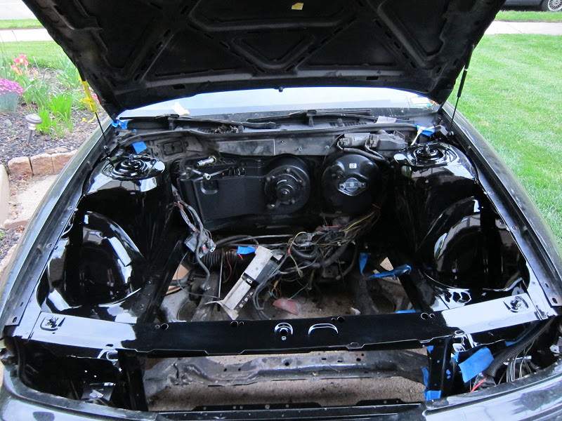

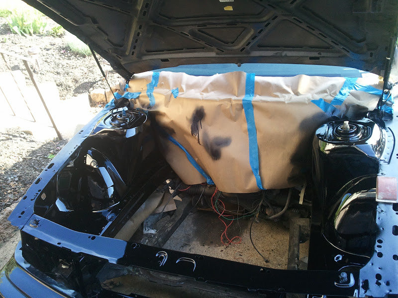

I got the bay repainted Wednesday. It came out a lot better. There are no runs but there are a couple spots where condensation from the gun/hose connection sprayed water and made tiny bubbles. Those spots are going to get buffed out later.
I got the booster, evaporator, ceramic coated HVAC box, blower motor, resistor in after work today.
The bay is already dirty in the pics.. yay pollen.
:lol:
Darn pollen. This is where having a white car comes in handy, it hides the stuff. :D
