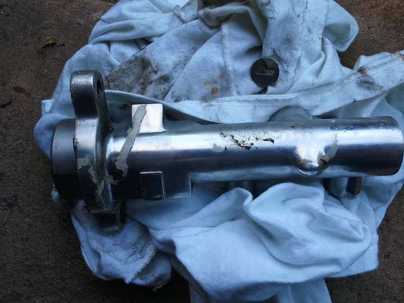

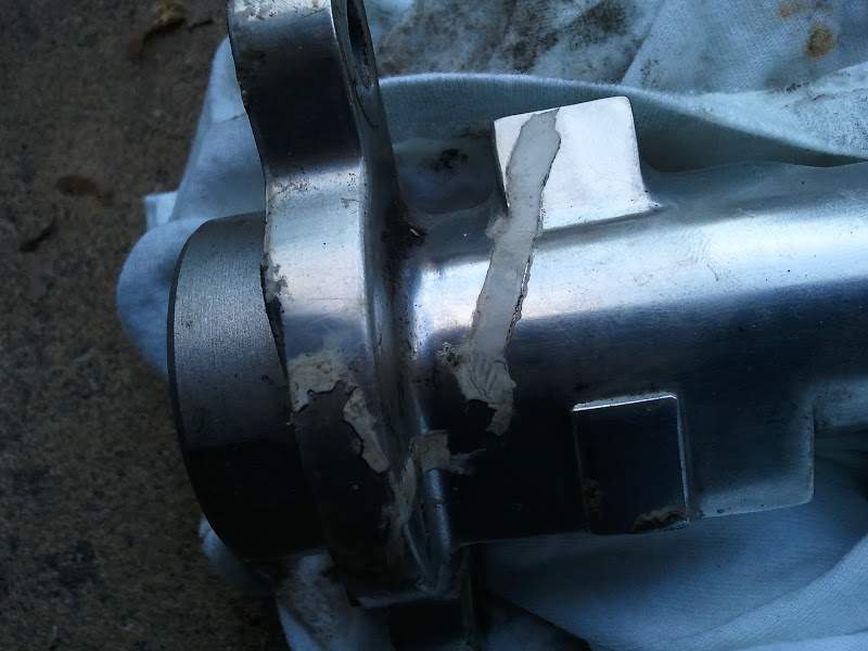

-Repolished the master cylinder and shine/sealed it. The original issue with it was I had it powdercoated clear, got brake fluid on it without realizing it and it effed up the powdercoat. I stripped it a couple weeks ago and it's been staring me down ever since.. It wasn't as bad as I thought it was going to be I only had to hit a couple areas with sand paper.

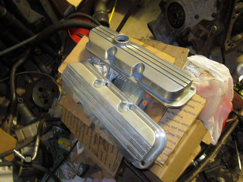

-Started to repolish the valve covers I had stripped chemically because of oxidation under the clear and realized they're oxidized much more than I thought.. I found out I have to take the covers and the alt down to 220 grit and work my back up.. FML.. I got the one cover down to 220, thought about blowing up the world and moved on to something else for the time being.

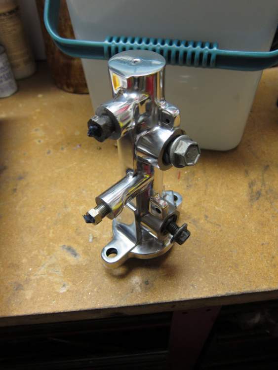

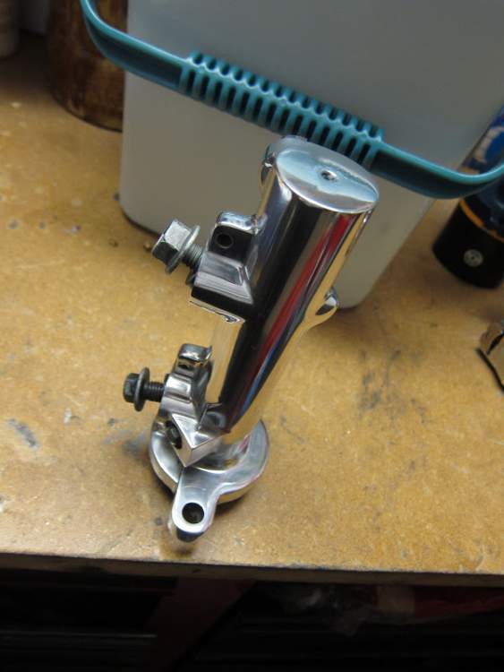

-Shine/Sealed the tensioner assembly which was easy since it was clean and never coated before.

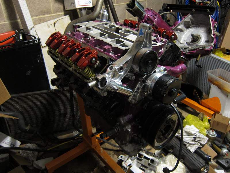

-Threw the 1.6 RRs, polished thermo housing, and tensioner assembly on the engine. I still have to check the preload though.
That ATI balancer does not want to go on easy at all.. It kind of has me worried about using it. I'm not even sure what puller to use if it gets stuck.
I should have the front suspension back together this weekend and hopefully by next weekend the engine/trans will be ready go in. There will still be a bunch of misc crap after they go in though.. so that's not the end of the road.

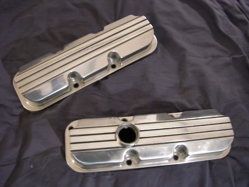

The VCs will be polished again.
Here's a pic of them before they got messed up:

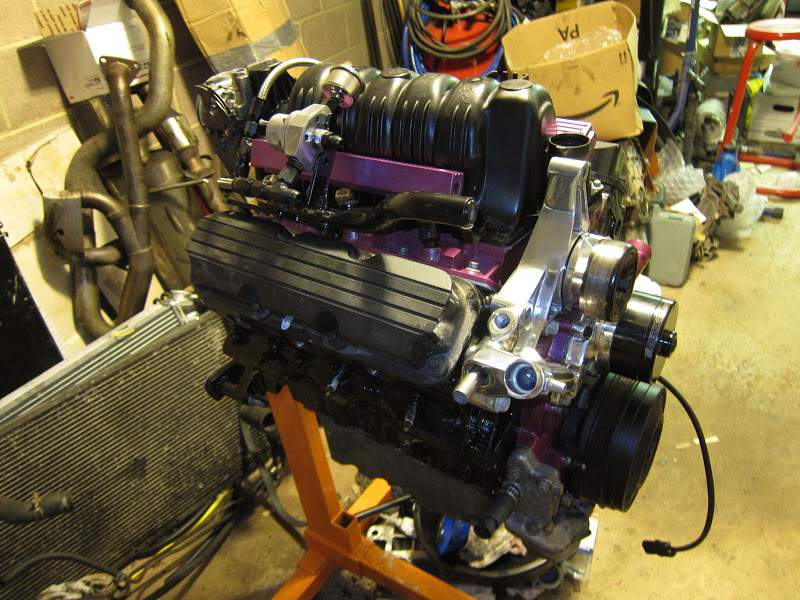

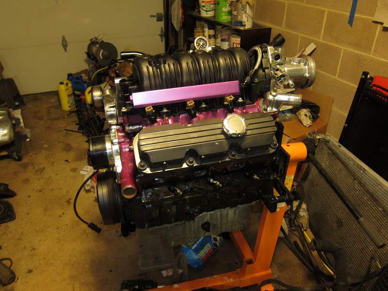

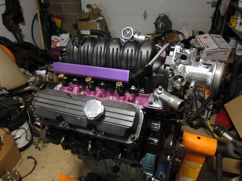

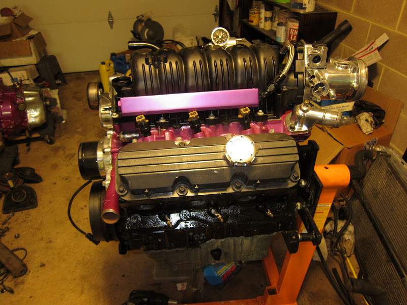

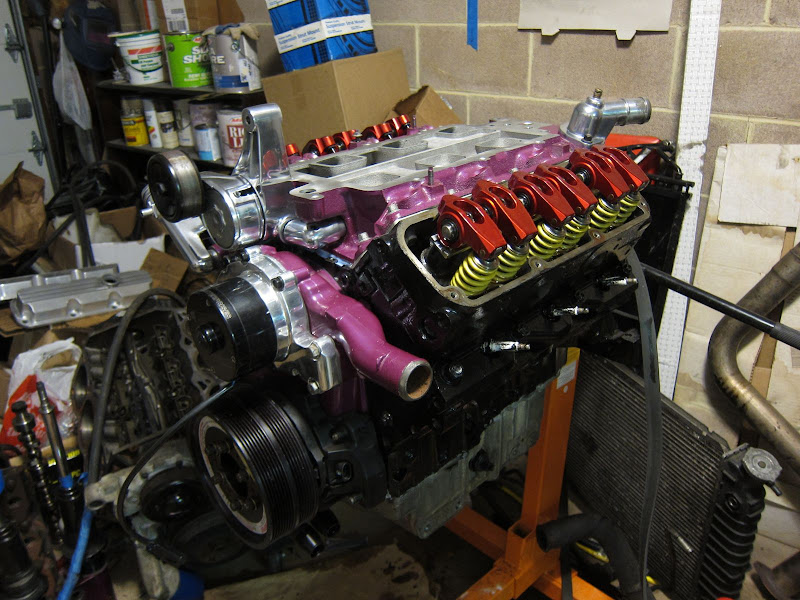

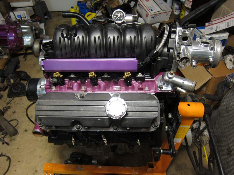

I squeezed in a couple things after work and the engine is starting to look more complete:
The aluminum valve covers and alt are getting sent out to be repolished and I'm having the alt and p/s pullys chromed. Polishing these things once was once too many.
I decided to just go with the stock balancer for now since it seems like it wants to go on a lot easier than the ATI.
And I'm waiting for the fuel rail legs to dry.. So, I will have something holding the rails down.
