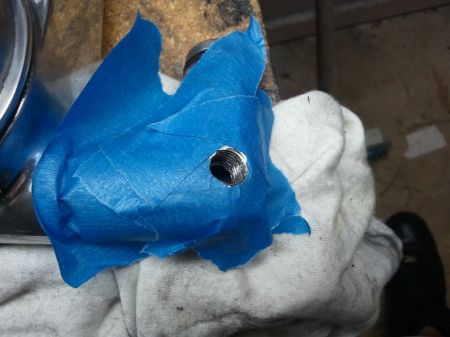

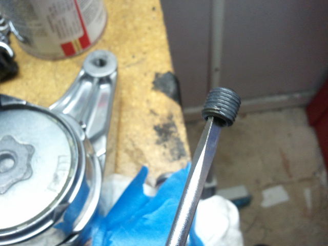

I got back and figured out the leaking fuel rail was a two part problem. 1. The sealant 2. When I re anodized the pipe plugs it shrank them. Anodization permeates the outer layer of aluminum and the only way to get it off is to chemically strip it, taking that outer layer. This resulted in the plugs sitting deeper in the tapered thread and not sealing correctly. As of right now, it's not leaking with permatex form-a-gasket and new stainless plugs.

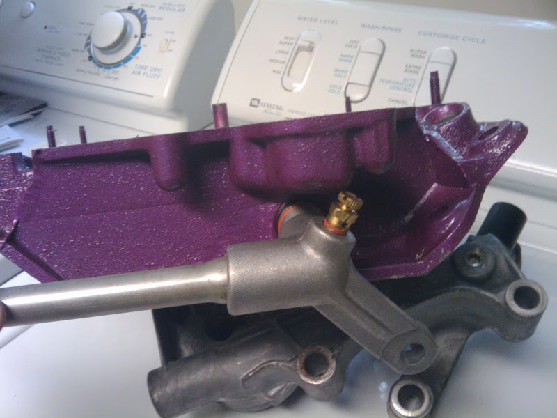

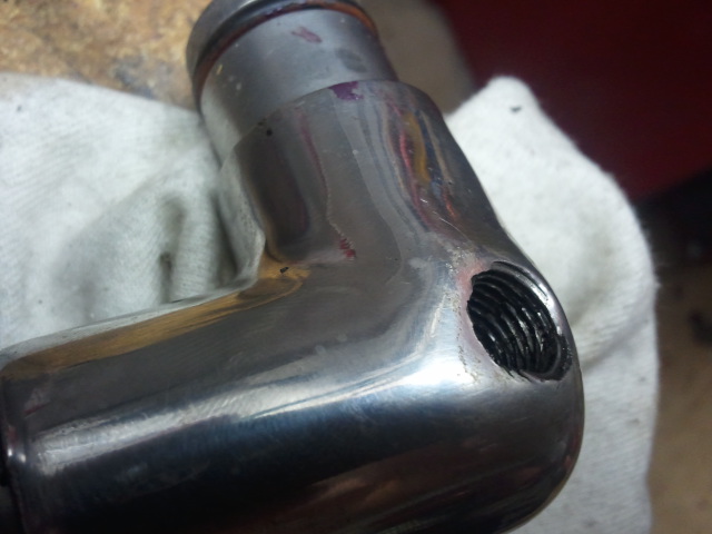

I found another leak with the Aussie Ecotec (our series II) coolant elbow I'm using. It's aluminum vs. nylon which is why I used it but takes a bit of adapting. Part of the adapting is it originally had a bleeder and a little dog leg for mounting which doesn't fit. I grinded the leg off and put a pipe thread plug where the bleeder was.
That plug was leaking. The PTFE I used didn't hold, form-a-gasket didn't work, so I moved onto a pipe thread joint compound which expands when it cures. It even says corrects for mismatched thread. I looked at the theads and they are a little jacked up. I'm not sure when/how that happened. I cleaned the threads as best I could and applied the compound last night. It takes 24hrs to cure.
With the fuel leak, it almost starting stripping the rear LIM paint but quickly diluted it with water, and after that and removing and reinstalling the tensioner assembly, I'm sure I ruined the clear sealant on it. So I have to reseal that. Hopefully I get that in today.

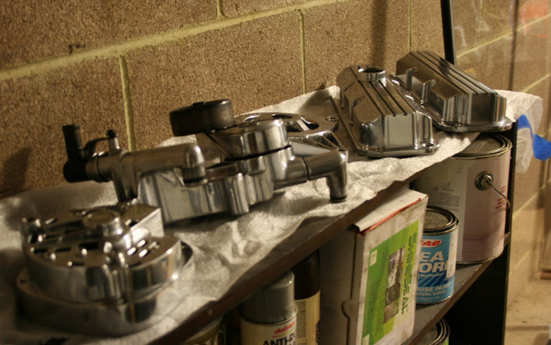

Tuesday I repolished the tensioner assembly and got through 2 out of 3 steps on the shine/seal for it and the remainder of the polished stuffs.

-Slick finished (step 3 to sealing) the tensioner assembly and installed.
The crazy witch doctor thread sealant is holding in the coolant elbow plug at the moment

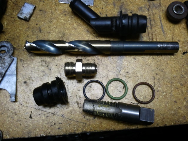

So.. I ran my compressor down to 10 psi, hose clamped a bag to the TB and ran pressure into a VAC port. The booster line fitting was leaking.. Its a L26 (3800 Sereis 3 with aluminum upper intake manifold) fitting since it doesn't have a vac nipple up top like the L36 (Series 2 with nylon upper). The L36 one doesn't fit with the fuel rail. I had a L36 booster line fitting that I cut just before the vac nipple for some reason at some point, so I put a bolt in it with a rubber vac cap, and put that in the UIM to pressure test again, it fit more snug and there was no more leaking noise. These parts look identical too which is strange. I got the calipers out and measured on either side of the o-ring and the o-ring groove. The L26 fitting was ~0.3mm smaller in those 3 areas and the o-ring more easily compressed and slightly skinnier. So, I made a new fitting out of the cut old L36 one by drill/tapping it and putting a NPT to -6AN fitting I had laying around, then hose clamped the booter line to that. This was Friday..

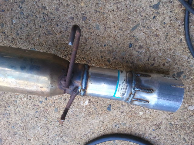

I did a temp hook up on the exhaust today. The parts store didn't have a 3" to 2.5" so I made my own via slits and crimping. Then I just clamped it to the rear header with one of those frozenboost band style clamps. I took some measurements too so when I get parts for the 3" full exhaust, I'll now how much room I'll have left for a res after the flex, cutout and cat.

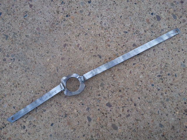

Since I had the welder etc. out, I decided to make a mount for the driver’s side fan. I found a bracket with a hole in it roughly the size of the back of the fan motor, cut that up, added some legs, welded, rounded off the edges, drilled holes, and POR-15'd it. It's taking it's time drying.
I still had a vac leak on start up.. pinched the booster line between the UIM and HVAC nipple, Vac increased from 11" to past 15", pinched HVAC nipple, no change, pinched line right before the booster same 15"+. And I could hear a leak coming from the driver’s side cowl area with my head on the windshield side of the open hood. Checked the check valve too and that was fine. Clean up most of my stuff, stood there looking at my phone (the time, only 5:30) and the car, and drudgingly went back and pulled the brand new ACFailco booster. I'll order another soon.

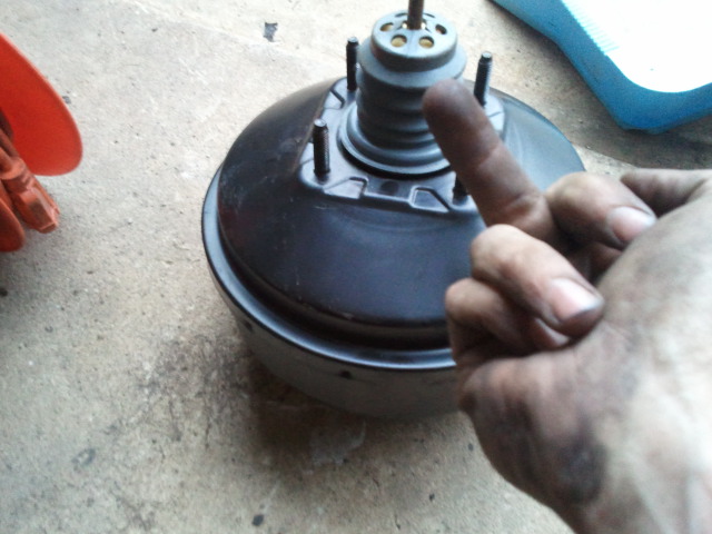

I love the pic of you flipping the bird to the broken part! :blink: We have all been there and done that but never took pics of it! :lol:
ha I was about to ask what that was all about
Lol. Yeah I was upside down in my drvers seat for 20 mins with my head on the floor mat and the front of the seat digging into my upper back.. getting at the 4 nuts for it up under the dash. I needed u joints to get two of the 4 nuts out too.. just a big pita. Flipping it off and taking a pic was the least I could do.
Good news: The new booster is in and I have brakes.
