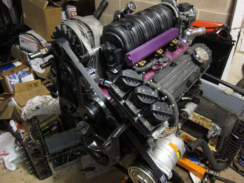

My knock sensors came in yesterday and I put those in. Those were one of 2 things I needed minimum to get the engine and trans in this weekend. As long as I get the flexplate back tomorrow or Friday I should be good to go.

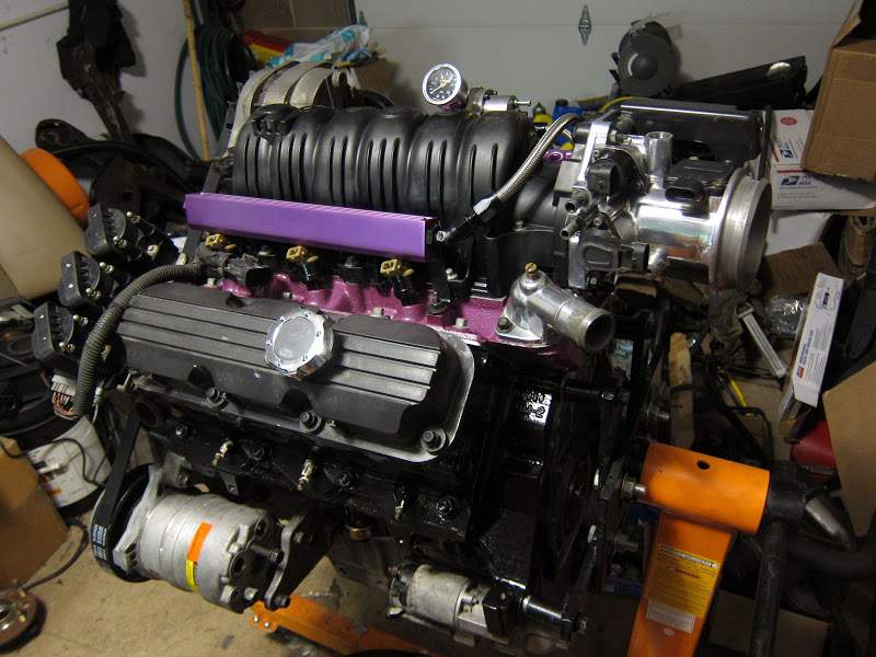

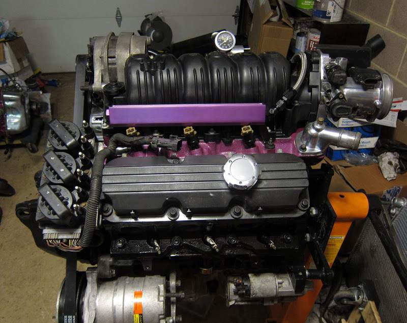

I tightened up the fuel setup with the rail legs and I decided to add one more leg on the rear to make it more solid. You can shake the engine by the rails now.

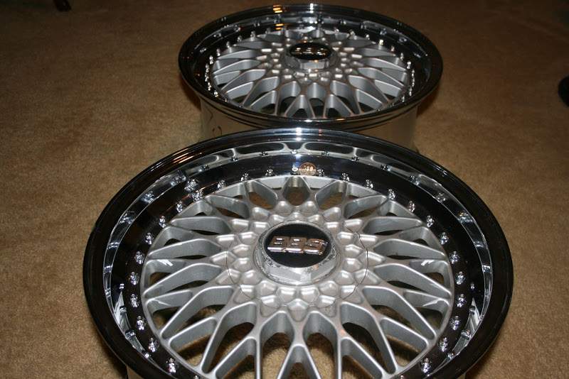

They're the same wheels I have now just wider with a chromed lip.
They're 2-pc so those are the bolts holding it together.

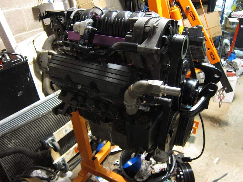

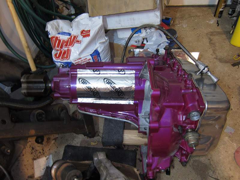

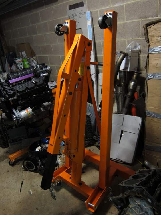

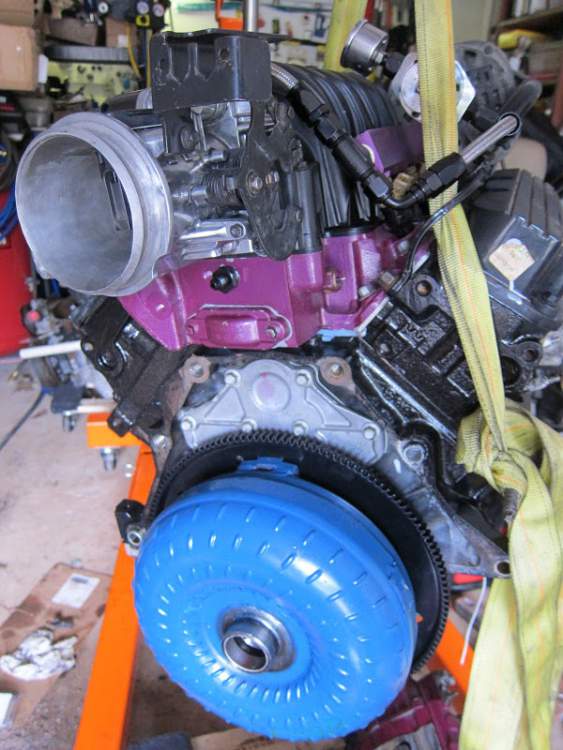

I got done a few more odds and ends with the engine and put the hoist together. I also dynamatted the trans tail shaft just in case.
Keep in mind:
-The alt, p/s pump, and valve covers will all be swapped out when I get them back from polishing/chroming.
-I intend to tuck the engine harness and relocate the coils once I'm sure everything is running correctly.
I'm hoping I'll get the flywheel and caliper tomorrow. If I'm lucky the shorter pushrods will be here by Saturday but the engine will go in either way.
<3 two piece BBS RS wheels.

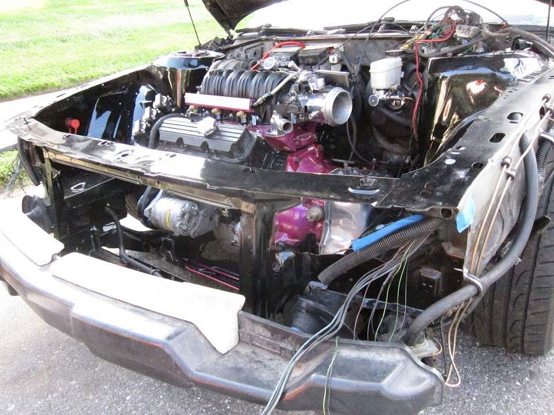

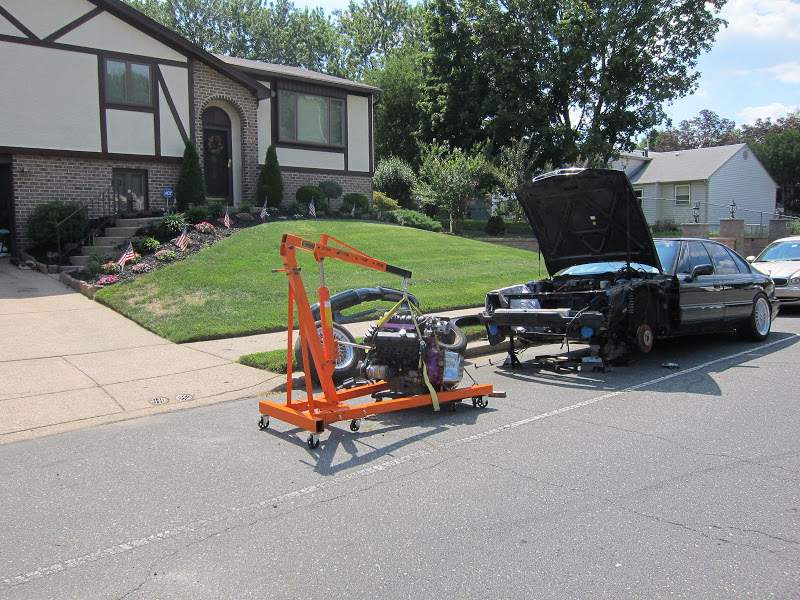

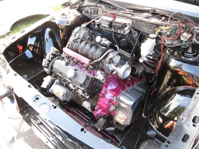

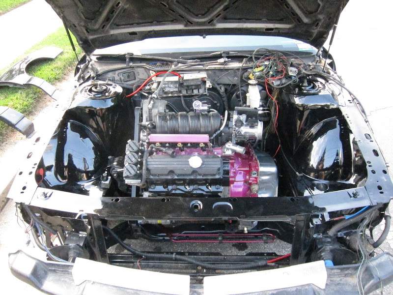

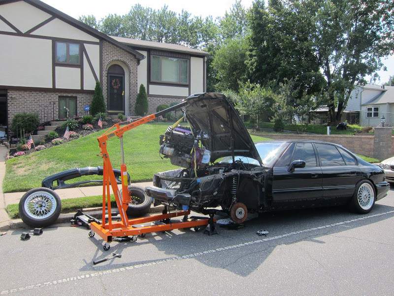

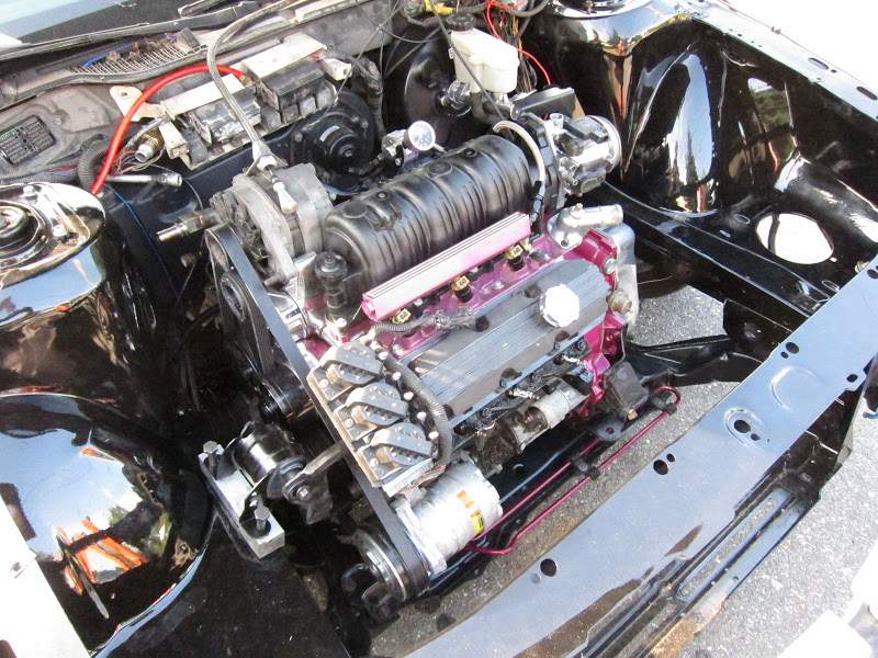

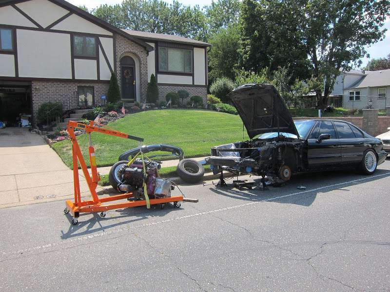

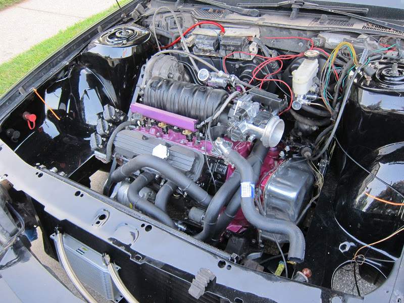

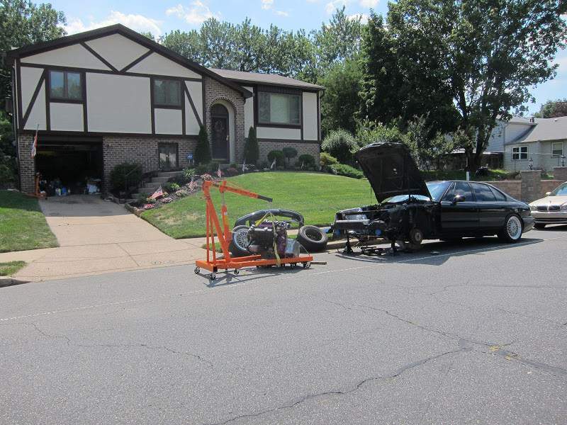

The engine/trans/rear header went in today..
I was solo for the most part. I just had my girlfriend push the engine/trans away from the passenger side unibody when I dropped it in.. She's whatever is more than awesome.
Welcome to Philadelphia...
Lots of misc crap left but this was a biggie.

I'm not only excited for when this baby is up and running smoothly again, but super stoked to see that engine bay with all the tucked wires. Om nom nom.

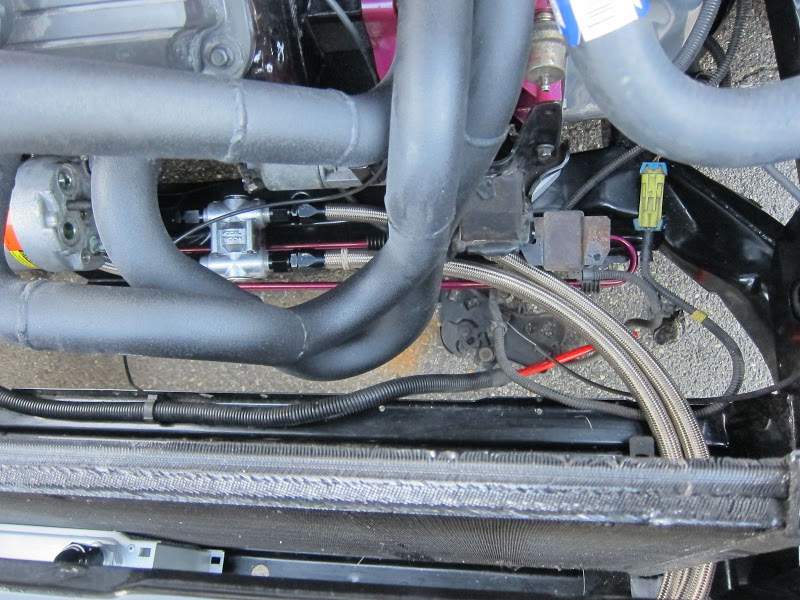

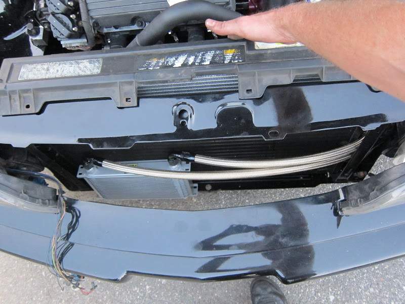

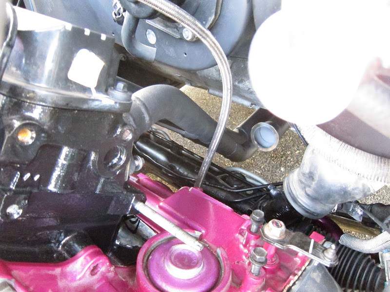

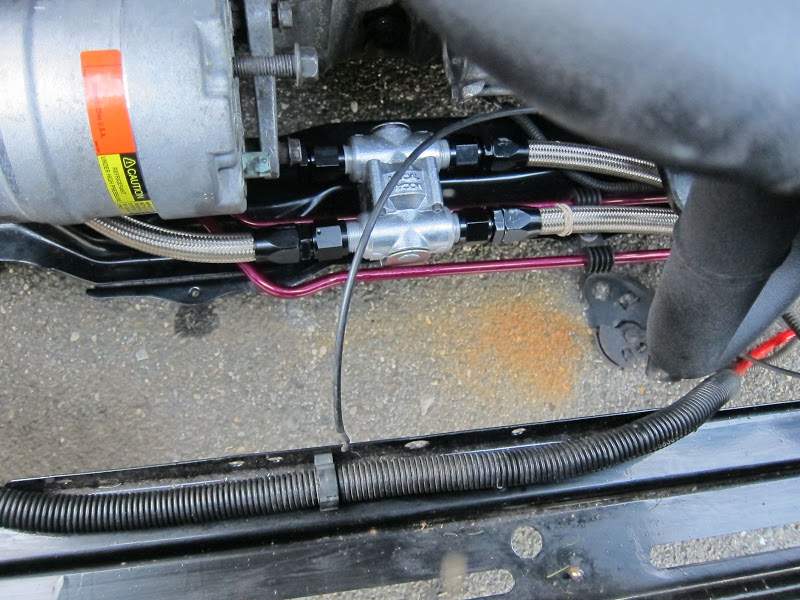

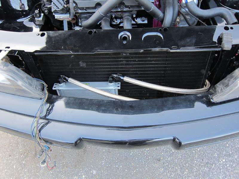

I figured out how I wanted the route the engine oil thermostat, cooler, and lines today. The condenser inlet/outlet blocks sneaking the lines through on the passenger side. There wasn't really enough room to mount the thermostat and have it go through that side anyway. So, I went over through the passenger side. I'll route the trans oil thermo and cooler lines over through there too. The matching cooler (They look identical) will be on the drivers size at the same height.
Making -10 an line is just like -6.. but multiply the pita factor by 1.5. I've got calluses out the wazoo from riding bmx, the gym, etc. and it feels like I borrowed a set of pre-teen girl hands to do this.
It fits! (twss)

Paint that plastic radiator mount black, purple or get a polished steal/chrome one. ;)
It kinda looks like hell compared to everything else you have done and would be a shame to use it in its current condition. ;)
-Clean stuff like the hood latch, radiator stay, wheel wells etc. and install
It's definitely not going on the car like that. For now I'm just going to clean the crap out of it and make it glossy/shiny.
I'll probably revisit it later but I don't want to get hung up on it at the moment.
