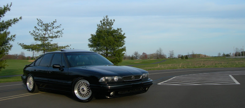

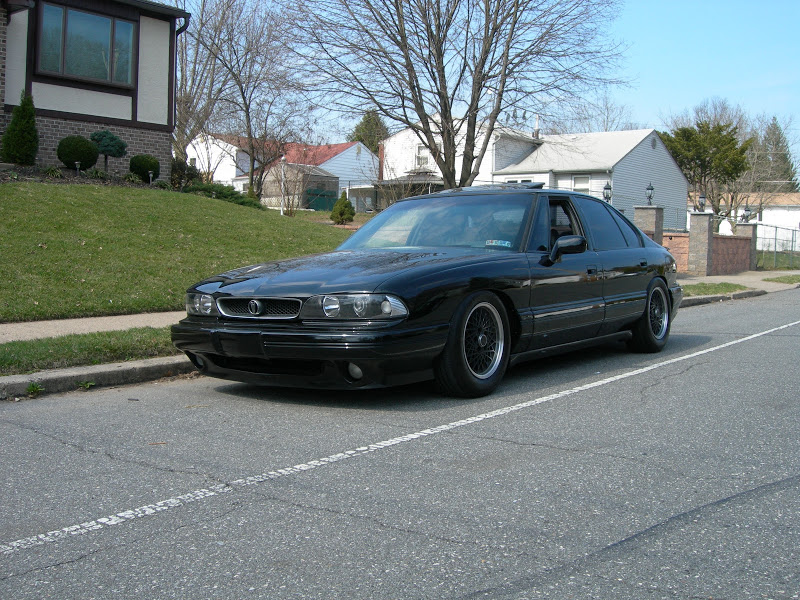

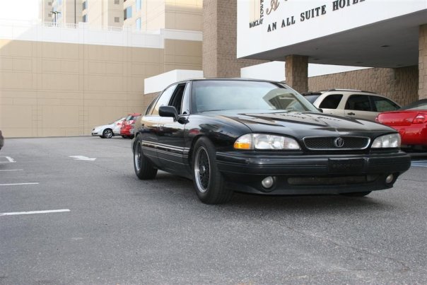

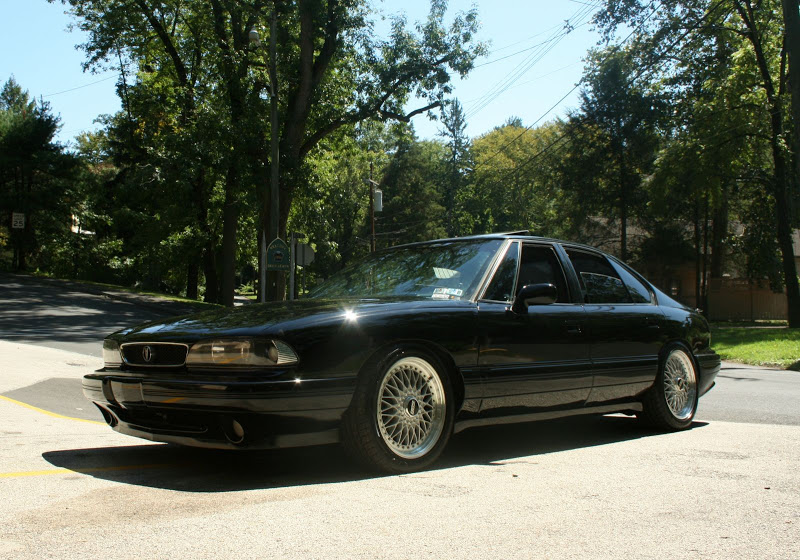

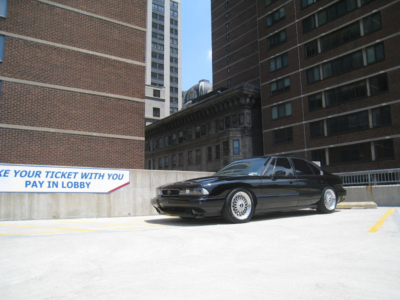

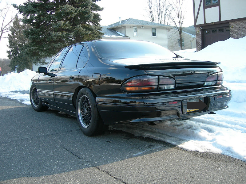

Here's the progression of my car over the past three and a half years.

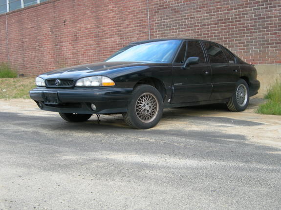

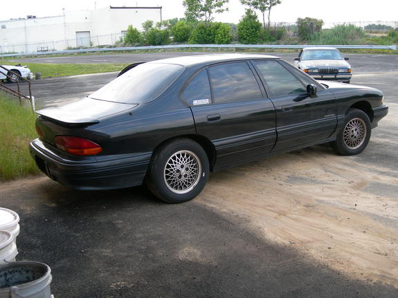

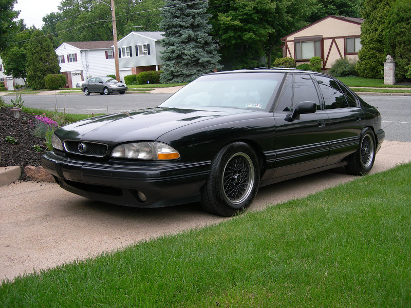

Right after I picked it up:

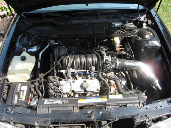

Engine and trans from my last bonneville installed plus some SSE/i tails:

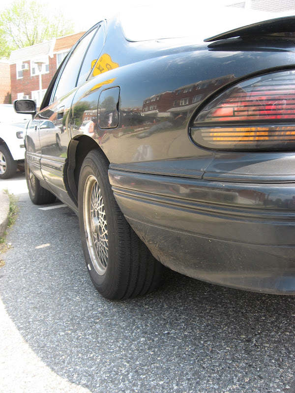

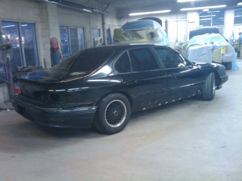

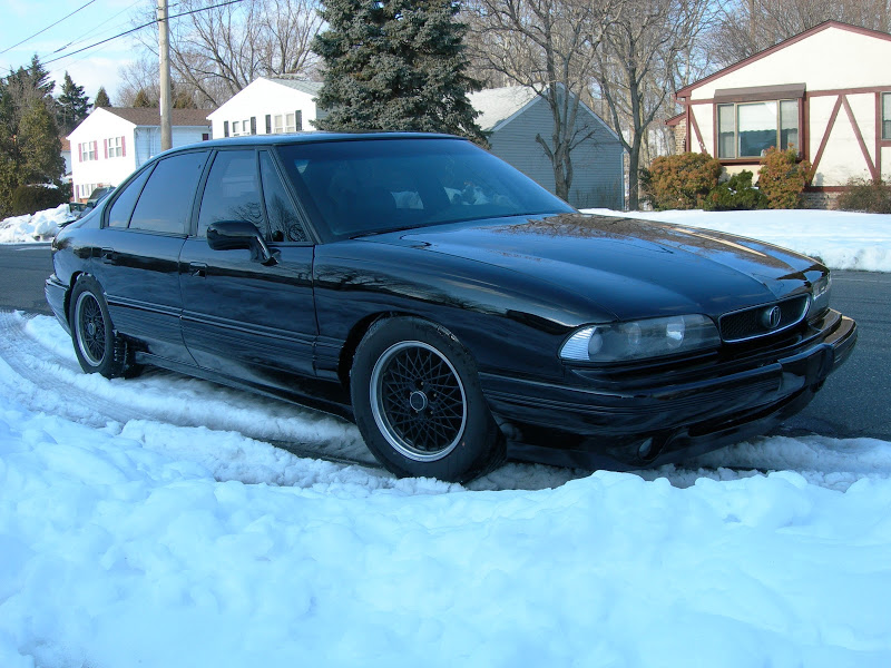

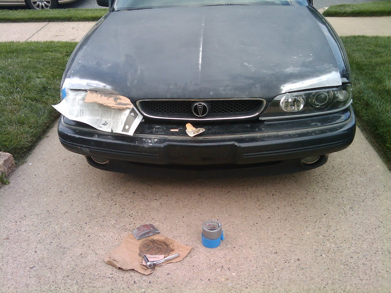

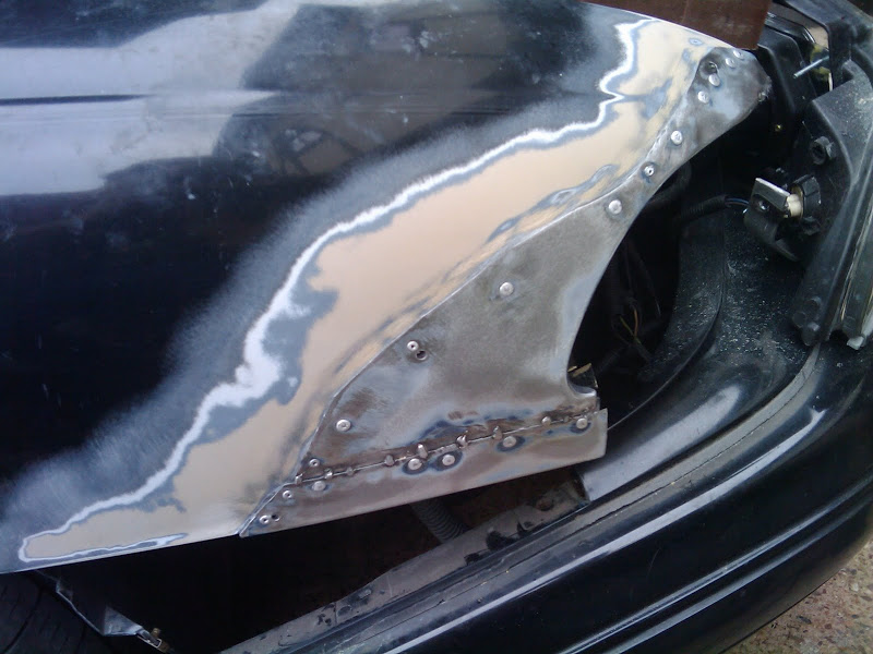

Flared out my bumper:

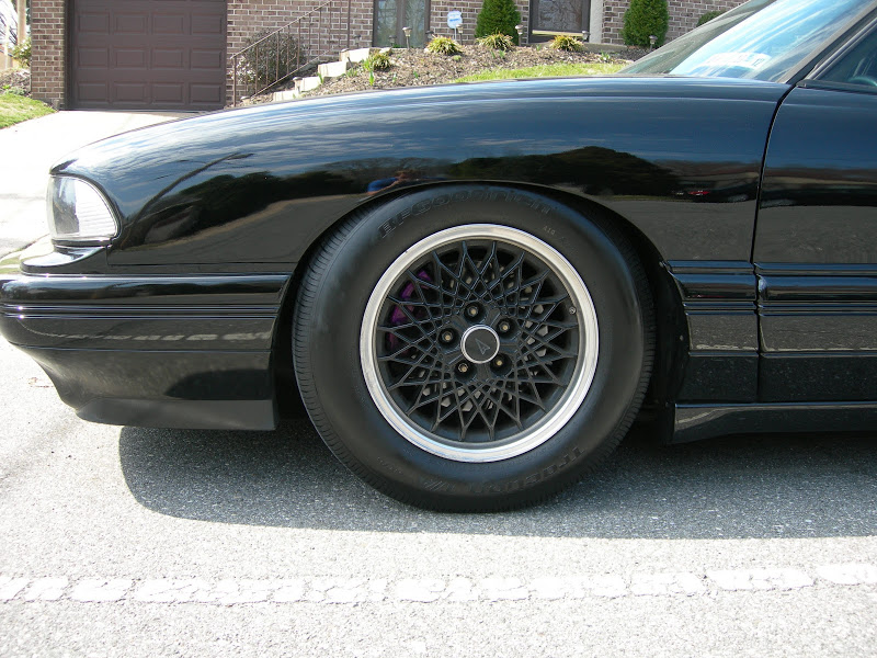

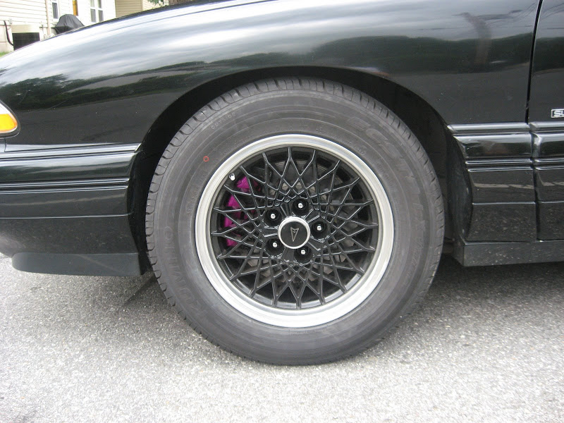

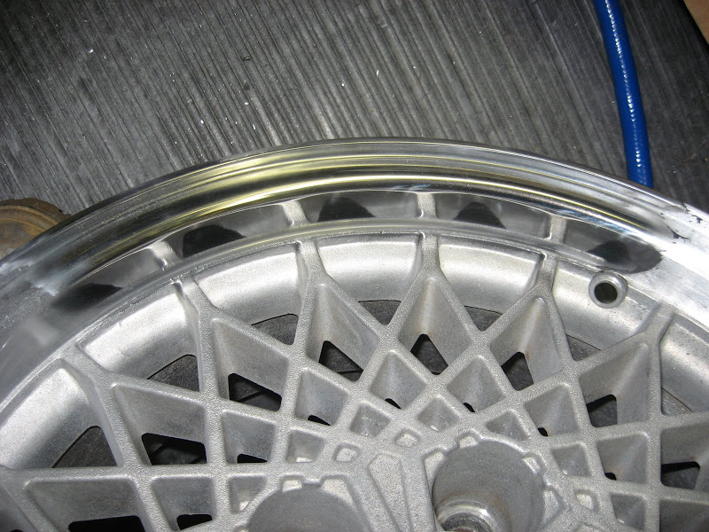

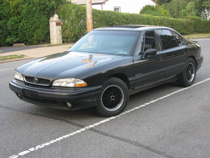

I resto-ed some 16x8 (22 ET) GP crosslaces and had the centers powdercoated black:

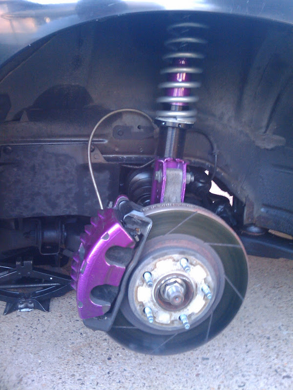

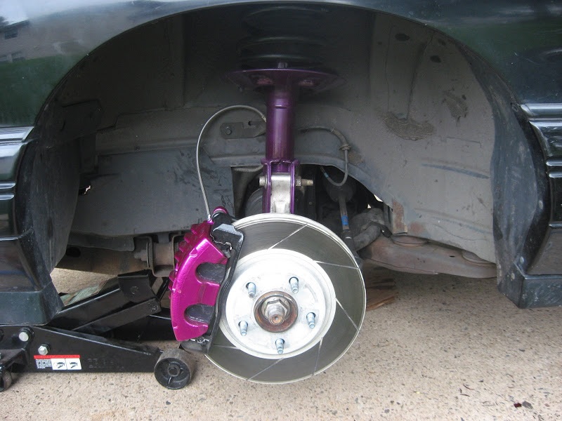

New almost everything suspension with GP AGXs and Eibachs up front with LS1 F-body brakes and Powerslots. Custom 3" drop springs in the rear with air assist shocks.

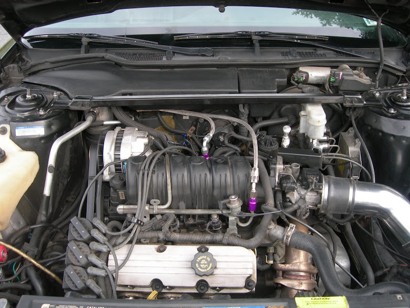

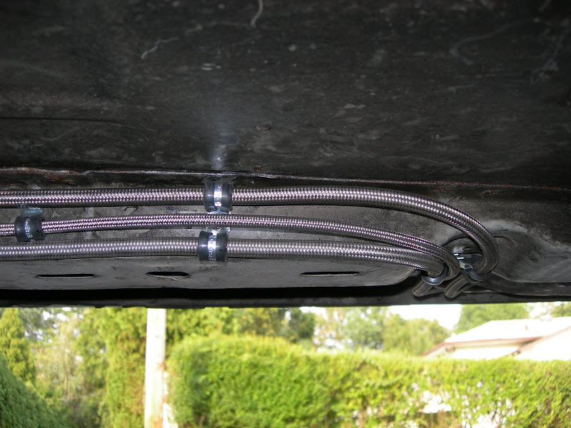

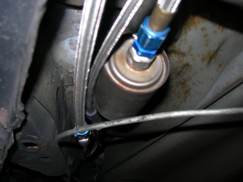

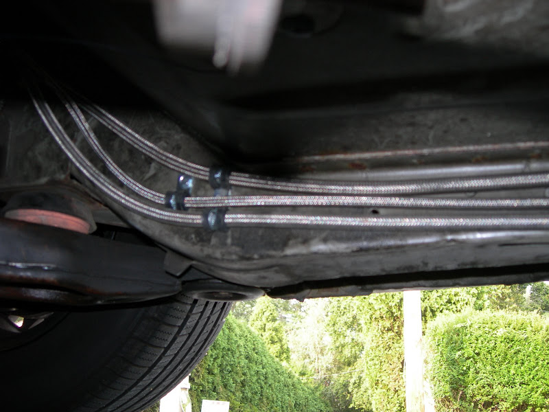

SS Braided Lines from the fuel tank:

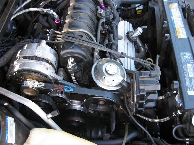

Vac pump setup:

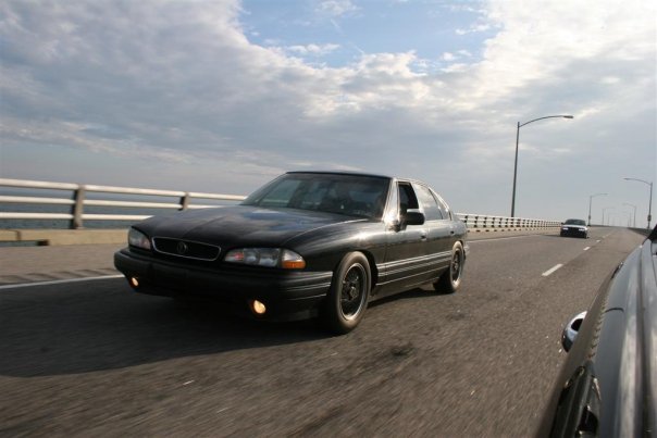

A trip to VA:

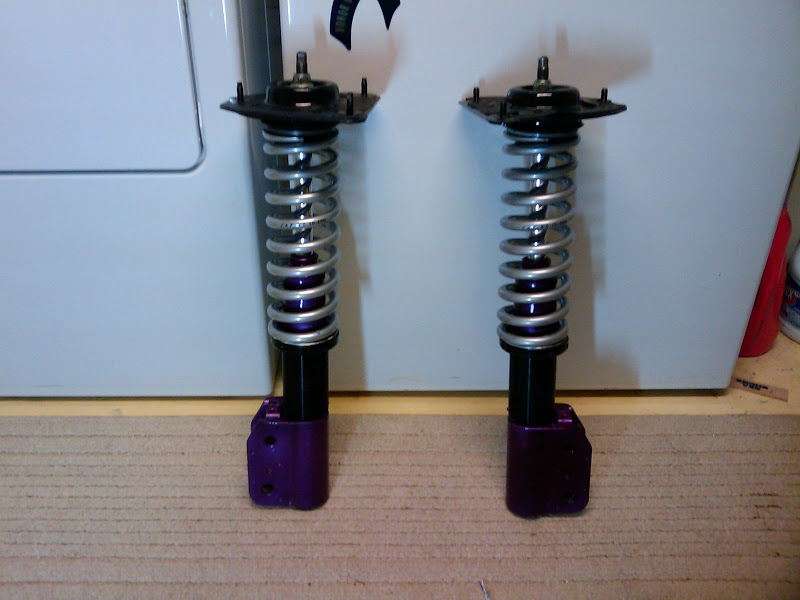

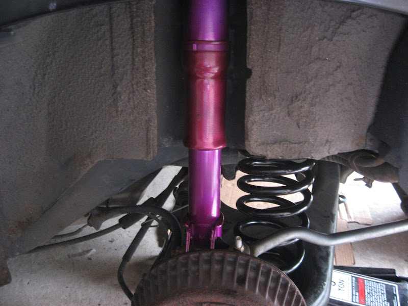

DIY front coilovers and 4" rear dropsprings:

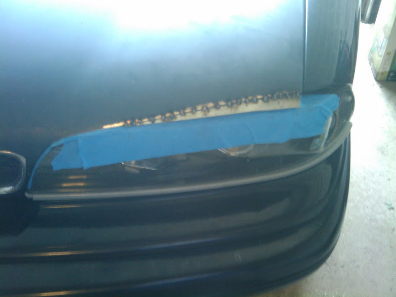

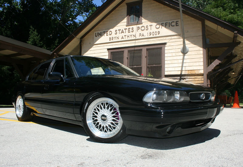

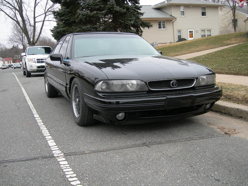

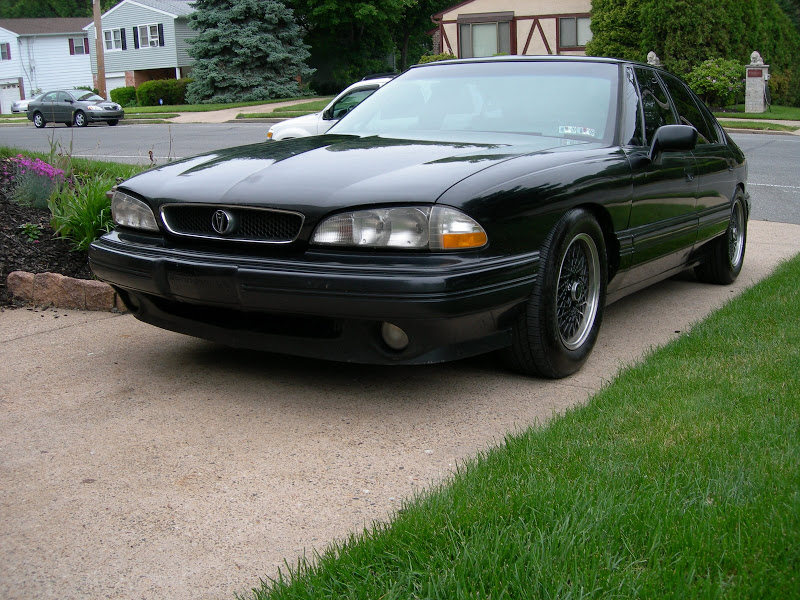

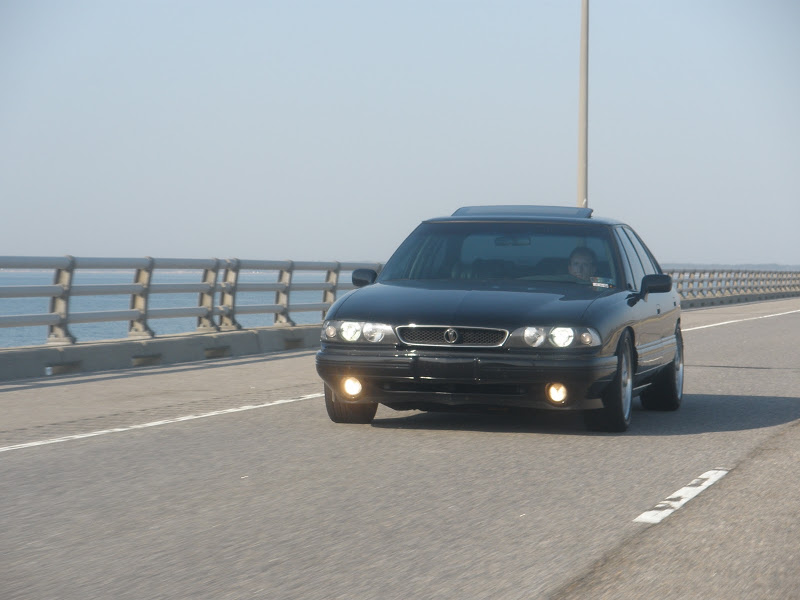

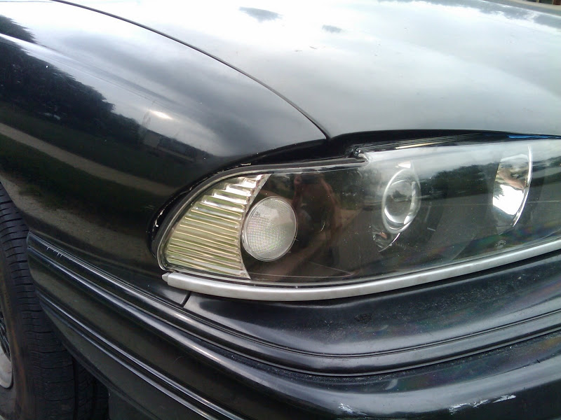

E39 headlights and Super RSes from Japan.

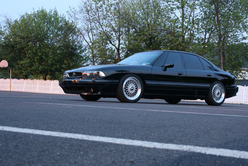

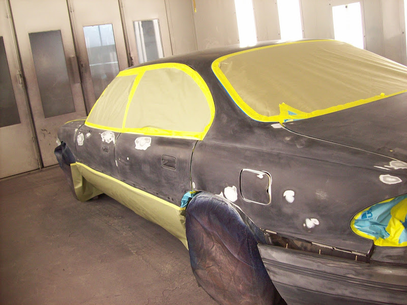

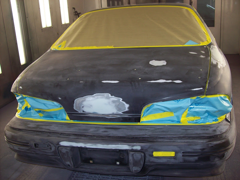

2-stage Black Onyx 202 paint:

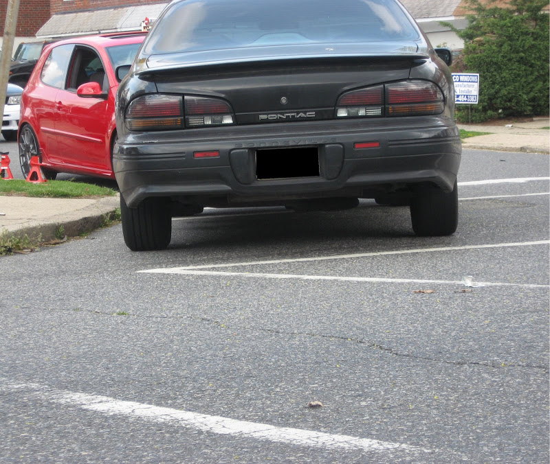

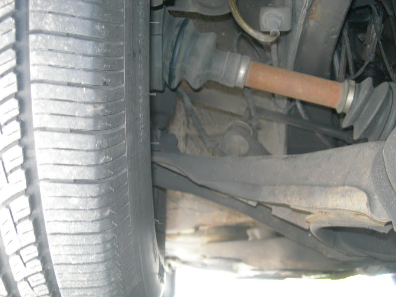

I had already determined how low I could be with raised drivetrain and modified fenders but I decided to bottom it out anyway to see how the axles would respond.. They shook the whole car so bad that I only drove it a half a block.. here's what it looked like though:
suspension geometry fail.

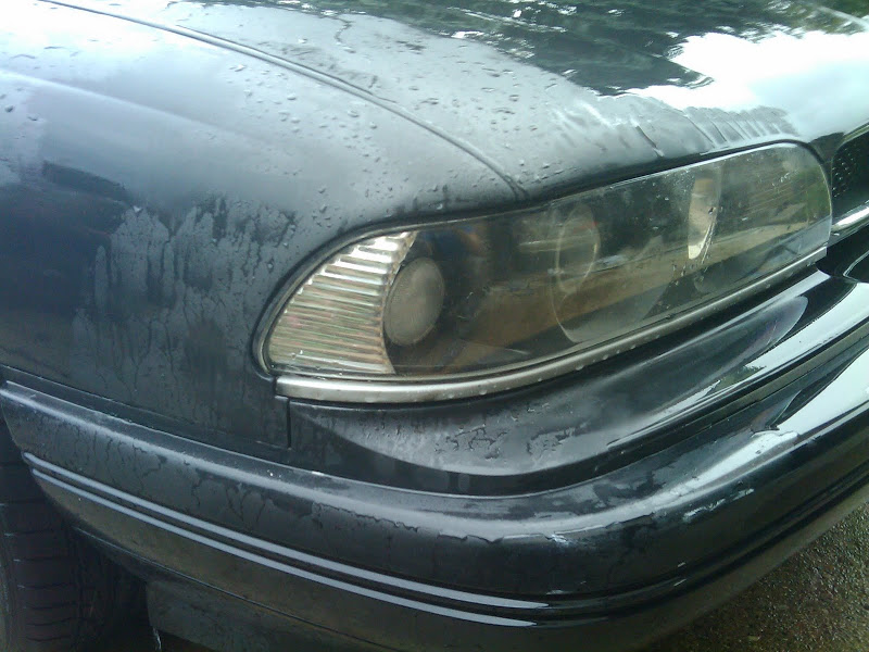

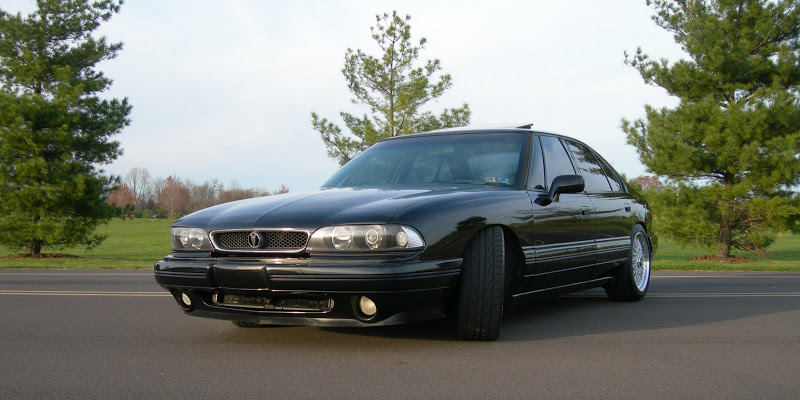

Headlights cleaned up and Super RSes back on:

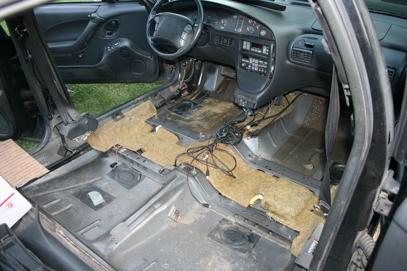

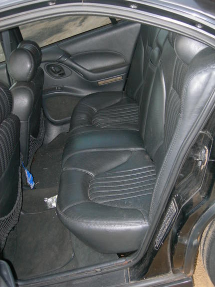

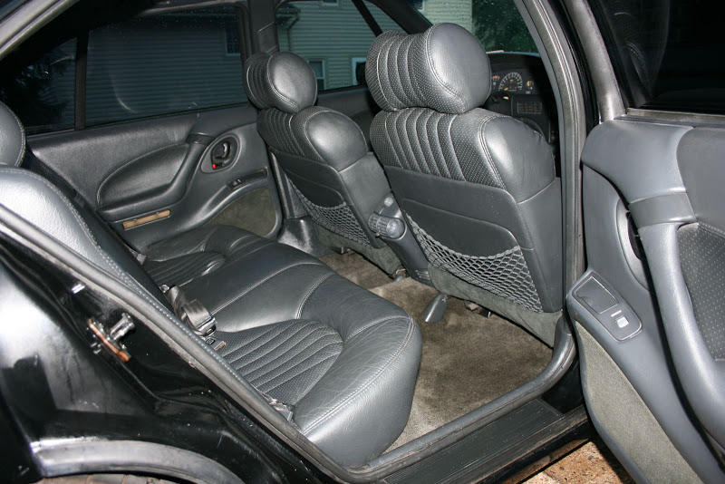

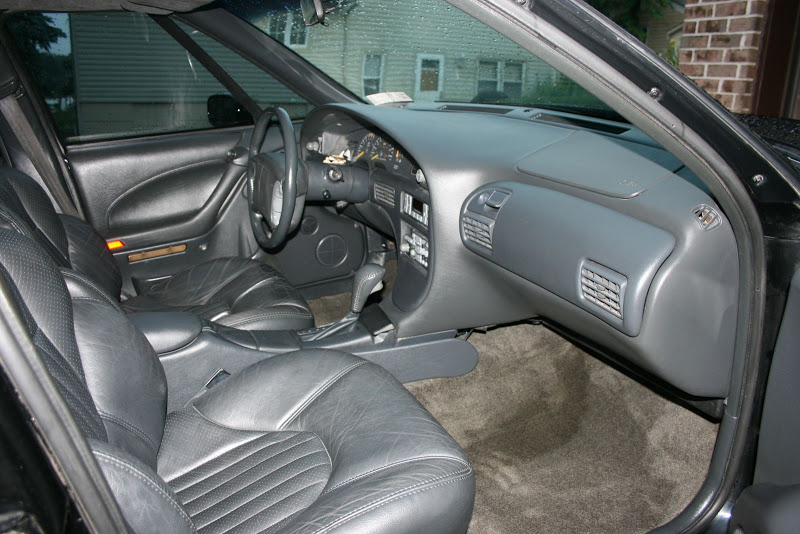

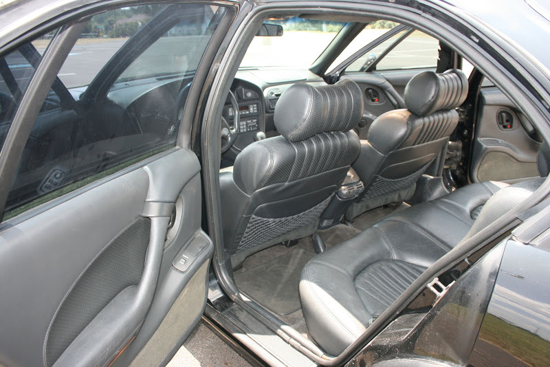

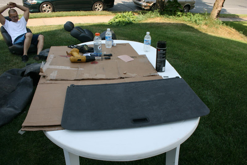

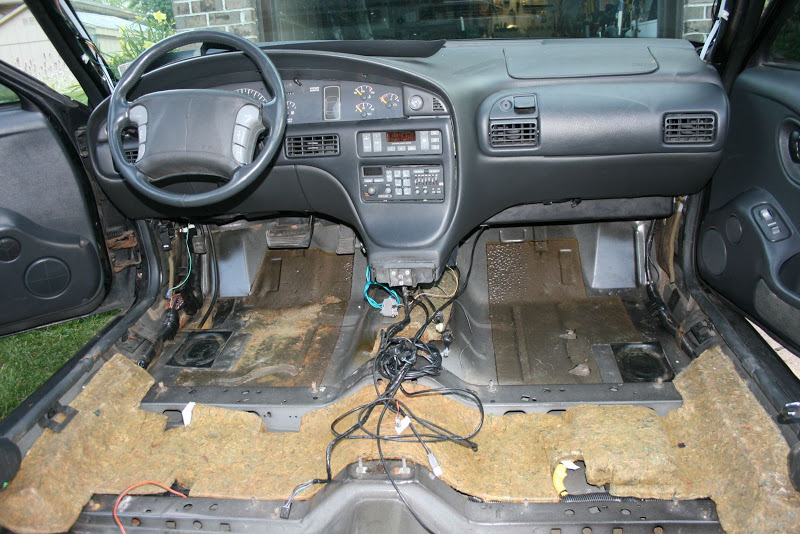

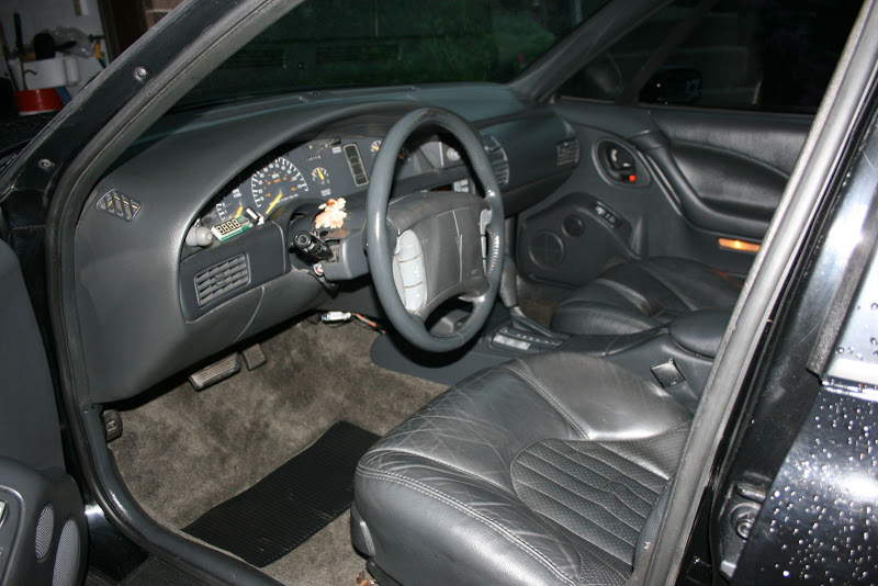

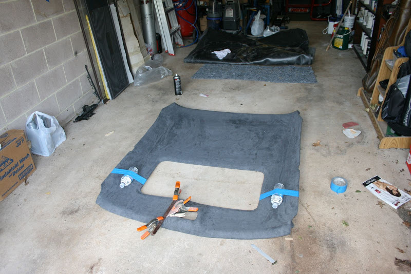

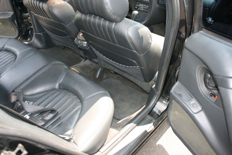

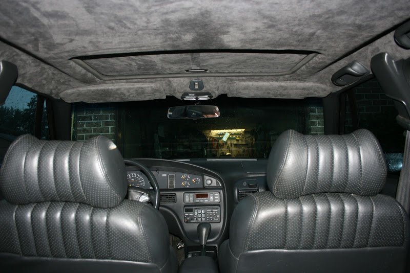

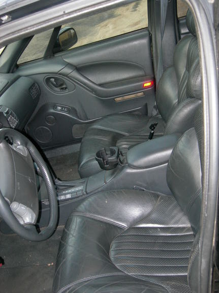

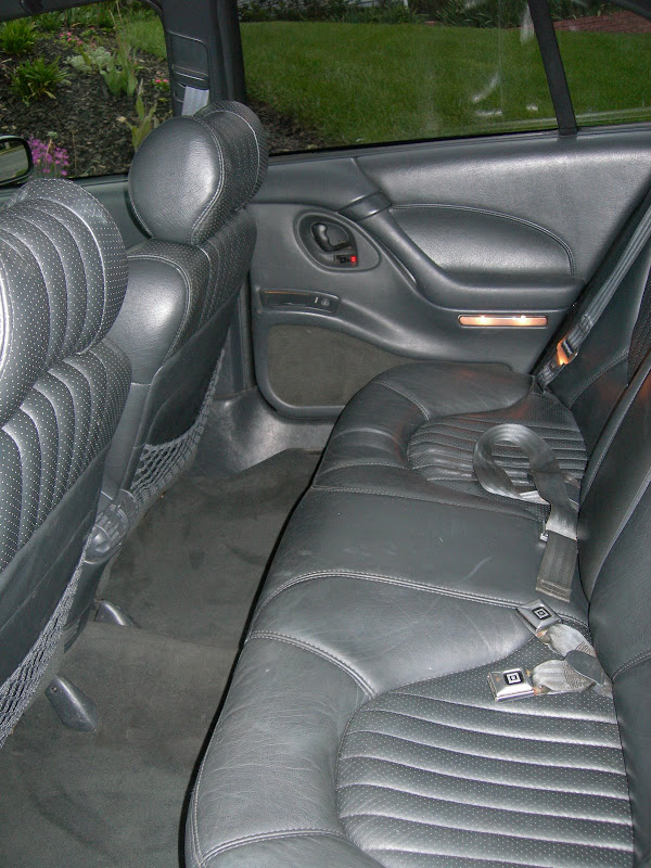

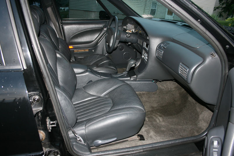

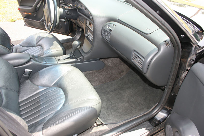

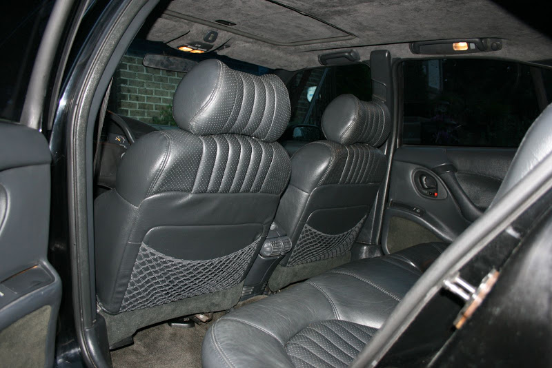

Interior refresh:

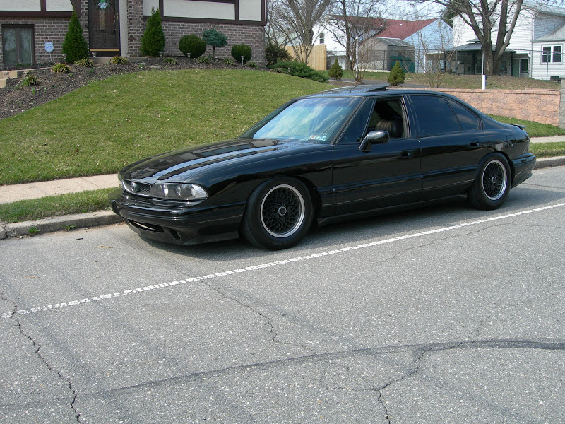

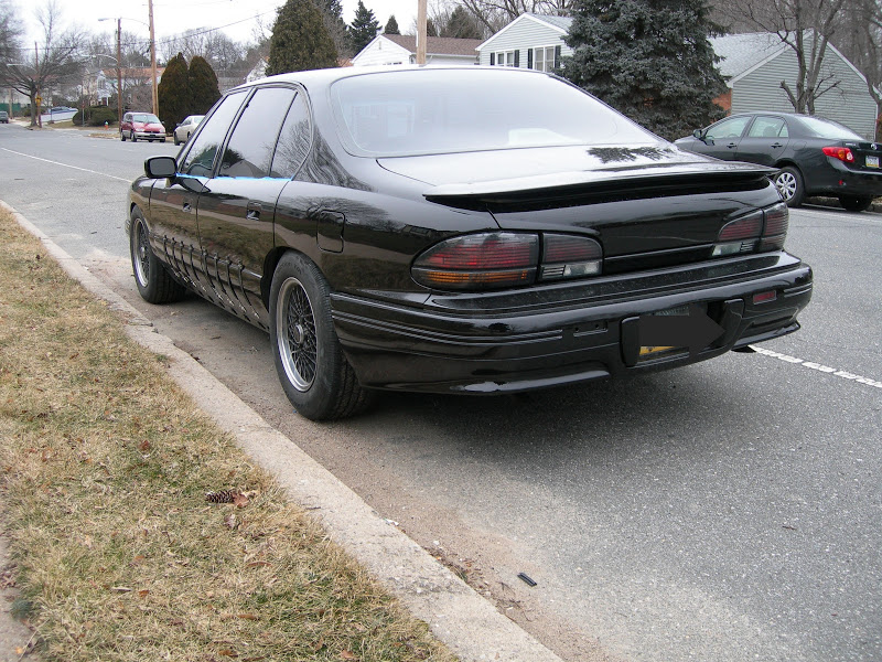

How it looked till about a month ago:

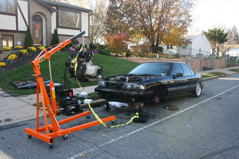

And the start of my engine/bay build:

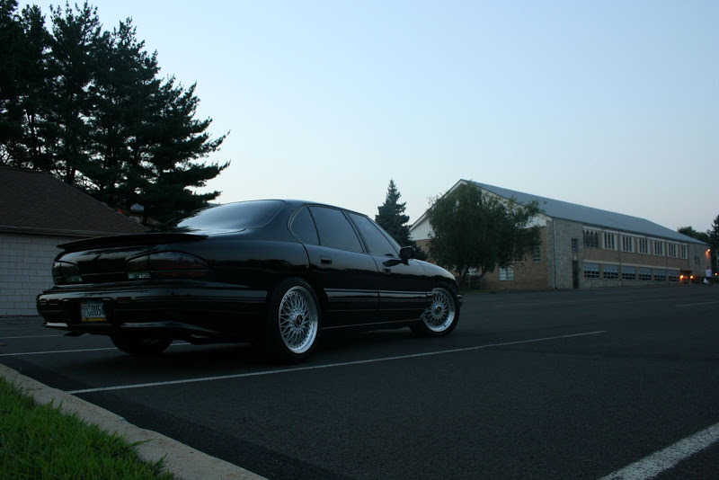

I love the work done to the Bonnie. So tasteful.
Also, if you EVAR decide to sell those BBS's, I want them. So legit.

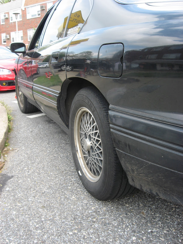

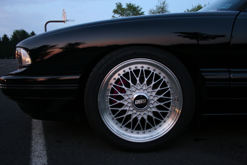

I tried to sell the wheels right before I got into an accident that destroyed one (see intro) but it's tough to get what they are worth. New, they're $6k imported from NZ. I got them for $2200 used from a JDM importer shipped and machined to 115x5 and 70.3mm bore. I've seen them go for as much as $3k on the east coast though. Theres probably 2 dozen sets in the US tops.. Which is why that set with one wheel's barrel destroyed beyond repair is now worth nothing. (believe me I'm searched/called/emailed for a barrel)
Oddly enough I had the new wider and chromed set by the time of the accident.

Such a great looking car! :rofl: I love the new headlights and the body work that made them fit. :rofl: The only thing I would do is give the bad boy some pontiac split grills!!!! I hate how Pontiac dropped there split grills for a few years... Bring them back!!!!! You seem to be pretty darn good at body work/fabing up stuff. I bet you could find some grills and a frontend to steel from another pontiac.
I do like that idea. Problem is I think it would be too close to the beemer kidney grills. I like that the grill is different enough to where it's not completely resembling an E39. Also, without any major other bodywork aside from the shaved trunk key hole and antenna, a lot of people really think that I didn't do anything at all to make the lights fit. That's kinda cool in a way.
This is the kind of build I enjoy; subtle body modifications, a proper stance, some OEM+ styling, and coilovers hidden behind the wheels. This is exactly where I want to go with my Grand Prix.
What components did you go with for your coilovers? I'm currently in the process of piecing together my own set and just about have all of the parts ordered. Mine will be a DIY assembly too, front and rear.
I got the thrust bearings for top and bottom and QA1 400lb springs from Summit. The sleeve and the lower perch are from A1racing. I welded a piece of 2.5" pipe to my stock top mount to center the spring and bearing. For the most part this setup works well. I would love to draw an adjustable top mount up in CAD with provision for a pillowball mount, but that will have to wait till later.

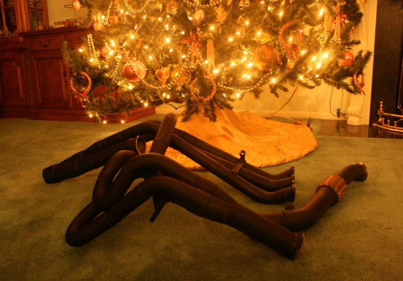

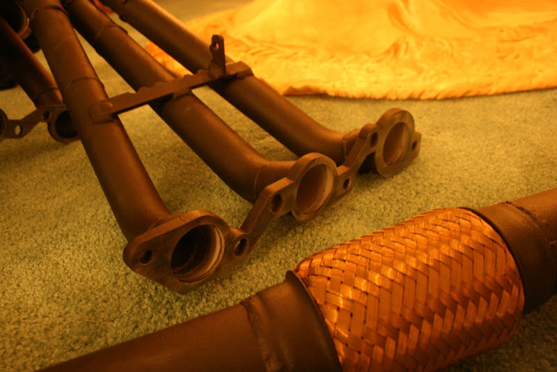

I got my longtubes back from Jet Hot today. 2000* Black.
