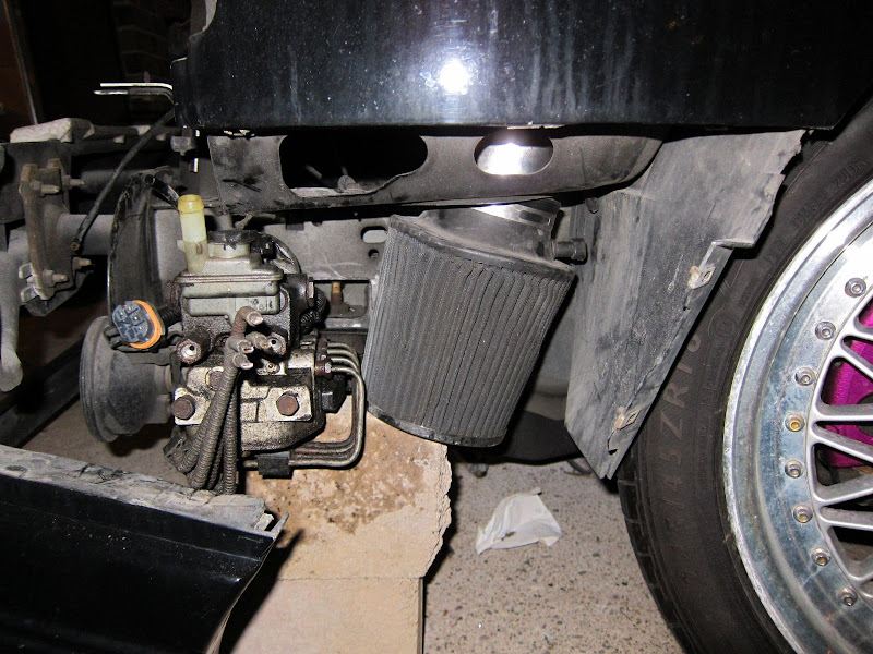

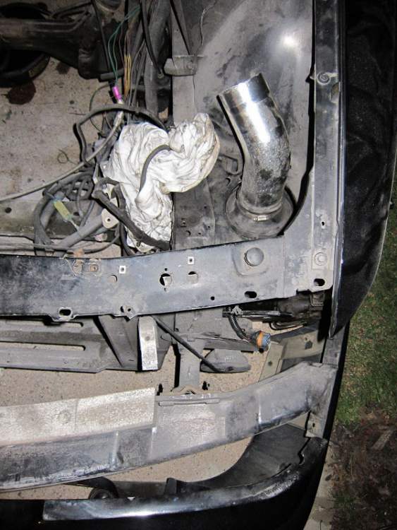

That black Audi you showed, didn't that opening in the headlight lead to the intake and/or engine bay?
Ohh. Thats what you meant.
I had to enlarge the holes behind my headlights to run the E39 projectors. I thought that's what you were talking about.
That Audi pic, yeah It would point at the filter in the bay. I know I've seen better more tasteful examples but I can't find one at the moment.
Yeah. I mean, if you go that route...just use the grille opening. :D

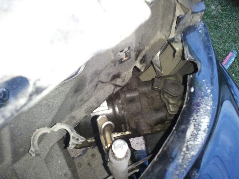

Ok. So.. ABS tuck and FWI it is.
With a little trimming and the OEM bracket welded in there, it will fit like it belongs.
If I can't fit my charcoal canister in there too (went above and forward of proposed abs block location) then I'll just move it to the other side.

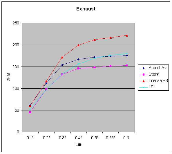

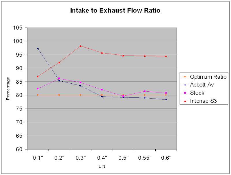

I chose these heads for a few reasons..
1. The highest n/a whp record (270 whp) was achieved with these
2. The intake to exhaust flow ratio is near perfect 80-85%
3. They come with flow data and chamber volume
4. 30 years of head porting experience
5. Good reputation (more so in the 3.8 F-body crowd)
6. I've been kicking around trying to decide if I should get these for 4 years. Once I got my 09 tax return, I knew.

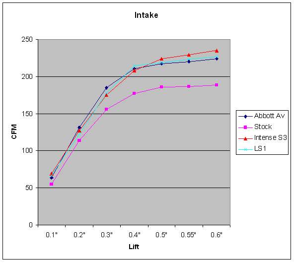

Flow comparison.. For a general idea not all are from the same bench.

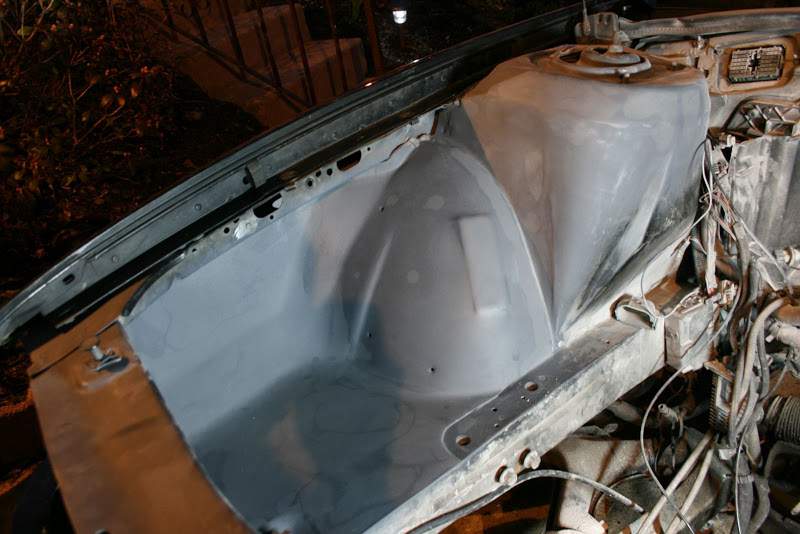

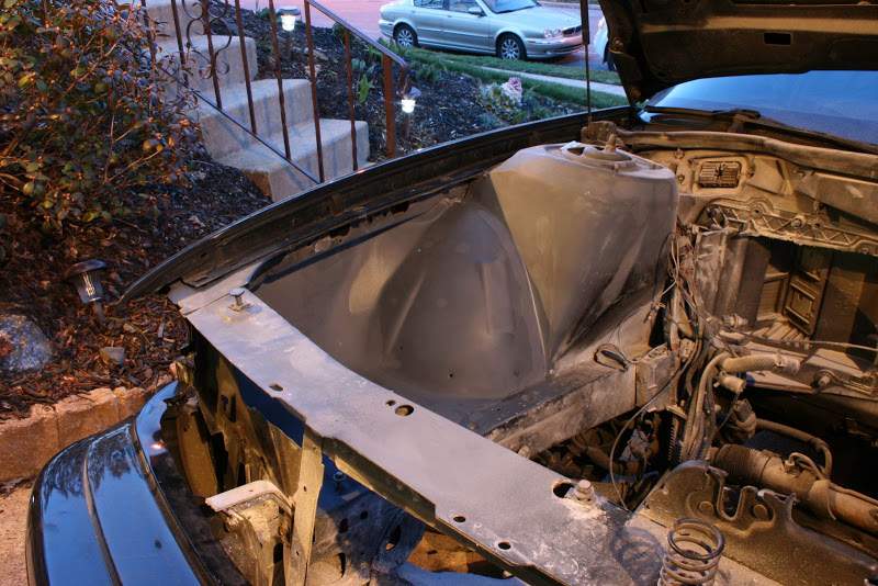

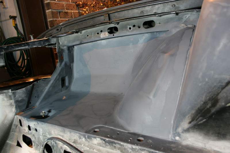

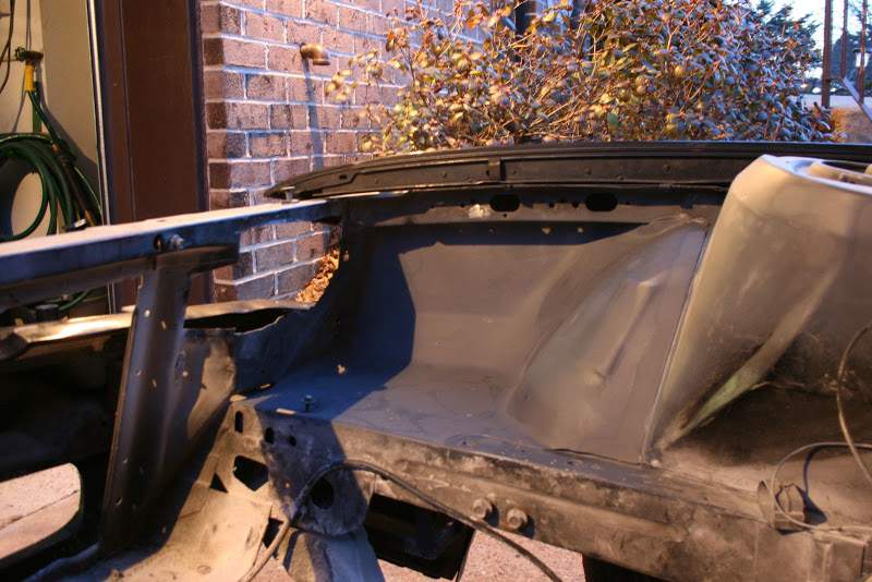

It might not look like much but I put in about another 8 hours of sanding. My fingers are raw.. But, all the bodywork is finished on the passenger side. There's just some grinding left in the headlight hole.

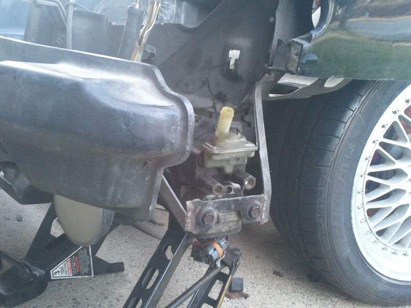

I started to mount the ABS unit but I ran out of gas.. CO2/Argon. It sucks. Where I go to fill the tank is only open 8-5 M-F and I work on the complete opposite side of the city.
Old:
Worked:
I'm using the sections of the stock ABS mount with rubber bushings then then bolting/welding extensions to support it. The bumper and filter both fit good and there is enough room to route all the lines.
Nice ! Glad to see updates, keep it up Mike !
Quick question; aren't you afraid rust will appear through the body filler on that shaved area ? I mean, did you seal it with anything before the kitty hair ?
:lol: u sir have tigerblood
Winning? Yes.
All the metal was sanded before the kitty hair and filler were added. So, any surface rust was eliminated before hand. No water or air is really going to reach the metal before (real) priming and paint so I'm sure it'll be fine. Everything on the other side was sprayed with underbody, so that will be good too.
